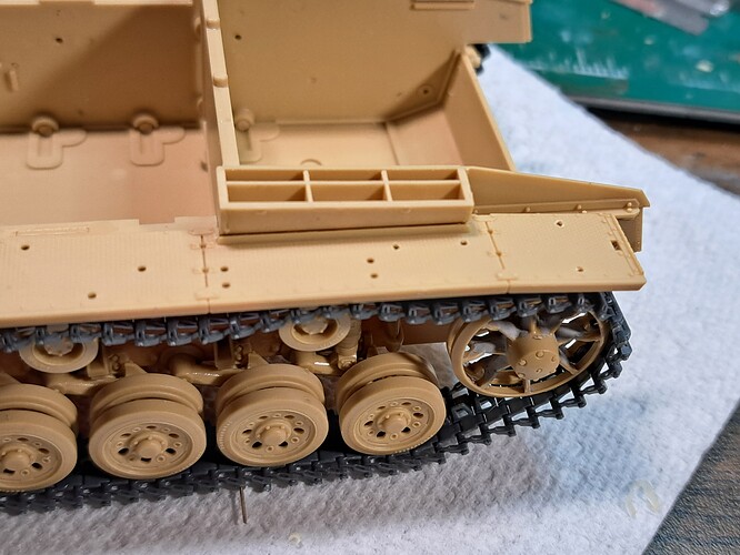

One item of note is how snug the road wheels, sprockets & idlers fit as is without polycaps (or the white glue trick to make a ghetto version polycap). In great road wheel fit & sitting level with all wheels touching the ground this kit is outstanding. Better than Tamiya, RFM (Stug III G suspension), Dragon and every thing is better than Takom’s feeble attempt with their Pz III N.

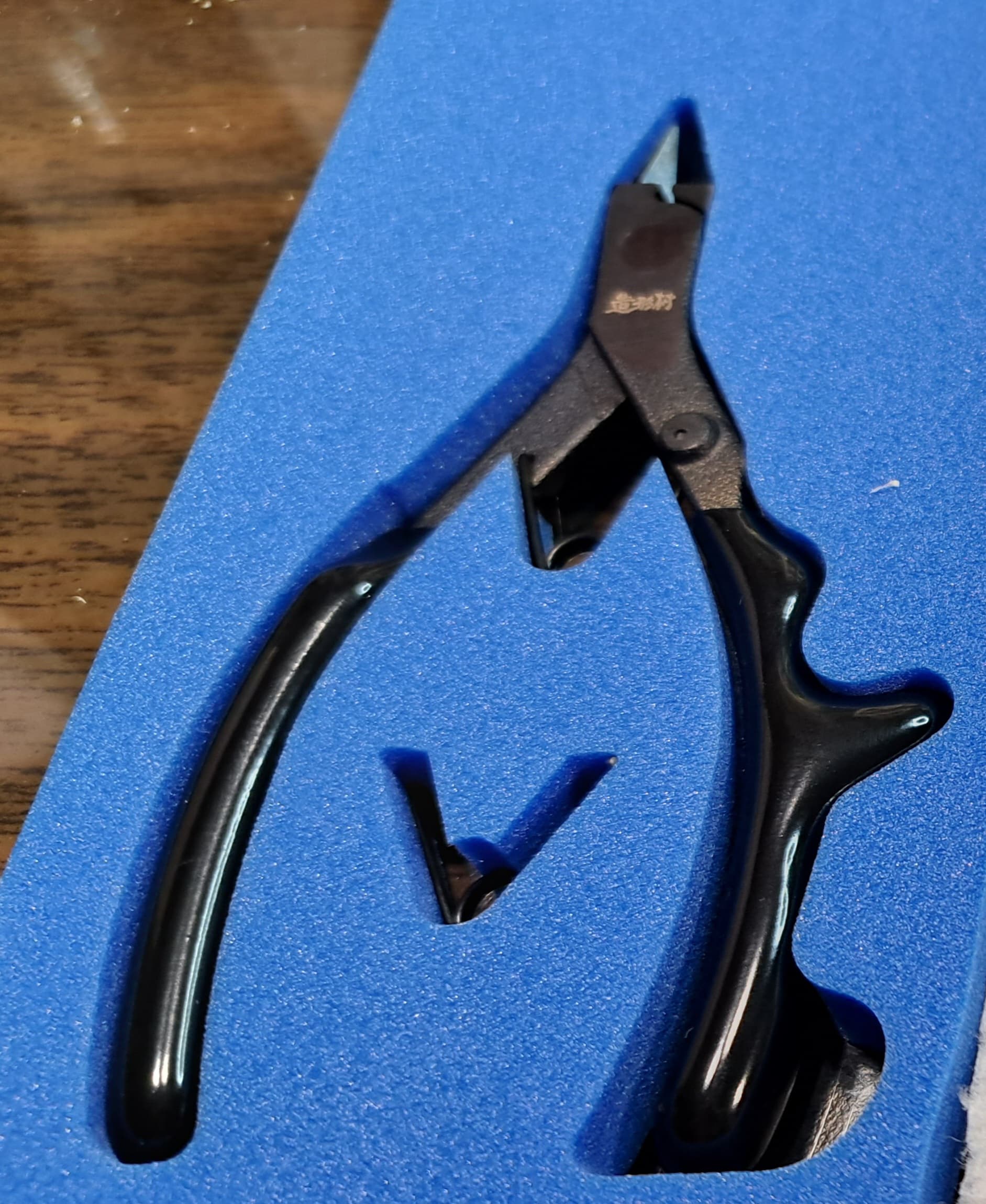

Tested out the Zoukei-Mura Pro nippers removing the fenders from the sprue. They are outstanding with sharp pointed nose to get into a tight area. Very minimal clean up required after snip. I think they do cut closer than ye ole trusty GodHand nippers.

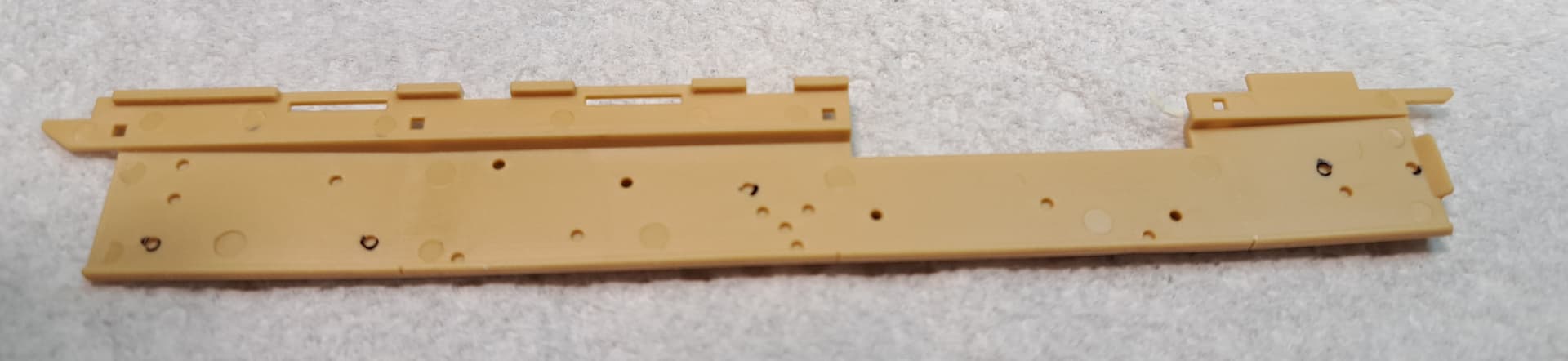

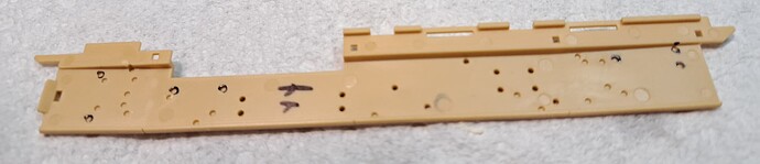

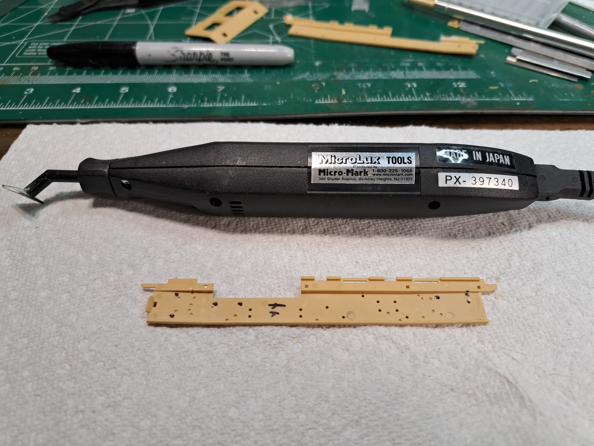

Building version #5, decided with all those holes best to mark each hole to be drilled on the fenders with a Sharpie. Yes, I even numbered one fender playing it safe.
Meng’s inexpensive finger drill bits proved the right tool for drilling. Used a .9 mm, rather be a hair under than over.
Underside of the fenders is pretty nasty probably ~30 undrilled holes to fill with CA and ~35 punch marks to fix. Dragon has the best Pz III fenders. Academy the fast build Rolex lower hull. RFM the killer inexpensive workable tracks.
No worries, The Nuclear Option to Obliterate punch marks (MicroLux) isn’t needed.
Conventional warfare with a #15 blade quickly takes care of business.
Scraped, filled w/black CA & stippled with thinned Molak to obscure sanding & tool marks.

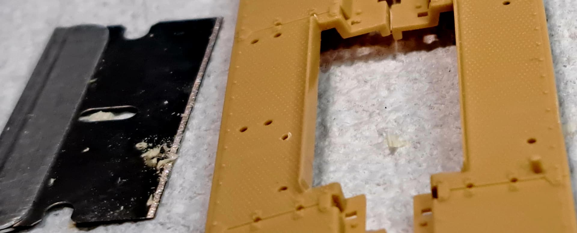

The newer Pz III kit manufacturers agree that two pieces of PE are the best way to address the raised lip beside the air intakes. Academy molds that lip to the fender like its 1999.
Left thinned, right stock.
My inner Panzer Policeman insisted on thinning the lip with a razor blade.
Thinned, I think it’s passable without PE.
The fenders fit very well. There’s a nice alignment tab in the rear and plus a pair near the front. I’m 99% sure if fit issues occur down the road it’s core issue will be at the tip of the fenders in front.
Fender madness.
I’m also got the Super Snipper today and tried it on a Tamiya kit and GWH and it is the bees knees!
My godhands are now weeping!
Doesn’t the RFM III give your two PE choices for that part you sanded thin? If so, you could cut it away and use the RFM part?
Dan, had one PE choice in the RFM Stug. I also checked my RFM Pz III J and it too only has one PE choice. Was it another kit Dragon or MiniArt maybe?
I’ll have to think of it more, but I know somwheres i saw a choice of two PE.

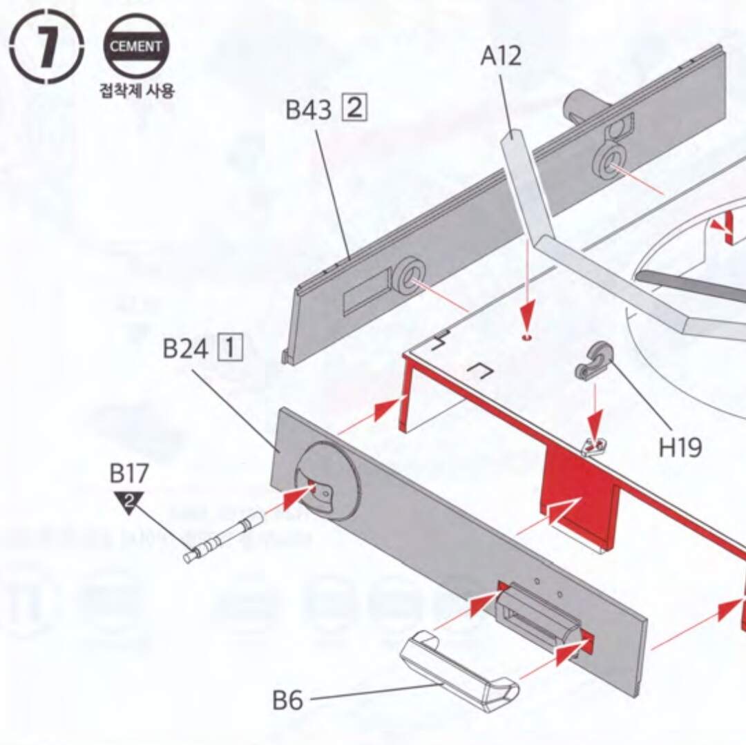

[ On soap box ]
B24 makes me want to…take this kit like the monkey in 2001: A Space Odyssey did that bone.
Check out B24
For kicks, I pulled my copy of Dragon 9020: PzKpfw.IV Ausf.G Kursk 1943 (Imperial Series Kit), the 1990’ update/repop of the Gunzy Sangyo Pz IV from the 1980’s. Even that decrepit old warhorse has the MG mount molded as a separate part.
[ Off soap box ]
Never seen options for those PE bits in a Dragon kit and I literally just built ten of them at one go last year. Only one piece per fender is what was included.

Wade, you’re working the styrene magic with the fender thinning. Only an old Master like you would think of that offhand.

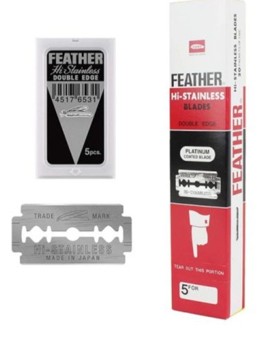

I think you’d really like my dear friend RP.
Couple years ago I showed him the GodHand nippers. He chopped a few parts loose and said, “Meh, you say you paid $60 for this thing? I’d send it back if you can. You need this!.”
Out comes a double edged razor blade wrapped in masking tape. He proceeds to quickly slice out parts with laser precision! Then adds, “Can get cut sometimes if you get careless but you got superglue? OK, No problem, when it happens, right? The parts don’t need clean up other than mold seams.”
Understatement!
I said no thanks, I’d end up in the ER with that thing…wink.
Needless to say he didn’t buy a pair of GodHand’s etc…I didn’t buy any double edged razor blades…and still have all my fingers…wink

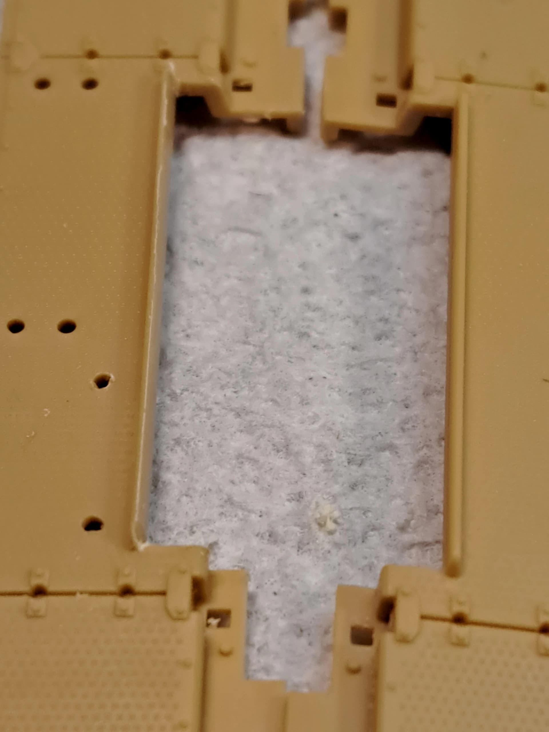

Top box of superstructure snapped in place with perfect precision. Zero fit issues. In fact it snapped in so perfect on test fit, I left it in place and LC’d accordingly as no trim, shave or tweaking was needed.
Oh gee-zuss! Wade I’m not trying to get highbrow on you but that’s just hillbilly modeling! That’s one of the craziest things I’ve ever heard. I guess RP had some thick skin. Trying that would get me straight to the ER with my wife babbling about how stupid I am. She thinks swinging a #11 blade around is dangerous!
