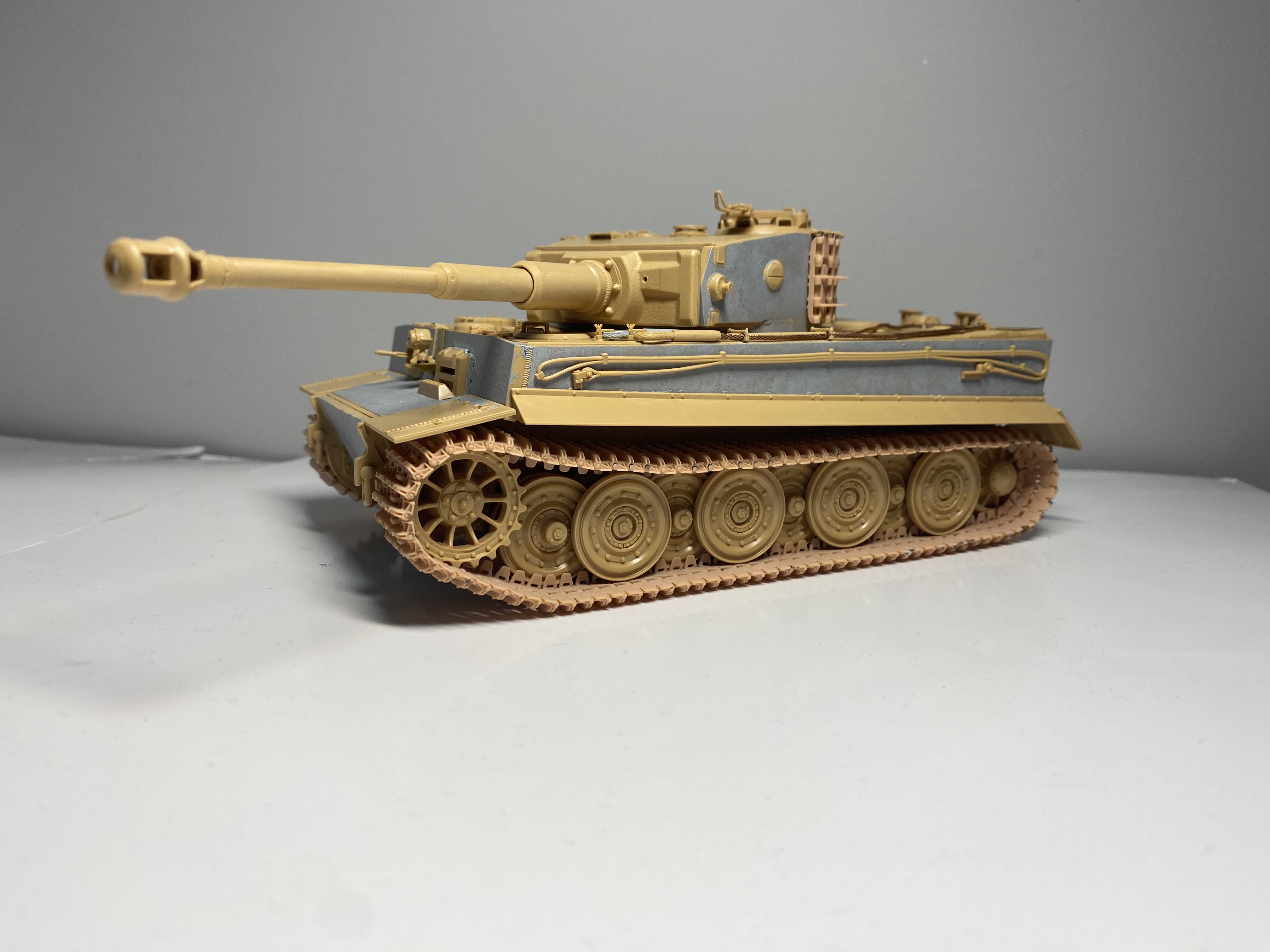

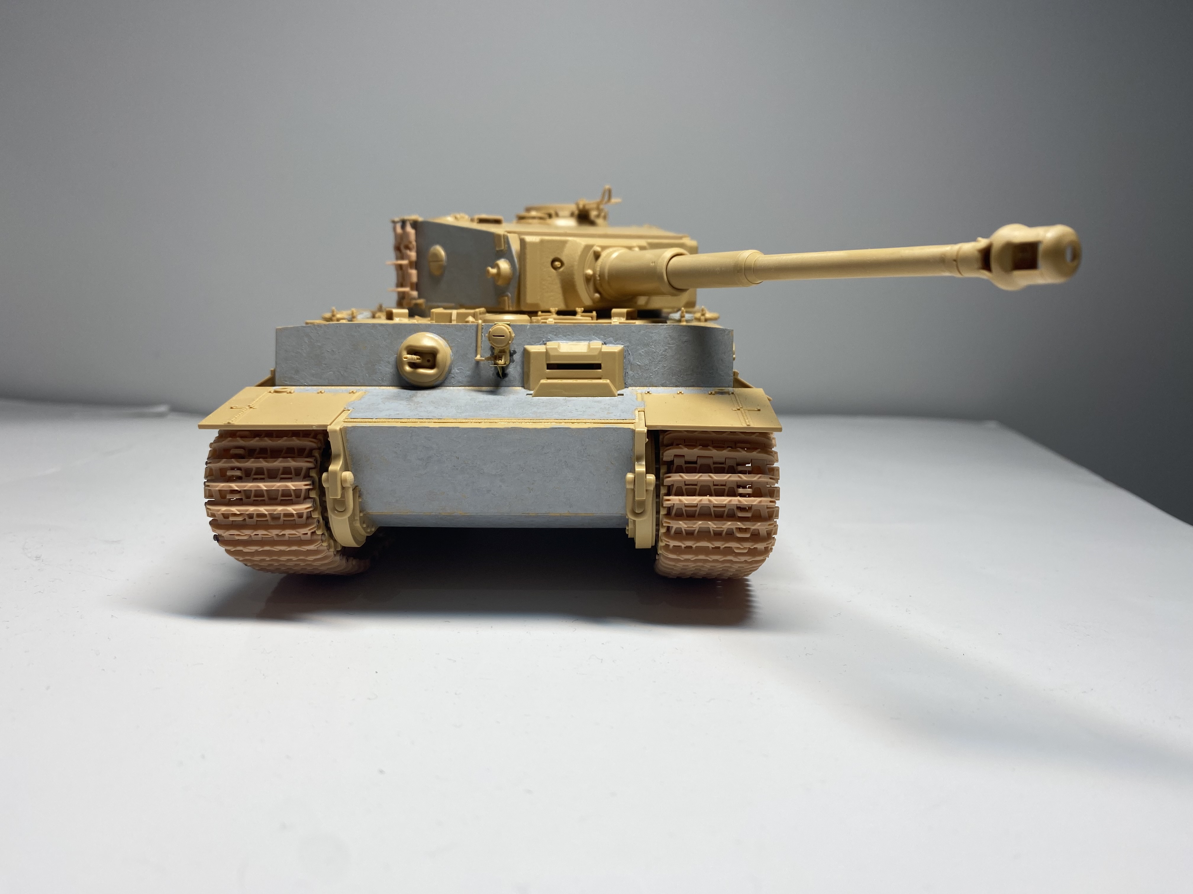

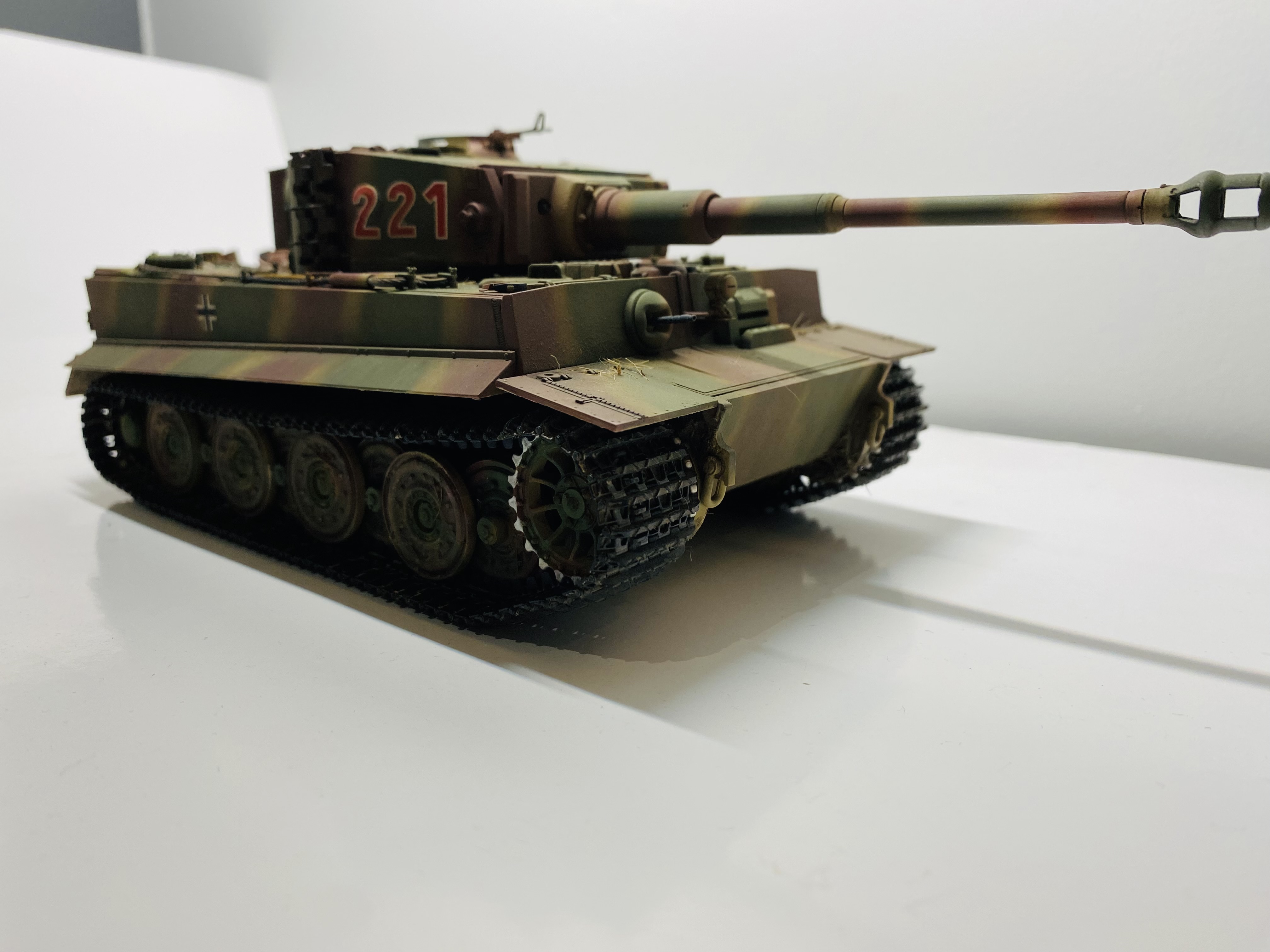

So the model is ready to paint. The model may not be 100% historically accurate because I did not use any zimmerit and as far as I know all late production tigers had one but I wanted to try the steel texture made of putty. Also added the 3d printed t-rex tracks
Looks sweet!

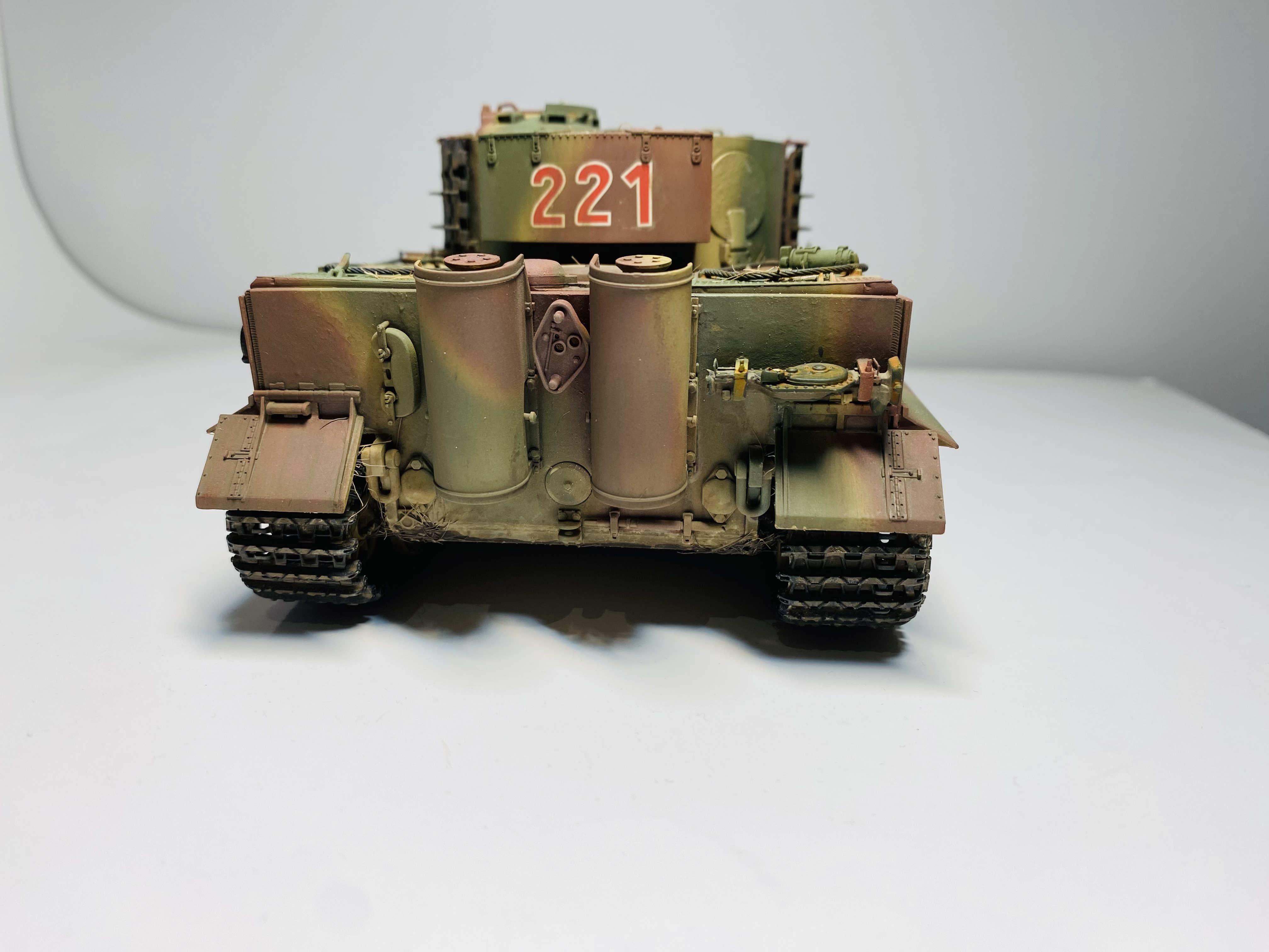

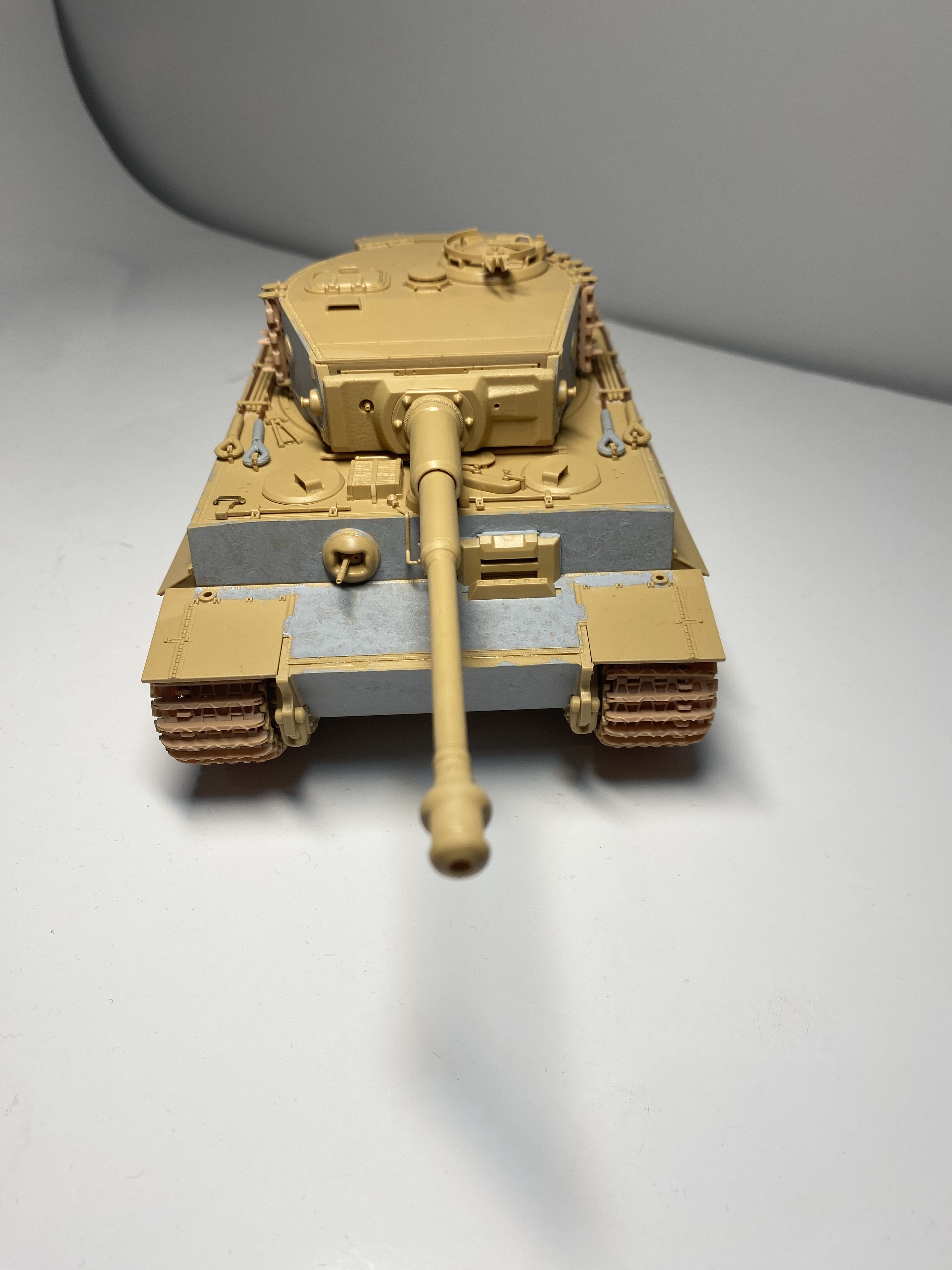

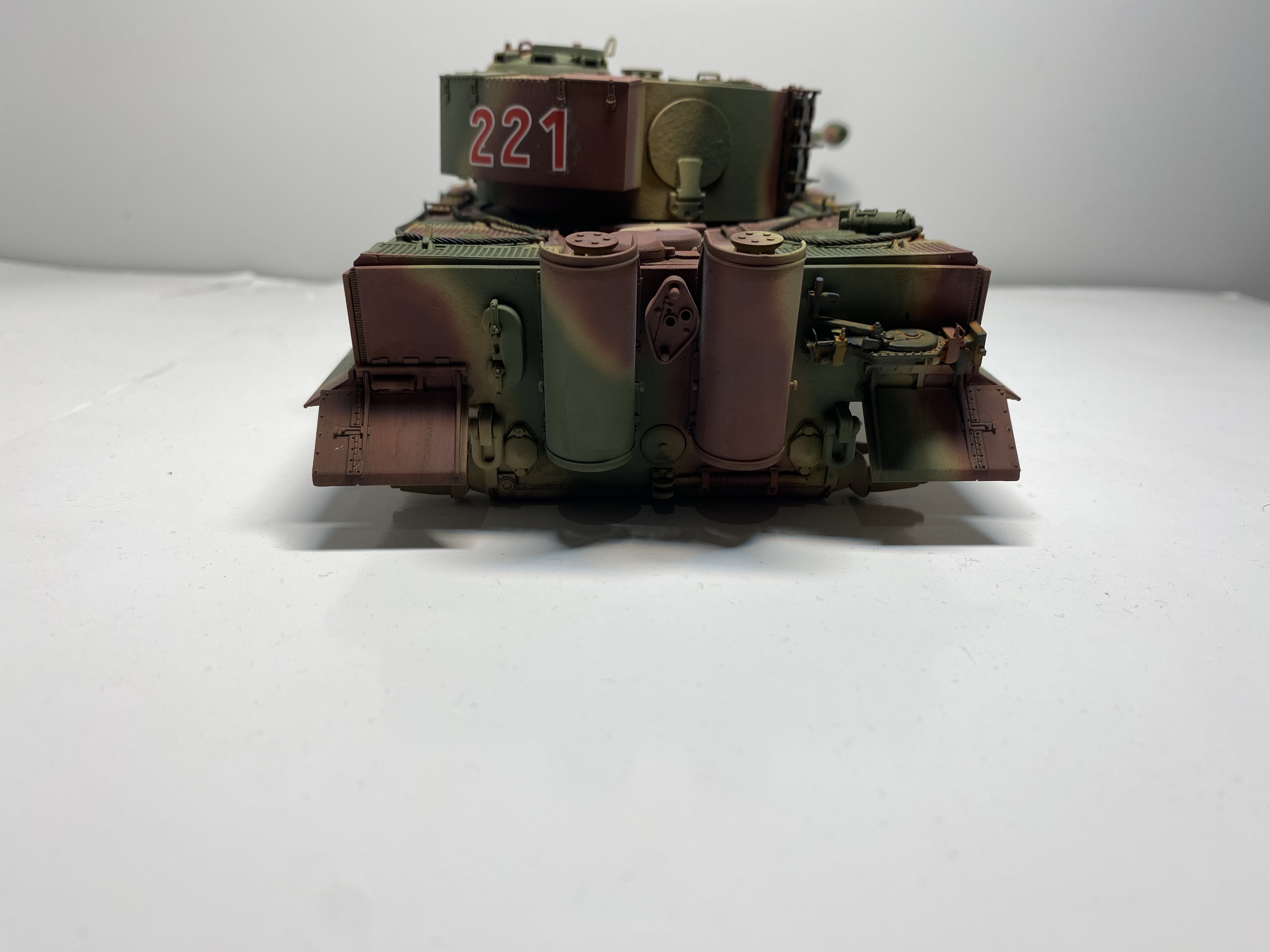

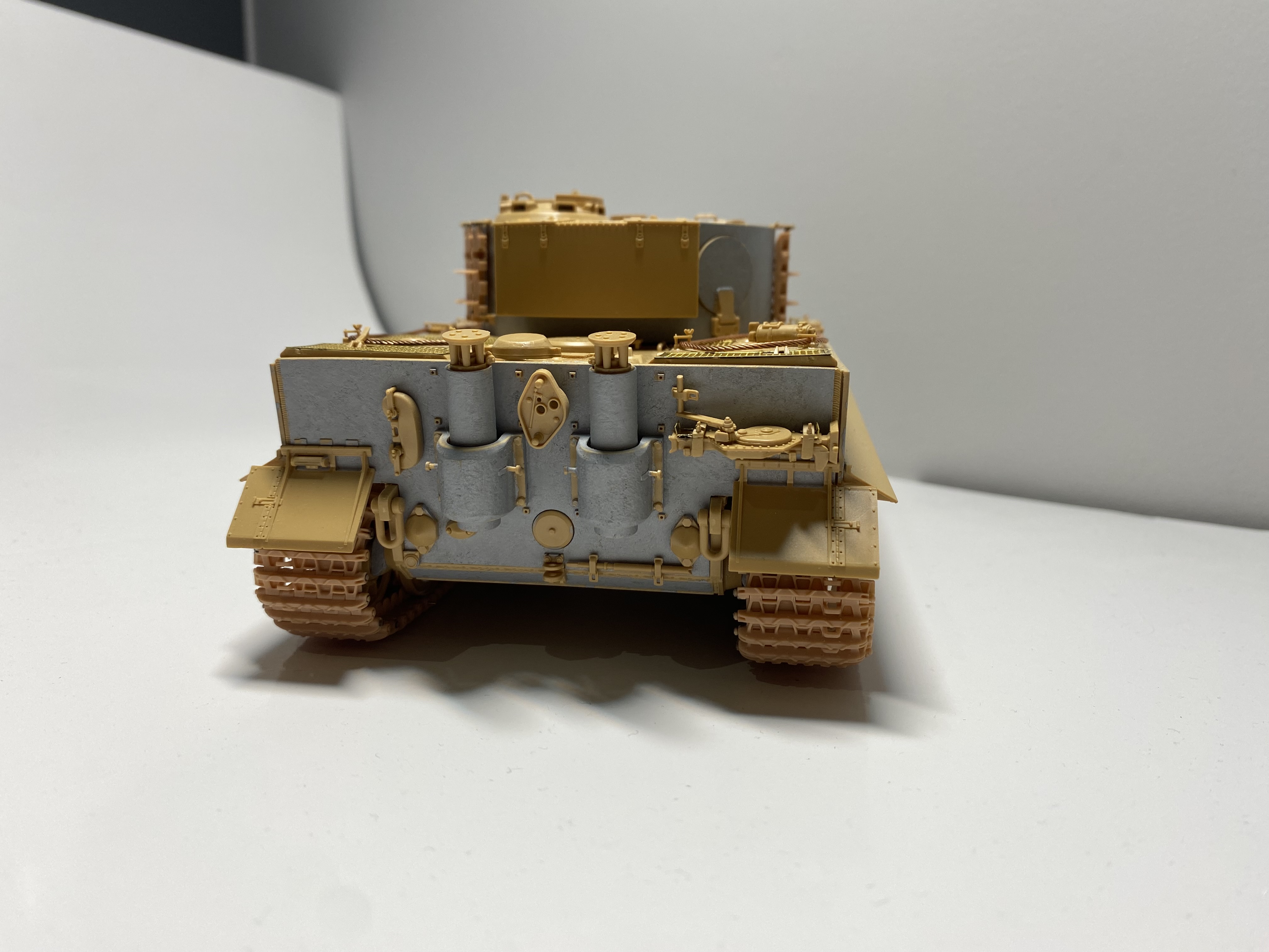

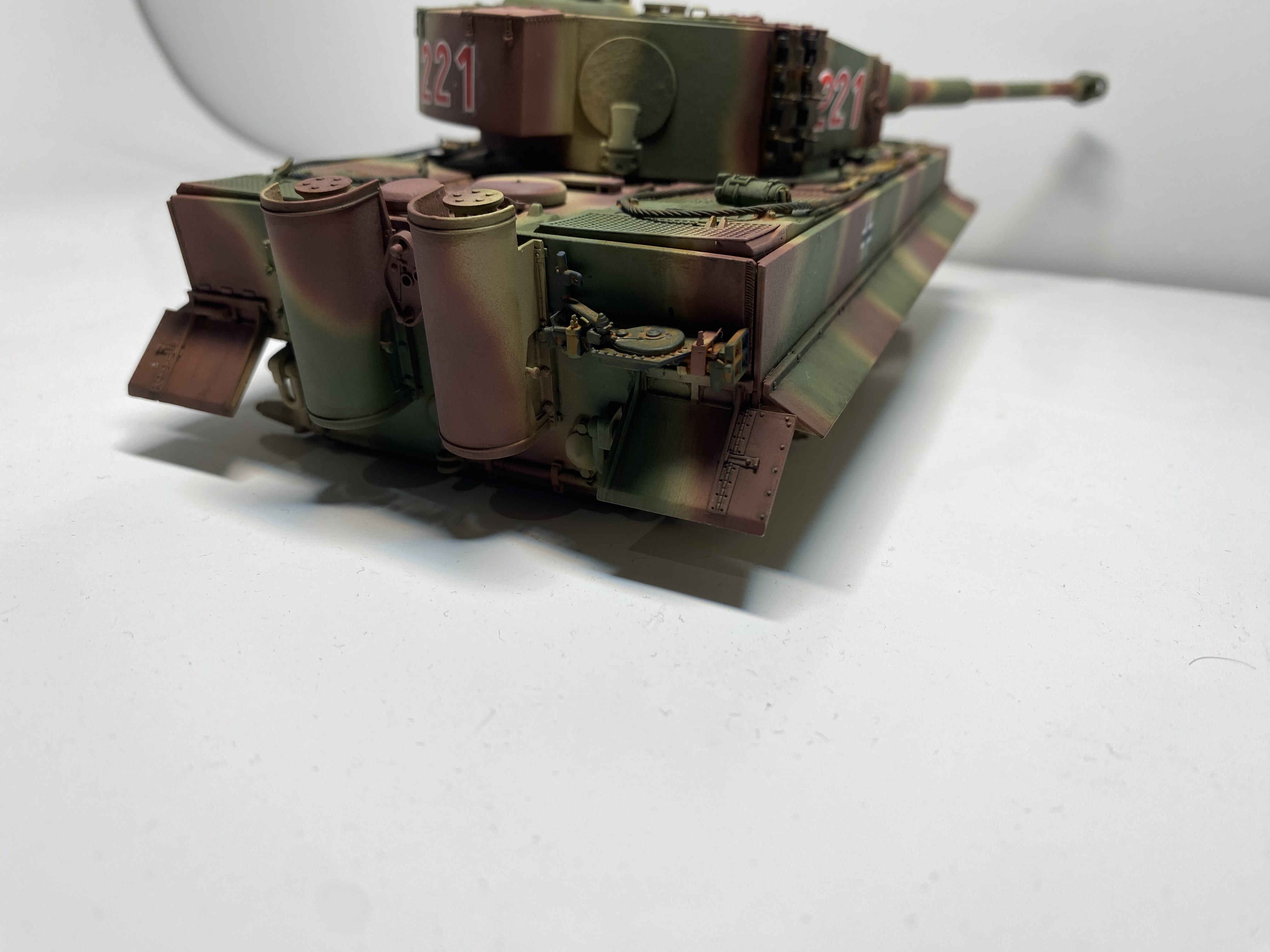

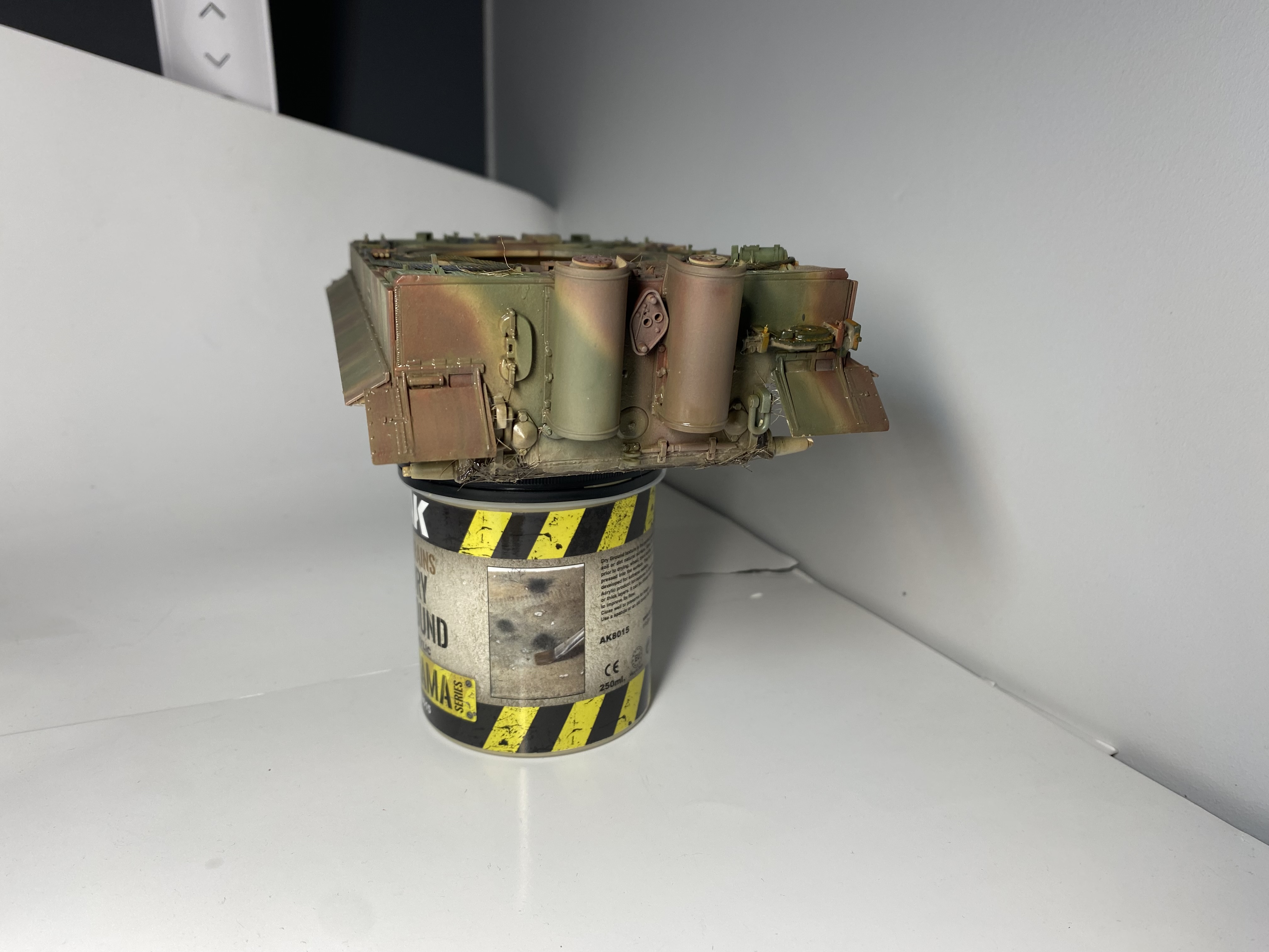

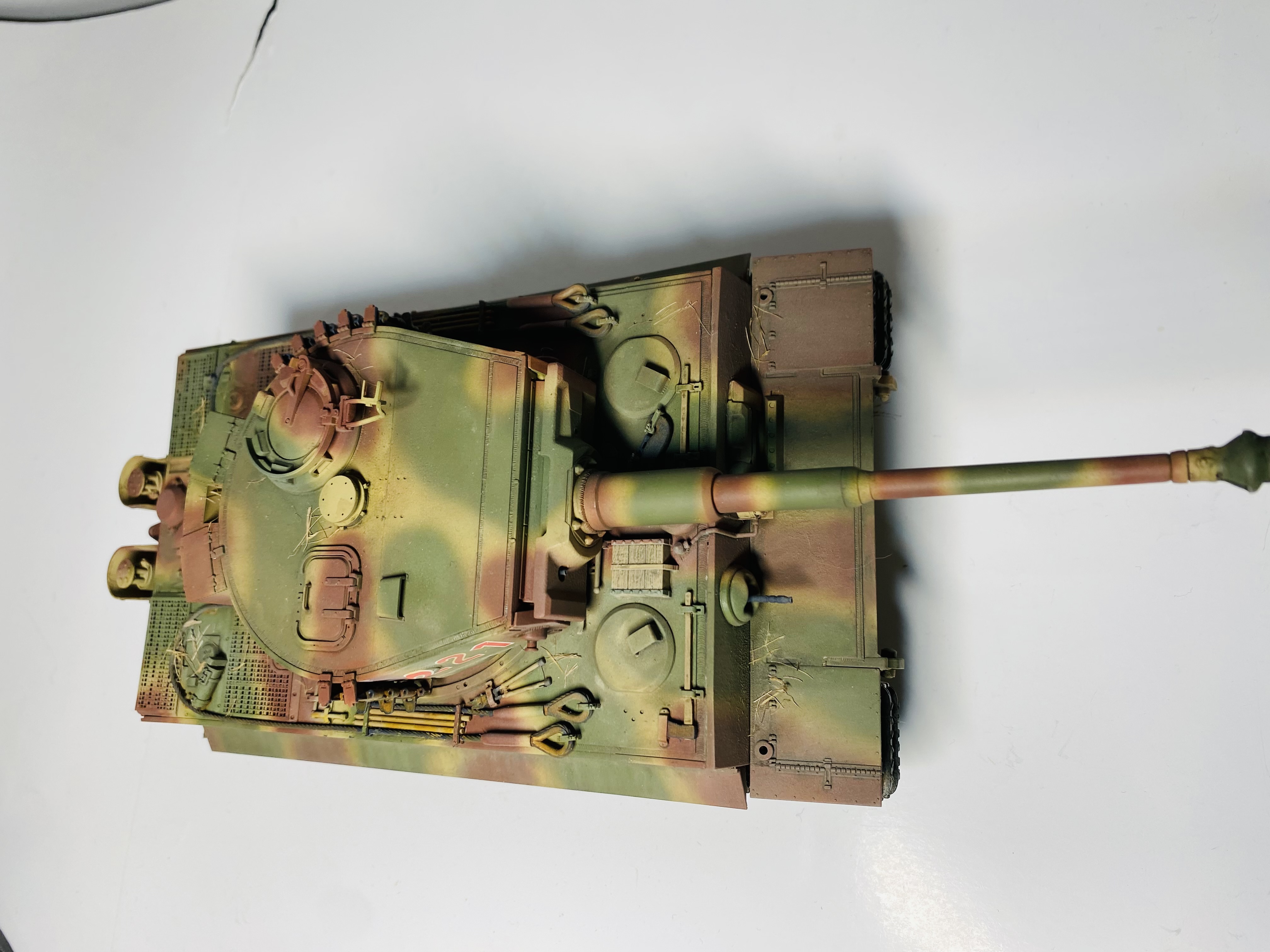

Could we get a shot of the rear & from above?
Thank you.
Yeah sure, here it is. The model isn’t perfect and the kit had a problem with fitting and these radiator claps shouldn’t stick out like that but I’ve heard that it is common issue and dragon has the same.

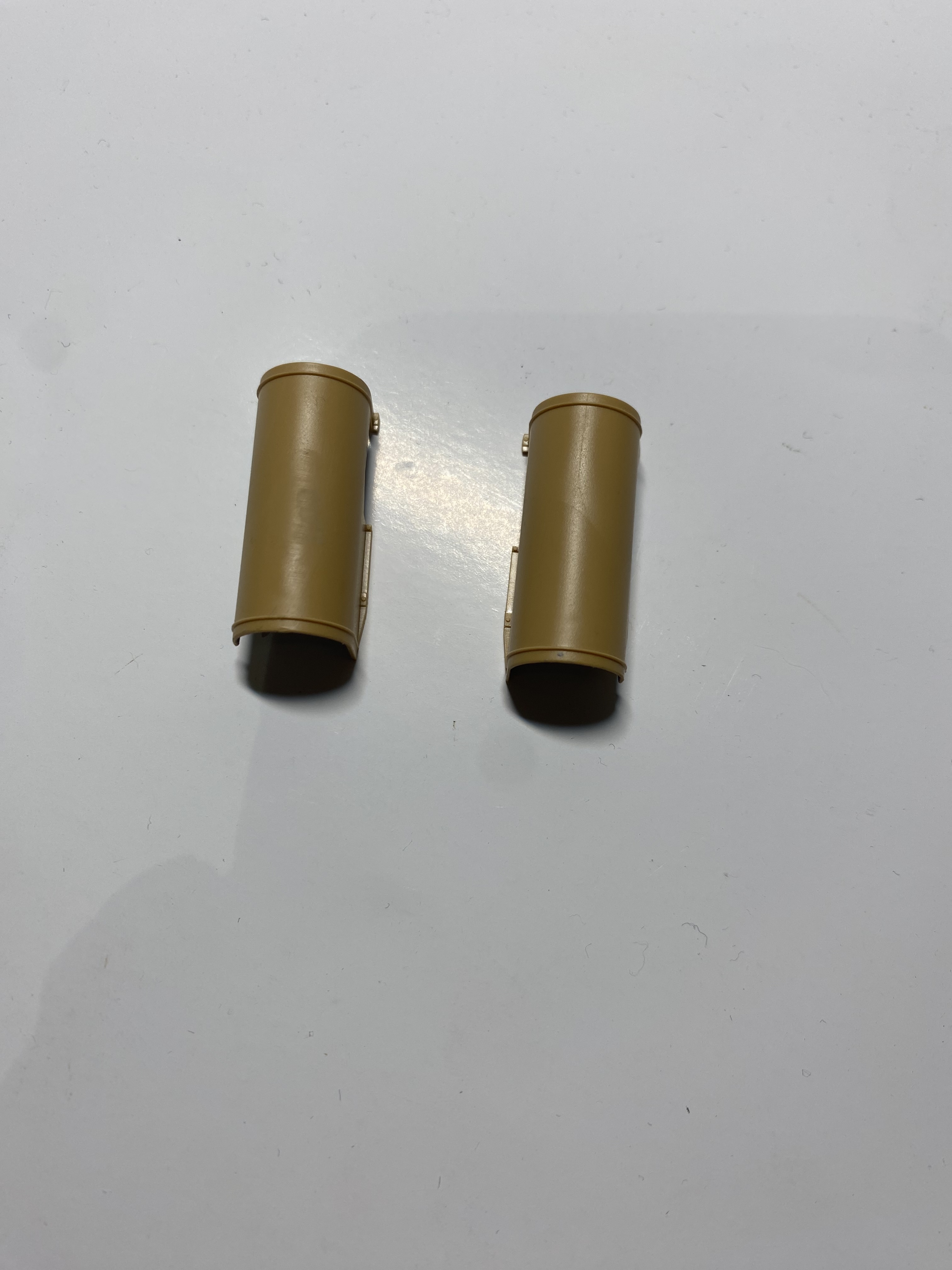

These parts are made of 2 element unfortunately in my kit they were wrong casted and don’t fit together so I will have to figure it out somehow, maybe I will just skip this detail and use putty

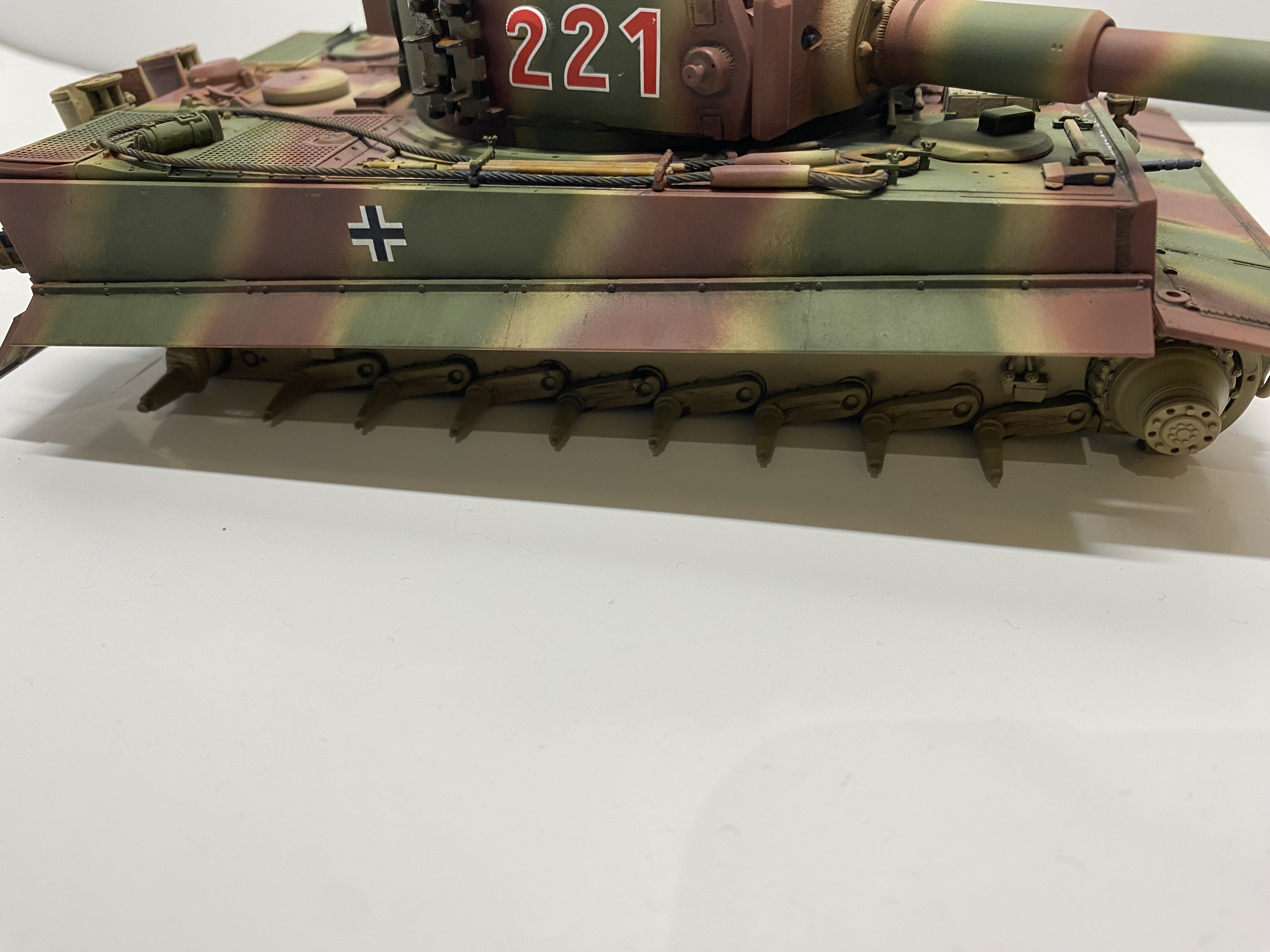

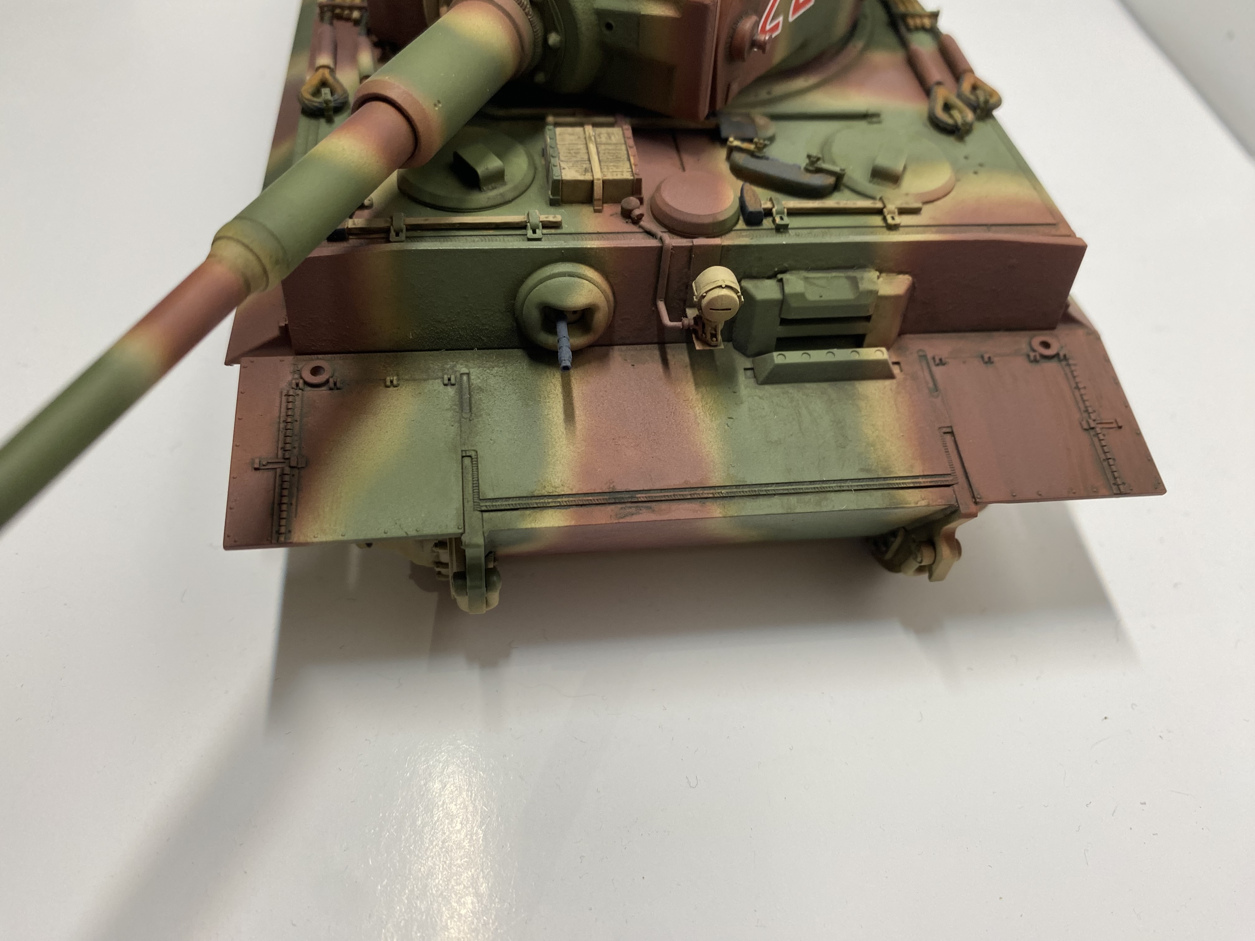

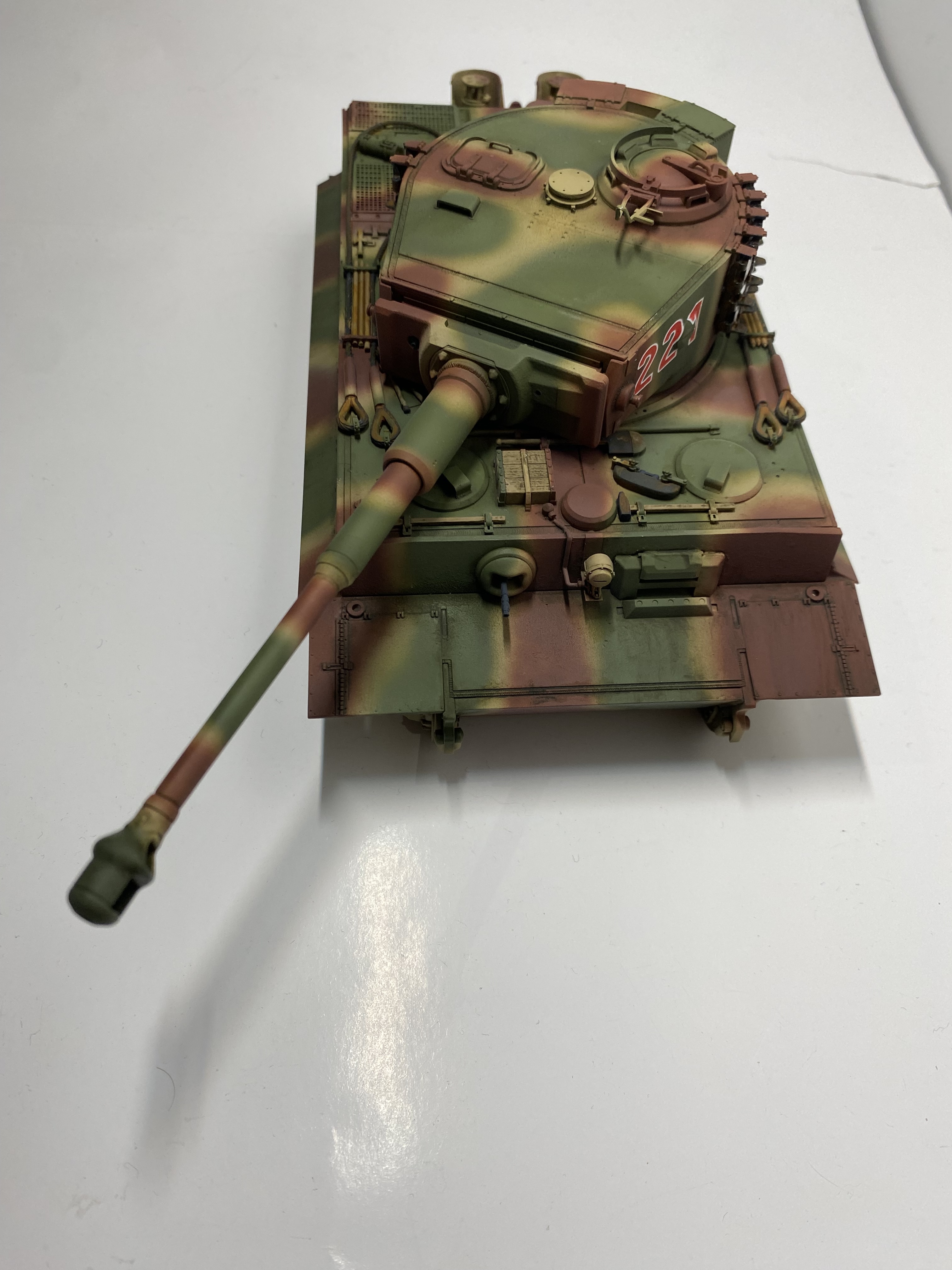

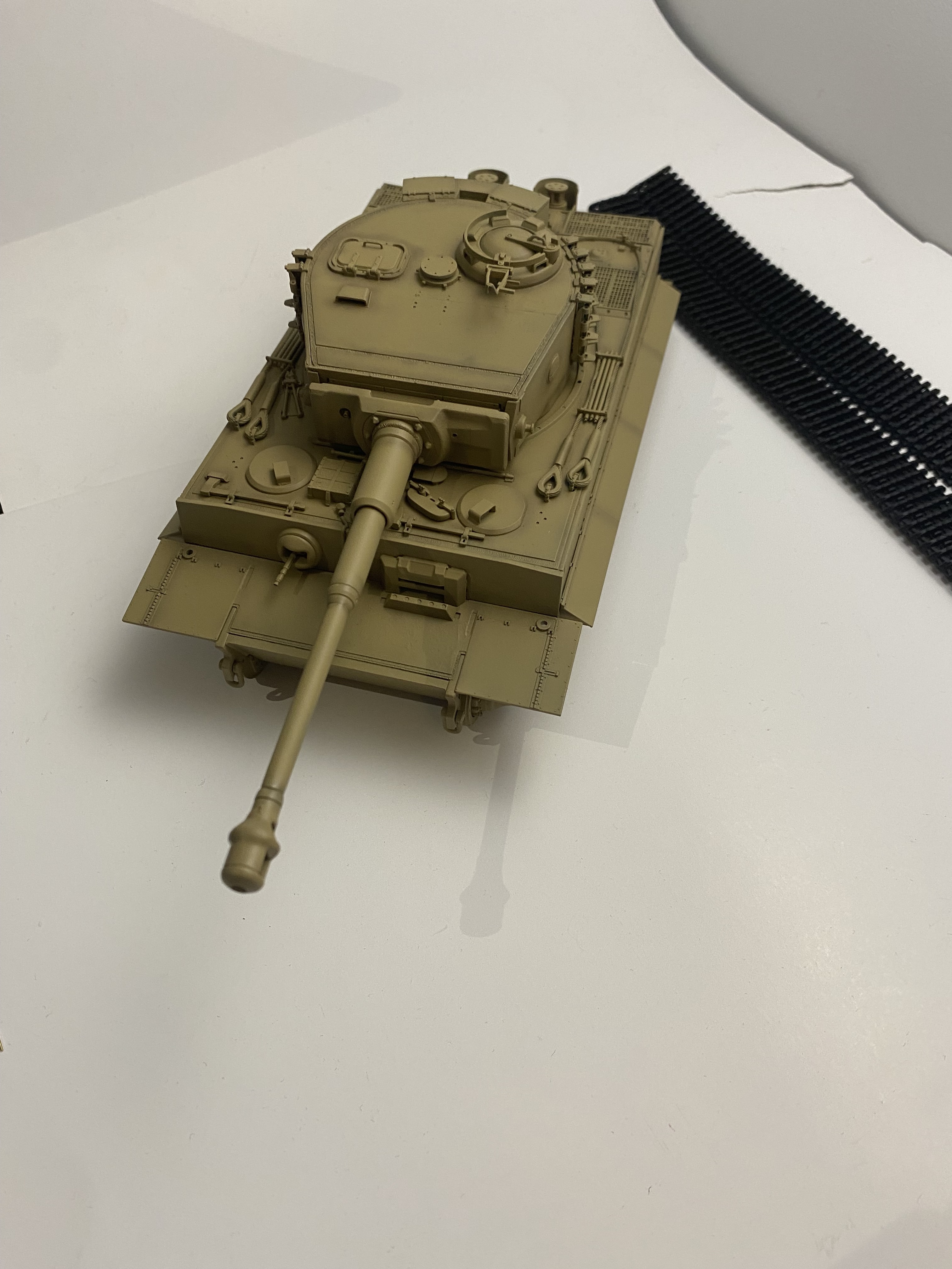

Tiger got some paint. As a primer used mr surfacer 1500 black and base coat ak rc060 dunkelgelb. Ammo shader grime for shadows

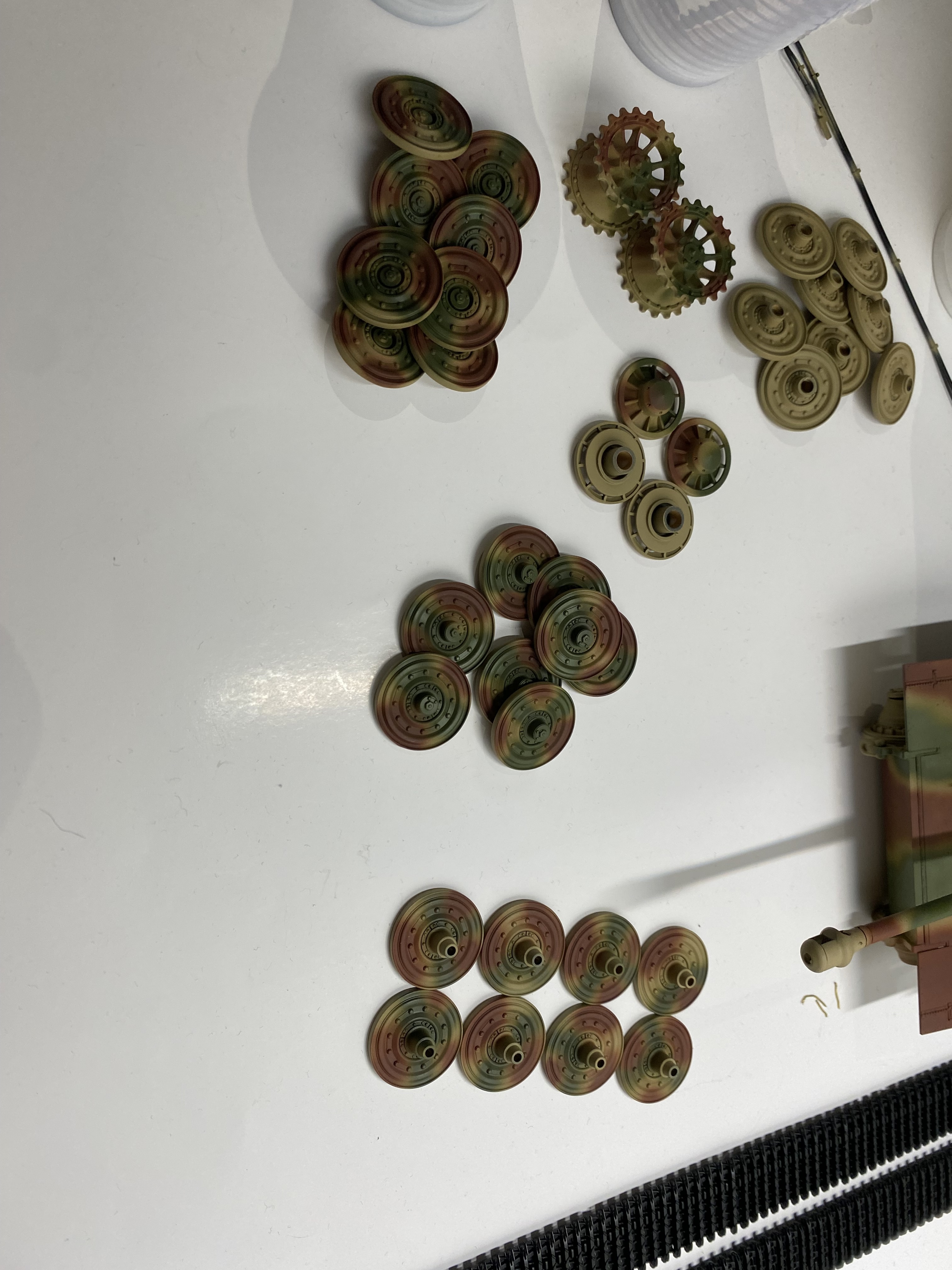

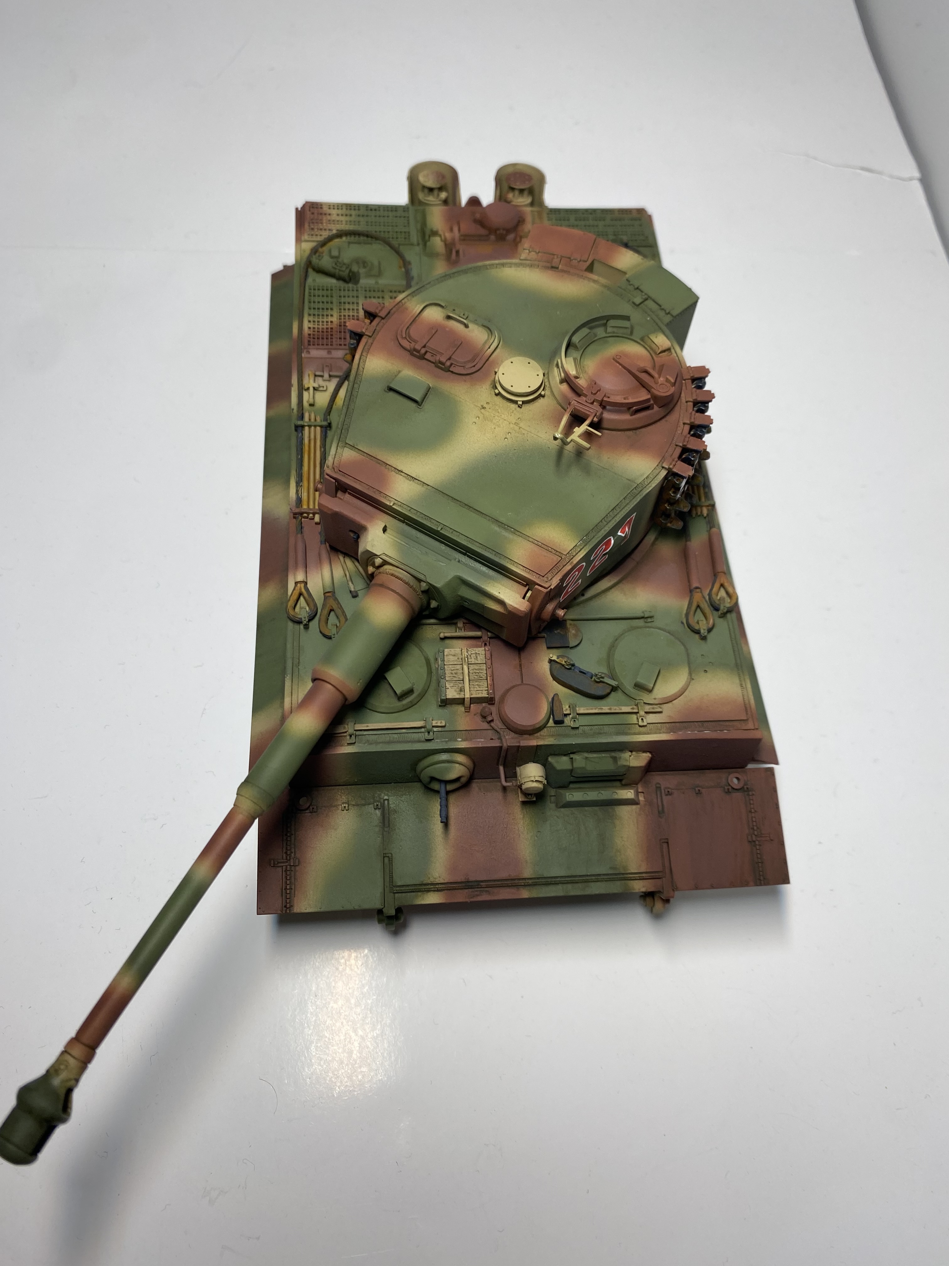

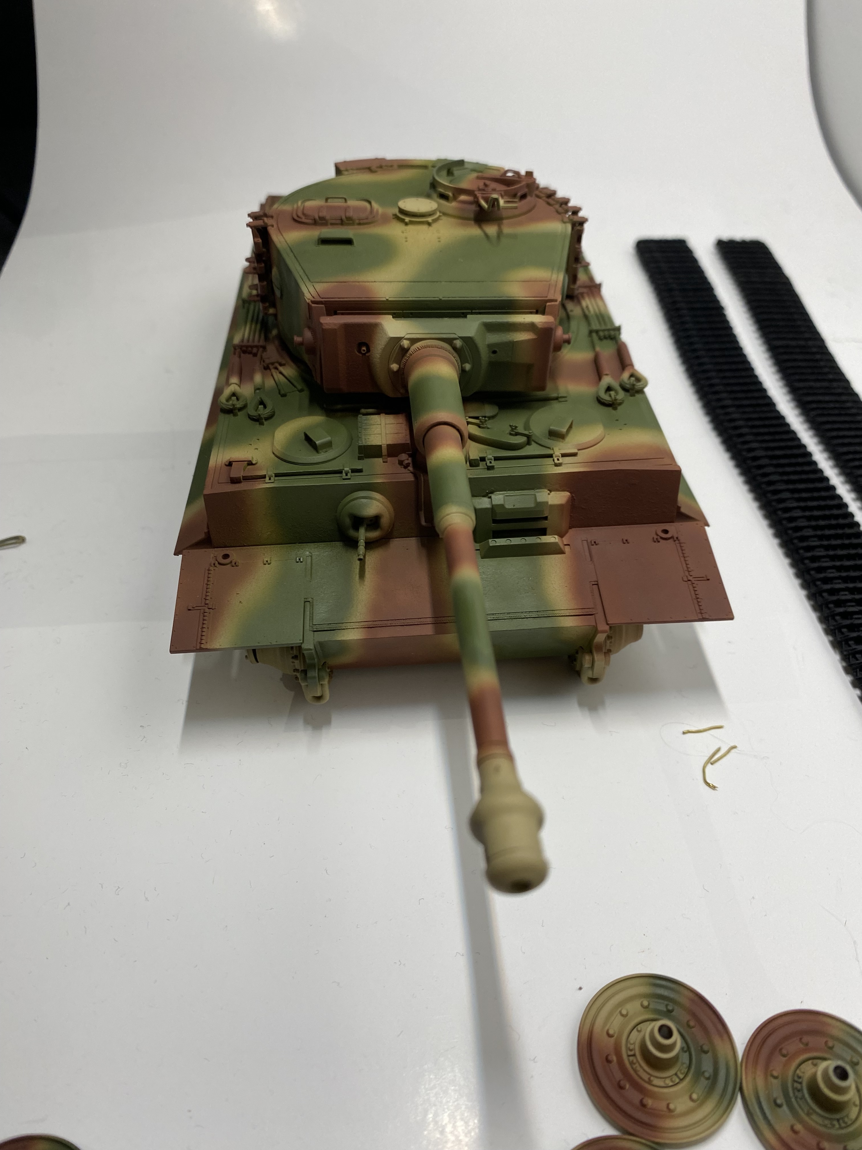

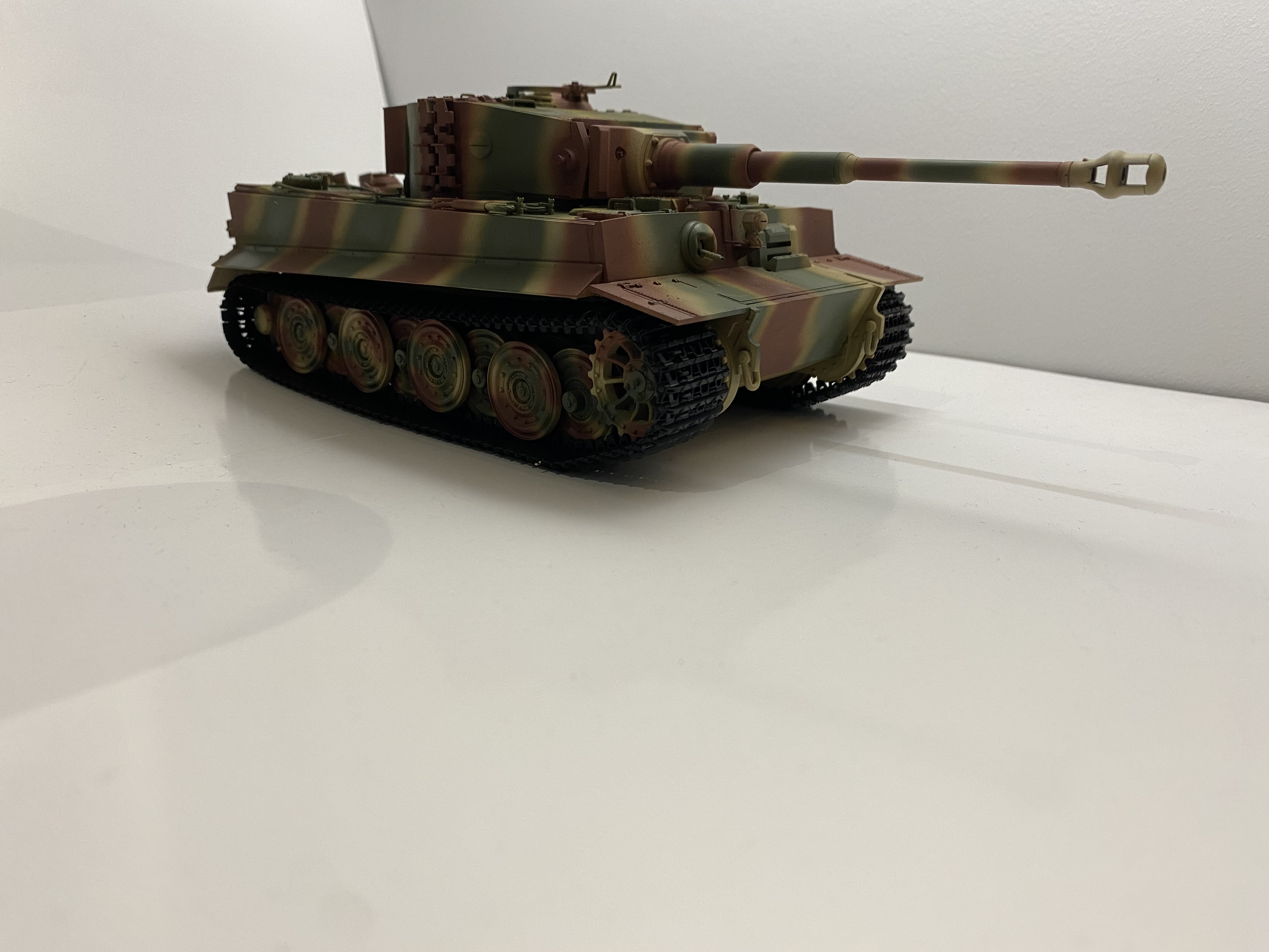

Tiger got some camouflage
Second time making camo in my life
Lightened the camo a little and change its pattern in some places

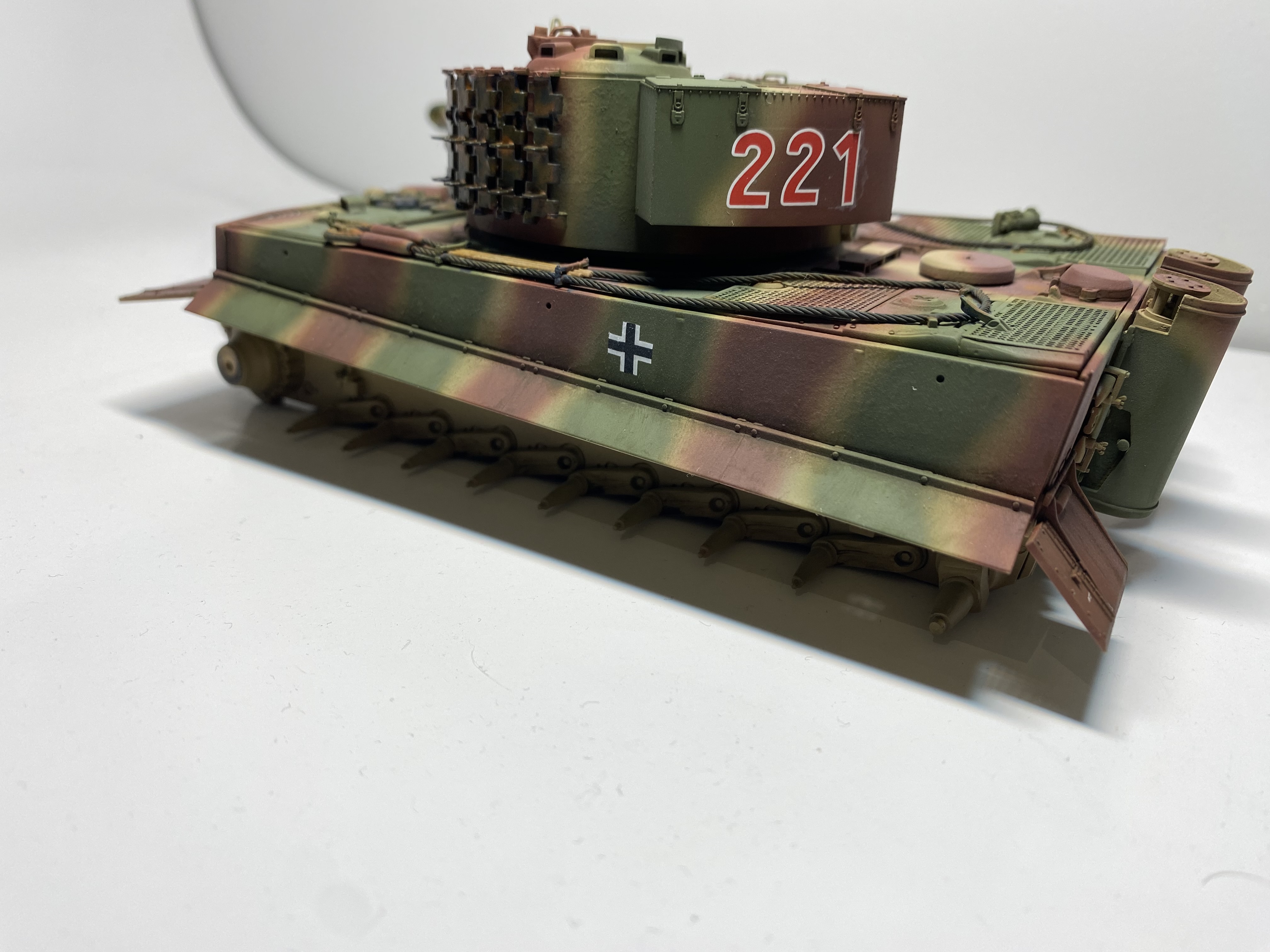

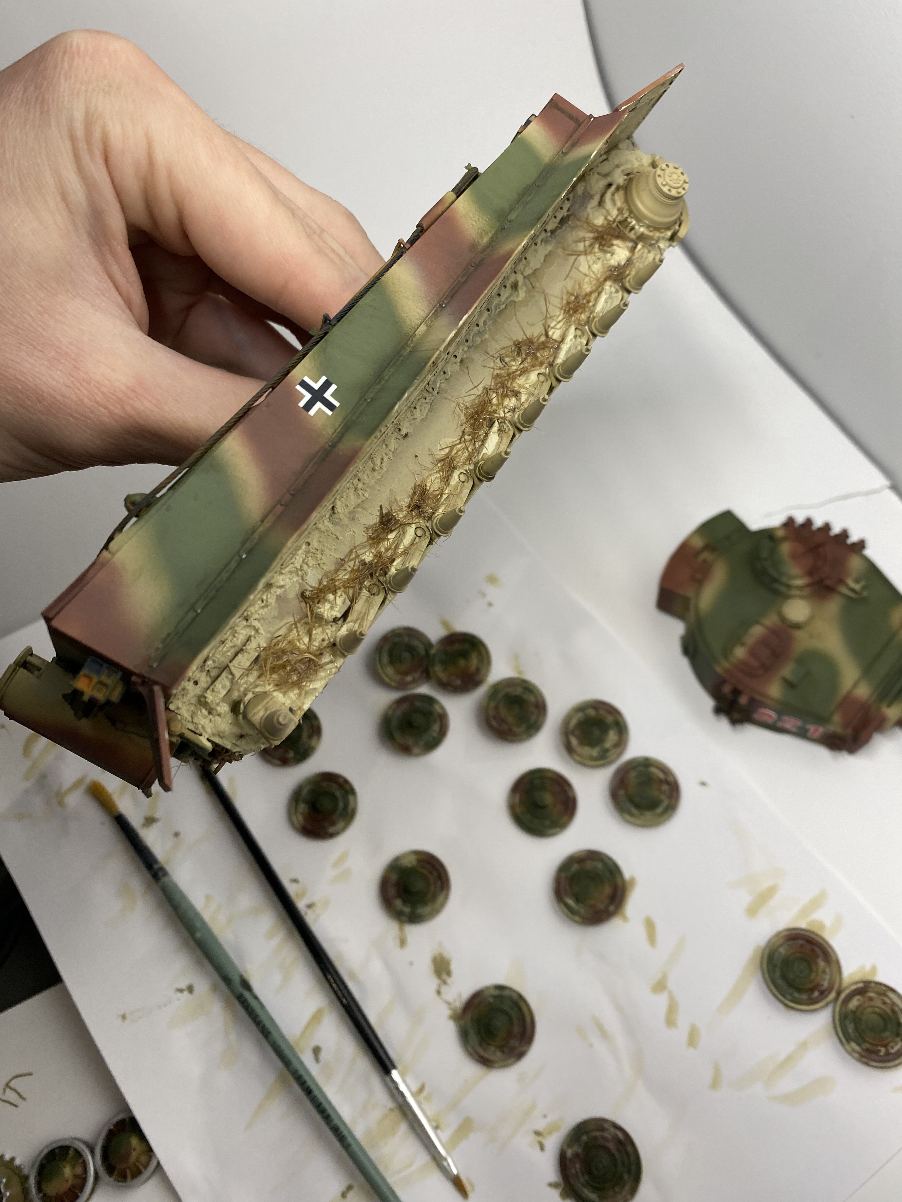

Painted details, used some pinwash and did a little weathering with the oils. As I said model is not historically accurate because of lack of zimmerit, markings are historical and colors of the camo are also historically accurate but the pattern isn’t.

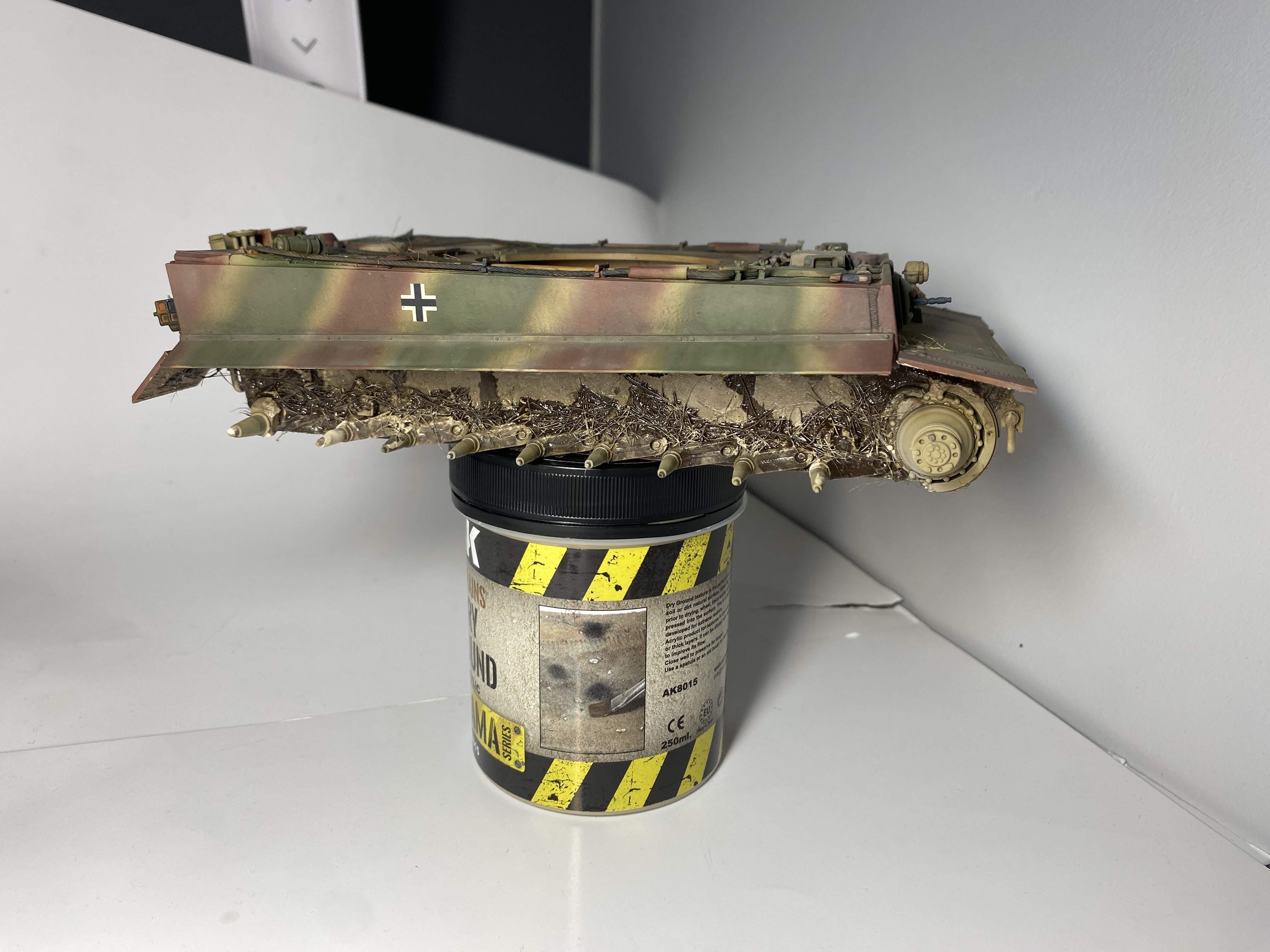

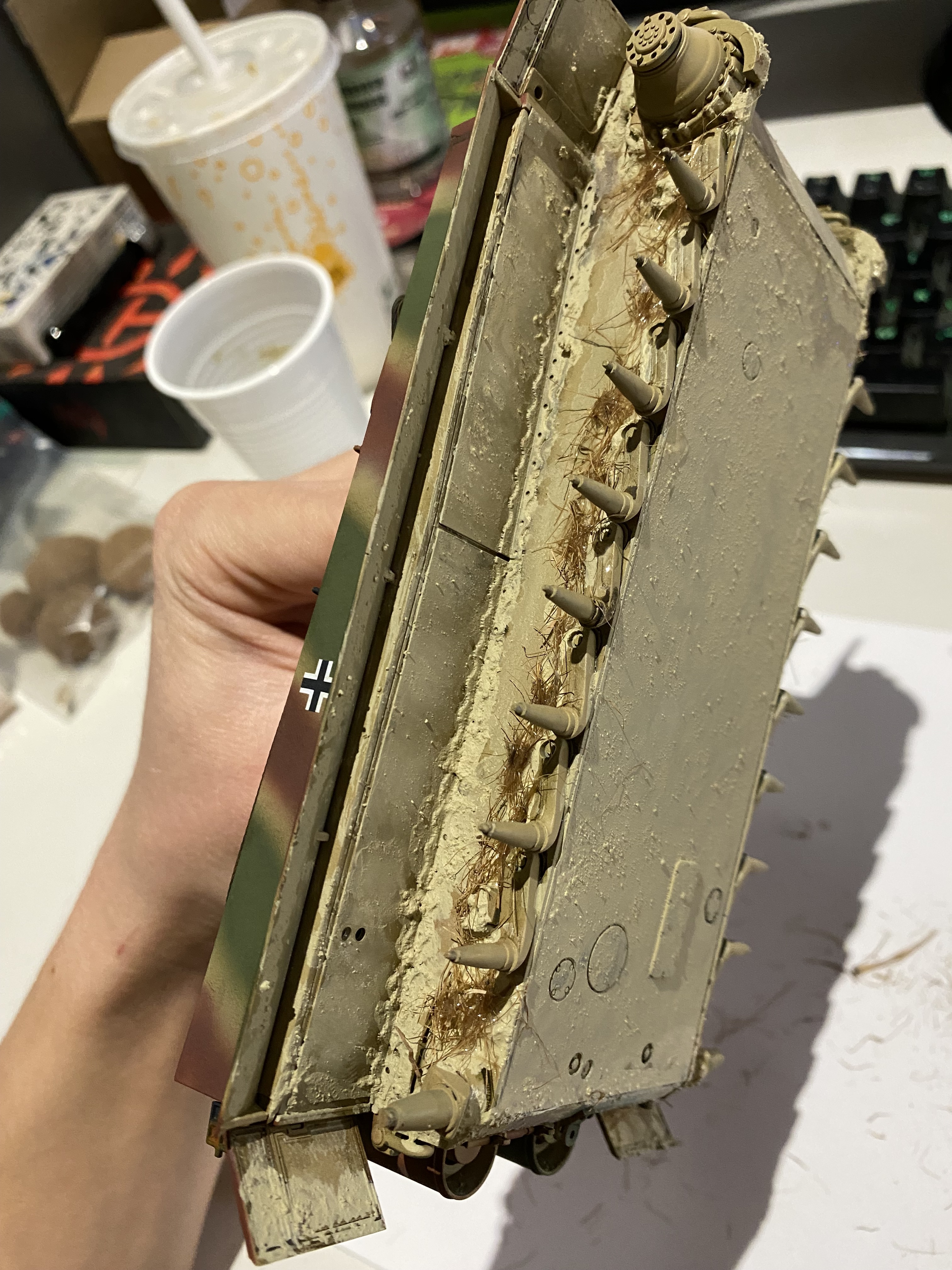

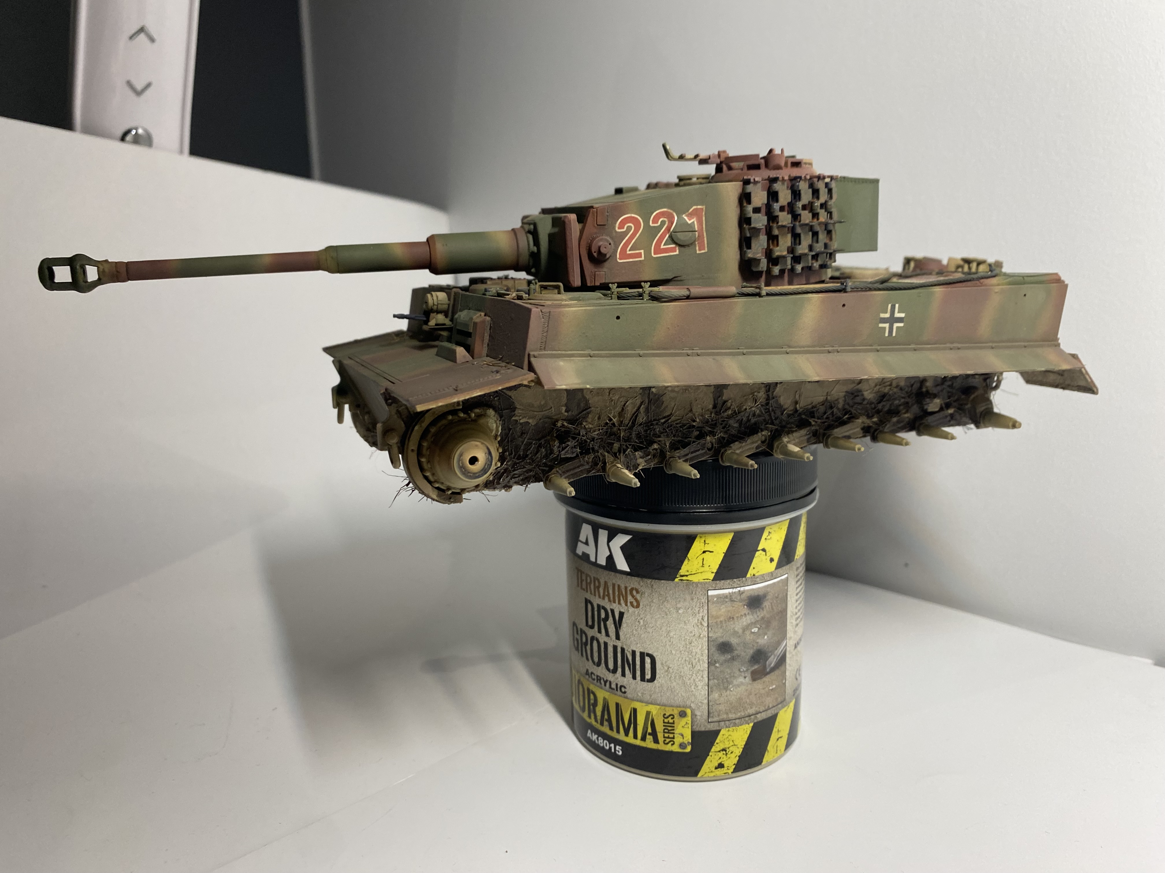

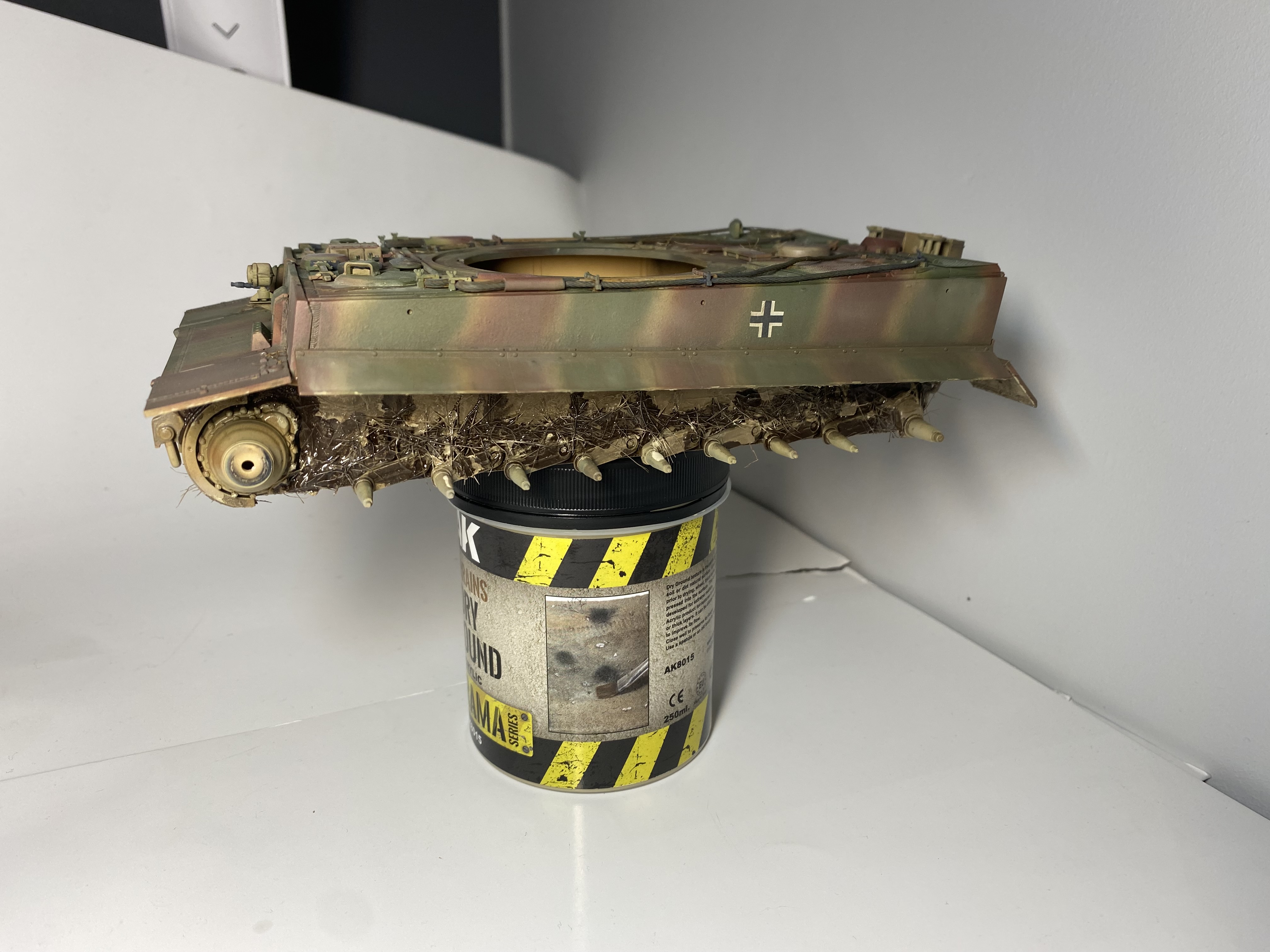

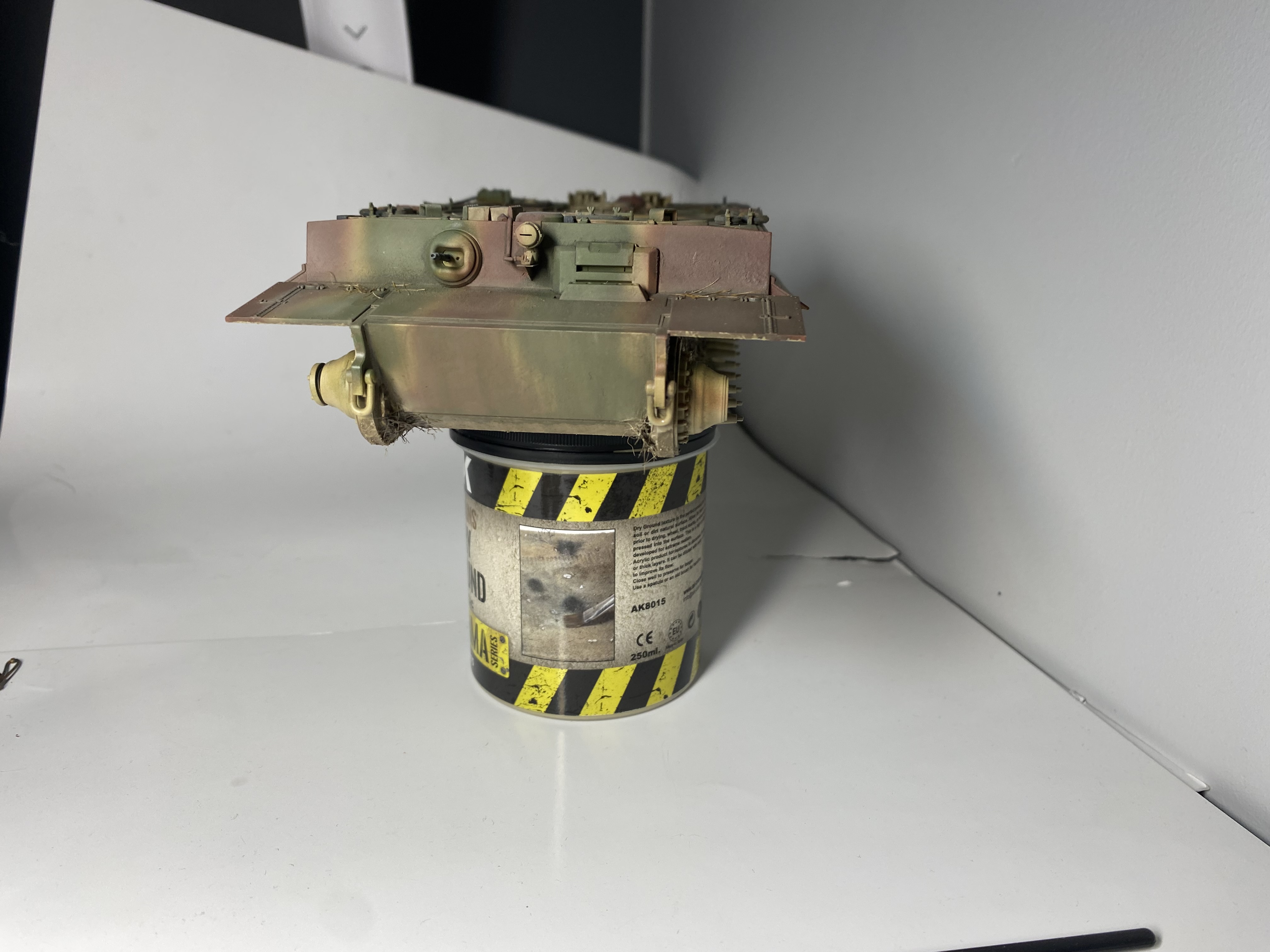

Started weathering using ak acrylic dry ground and some grass also from ak. For now it doesn’t look the best but I hope I achieve same effect as nightshift on his jagdpanther

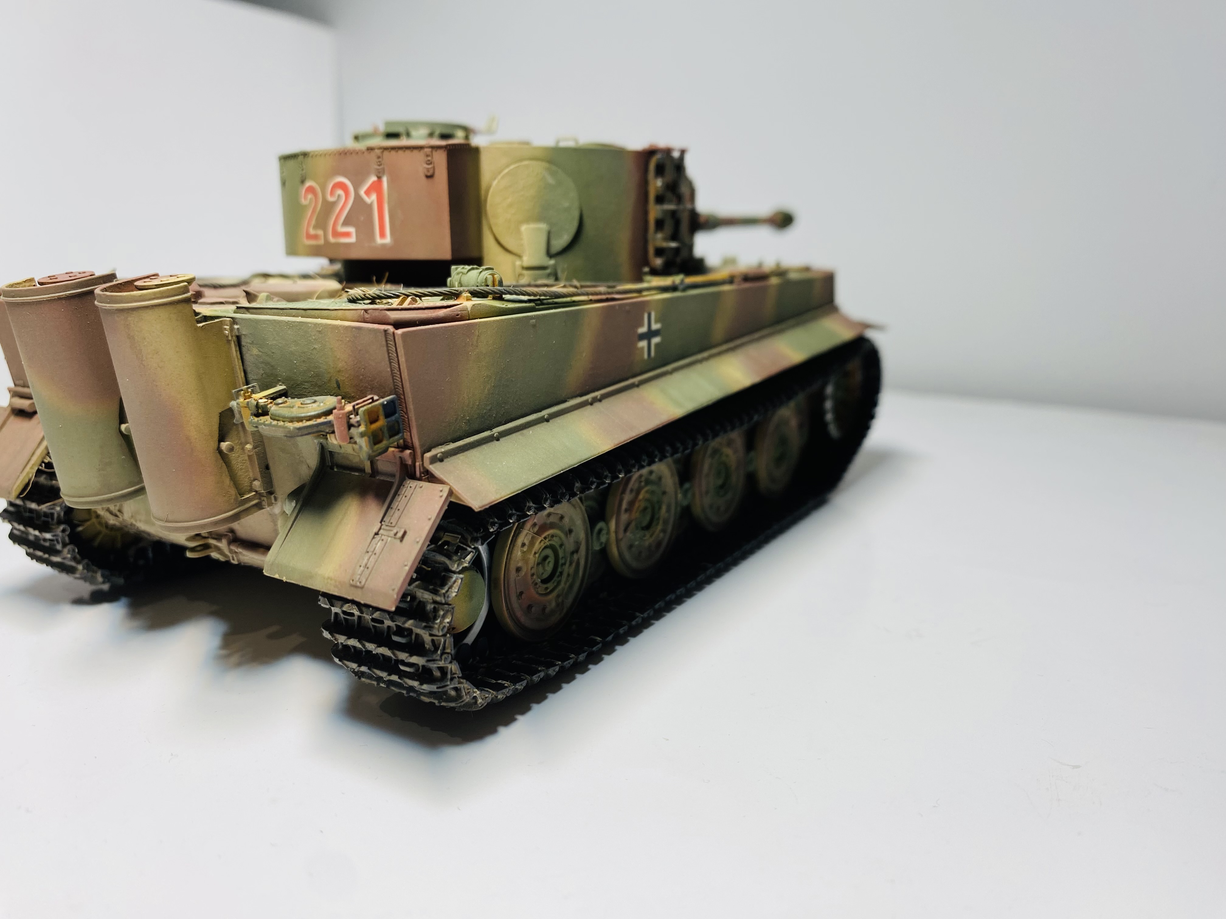

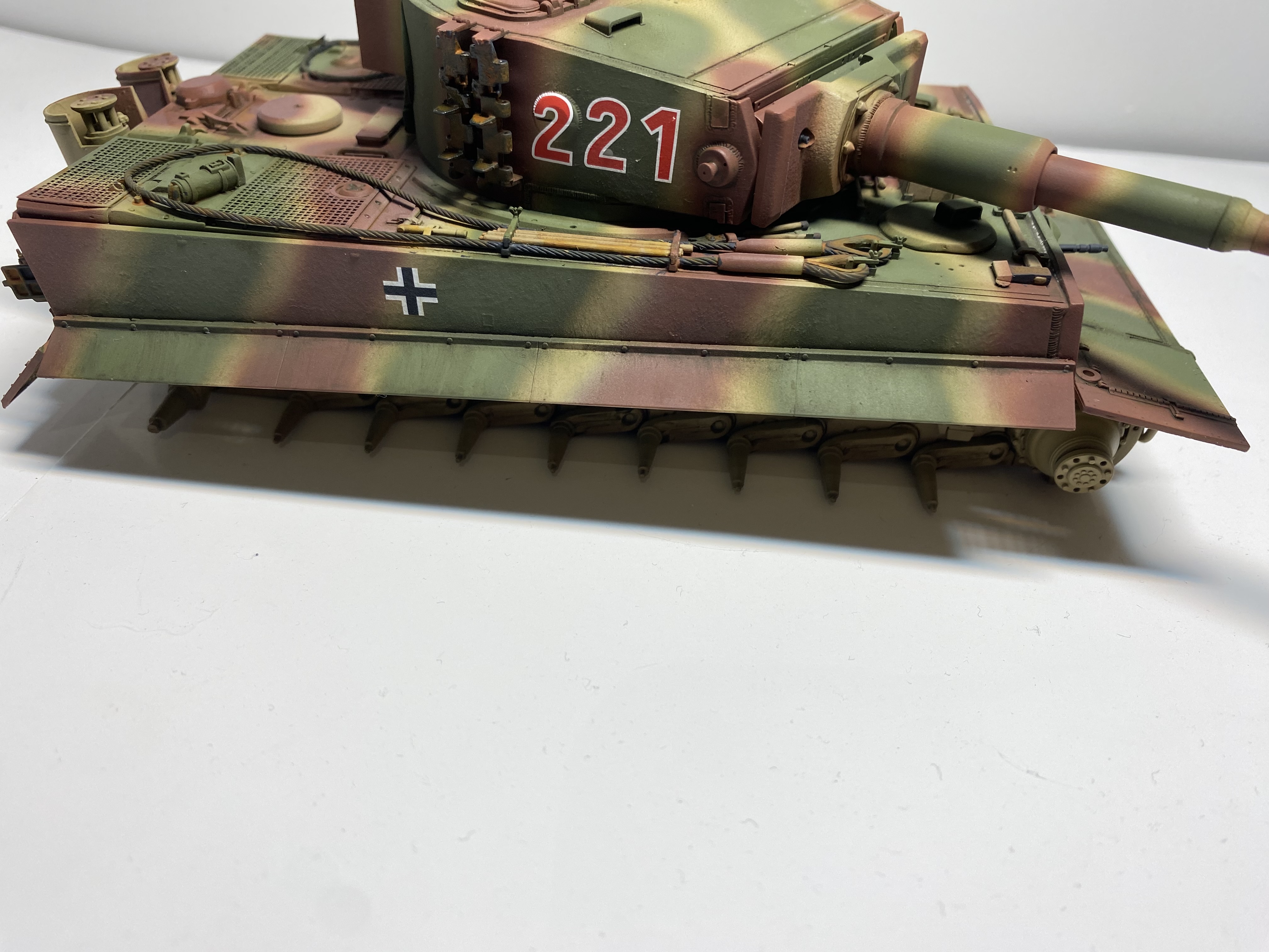

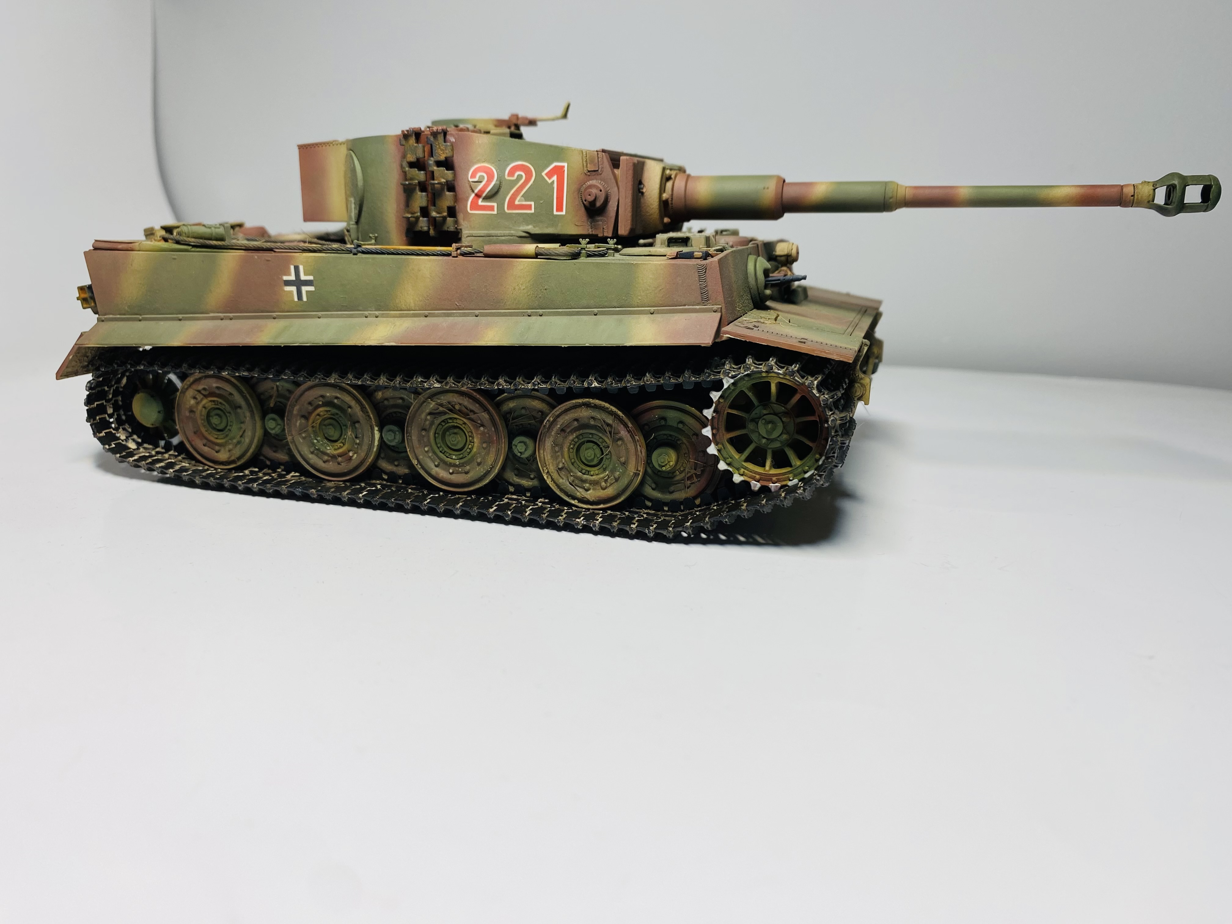

Finished hull and turret weathering, only tracks are left and varnish over whole model. Yeah the final effect ain’t the best but I’ve been modeling only for year and don’t have much experience since this is the third model in which I’ve done something more than just wash.

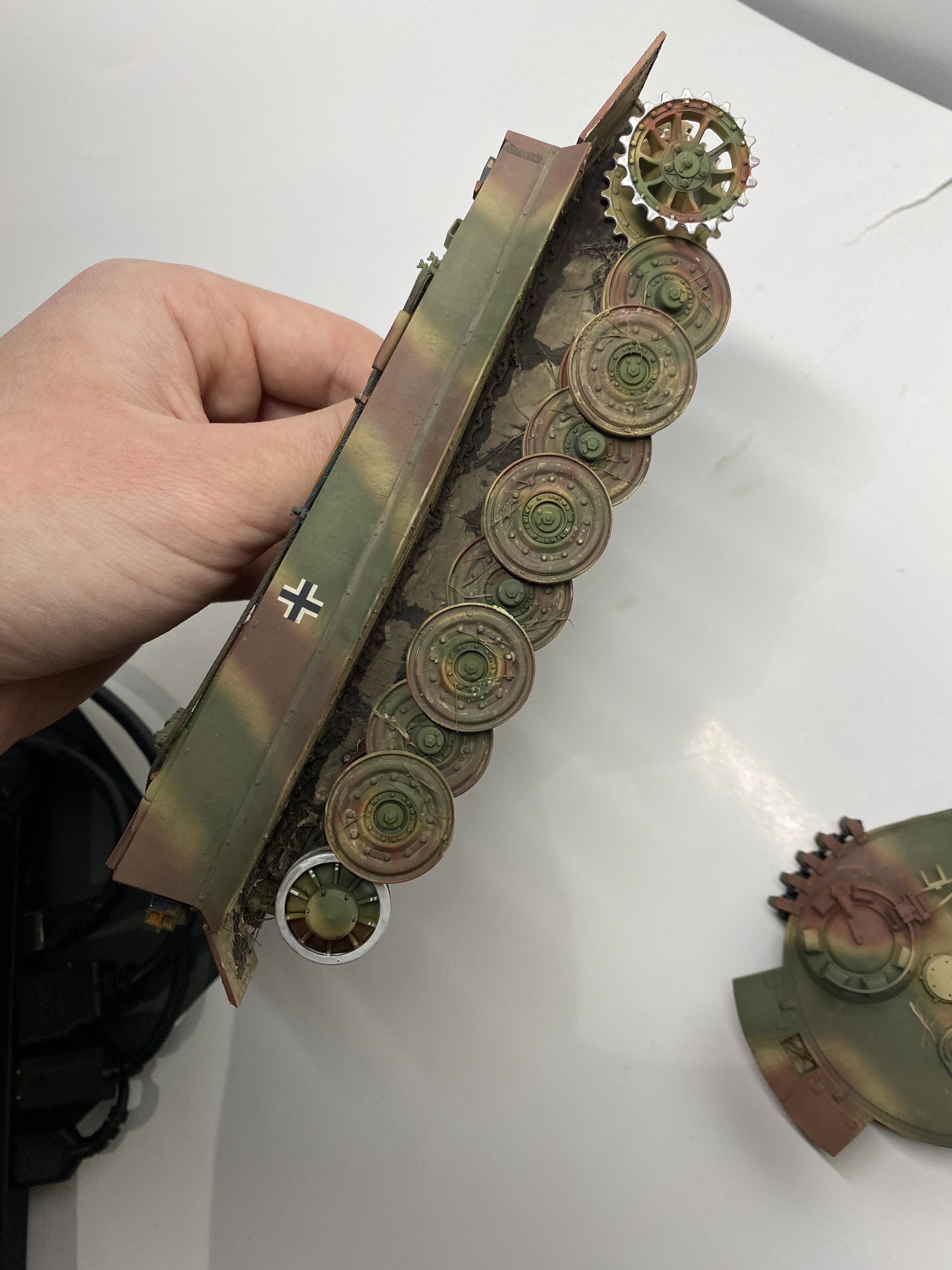

The chassis looks like that for now
Just a tip, you could try blending the mud effects so that they transition a little bit better with the dry mud. The leaks/streaks could be pulled down with a flat brush moistened with enamel thinner/white spirits. Overall, though, your model is very nice, especially for someone who’s only been doing this for a year; it looks better than my first models when I started a few years ago. Great job!
Edit: if you aren’t using enamels, but acrylics instead, just try using some water and working fast and in small sections so you can blend it before it dries.
Thanks for the tips. By transitions you mean the mud on the side skirts and side hull or lower hull?
The lower hull.
I would also recommend some light dust speckling on the front and rear parts of the hull, and on the fenders, and lighter colors for the mud staining on them; for this model I would thin down the acrylic mud paste and blend that on the fenders and use it for speckling. Darker speckling would help on the lower hull; Night Shift does this on his newer videos if you need examples. Hope this helps!

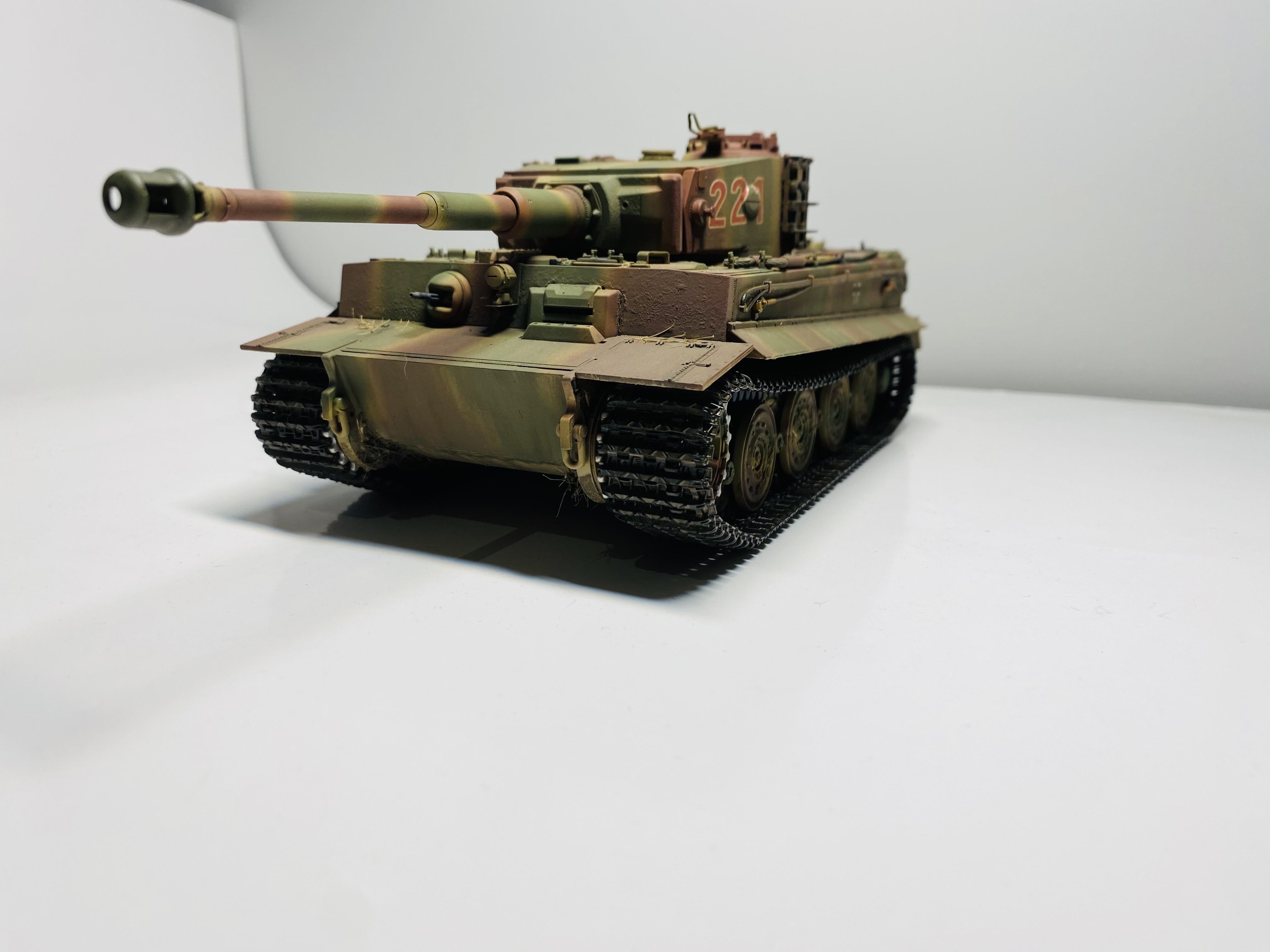

So for now the tiger is 99,9% completed. This model is peak of my abilities so far but I will for sure improve it and change few things as soon as my skills improve. It’s time to give up working on the tiger for a while and focus on the new project I’m starting soon.
