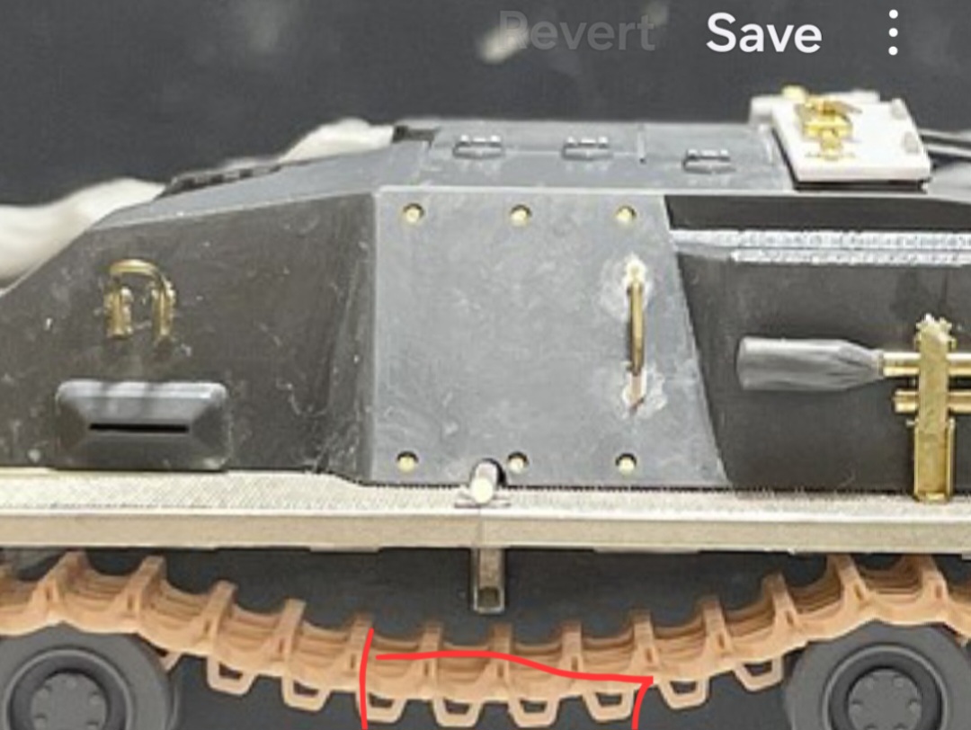

Too much sag?
Too much sag? I’m very undecided…. I feel like it’s borderline but just okay….
That’s a bit personal mate! It happens when you hit a certain age! :grin:
Ref the kit’s sag, it does look a touch dramatic but only a touch.
Looks REALALISTIC
I’d say that’s at the far end of acceptable by the platoon sergeant. I don’t see that much in period photos.
IMHO it is way too much. I would go for half of that sag.

IMHO it’s asking for a thrown track. Take one link out and it would probably be a lot better — maybe even two?
Just a bit to much … Crews would be on top of track maint as they know what a thrown track could lead to. Tightening a track only takes twenty minutes or so for a good crew so it wouldnt be an issue to get it done
Too much,look at pics of the real thing,not pics of models,most are tighter.
Google AI says “The amount of sag is typically between half and the full depth of the return roller.” As Anthony says most photos of 1:1 show a tighter track. I would agree most seem to show a much tighter track. If you have a photo your trying to match it would be interest to see to compare.
Looks ok to me. As long as it’s standing still.

I will see if I can remove a link to improve the look - these T-Rex tracks are pretty fragile though, so wish me luck removing a link!
I would say take one link off and dial it in if possible. Looks a bit too much IMO.
I’d take out two links. Then should be perfect.

My understanding is the track guide tooth can go as low as half of the return roller but that is the absolute maximum. There might be an occasional exception but that’s one where the track tension needs adjustment ASAP, in my opinion.

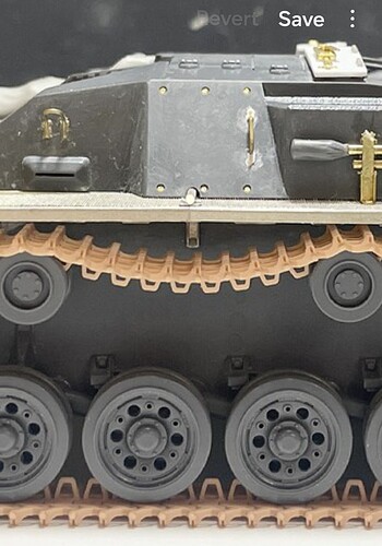

Between the 1st return roller and the 2nd return roller:
If we chop the picture as shown below we can see the guide teeth are too low. They are about 2/3 to 3/4 the depth of the return roller.
This section has too much slack in my opinion.
Repeated for the 2nd & 3rd return roller, this section is passable. It has a lot of sag but there are pictures of it. Maybe not a lot etc. Probably needs adjustment soon etc.

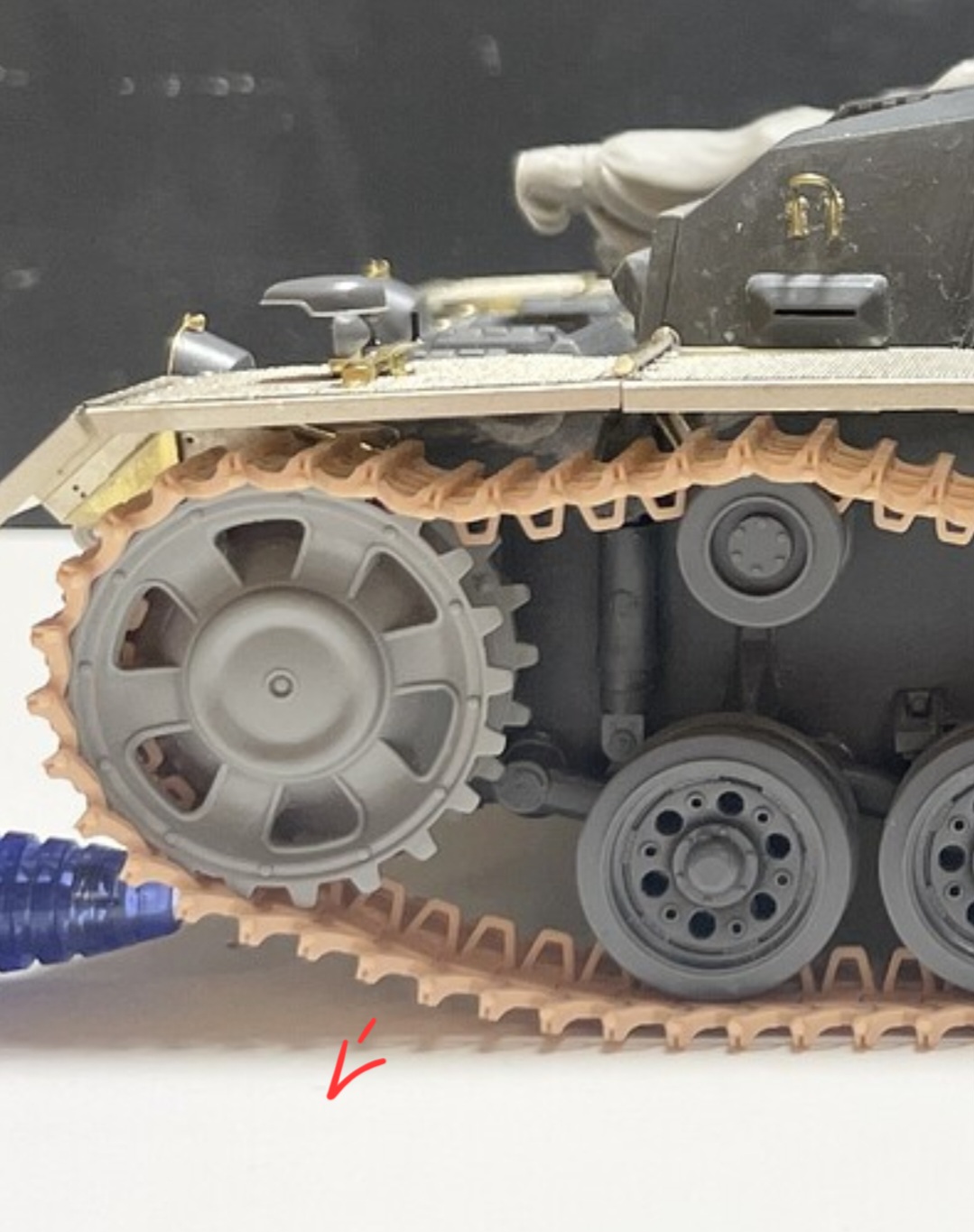

To me for the sag up top, the front & rear below (sprocket & idler) appear pulled very tight.
If one doesn’t want to pull a link, it might be possible to cheat a slight bit of slack from between return roller #1 & #2 to there areas. That may or may not get #1 & #2 track sag to match #2 & #3 track sag.
Keeping that spaced exactly as desired will be pain until the track is tacked in place in my opinion.
I’d pull one link as previously mentioned by others and see if you like that look better.
