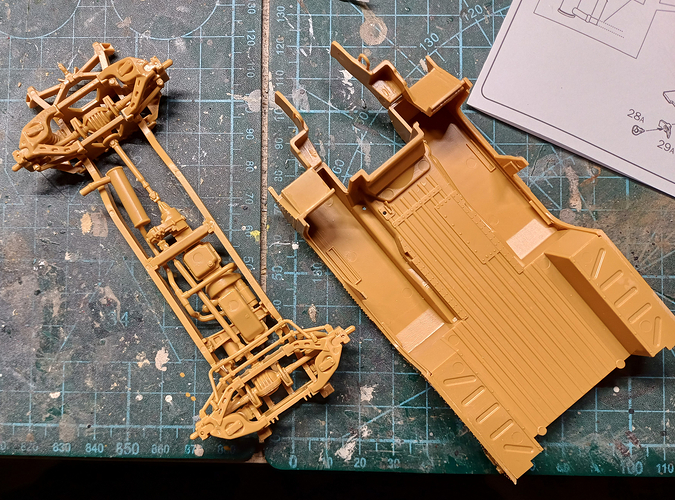

Started these three kits, 2 of them will be for the tough MUVVER campaign, the Tamiya version will be build for the Tamiya campaign.

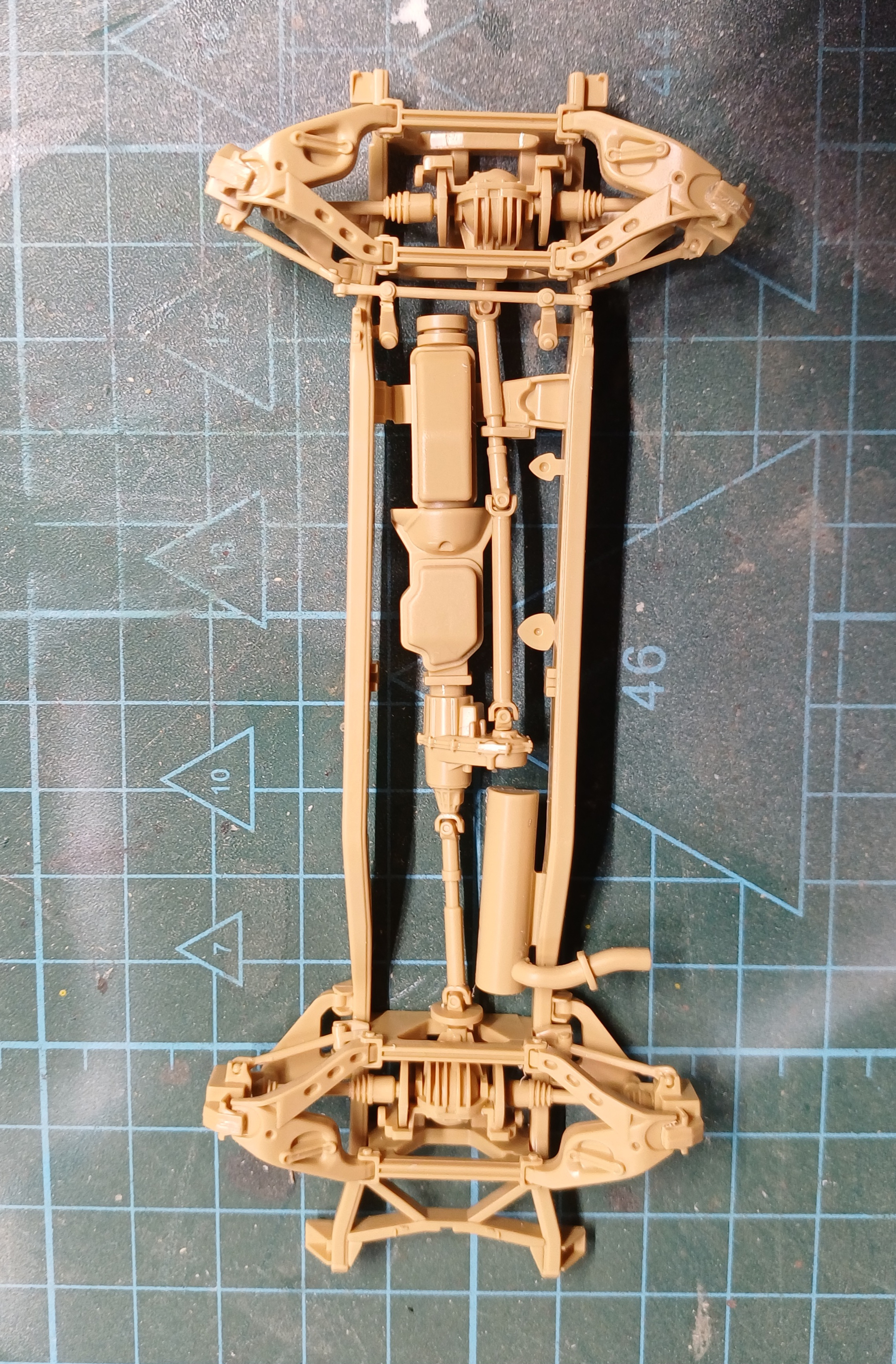

And first bits of the Tamiya are glued…

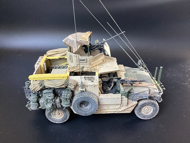

Pig nr.2 is considered done. And a pig of a kit it was! I am not pleased with this one, really.
Fit and detail was not great at all, the MP-decals absorbed the grey wash and the AK-paint was prone to coming off during handling. No idea why? Was it the paint or the plastic?
What did I add: tactical tape to the lights, since these looked bad. I also added a bent antennabase from Djiti Models. Antenna and retaining rope are steel and copper wire. The tiedown strap is maskingtape and the camouflagenet is homemade with coloured bandage gauze and oregane + foilage from railwayscenery. The mud is a mix of gras, leaves, soil and paint.
Very nice. You gave it an interesting look.
I agree about lights, especially semi-circular optics, they should not be prominents
Somehow, it has become customary on modelling forums (and elsewhere) for everyone to praise everyone else. This only serves to harm the author of the model. They assume that it is acceptable and that it does not contribute to the improvement of their skills. In my opinion – and I write this without any malicious criticism – the model looks poor. First of all, because of the mud, which you failed to make. We all started with poor models, and we all have better, worse and sometimes outstanding ones. In my opinion, you need to start with correct, clean gluing of the model and clean painting. Later, you can learn other techniques – damage, signs of wear and tear, dirt and dust, the effect of faded paint, and elements such as snow, mud, and rain-wet surfaces. Take it slowly, try it yourself, watch others, ask questions, experiment. Good luck!
Agreed, it does not look good.
Because of the issues mentioned I lost heart for this one and started using it as a testbed and pushed to finish it, before smashing it into a wall. The only thing I am somewhat pleased with is the camouflagenet.

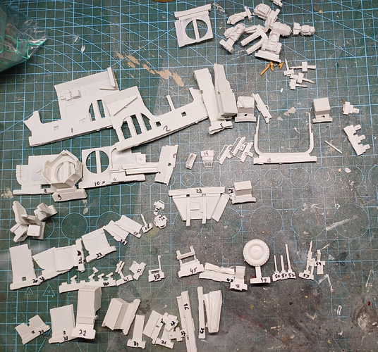

Started on the versions I will make for this campaign, and Ron thought his kit was bad… I buy a lot of stuff second hand, like this Revell one that came with a BlackDog set.. old, brittle, bended resin…
I have it on my shelf. In my opinion, it’s a great conversion. Good luck.
Black Dog is brittle, bended resin right out of the box.
