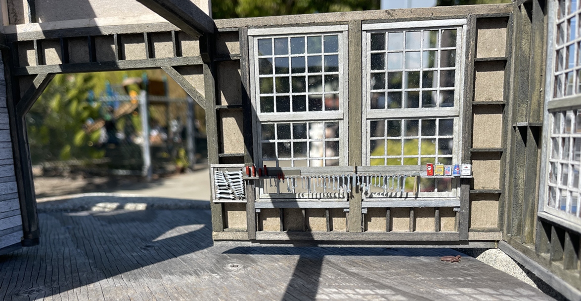

Now, onto the interior, starting with the easy:

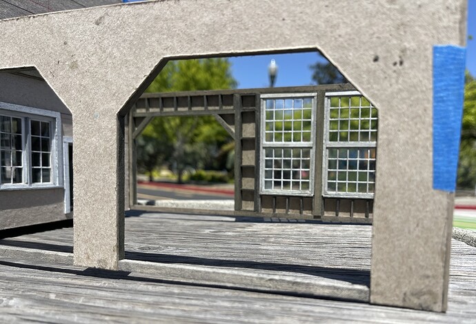

Easy might be the wrong word, as this is not easy per se, but adding framing to the back is something that will be more evident than in the front, so it’s important to do. And, if you skimp out, and fake it, well - guess what?? it’s pretty easy to tell if you do it the wrong way.

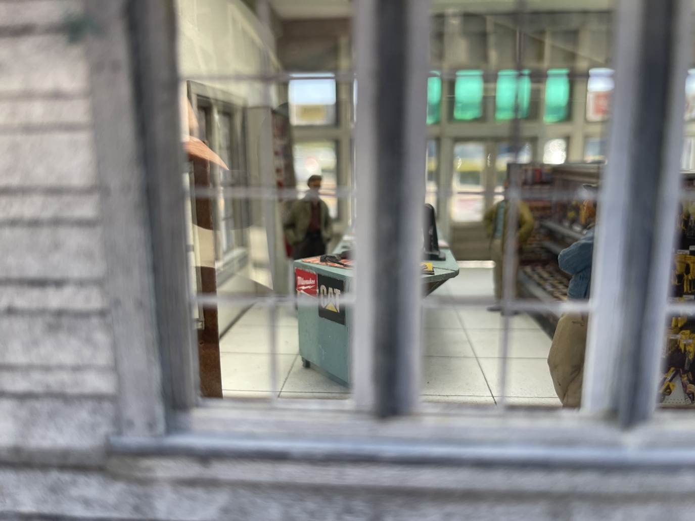

Now, on to the bigger problems, the front. Well, shoot…as predicted, not all that easy to see in:
So, here you go! it’s so easy to see :grinning_face: Except, this image is pretty gratuitous, as it works because there are no (there are two) front doors…perfect, and if you step back somewhat:
Well, you can still see some of it - though, with the doors on, none of it will be seen - which is a bummer - and from the side door:
Perfect! except, the side door is not installed either :man_facepalming:

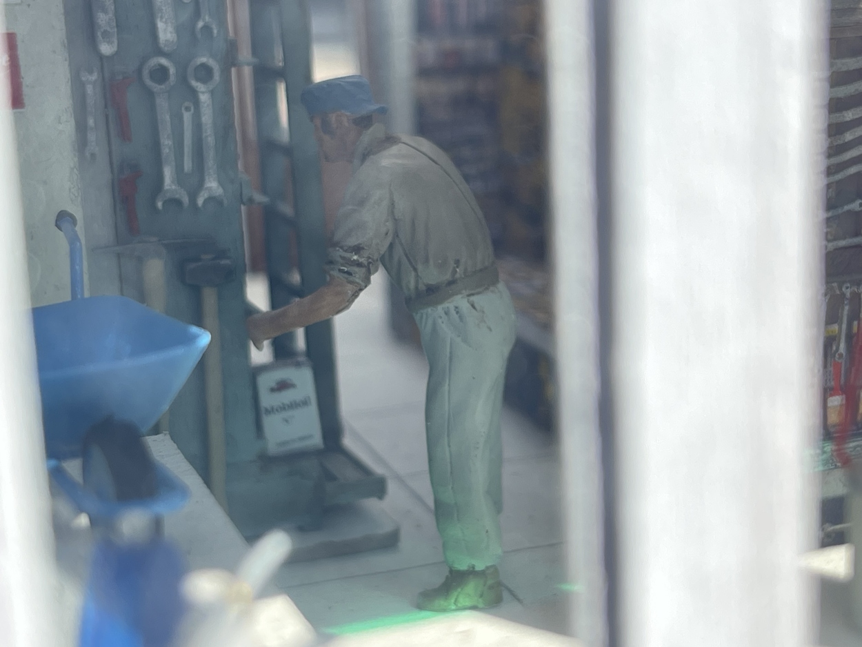

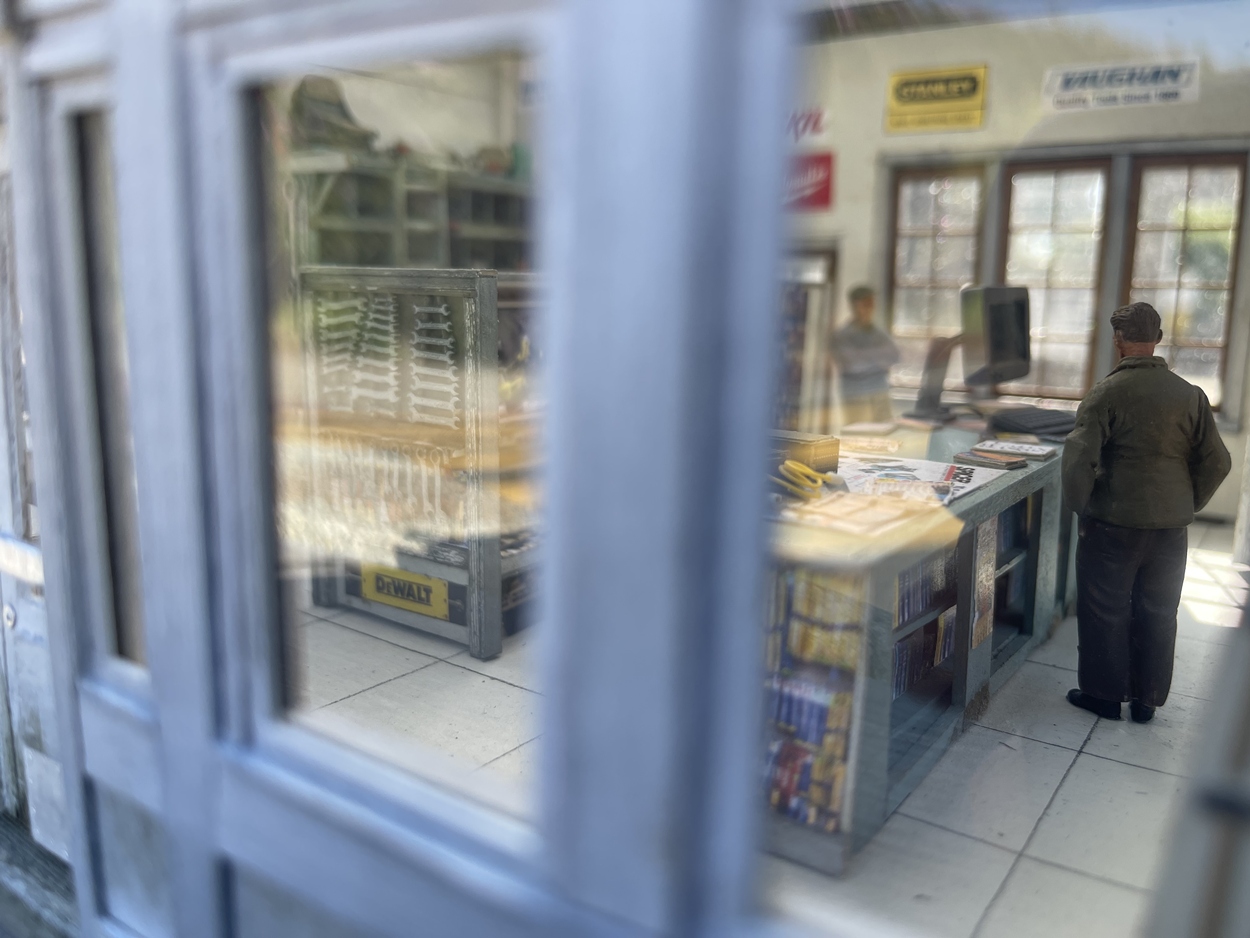

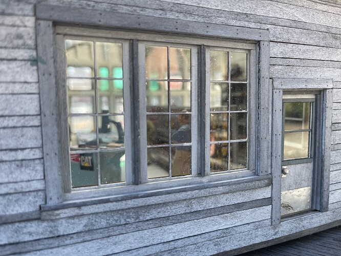

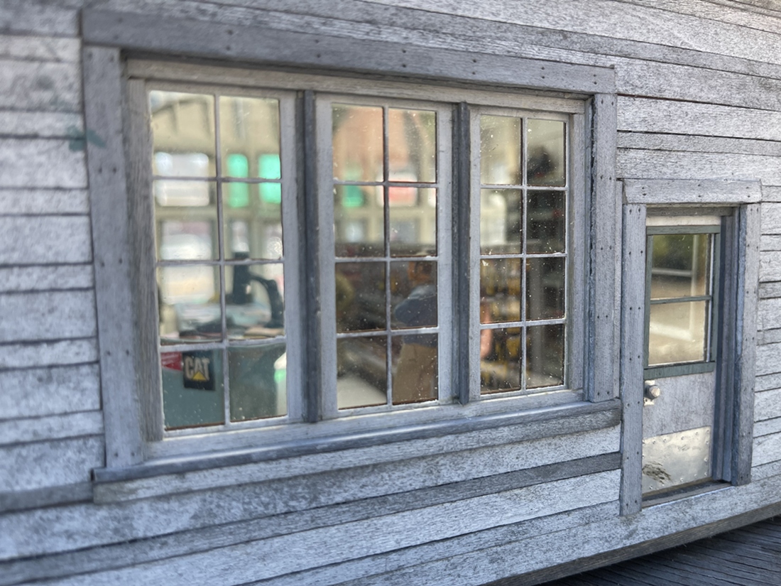

And the reality shot, and as noted by @loncray, well we have some glare:
Oh what a treat, a lot of glare - if I hold the camera essentially on the “glass” well you get to see inside and plenty of…glare. The reason the glass is installed is that once this is wrapped in (walls built, siding added etc), there’s no way to get back in…so - the problem of seeing what’s in there remains.

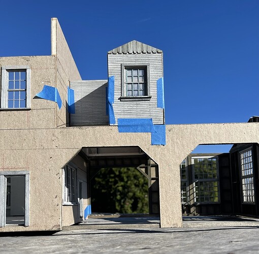

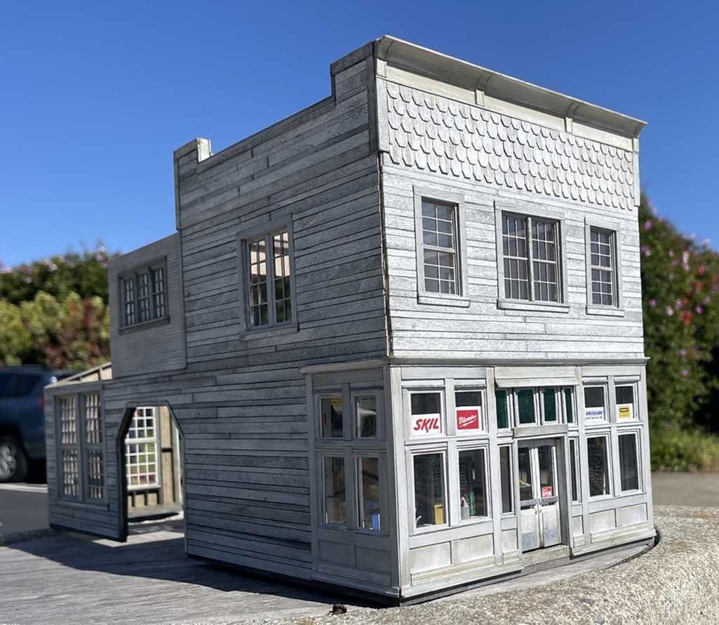

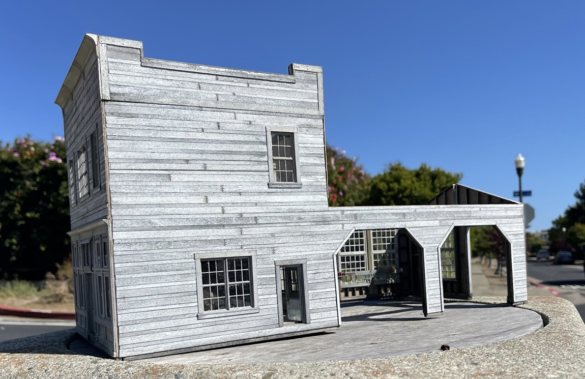

First up, the addition. @Uncle-Heavy, yes, Robin, we’re on the same page here. The plan was to make it look like something was added along the course of time, and not just a bigger second floor - and the parapet, naturally, I went ahead and stripped it apart to get access to the the strip wood buried within for reuse, and reuse I did, but while pondering the new area, I wondered, if I were adding to this in real life, why would the parapet get removed? I’d keep it and avoid the need to rebuild the facade, so, yes, I rebuilt it! If once is good, twice must be a lot better! :grinning_face_with_smiling_eyes:
And here we are! I used scribed sheet for the siding, and individual boards for the gable end. The windows are a different color and pattern than the others - why? because they were recycled from another project of course! But, the look fit the intent. And, rather than adding a regularly shaped area, I made something with a jog - allowing the “need” for a side dormer! I must say, this idea is a callback from making model rr buildings, where forcing interest is a common practice :grinning_face_with_smiling_eyes: and I’m glad I did so! the purpose was to, well, add interest!

We now have light on the first/ground floor! I still have something of a glare problem, but it’s the lesser of evils when compared against a dark main floor!

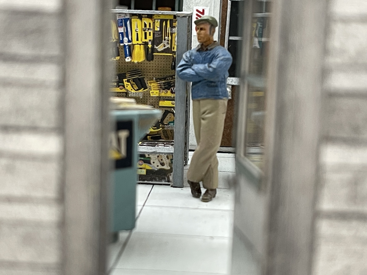

And for grins, I did some indoor photo tests too, maybe less glare?
This worked out fine too - so, I’m calling this problem resolved. I drew some lines on the floor with a pencil to look like it’s linoleum.

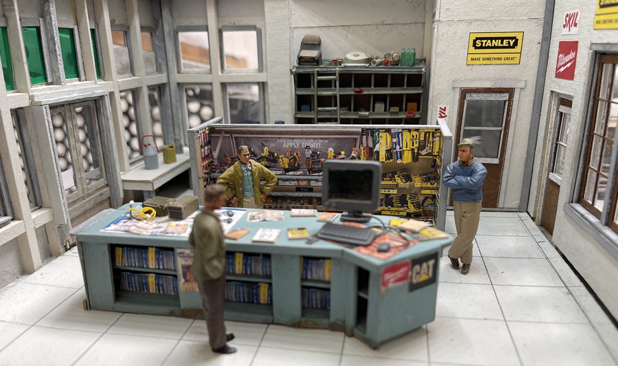

Now, on to the interior. @Dioramartin, hi Tim, yes! I remember that building, and like it now, as much as I did when you built it! Unhappily, in this case, unless I went with @Tank_1812 Ryan’s idea of a vacant building (hmmm, maybe for another project??) well, I need more miniatures!! yes, @golikell Erwin, that’s for you! :grinning_face_with_smiling_eyes:

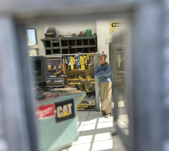

I stuck with the hybrid approach, and think it was the right way to go:
We now have elements of an interior! thankfully Sprue Bros had a 20% off sale on Miniart kits a few weeks ago, so I purchased a couple of sets of mechanic’s tools kits, pillaged more from an old project, and yes, scaled, printed, and glued in place photos of tool racks! The central and taller white shelf racks are made of chip board, basswood, pictures and a few kit parts to add some dimensions in clearly evident places. If you look closely, you’ll see there is a low shelf on these two racks, which I might still add some bits to, but as the look ok as is, these might be about done. I’ll paint the wall behind the tall cabinet with the ladder white, like the rest of the interior walls.

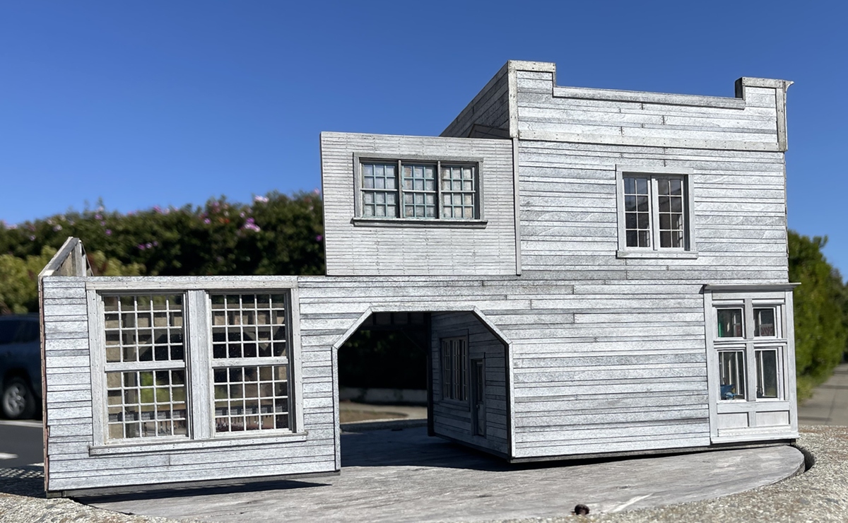

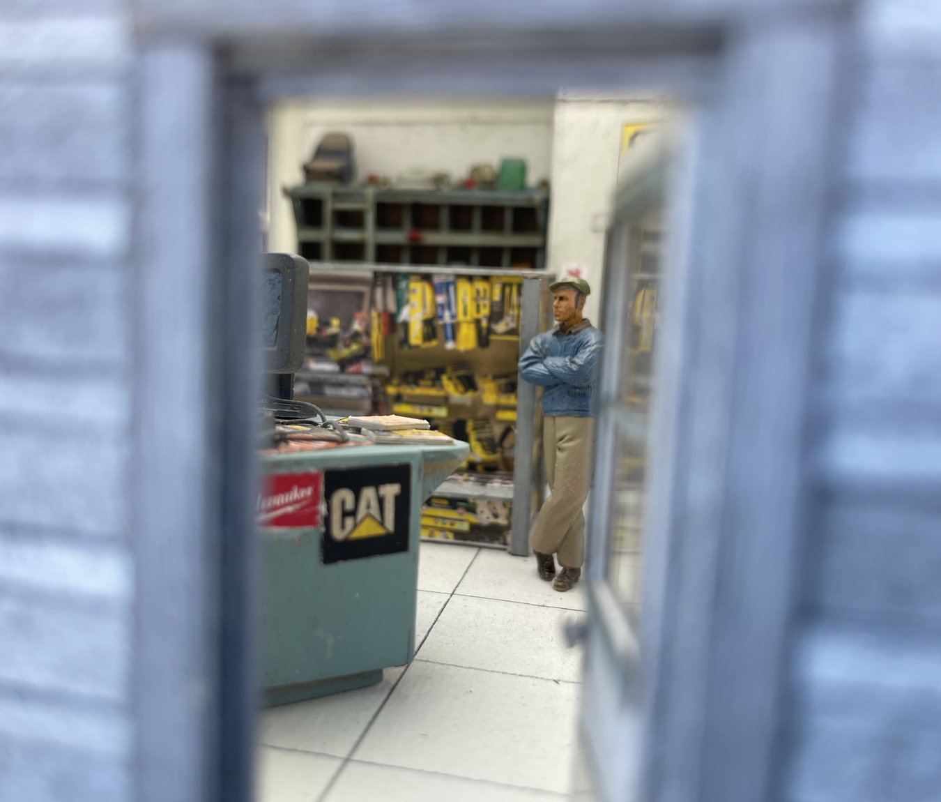

And today an update on where we are now:

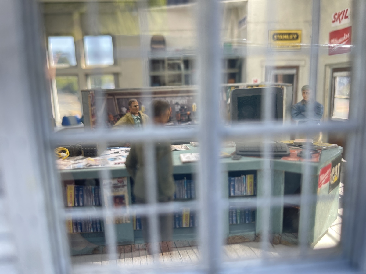

With the bulk of the siding installed, I could finally glue the interior in place. I used some figures from another project. They are not my favorites, but not bad, and likely/hopefully ideal for guys that will be hard to see directly.
And on we go:

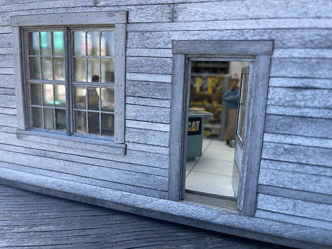

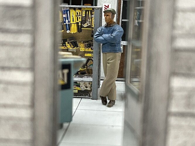

You’ll see this guy a few times, the picture above was taken indoors, then outside we went for some brighter images:
the guy is back! but now with some sunlight. It’s really surprising how well the fake tool rack works - wow -
The images above showing various images in - and as you can see, the skylight seems to be working out pretty well.
Ahhh…more siding installed…I think this is all of it - but, this still needs all sorts of trim work and, well, the second floor addition, and lots of roof framing…

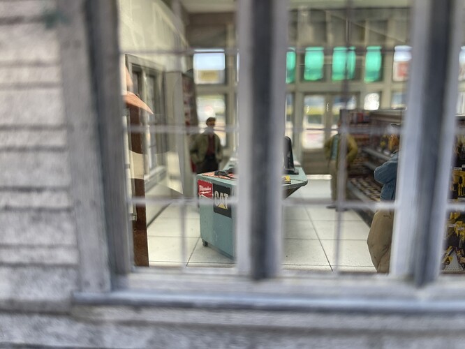

Yes, yes, I know - a gratuitous move…I left the side door open. I couldn’t make it closed, as now, we have one clear view in.
The guy again, this time with the building oriented differently to the sun, but, this view gives a good indication of how well the skylight is working out -
Ok, still a lot more to go, but we are making progress -

Amazing Nick, and agree the tool racks look incredible. That last shot through the door - you have the 3D effect and a full tool rack. A bit more focus and you could have gone for a product placement fee!

What a great update with those inside shots. so realistic. And also great photo work to make it so real with how the light adds to it all.
