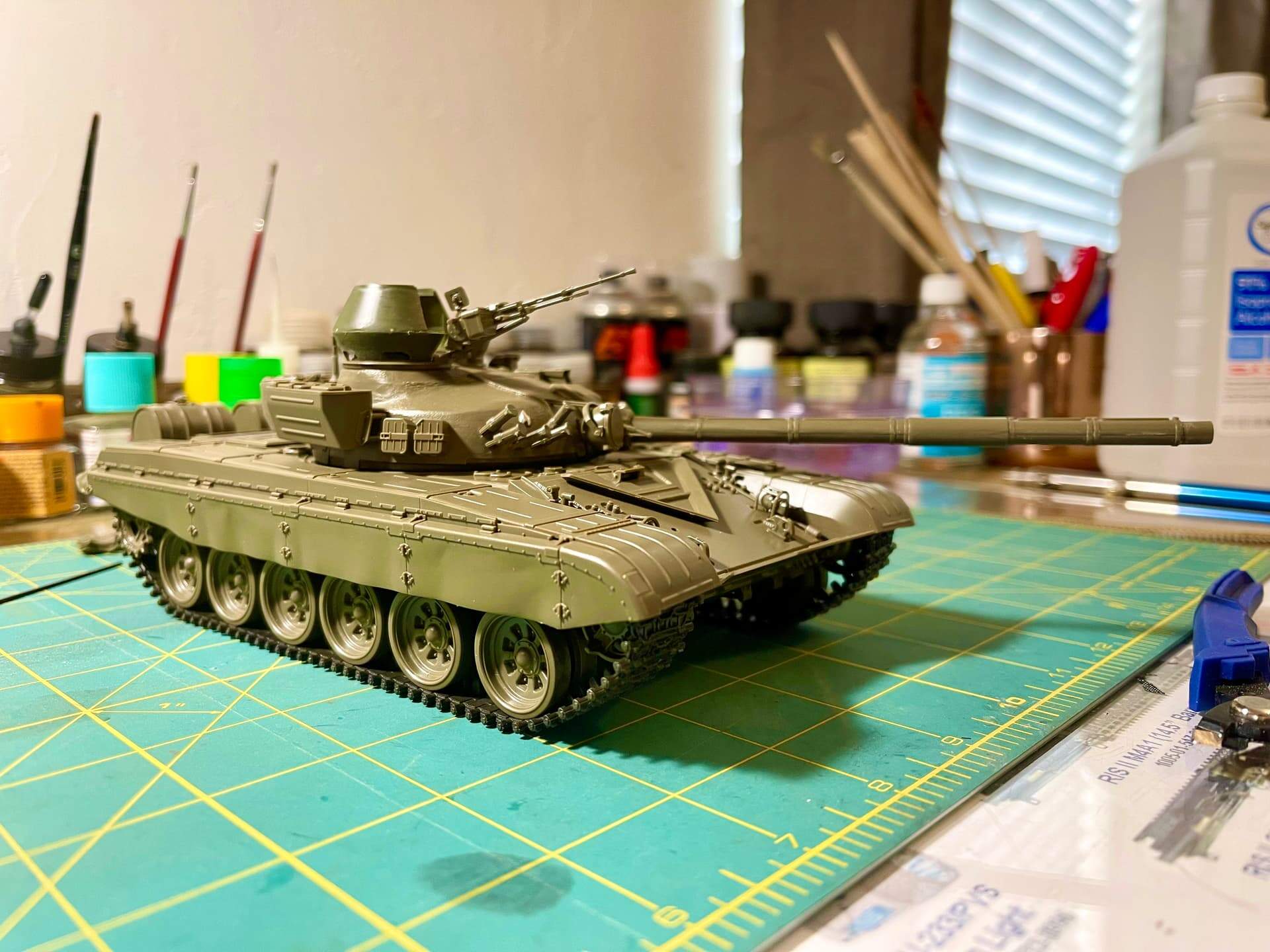

Ah, I missed that. So the one you’re doing is the retooled one?
Can one compare the two?
There is also a issue with the equipment on the fenders, I think the straps going over the fuel cells are backwards?
Yes, I think the lid of the foremost zip box is flipped.
I build one of the old Tamiya kits to replicate a New Iraqi Army model a while back.
I hated the smoke launchers on the T-72 with a passion, i could never get them properly aligned. :enraged_face:
Get some 3D baby!

  2. The SGL’s on Tamiya’s kit are a pain, but they are on any kit that has them separate. Specific SGL’s go in specific places, you cannot interchange them.
  3. Yes, the straps on the Tamiya T-72 fuel cells are placed on backwards, with the clasp/buckle on the incorrect side.
FYI the Tamiya kit is a T-72M turret (think T-72 Ural) on a T-72M1 hull. Generally.
