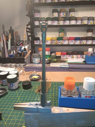

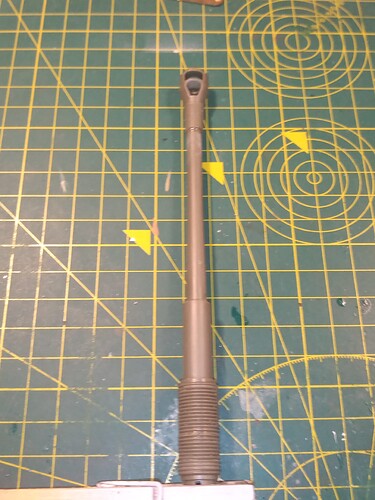

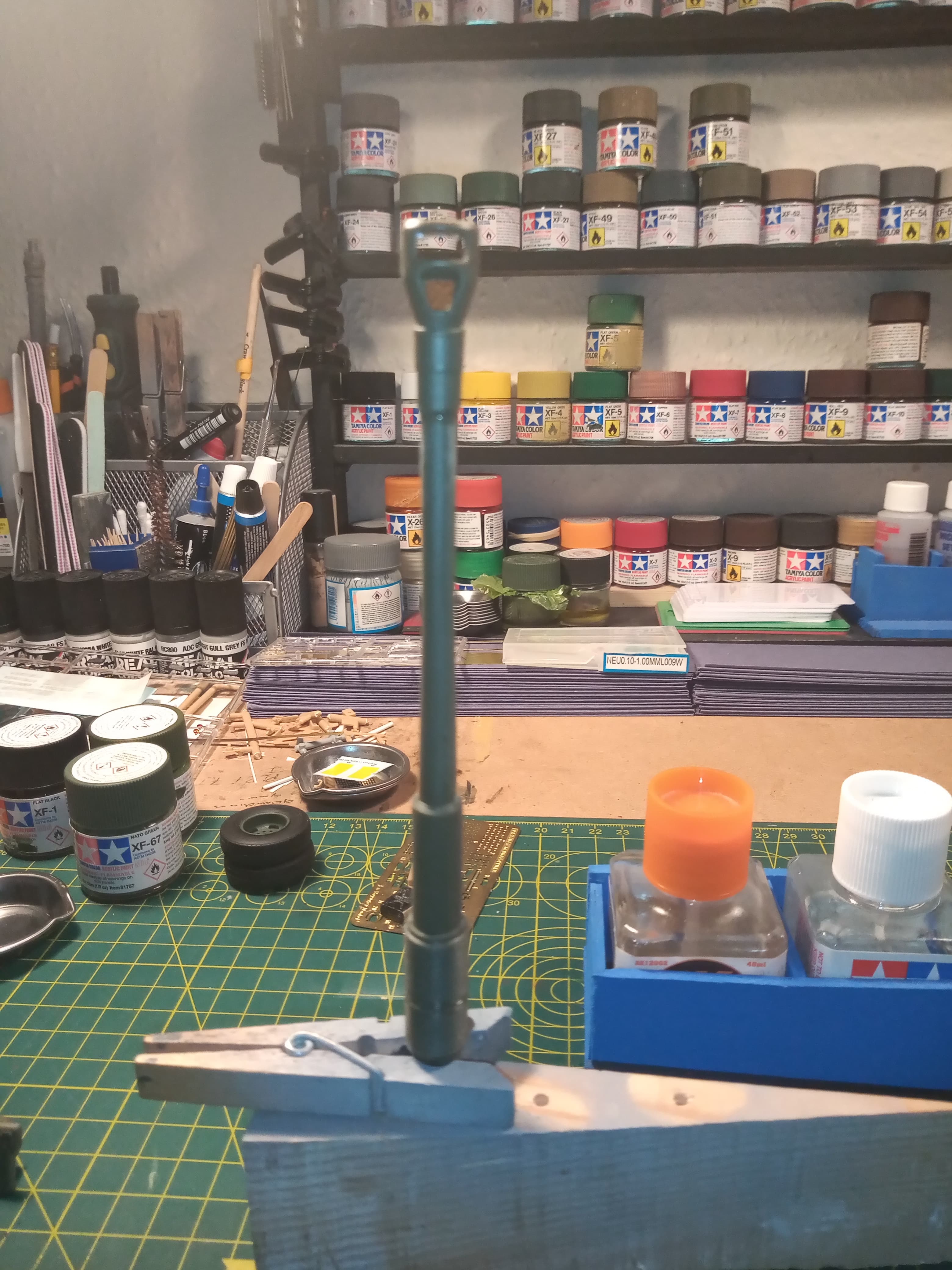

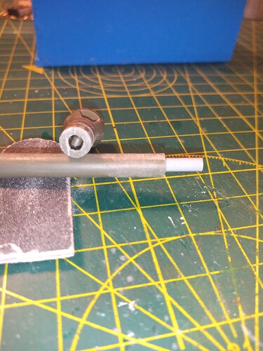

I found a perfect size of sprue that fits into the barrel center.
Then it was attaching the muzzle moment… Made sure it was straight and true on all its axis…
Pretty happy with the way it came out. Finished it off with some liquid super glue around the edge to give it a nice seal…
We now have a barrel nearer the correct length. :+1:

Fantastic outcome John! That barrel looks the dog’s! Exceptional work.
Agreed, If I’d tried that it would look like a dogs hind leg.
The moral here John - never doubt your abilities. Top notch work.

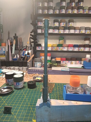

Thanks Matt @SSGToms , G @Maximus8425 and Pete @petbat — the bellows were nice and simple, the V’s make perfect guides and the saving grace with the barrel was finding that section of sprue that acted as the perfect support between barrel and M brake, that helped just to slot it together and super glue then easily hid the join line … I must admit … I did breath a big sigh of relief once I knew it was ok …

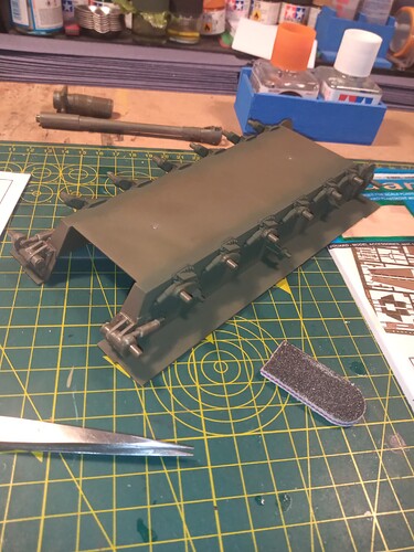

Carried on with the lower hull running gear units and that’s all now completed…
Wheels will be next and then fitted.

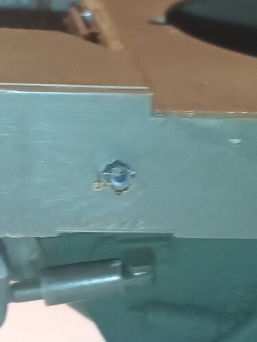

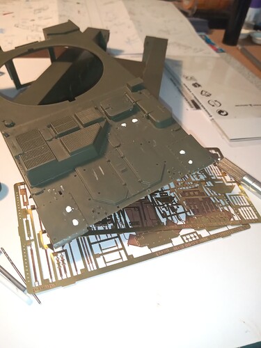

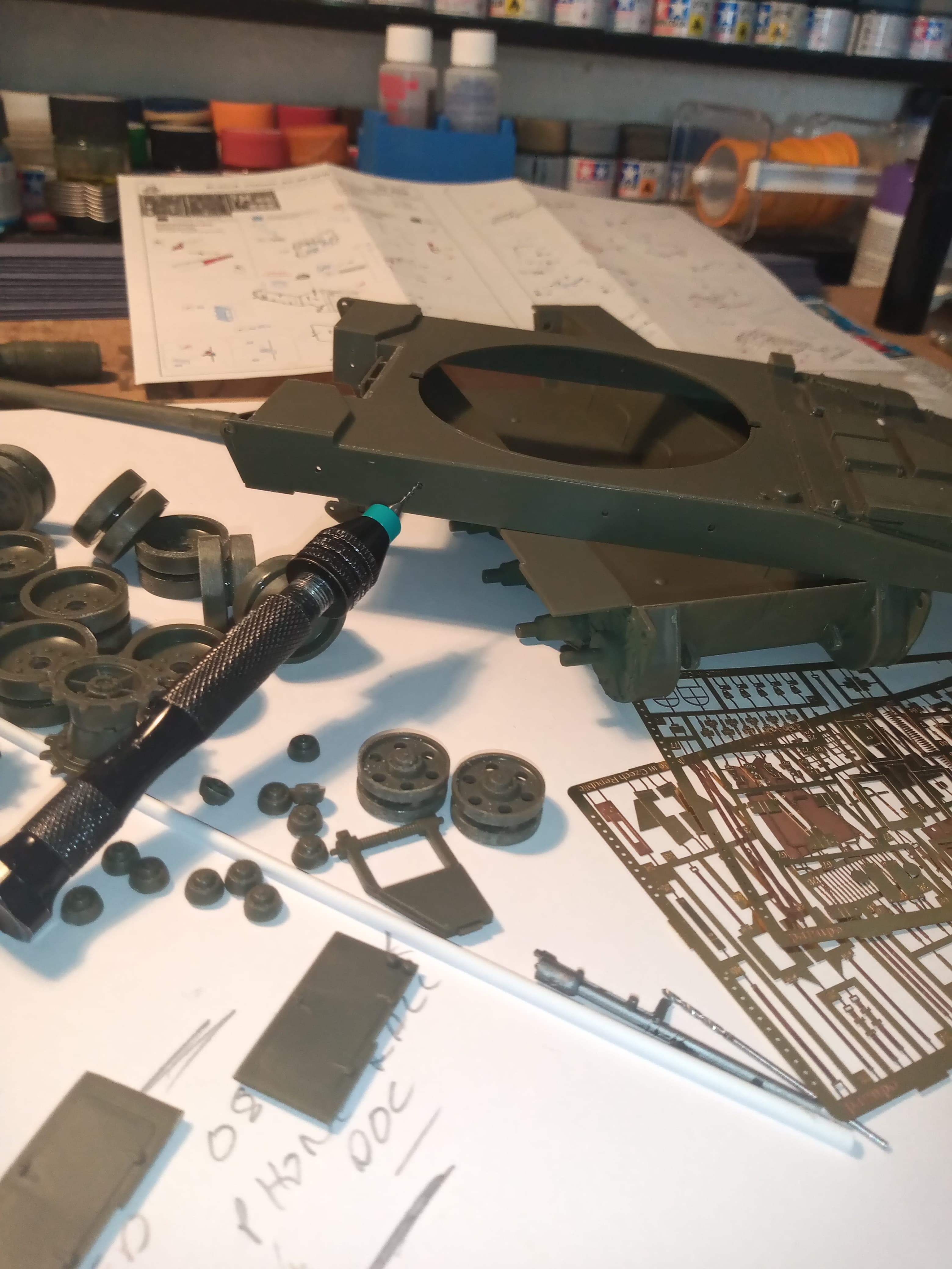

Have started to fill some of the unnecessary holes on the hull, 2 of which are for the drivers sight which is to far forward and some tools on the front upper mudguards

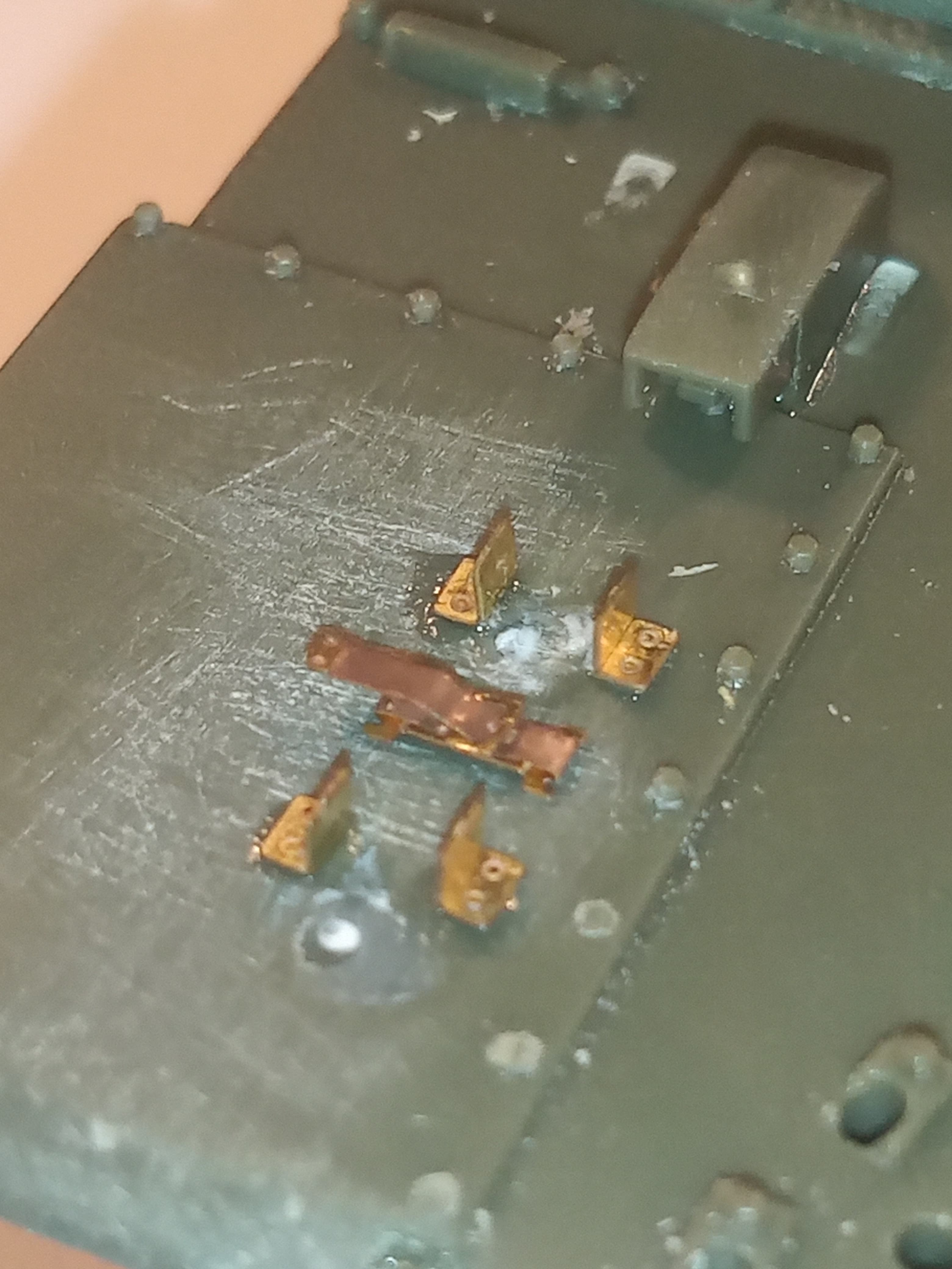

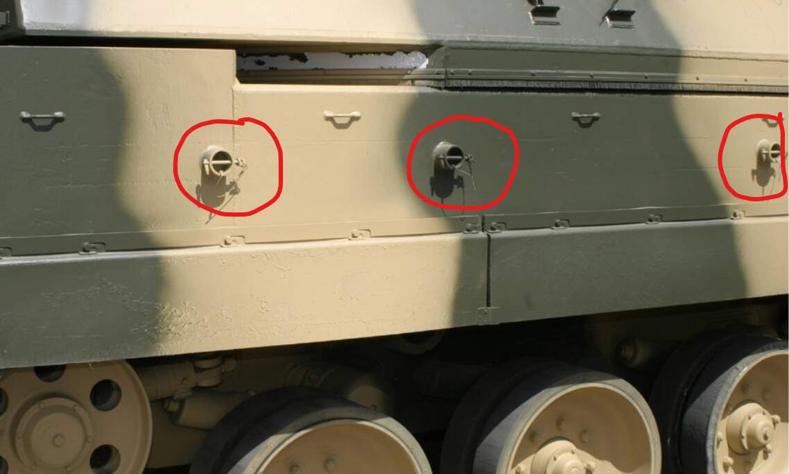

On this image, the drill is in a hole (to be filled) that is aone of two mounting points for another unidentified tool - there are 4 mounts altogether for 2 identical tools -
The mounting points look like this. Image for discussion only.

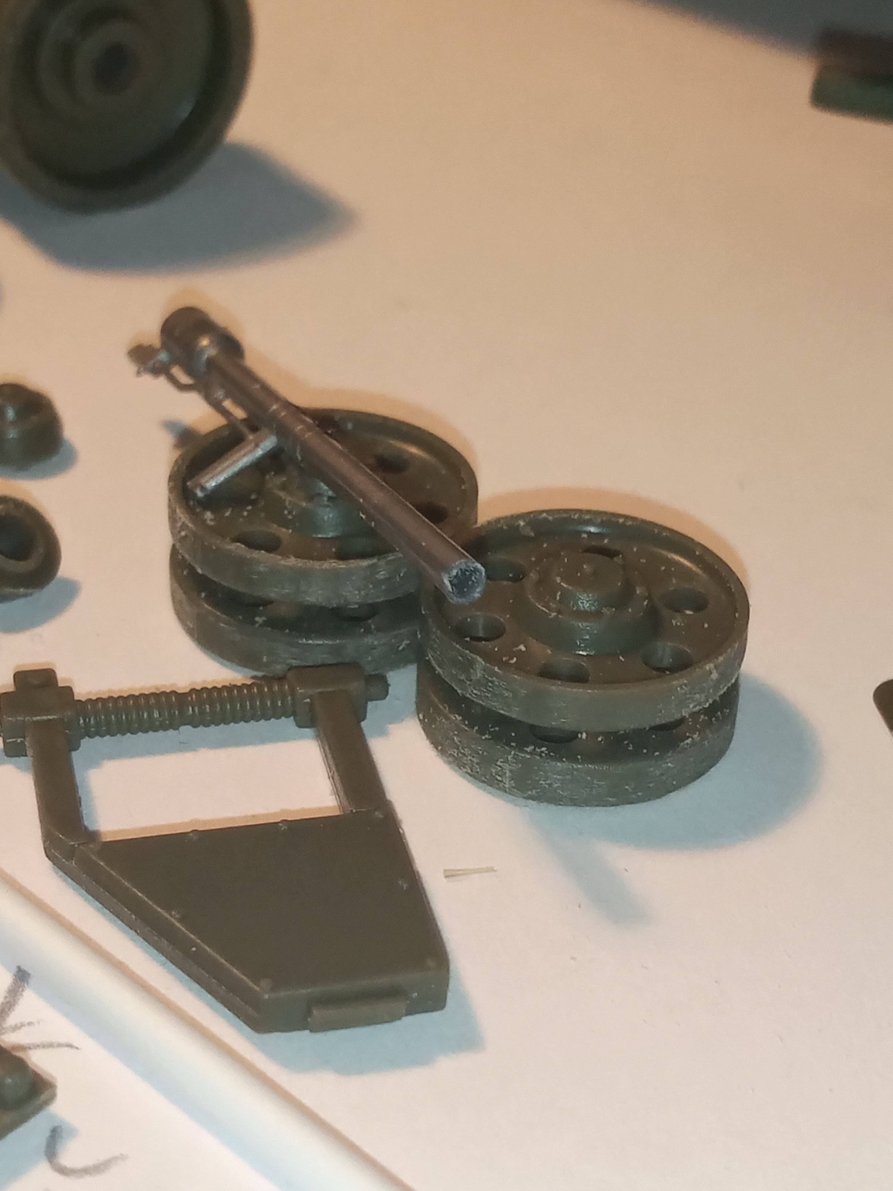

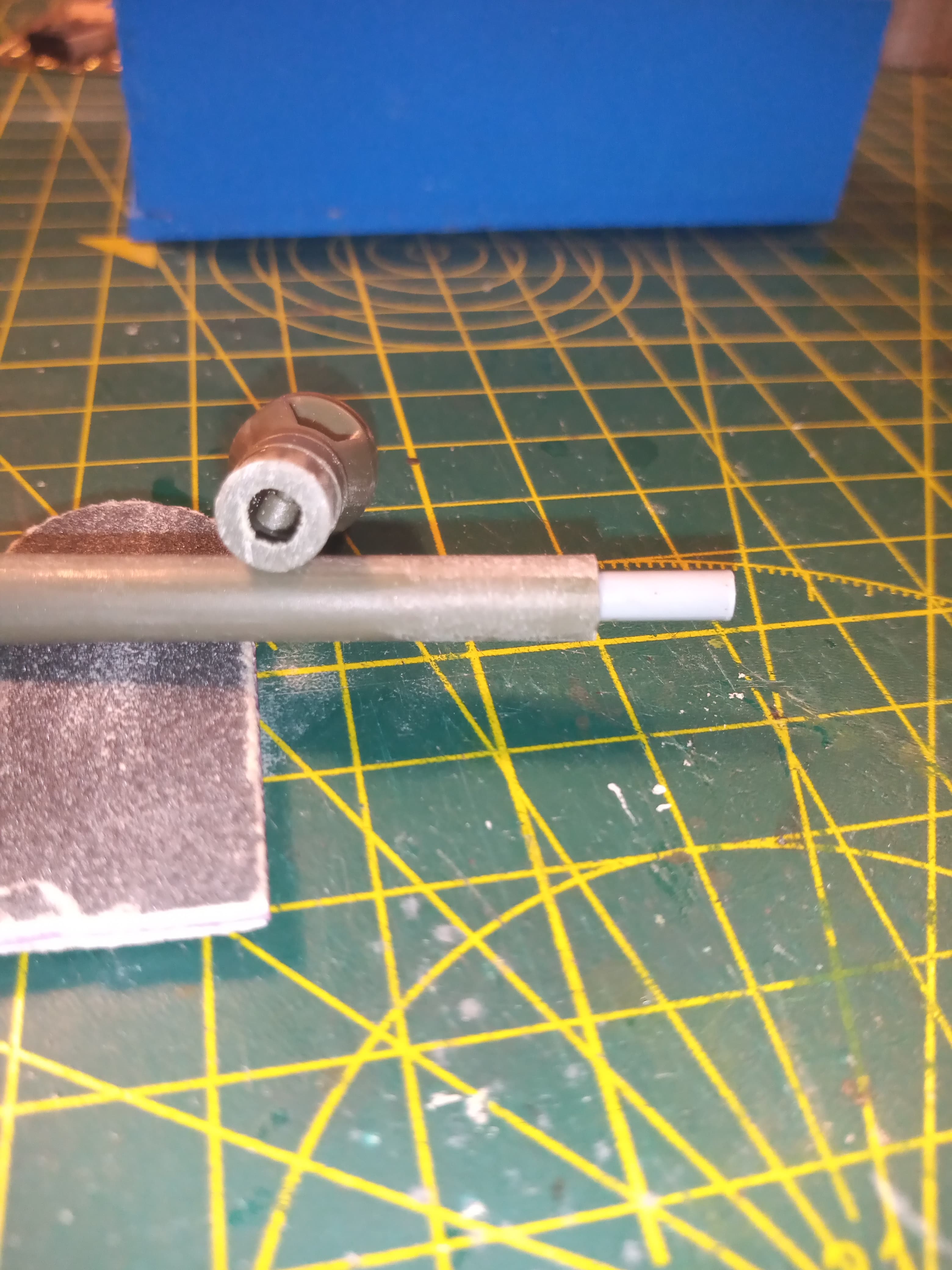

I didn’t have and hollow rod the correct size, so I found the recoilless rifle from the Tamiya US weapons set and the barrel is the correct diameter so will drill that out and then drill smaller holes for the retaining pins, which will come from Panther spare track link securing pins.

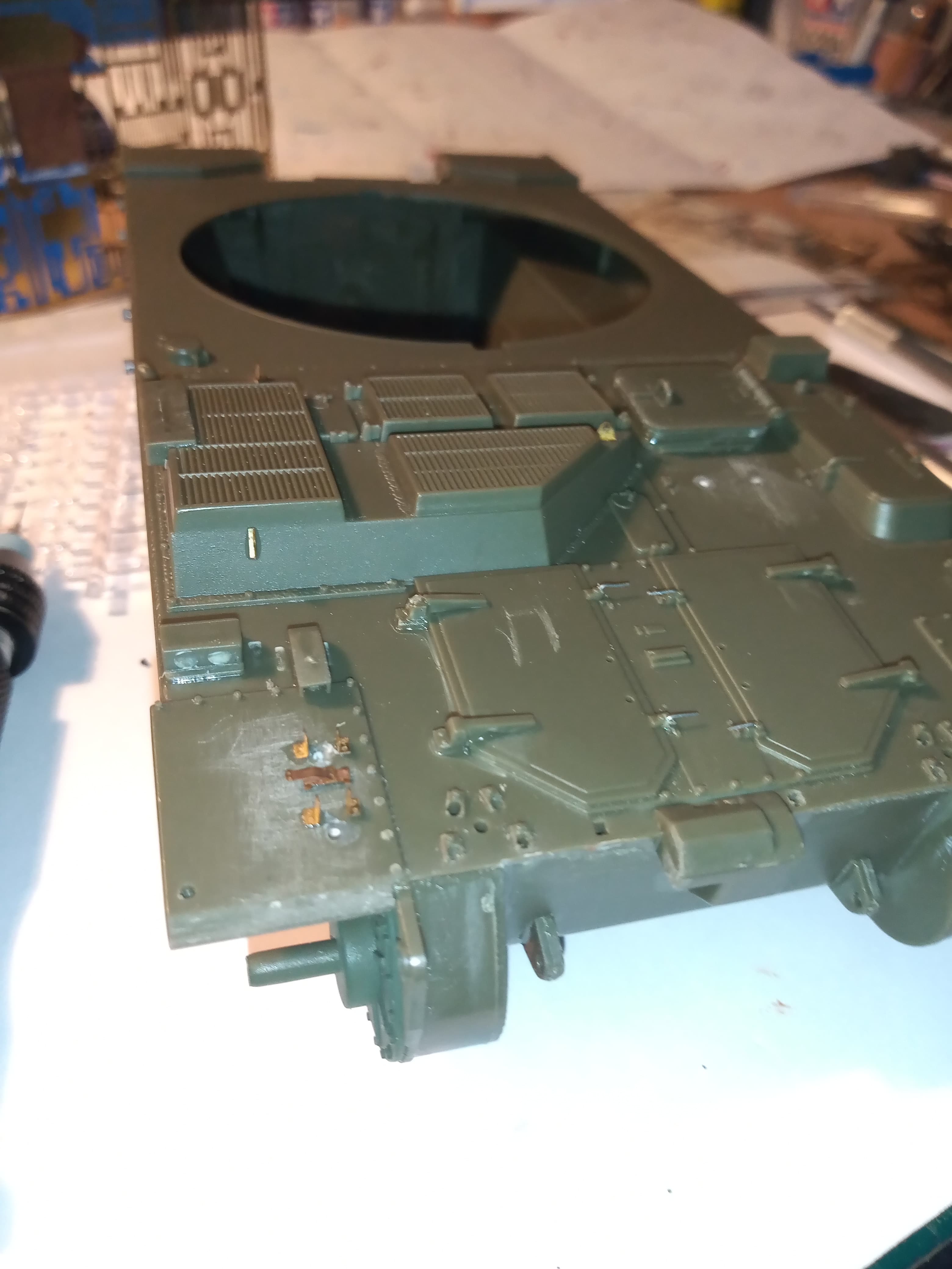

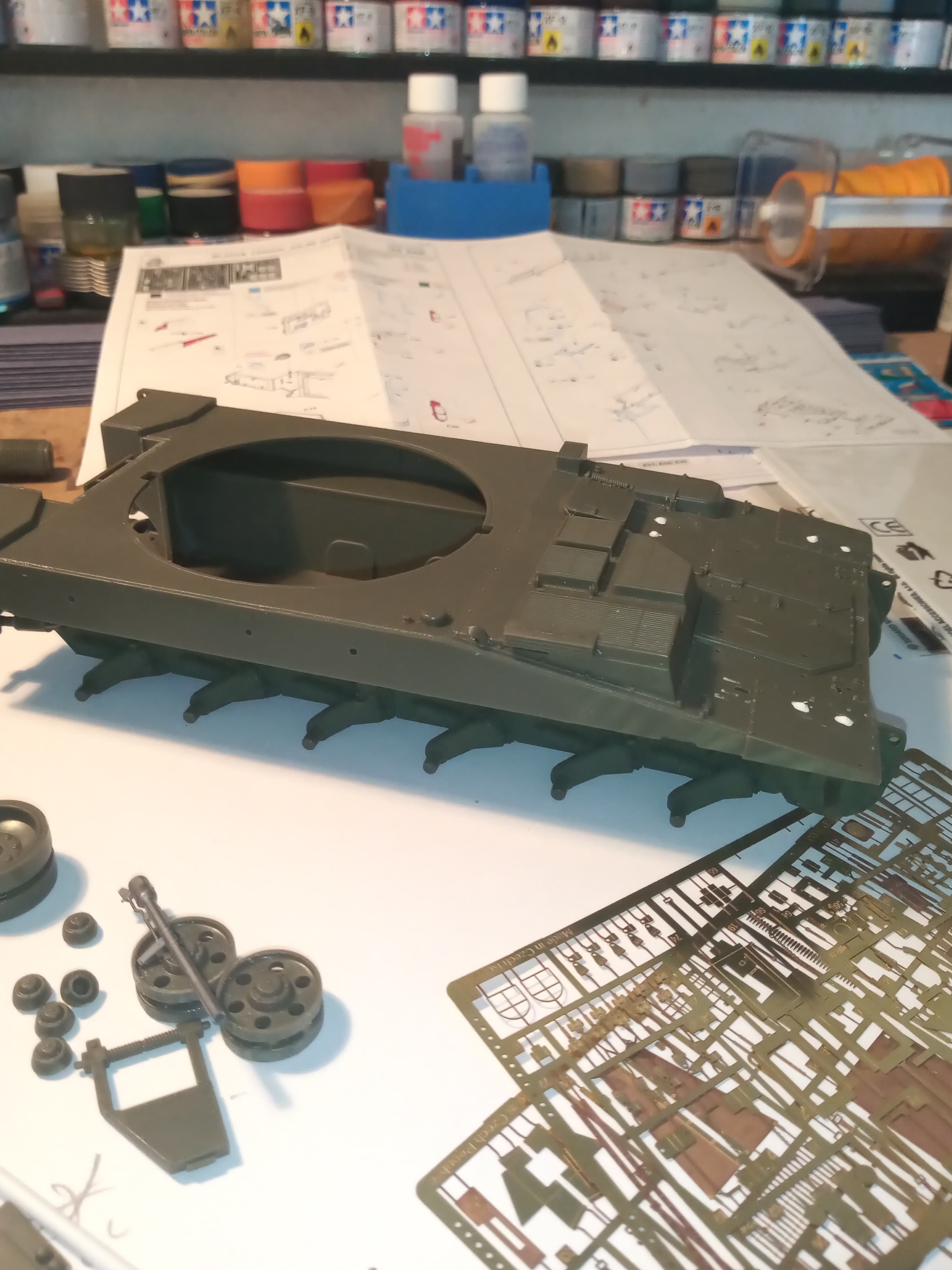

And a test dry fit of upper and lower hull

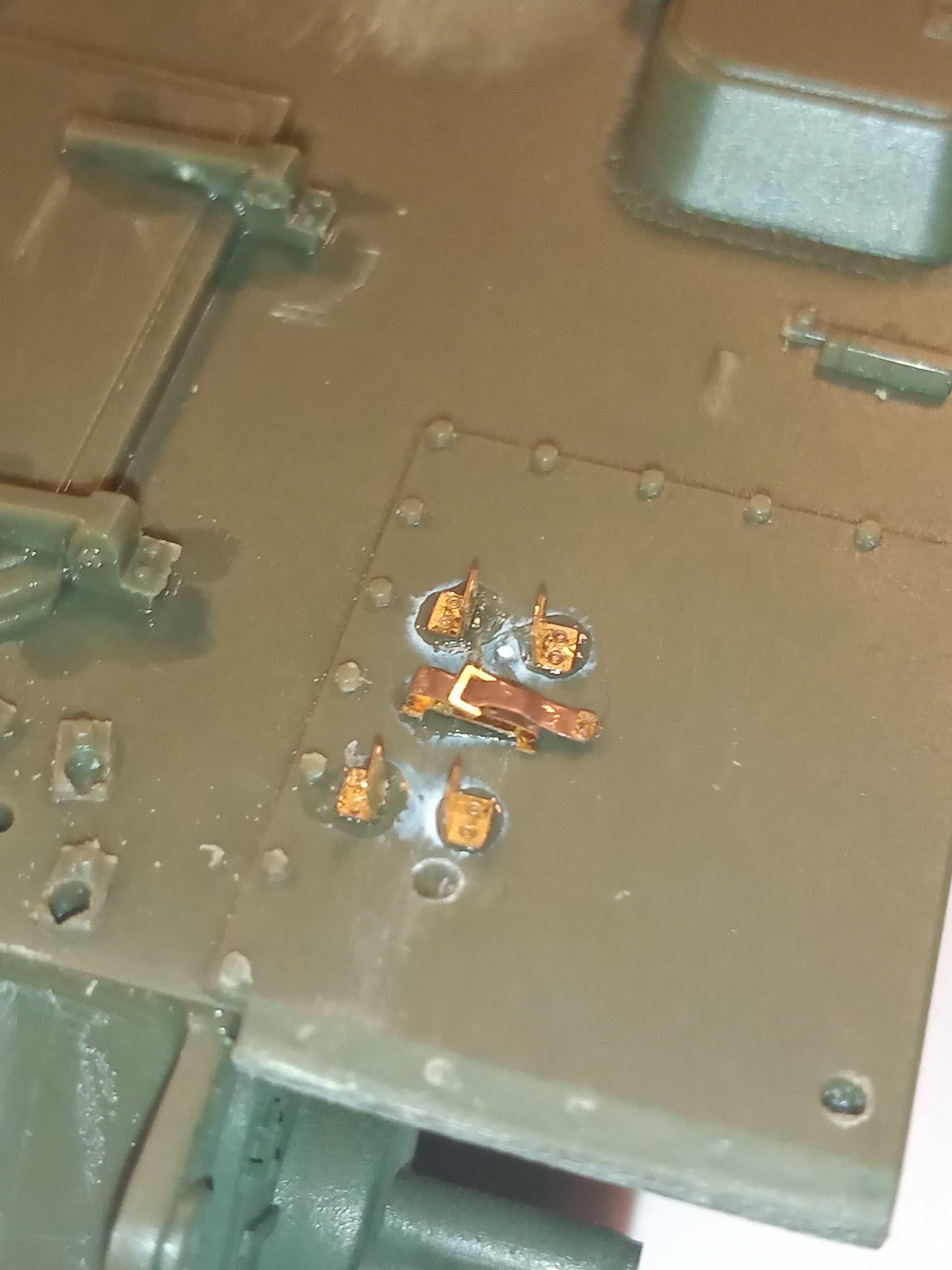

Started on a bit of PE for the tools.
Also did the 4 circular mounting points and fitted one retaining pin.

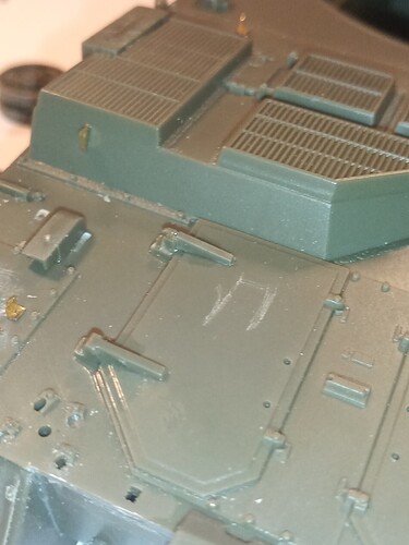

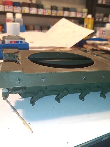

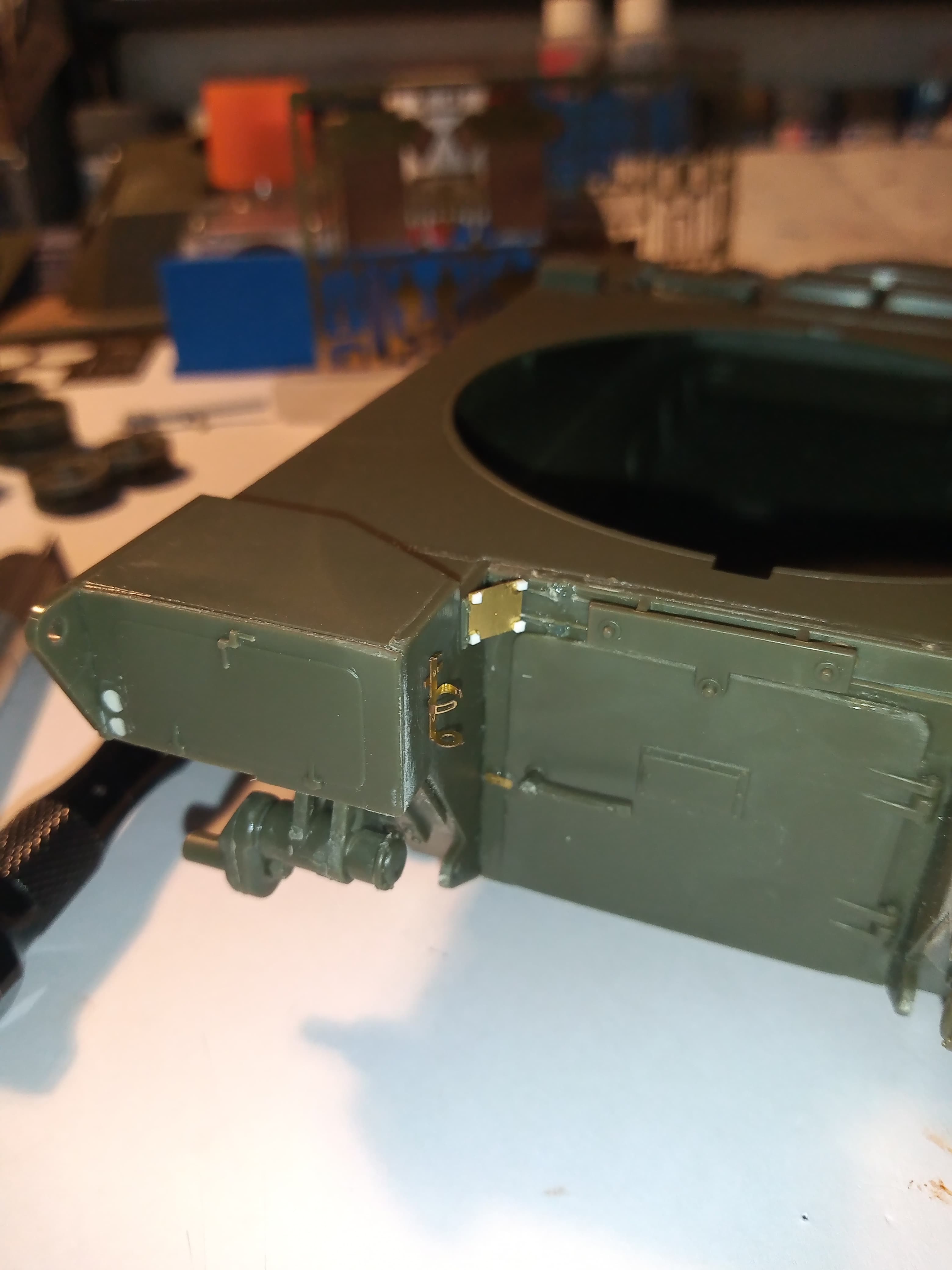

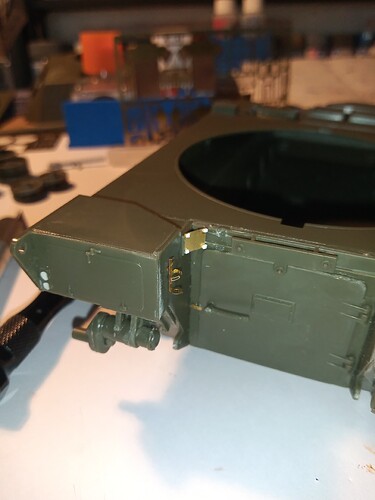

Fitted the 4 hinges for the gearbox but noticed that one was missing the end that mounts on the hull… It didn’t break off, guess it must of been a part pour… Looks like an easy fix.
And fixed…
Needs a bit of trimming but once painted it will be fine.

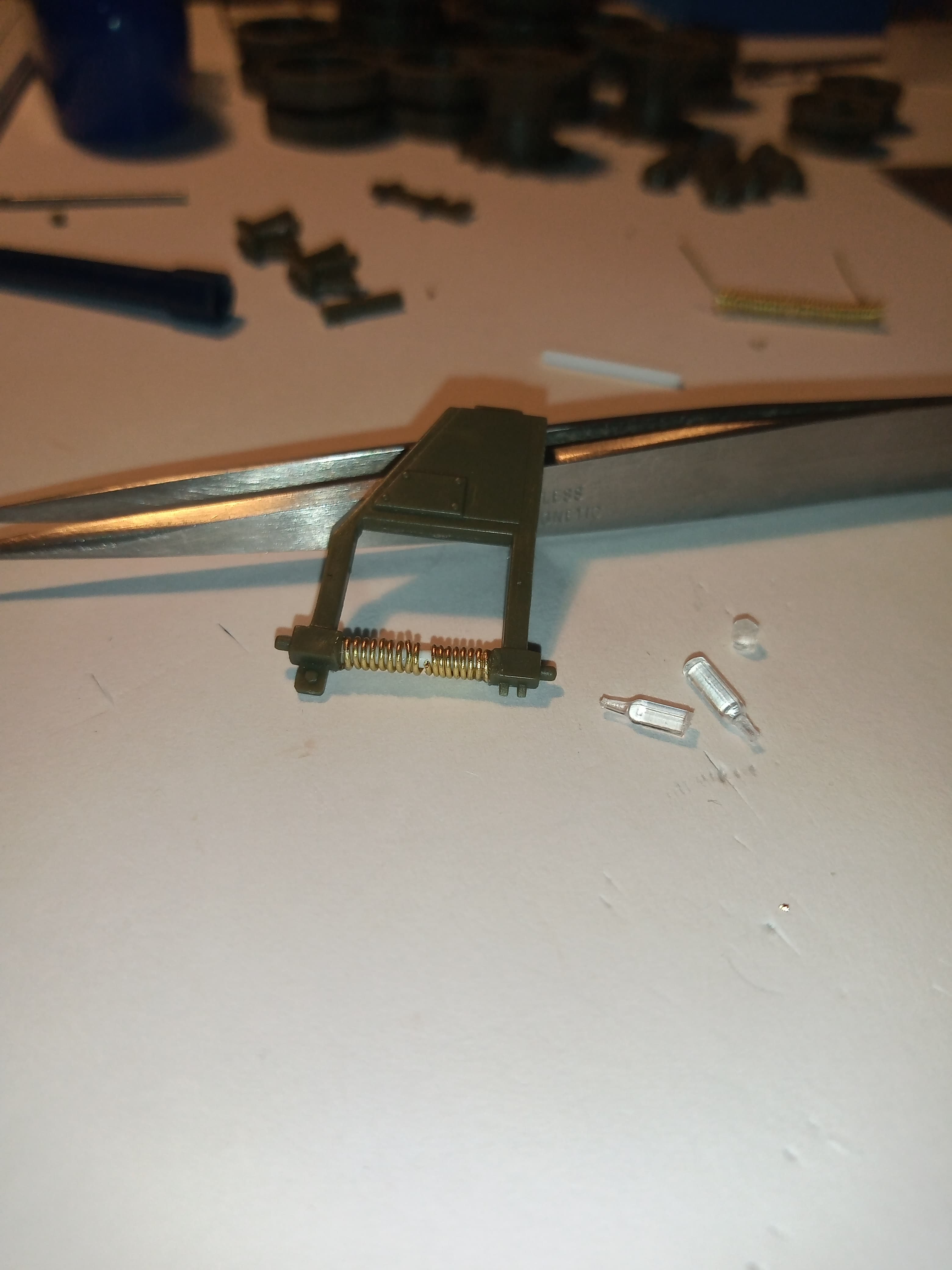

Although the gun clamp spring is passable, I decided to add one from jewelers wire.
Have also sliced off the side, tail and indicator lights as they were just moulded on plastic and will add clear parts for those, some actual spare lenses and the rear ones made from cut up clear wine bottles

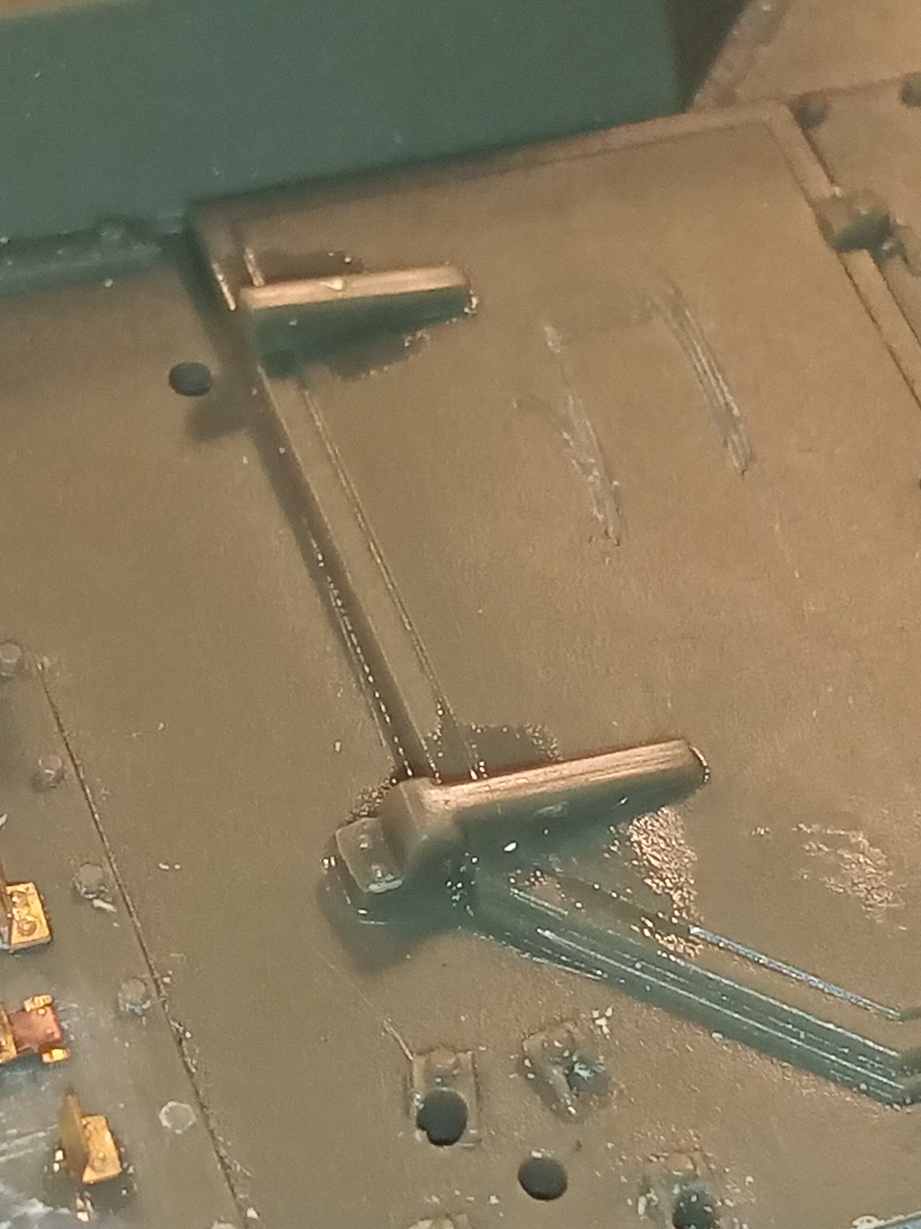

Also added some locking handles on the gearbox decks.
