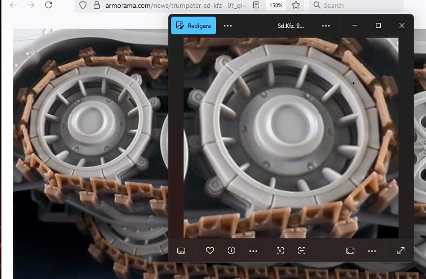

Looks like we’re still dealing with the incorrect offset of the rollers on the drive wheel.

Could the builder have swapped the sprocket/drive wheels left/right?
On first glance I would say it’s a mixed bag. Yes, the drive sprocket issue is a bummer, but it’s easily fixed. From what I remember from PMMS: there are two tabs which have to be removed, then the outer ring can rotate freely. The correct offset can be checked with a length of track.

Indeed! Looking again closely at the pictures, the rollers are offset, contrary to what I have written in my first post. But you’re right: the offset should be in the other direction, therefore the tracks don’t fit.
which made me think that swapping the drive wheels left side ↔ right side might
solve the problem. The rollers on both sides, as the kit has been assembled are on the trailing edge of the “pad”. Turning the wheels 180 degrees, i.e. moving them to the “other” side would get the rollers on the leading edge of the “pad”.
The wheel from the passenger side roughly pasted onto the drivers side (from right side to left side):
The right side wheel has a leading offset whe mounted on the left side.
Compare with some car tires/tyres which have directional tread, usually indicated by an arrow on the side wall. If that wheel is mounted on the wrong side of the car the tread pattern will be rolling backwards.
I have a few other Sd.Kfz 7’s so I’ll look and see if that might work rather than cut the roller piece.
I think this all unnecessary: the original, an early F2, yet with some features of the F gr 1, had different sprockets altogether. The rubber was not sub-divided in segments, but rather one continuous rubber ring. So there’s no issue with the offset. The hub also had a different shape: less contoured, more conical.
