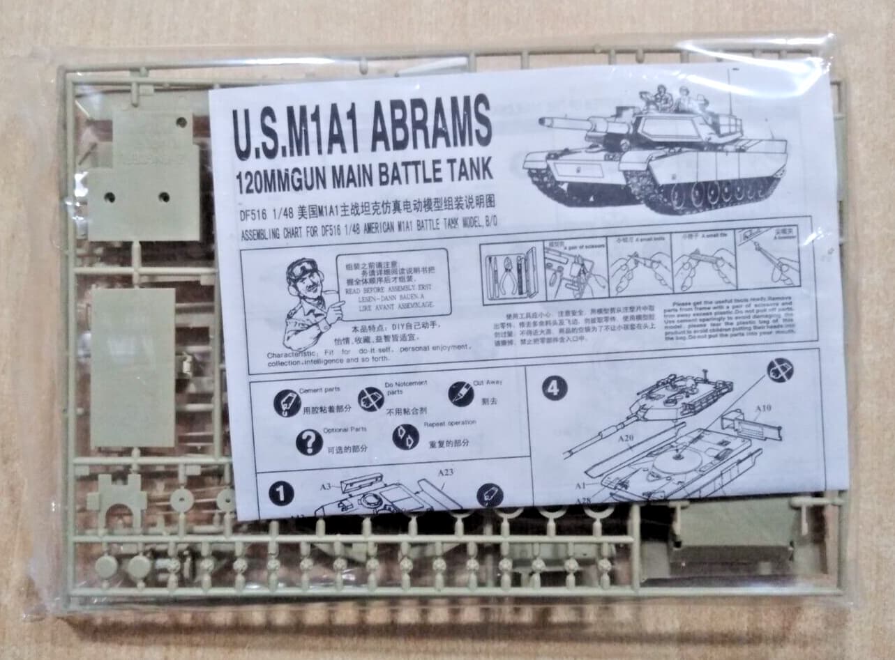

No clue on accuracy or quality. It looks pretty good. It looks to be a scaled down Tamiya 1/35 M1A1 (35156 most likely) from the parts layout. It is an older model though with what appears to be T156 chevron block tracks and the old-style angled rear part of the Gunner’s Primary Sight (GPS) box, both pretty easily fixable w/parts from the Tamiya M1A2 kit. Looks like it goes for about the same price too.

The Tamiya kit would be a good start for a conversion. The hull is correct for an M1A1, with just the fuel filler caps at the rear corners. The suspension is nice, and it has good link and length tracks. You would have to cap off the CITV and replace the TCs cupola. Using another kit, is a good option for this, but there are a couple problems to consider.
First, the other brand kits: Academy, Aoshima, ARII, and Zhengdefu tend to be slightly off in size compared to the Tamiya, with softer detail. This is OK if you just use some part from them.
The other problem is that they are all made to be motorized. The suspension, road wheels, and sprockets are crap. The tracks are literally black rubber bands.
If you have never built and old kit with these original rubber band tracks, then you cannot understand just how advanced modern vinyl tracks truly are.
Having said that, you will need the Tamiya kit for the lower hull, suspension, and tracks, regardless of what you do.
This is a photo of the Zhengdefu kit from an eBay listing:
Ken
P.S. As for the photo on the box, it’s fake. I think they used a photo of the Tamiya or Academy 1/35 scale kit.
