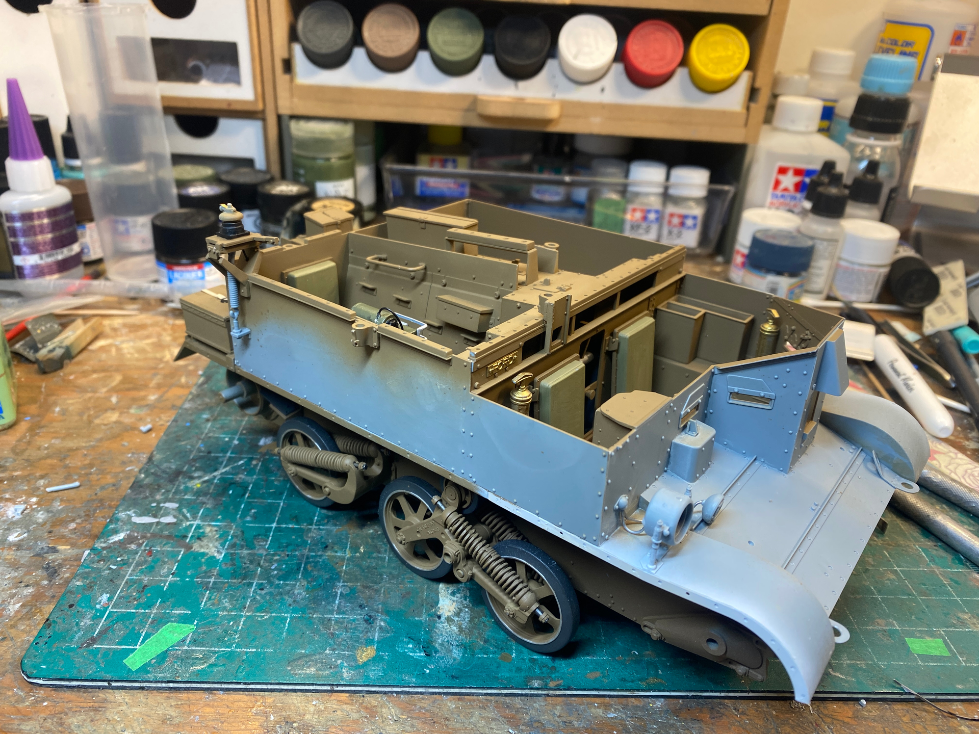

I’m currently building the Mk.1 right now. it’s building nicely. I’m doing a build blog on it here: TRACK-LINK / Forums / Track-Link Build Logs / Gecko 1/16 Universal Carrier Mk.1
Here’s where I’m at:

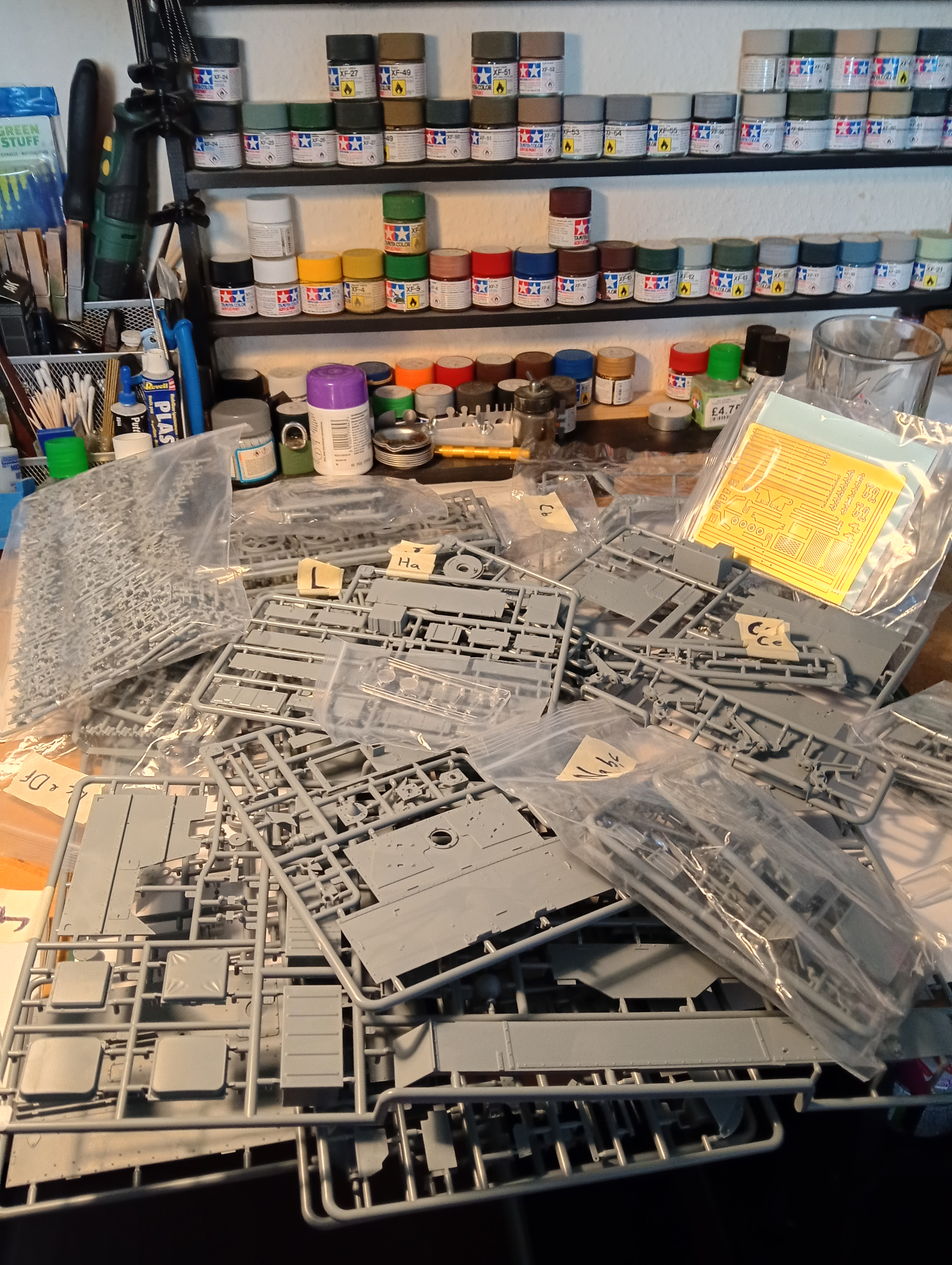

Welcome to sprue hell lol…….
I decided to label the main hull sprues to ID easier, but I can also leave a lot as they are due to them not being needed till a lot later in the build or easy to find as they are just tools or weapons etc …..

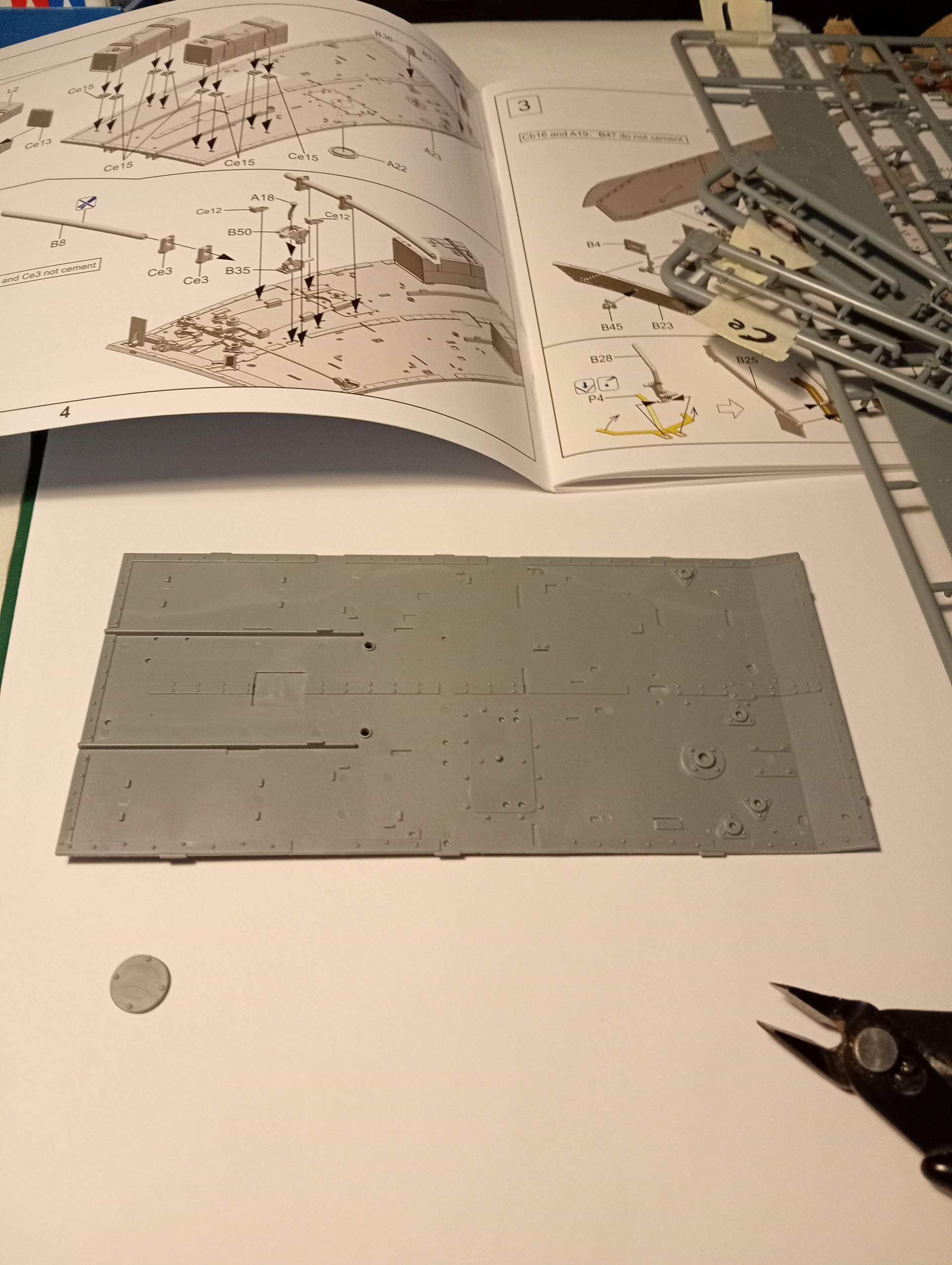

After having a quick look the the destruction booklet, I can see one area that’s going to need some attention, and that being the void under the PE engine casing….
I can see that I will need to at least knock up the air cleaner box and pipe, potentially the gearbox housing and various cables/pipes and drive shaft outlet ……
And first plastic now cut …. Bottom plate and a cover :grin:…..
Gecko did an engine kit but a club member said you cannot see anything under the housing. Maybe wait til the cover is made up and see if you see under before making the parts unless it’s needed because you will know thing.
For mine the engine cover was styrene not PE. and the kit gave me the Radiator which pretty well covered the front. I can’t see into the void at all.
There’s also a build blog for the Mk.2 UC at Track-Link. it be of more help as there are differences in the engine covers between the 2.
Thanks Ian …. will check it out as well.

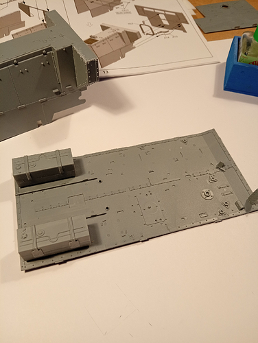

Added the fuel tanks to the belly plate, and a few bits at the front end.

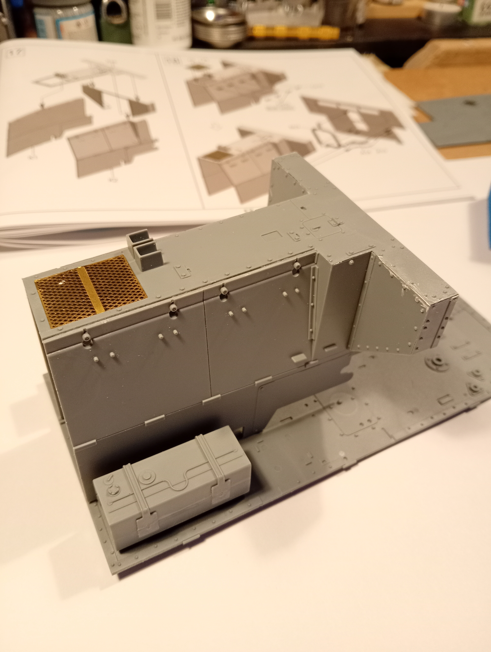

Also decided I would jump ahead slightly, and build up the engine cover section….. purely to get an idea of how deep you can see down into the void ….
I think it’s safe not bother with the output shaft or the gearbox as it will be to far down to see anything … I may just add a scratch air cleaner/box and it’s pipe work as that will probably be just visible through the PE, and should be nice and straightforward to get done .
You can get away with the round air filter top and tube to the carb as not much else would be visible both easy to scratch. I replaced the photoetch with ali mesh as the plate over the centre should really be beneath the mesh supporting it. It all depends how mad you want to get detailing really.
Thanks Keith :+1:
