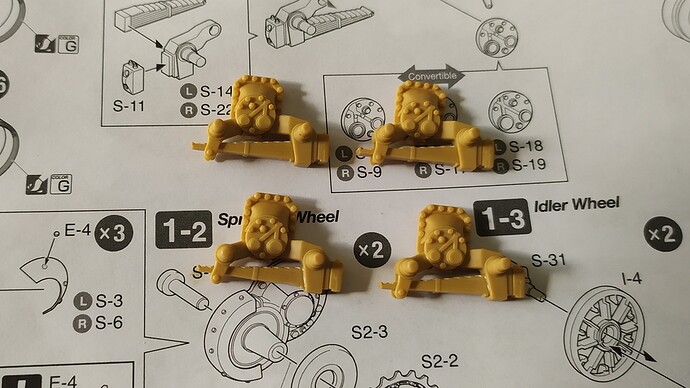

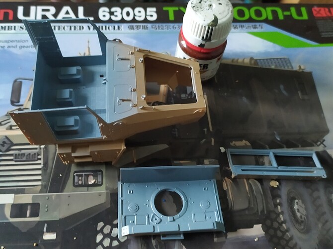

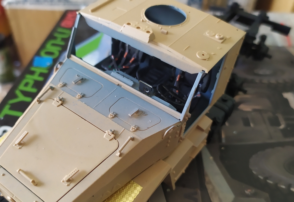

Here, attaching E5, E6 and E7, I remember it wasn’t easy at all… it took me more than an hour to get it fixed. And attaching them to E27… is a nightmare.
Ok, you get a moveable independent suspension on all wheels… is it worth the trouble… I don’t think so.
attaching E45 to the PE parts… they stayed quite fragile, I remember when glueing the chassis one or two came off very easily…
And the 3rd one… it was my own fault,

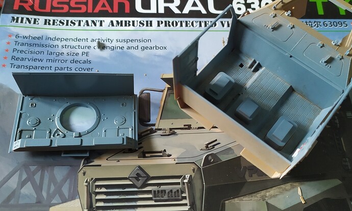

I decided to work on the cabin first, and attach it after… it doesn’t work.
I managed to get it done… but it was a headache and I risked breaking the cabin apart.

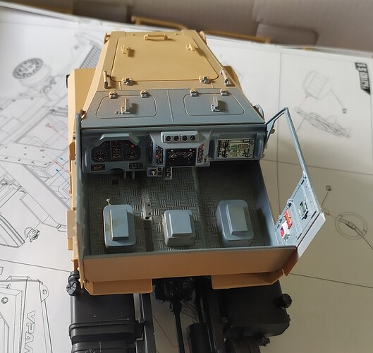

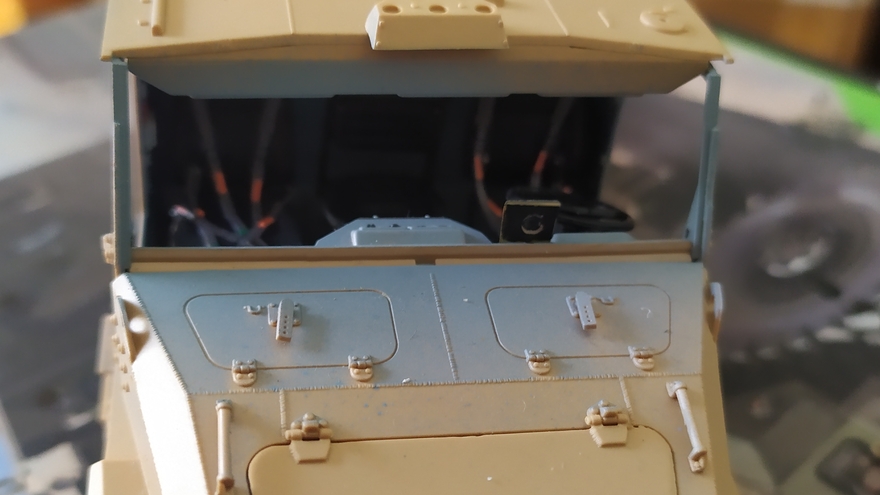

Thats a sharp looking cab.
Thanks Dan !

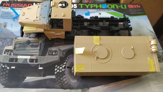

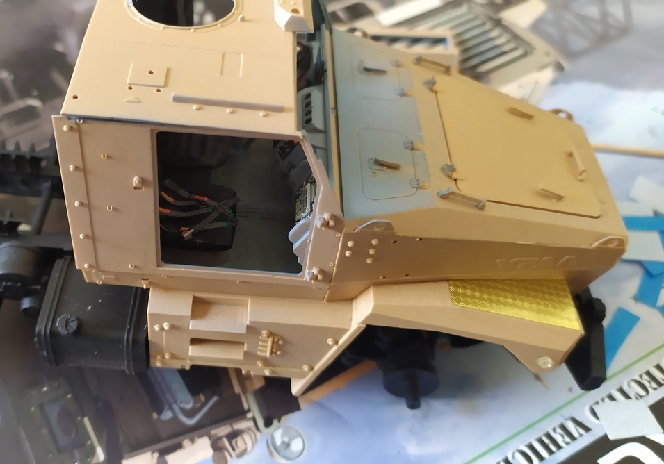

Some more work today,
It’s looking great.
Thanks, this one was a little behind.
I hope to work more on it soon,

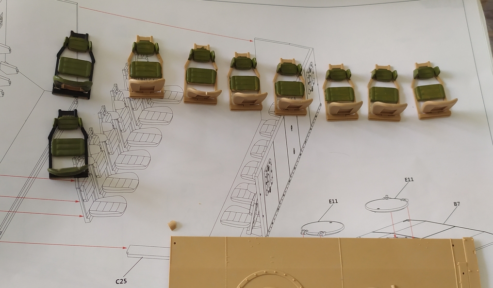

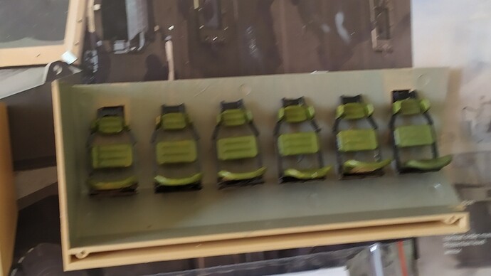

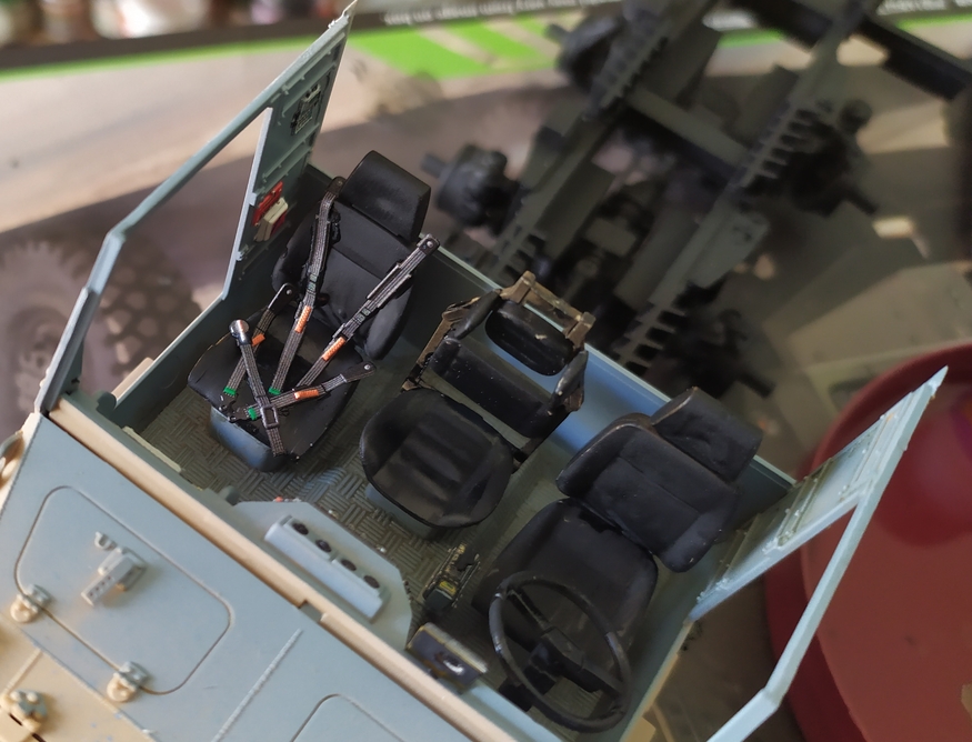

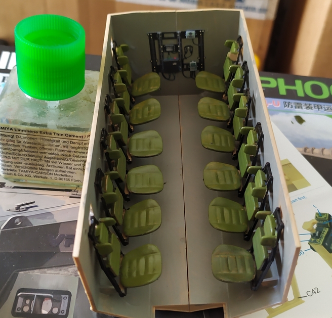

Added 3D seatbelts, worked some more on the cabin.
