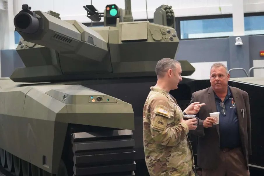

Now that’s a Category XIV model!
That’s one of the worst photoshops I’ve seen in quite some time.
I once mooted a M18 Hellcat with 17pdr Achilles turret as a WIF? (more accurately a WTF??).
