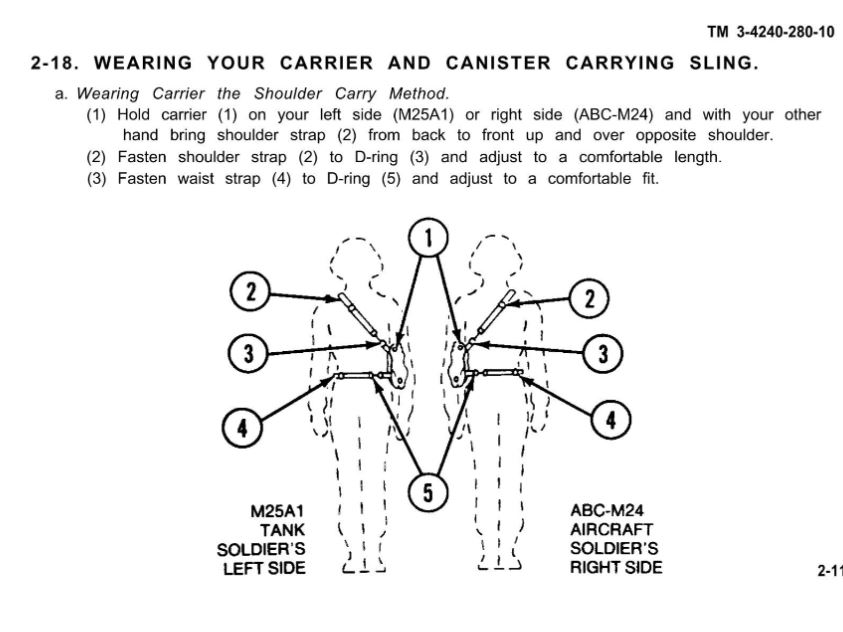

I understand this was the respirator type during the early to say, mid-70s, used by AFV crews. My first question is would it have been used by Sheridan crews in Europe, and also would the M114 crew have used it?
Second question is, would it have been clipped on/otherwise secured to their personal equipment - M1956 (which I thought would have been unlikely as such personal equipment would not have been worn inside an AFV)? assuming crews had M1956 in some form; correct me if I’m wrong please.
Would they have taken it with them is, for whatever reason, they had to dismount? Secured to their equipment or just slung?

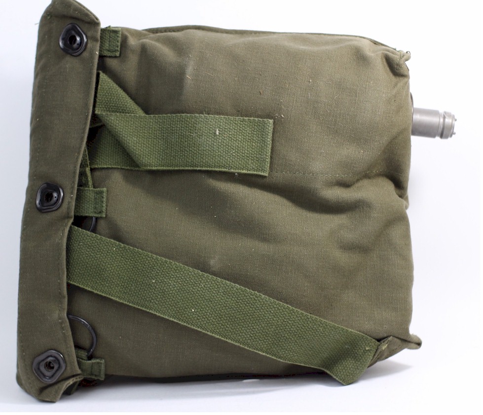

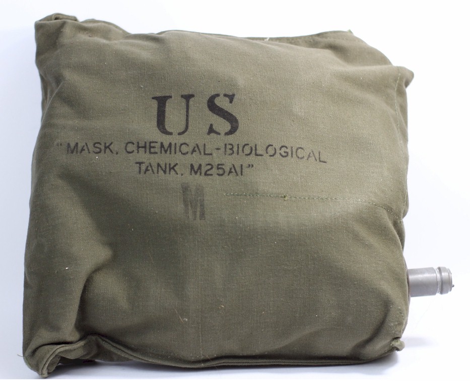

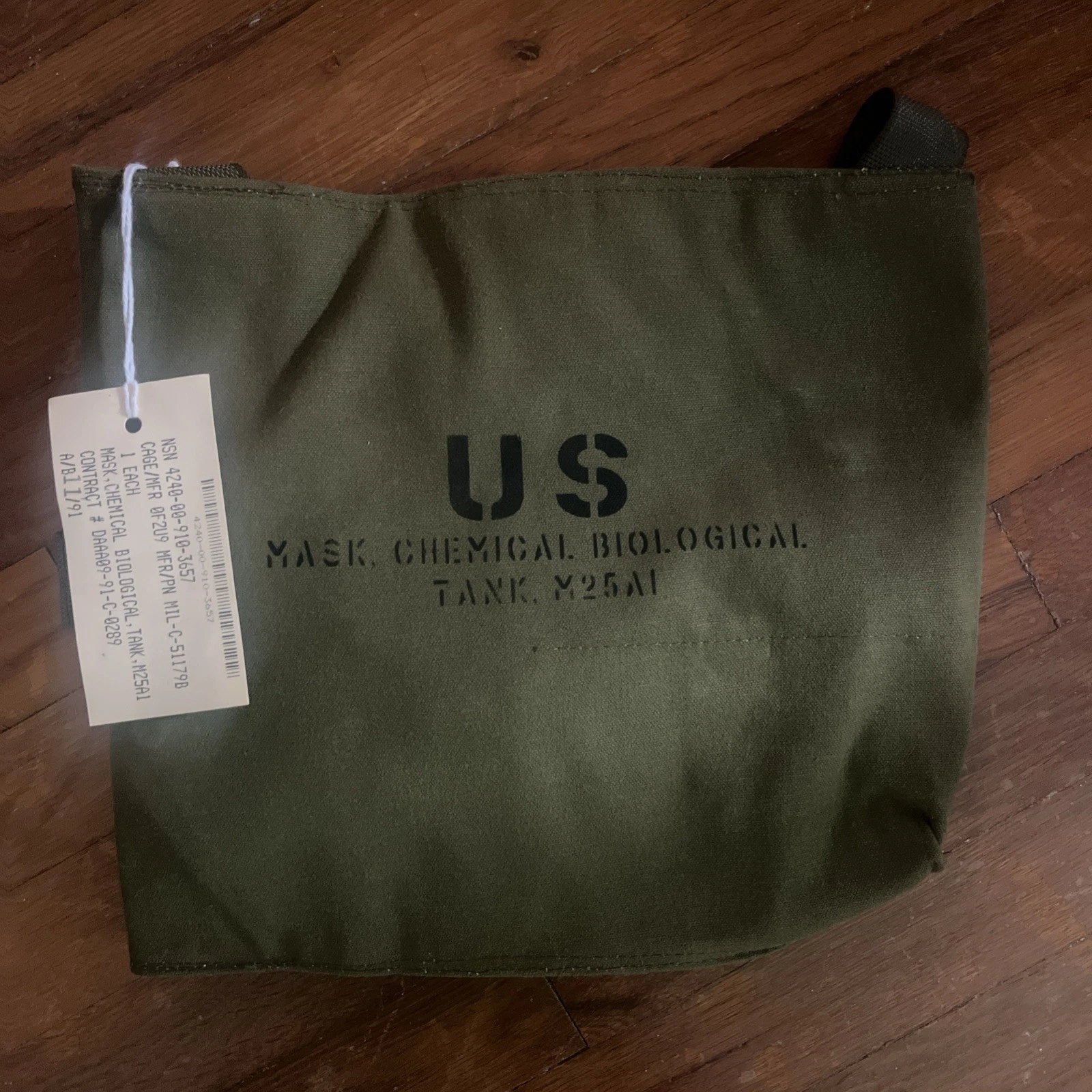

Lastly, any pics of the carrying bag (for want of a better term) would be welcome.

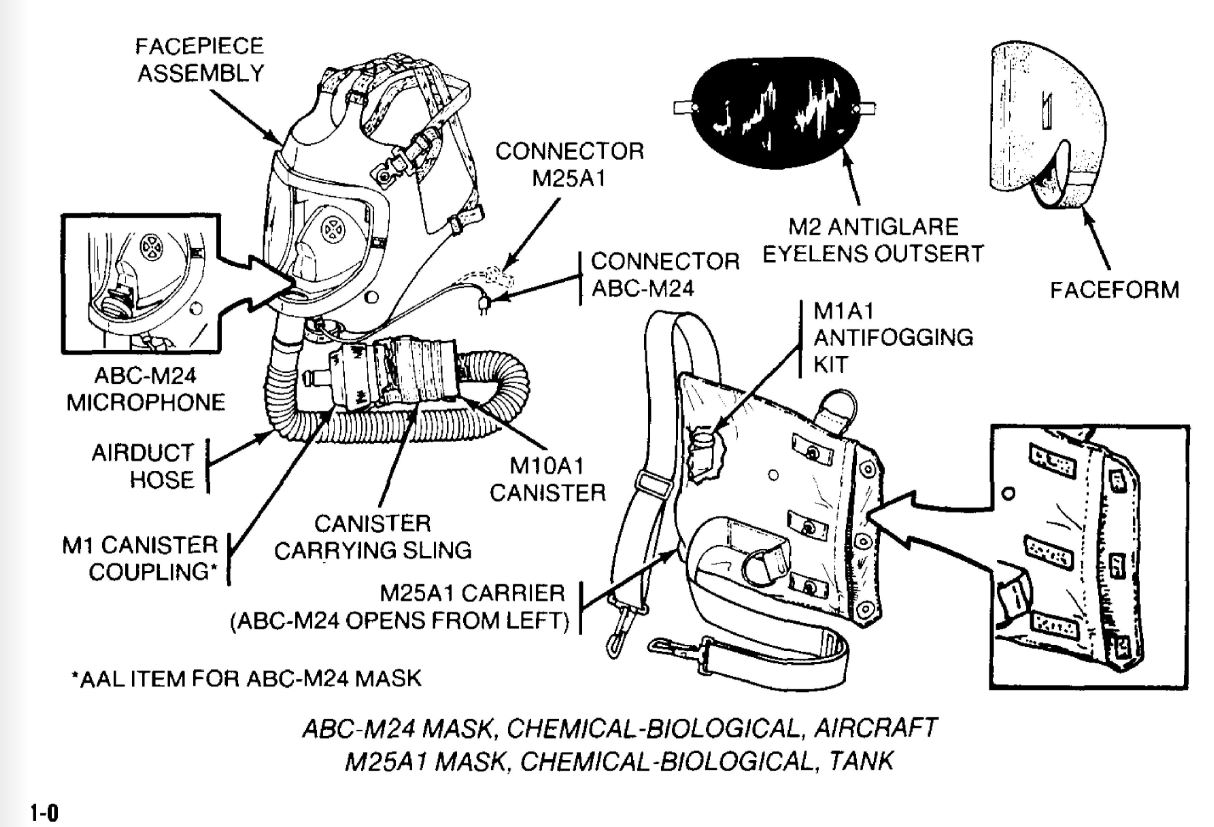

Thanks Frenchy, very helpful; I sort of need to know how it was worn about the person, when dismounted. I’m not sure I can work out what strap is what at the moment, but thanks anyway - great for colours, stenciling and the like.

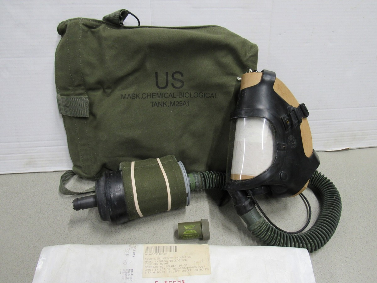

Another pic.

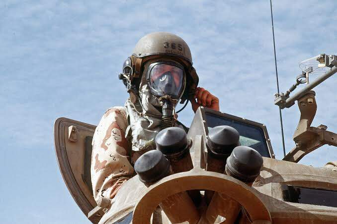

It was actually used up until the early-mid '90s when it was replaced by the M42 mask. It would have been on all US armored vehicles and was used on the M114 and M557.

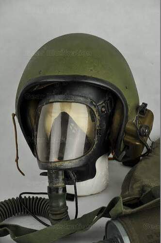

M25 mask with w/T56-6 CVC helmet.
USMC LVTP7 crewman wearing one in ODS ('90-'91) w/DH-132 CVC helmet.

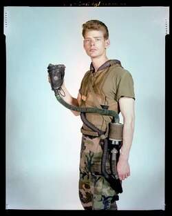

Worn dismounted.

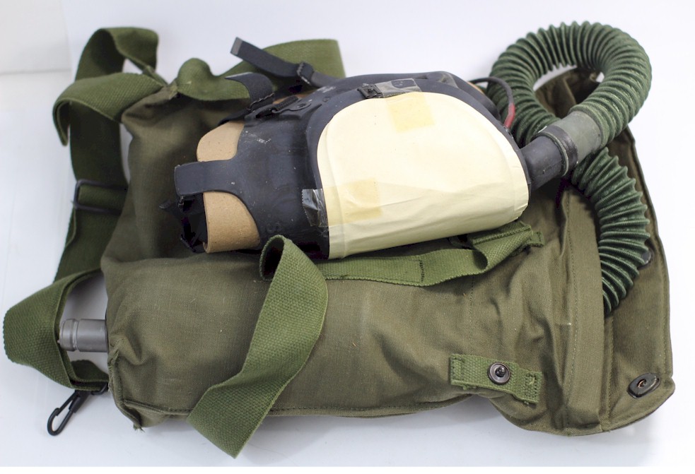

This set comes with a couple mask bags close to what you’re talking about

Yeah, it’s how it’s worn dismounted that is the problem; from the ultimate photo basically a fairly shapeless blob under the left arm (I think even I can sculpt that!)

Thanks for that; I’ve actually got that set but missed it!
Yeah, but I don’t need it worn as such, just carried.

It was the only mask at the time that had the capability to hook up to a vehicles intercom, so the driver and vehicle commander have to use it.
