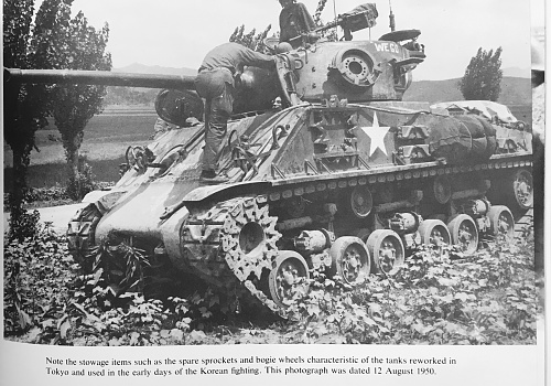

Wasn’t there a rebuild program under way in Tokyo? Not sure if they reached Korea, or what they were painted…
The Tokyo Ordnance Depot, in addition to repairing and renovating World War II equipment for use in Korea, instituted a program of modifying certain weapons and vehicles to make them more effective in combat. For instance, M4A3 tanks were modified for the replacement of the 75-mm. gun with the high velocity 76-mm. gun, and the motor carriage of the 105-mm. gun was modified so that it could reach a maximum elevation of 67 degrees to permit high-angle fire over the steep Korean mountains.”

Yes, there was a rebuild program of Shermans in Tokyo. Being an Army depot from the occupation forces, they likely would have used whatever OD paint that they had at the time. There was something about the external stowage configuration, a spare sprocket ring on the hull side or something like that, that set those tanks apart from stateside rebuilds. And yes they did reach Korea. I’m going off memory of the old Squadron Armor in Korea book for this. It’s been awhile since my M46 build and last looking at this book from my reference library.
Here is a Tokyo rebuild E8
