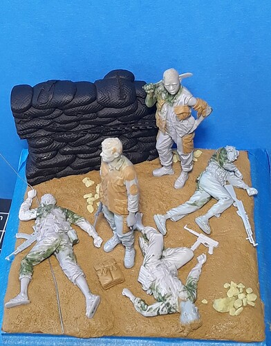

Made some progress that gets me one step closer to starting the groundwork and then painting.
I was originally going to sculpt a sleeve onto the left arm of the guy with his shirt open, but it did not turn out quite like how I wanted it to. I scaped it away and decided to sculpt a field dressing instead. It explains why the figure has only one sleeve and I think it adds to the perception that the fighting had been pretty fierce.
I used some AK Interactive Green Putty to fill in some gaps. It is OK, but I don’t like it as much as I liked the old Squadron Green Putty.
I changed heads on the dead VC laying on his back. I carved a star shaped entry wound to his forehead and have an exit wound barely visible in the back of his head. Most entry wounds to human bodies are just a small round circle depending on the caliber. Head wounds are a bit different. Sometimes it will just be a small entry wound depending where it impacts. Other times, such as a shot from close quarters, the impact can cause a shattering effect resulting in a starlike shape. To keep with the theme of this having been a desperate close in fight, I decided to make a star shaped entry wound to indicate a shot from a close distance.

Great figures, balance. Everything works well. Will spent cartridges make their way on once everything is nearly finished?
Thank you.
Yes, there will be shell casings, empty magazines, and perhaps a satchel charge strewn about. There will also be a claymore clacker in the bunker opening with wire leading out towards the viewer.
I value your opinion. So since you are good with how this is going, I will continue.
I imagine the platoon sergeant has many thoughts going through his mind - I hope my wounded Soldiers make it. Why did some have to die? It was one heck of a fight. Charlie gave it his all. Look how close they got to possibly overrunning us. Thank God we had so much firepower on our side.
The young Grunt is glad to be alive but is sad for the buddies he lost and those who are wounded worse than him.

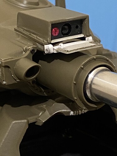

My 1/16 M551 Sheridan tank Vietnam.
I have been working on this for a few years, due to a on going health battle and still needs finishing.

That is so cool! I’ve wanted one of those monster Sheridans for years now. I’d better start saving up!

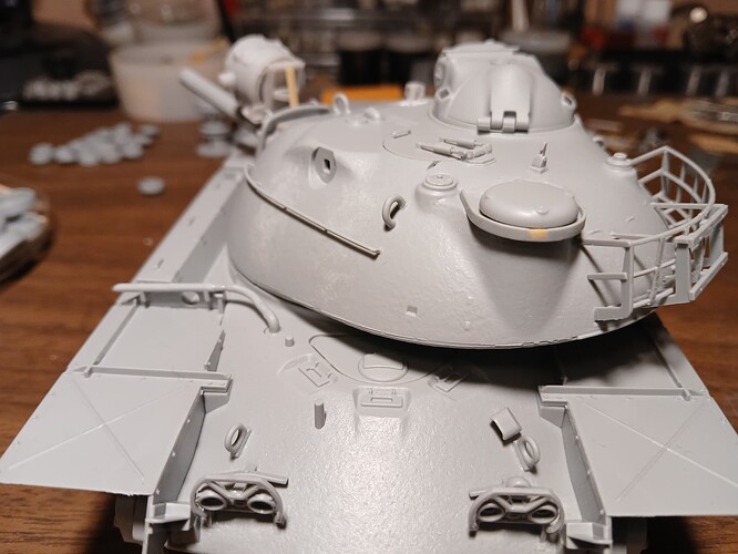

A few things to do yet but getting close . . .
Probably the biggest hindrance on this model build was not having an authoritative reference for the Patton tank, this series of battle tank can be perplexing to say the least . . . even within a specific design model the variations can leave you scratching your head, driving light brush guards, tail light guards, track return rollers, muzzle brakes, TC cupola configuration, personel heater vent pipe location, gun mantlet, all these items change from one production model to the next but each upgrade can carry both new and old design features, this what I’ve tried to portray in my version of the M67/M48A2.
I have to give Dragon a thumbs up for this model, its been a fun build, parts fit has been precise, directions easy to follow and casting in some cases ingenious.
Anxious to get some paint on.

@agincajun - did you see the drawings showing the whole left side of the turret being occupied by the fuel tank for the flamer? That’s also why this tank only had a crew of three:

I did see this cutaway diagram of the fuel, air and CO2 tanks, how would you like this to be your ride to work every day? The most useful guide for this particular build would have to be Mike Petty’s revue here . . . AMPS Reviews - Dragon - M67A2 Flamethrower Tank - Armor Modeling & Preservation Society, it was like having Cliff notes for the model although I didn’t follow it step by step, there are some differences between our two models.

@agincajun - a flametank is many times scarier than a regular tank - both for the bad guys and the crew… I wouldn’t feel comfy next to that big fuel tank knowing tere are guys with rockets around…
