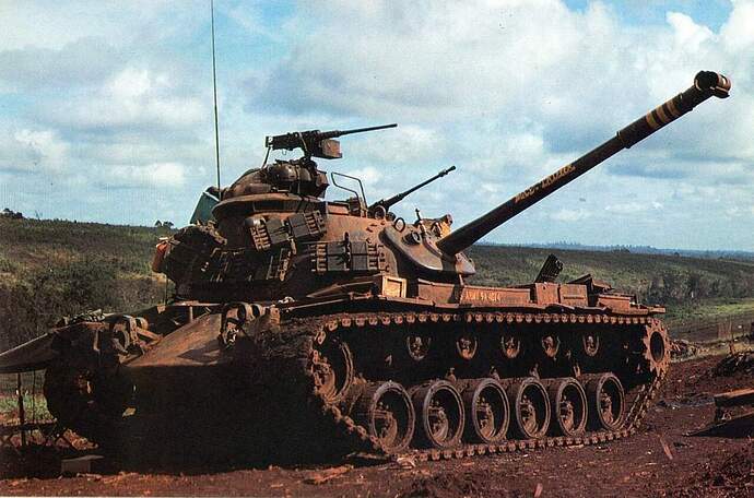

There were three M48 variants used in Vietnam
M48A2C
203058
460F97E7-D5C3-4BCF-ABFD-BF744414A9D1
M48A3
M48A3ModB
pattonvietnam-63
AFAIK all M48 variants seen in Vietnam were fitted with the M1 cupola, with or without the G305 riser

Even the M48A2C has the M1 cupola. Only the original M48 had the Urdan-style cupola w/external .50 cal mount. All M48s from the M48A1 forward had the M1 cupola.
Slingshot Models makes the original M48 cupola. It would take some work, but you could backdate an M48A1 to an M48. Both Dragon and I Love Kits offer M48A1s.
The M48A5 used in Korea had an Urdan-style cupola as well. Takom’s kit has these parts.
You can use the Dragon Magach 1 & 2 kit to make a M48A2C. You’ll just need to source some appropriate decals for it.
can’t say I ever saw one without the riser under the cupola, but of course didn’t see everyone over there. There is a photo of one that has two risers on it that shows up every now and then. Who had it; I don’t know. I’ve seen Army and Marine tanks with a post welded to accept the standard M2 gun cradle, and I’ve seen them with a standard M2 tripod simply welded to the turret to. Still like Gino said they all were shipped with the cupola.
