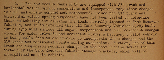

The correct designation was T14E1 for the initial batch of M32B3s built on M4A3 (105 mm) HVSS tanks. These all went to the USMC, but when the US Army also wanted HVSS on their M32s, then as @Frenchy says, the designation got “A1” added between the M- and B-numbers. So an M32B1 (that is, an M32 with a cast hull) becomes an M32A1B1 when fitted with HVSS.

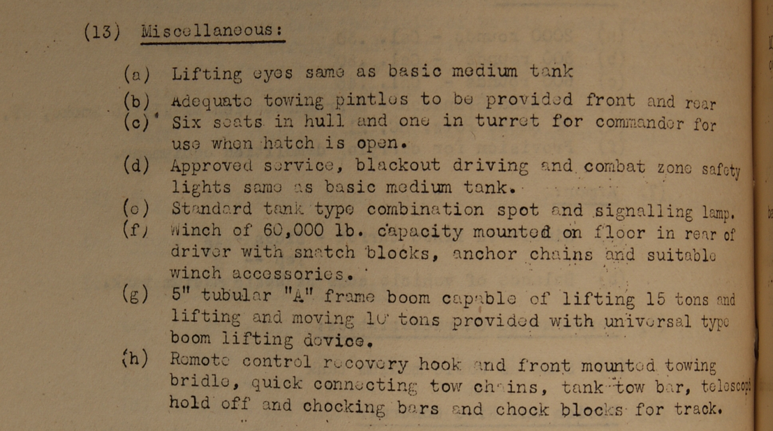

That’s not correct. This is what went into the A1 designation, from the Ordnance document that assigned the designation:
(The equivalent document for the M32 also had 5-inch diameter tubes in the boom.)
The A frame had to be changed because of the HVSS, but this was part of the T14 designation, not a separate model revision in its own right.
All sources claiming that the A1 designation indicated HVSS are incorrect, likely based of Hunnicutt’s misinterpretation of the source documents.
