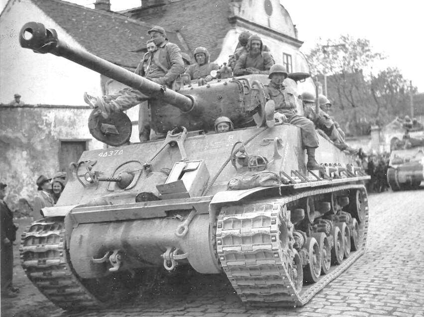

Here are some photos I found real quick
These guys appear to be wearing the soft helmet under the steel pot.

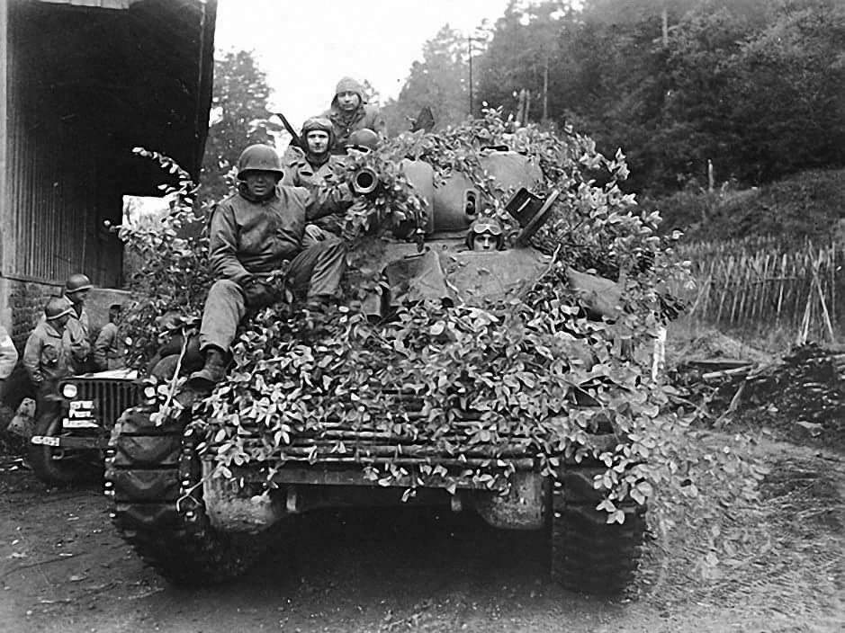

This tank crew is wearing the hard helmet, the infantry riding on the tank have the regular steel pot.

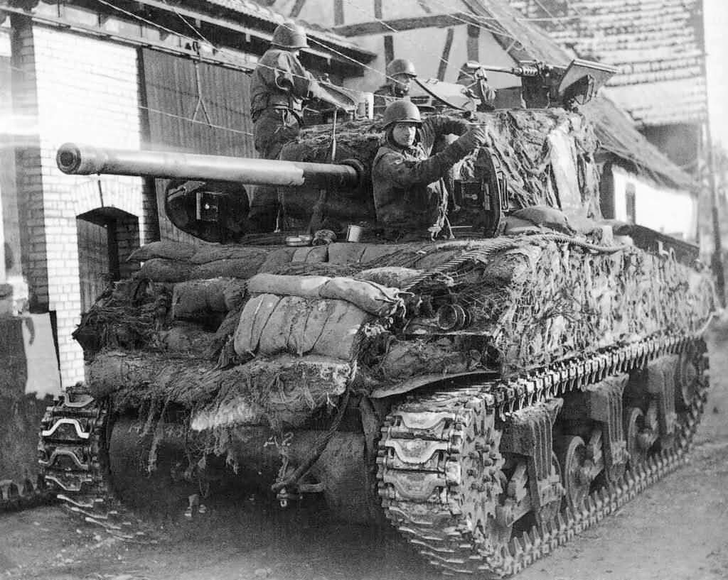

This picture has a mix of both.
Did everybody note the track mounted the wrong way round in the first pic? Try and explain that to a contest judge!
Actually it looks like only two links are reversed.
Good eye(s), all the same. I think I’ll do that for my next contest entry. When the judges poo-poo it, I’ll spring the photo on them. :rofl:
Just don’t do them randomly throughout the track run. That would be very unlikely, given that tracks were assembled at the factory and repairs would generally involve adjacent links (due to mine damage, for example).
