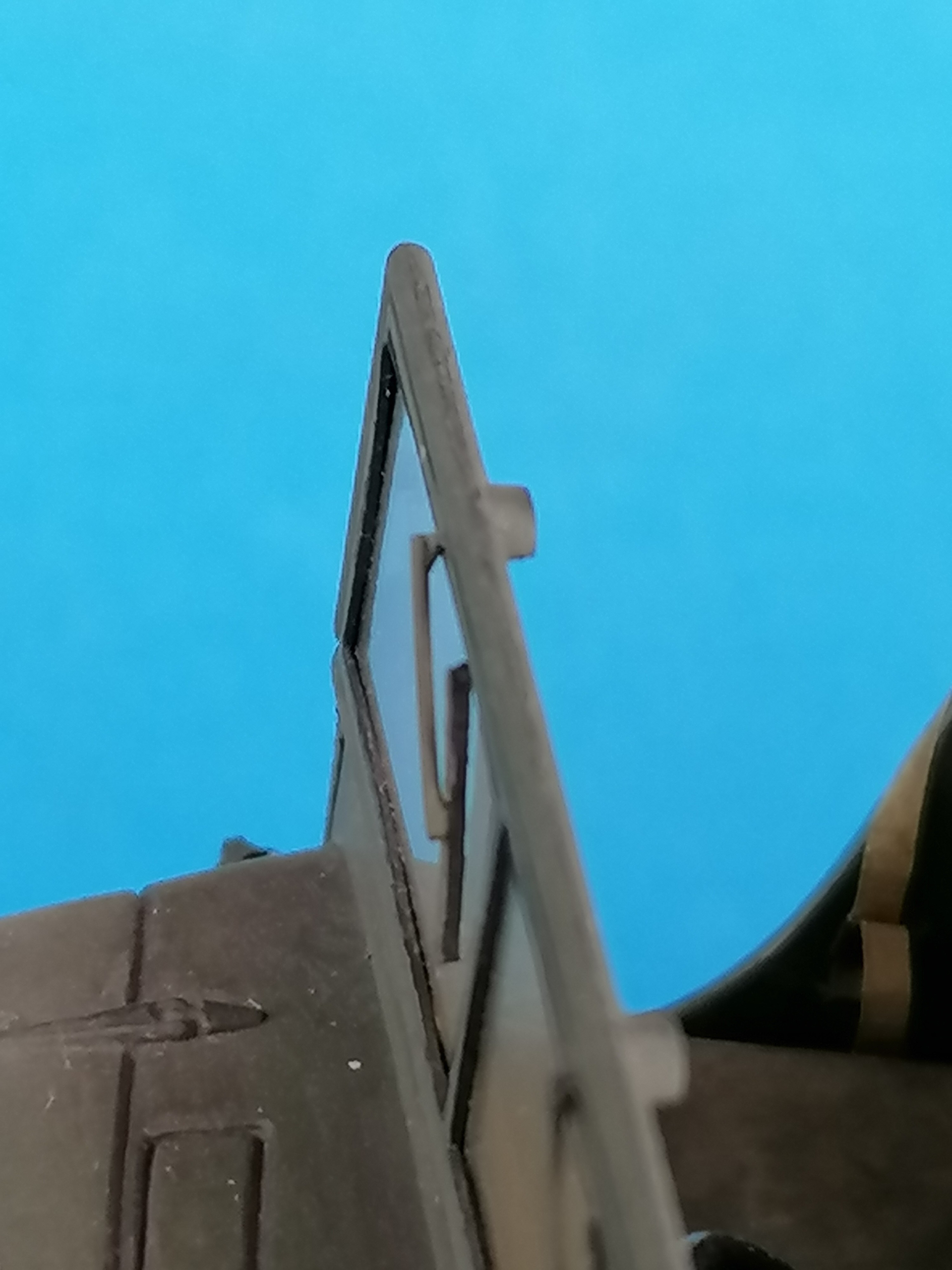

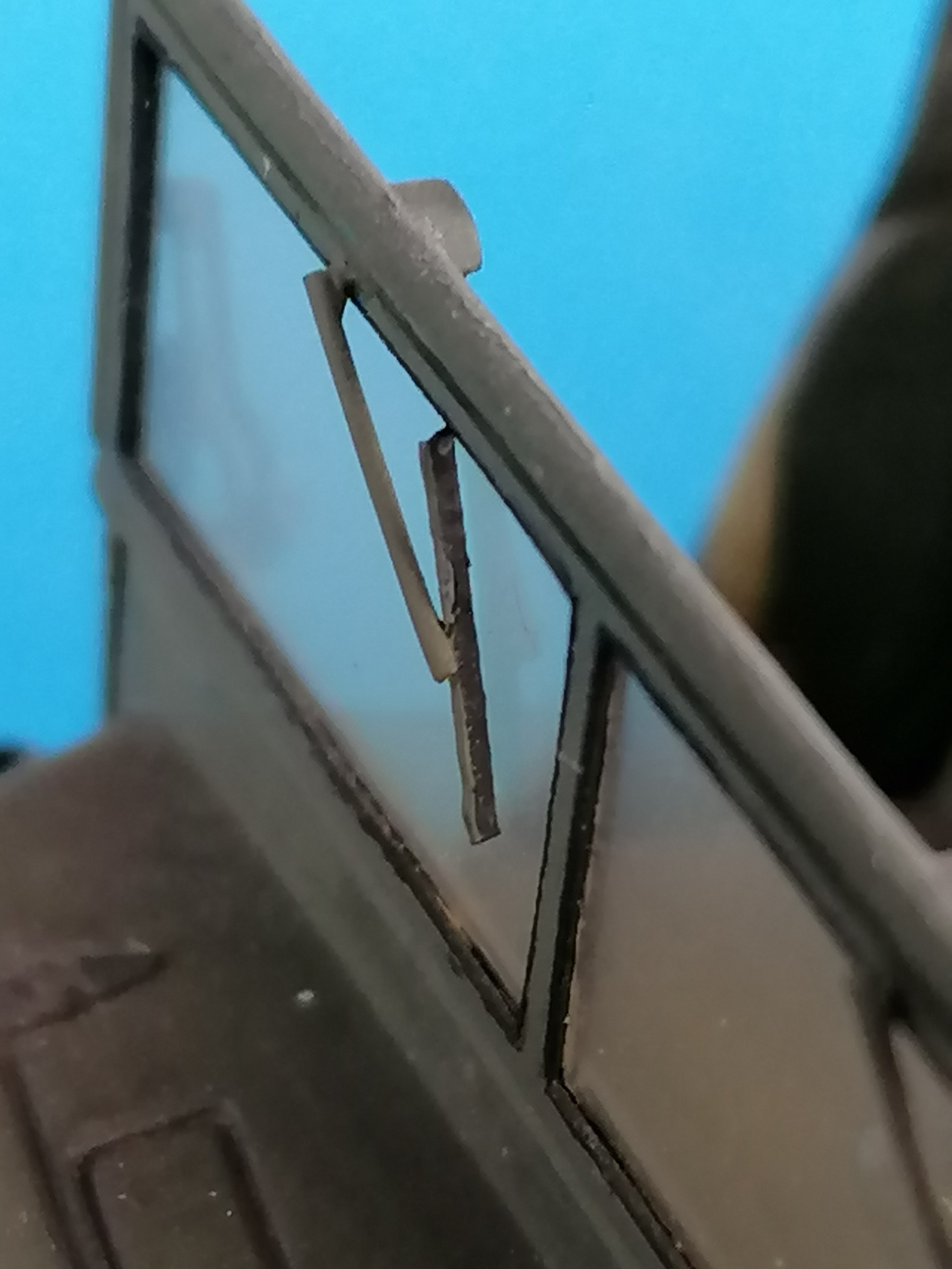

'Cause I’m unable to paint them to look like this:
Fair enough!
and a thin clear sheet of polystyrene, or other glueable plastic,
looks a lot better than the “armoured” glass provided in the kits.
Windshield part is 1 mm thick, at 1/35th scale → the 1:1 scale windshield
would be 35 mm thick (1.35 inches …)
Getting a perfect fit is a hassle though
