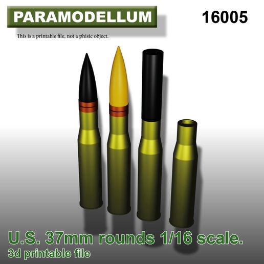

If you have a printer or know someone who does/printer service,
I don’t think you need a printer for this but not sure.
That’s great, thank you. I don’t have a printer nor know anybody with one. So I’ve contacted Battleground Models, to see if they post to the UK, especially with the current state of the tariffs debarcle.
Just hope somewhere in the UK the gauntlet will be picked up and produce similar items.
Google uk 3d printing service. There is number of options, not sure if one fits your needs.

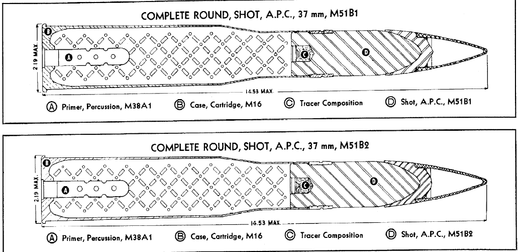

Here’s what the 37mm rounds for the M3, M5, and M6 looked like:
This cartridge would be 0.908 inches long in 1/16. Something 0.908 inches long in 1/35 represents a real life object that is 31.78 inches long.
A 37mm projectile in 1/16 would be the same diameter as a 81mm projectile in 1/35. The first thing to do would be to look for ammunition that is close to the shape shown here, and ignore those that don’t. From that group, look for cartridges that are around 31.78 inches long, and discard those that are far off. If you find anything that passes those two hurdles, see if that ammunition is available in 1/35.
I suspect you’ll have a hard time finding any ammunition that is suitable.

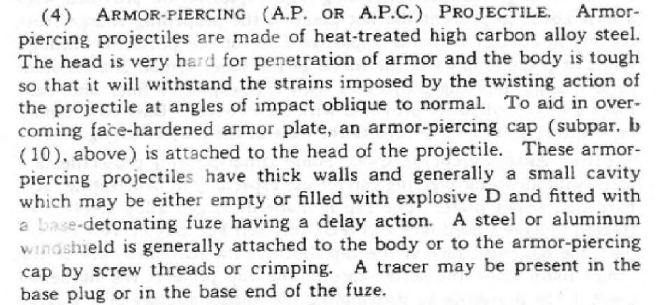

I look at the illustrations, and my CDO (it’s just like OCD, except the letters are in alphabetical order. AS THEY SHOULD BE.) pings on the mislabeling in the original illustrations, because the thin ogival cover on the nose of the projectiles make them APCBC (Armor Piercing, Capped, Ballistically Capped), not APC.
It’s odd what little knee-jerks your memory throws out.
It’s labeled correctly, in accordance with US definitions and nomenclature.
It’s like the UK HESH and the US HEP, or lorry and truck.
That’s why the abbreviation has a D for Disorder in there. Those little knee-jerks are a problem.
KL
That the definition does not draw the distinction does not mean that the distinction does not exist. Retaining the designation as APC after the ballistic cap became standard was an administrative shortcut to avoid the overhead in paperwork and logistics of adding a separate inventory item for the APCBC variant, since it was a straight-up upgrade of the uncapped round and would replace it in inventory as the uncapped rounds were expended. Not all of the streamlining and simplification of war production involved hardware.
You said it was mislabeled. You were wrong. It is not mislabeled. It is a US Army document and it is labeled correctly in accordance with the US Army nomenclature.
And D still stands for Disorder. I don’t think you are giving that the attention it deserves.
KL
