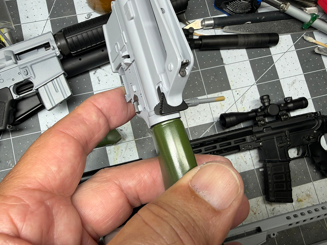

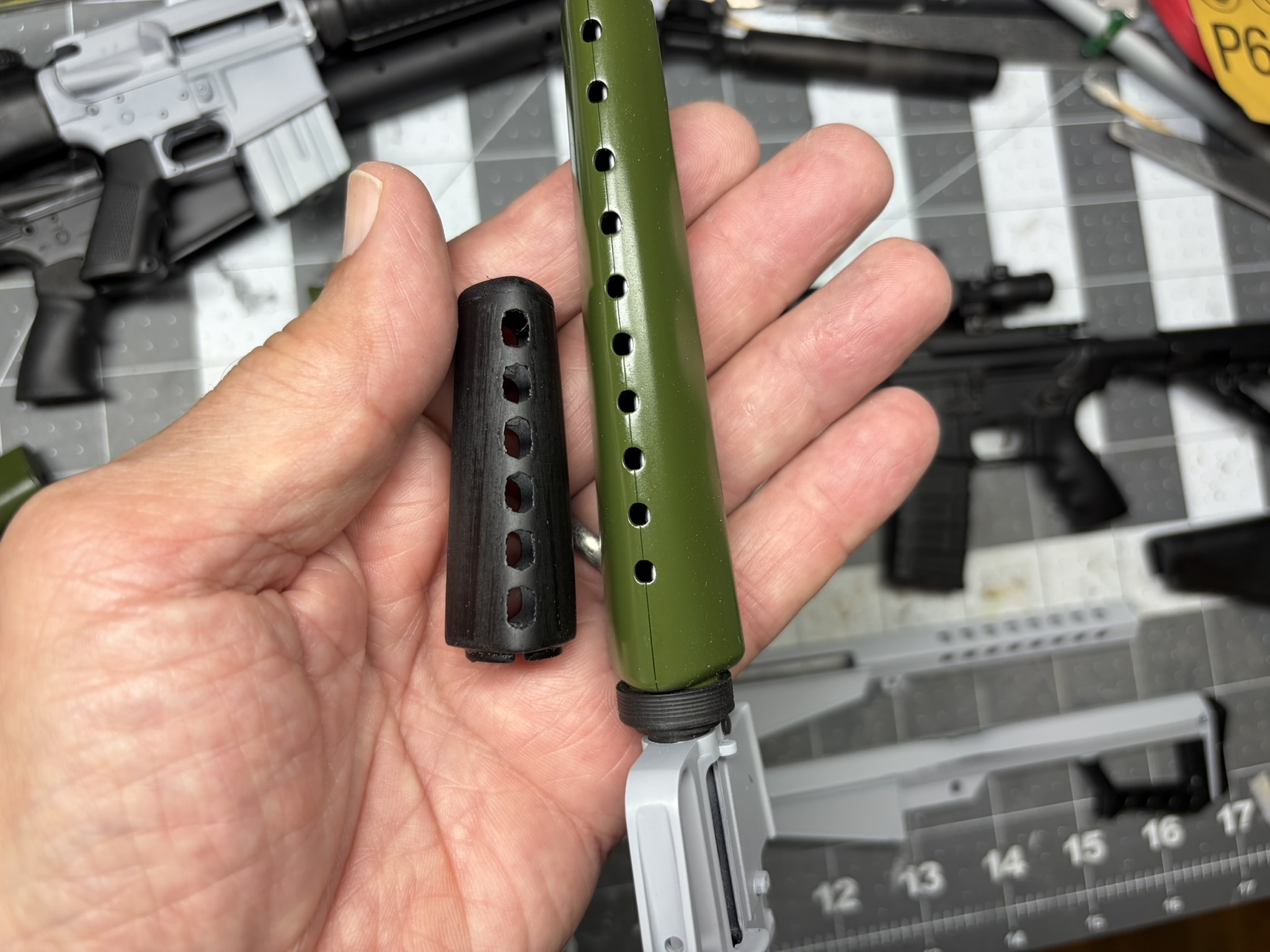

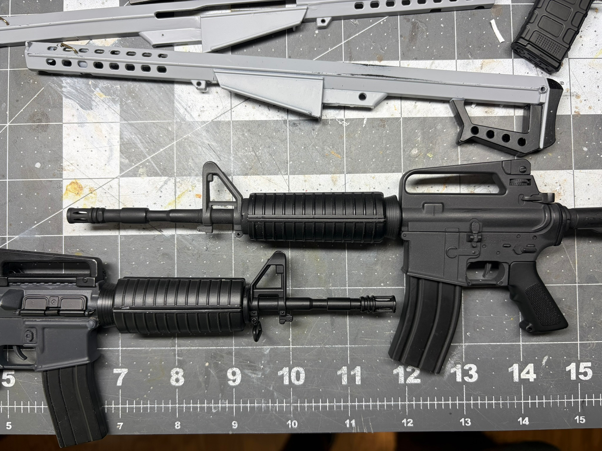

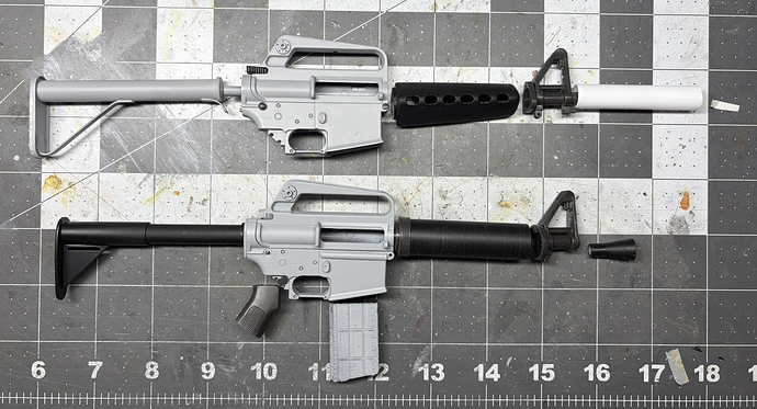

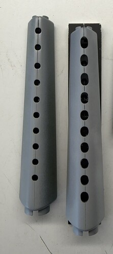

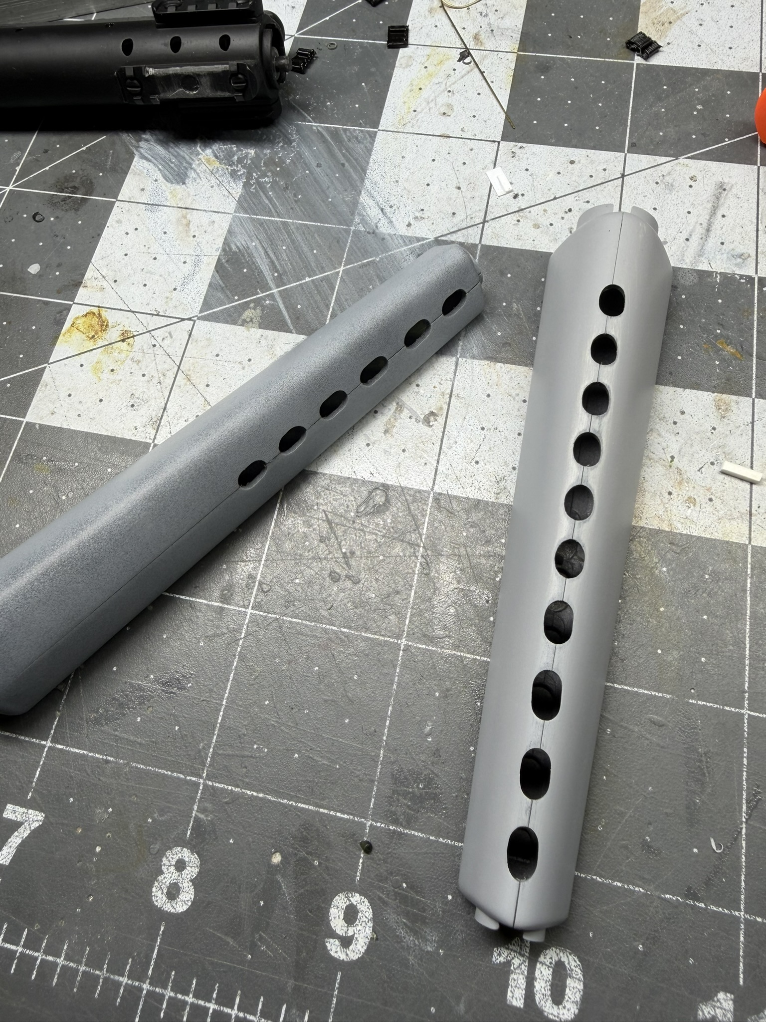

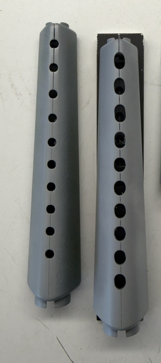

A couple months ago, I got this bug to finish a Trumpeter 1/3 M4A1 model I’d had in the stash for 20 years. Maybe something to do with building my first actual AR =) Anyway, I went down a rabbit hole as I tend to do. I now own 12 of the various models they offered, some Easy Model built-ups I found cheap, and yes even some Goat Guns! Chasing the rabbit I realized the Trumpeter kits have some ridiculously weird errors…considering the effort that went to mold so many different variants, they missed the fact that vent holes on the triangular handguards were not round, and their M4 handguards have too many ribs (13 vs correct 11). Also, the early model kits have later M16A2 stocks so I had to shorten them and create new butt-pads without storage, and a proper triangle charge handle for the earliest USAF build. I decided to also stretch my scratch skills so am building a few of the oddities.: 606, 607, 608 (at least three different ones), and the DOE 633 and DEA 635 suppressed 9mms. Some 3D printed parts, and using the Goat Guns M4 handguard to cast a few more in resin. The other Goat Guns are decent models in themselves save for the screw holes, so building those with CY and covering the screw holes. I’m having parts from my full size AR printed up and will build a replica of it. PS: an excellent source of STL files for all things AR is the airsoft community…all at 1:1 scale, I just have it printed at 1/3.

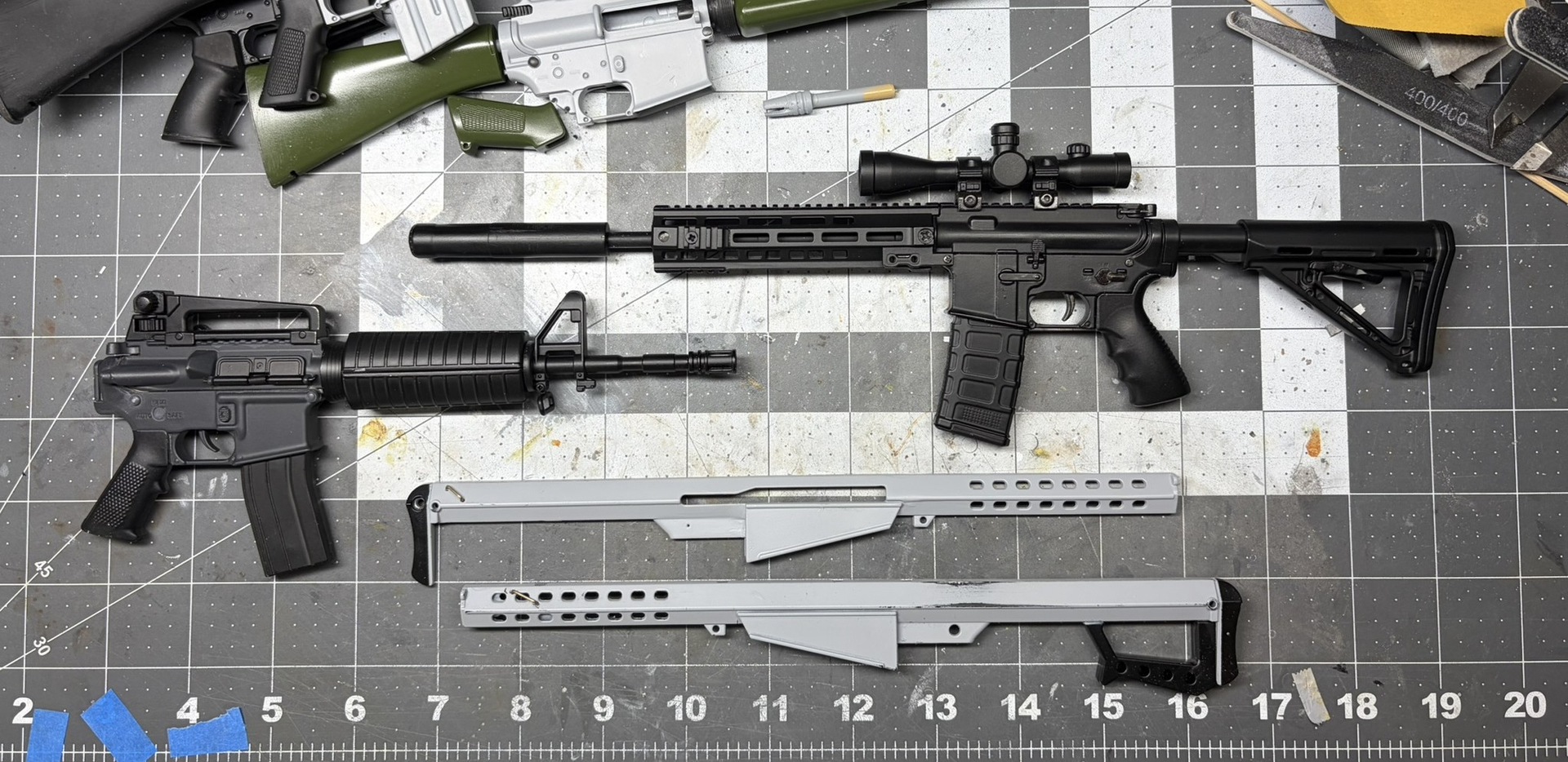

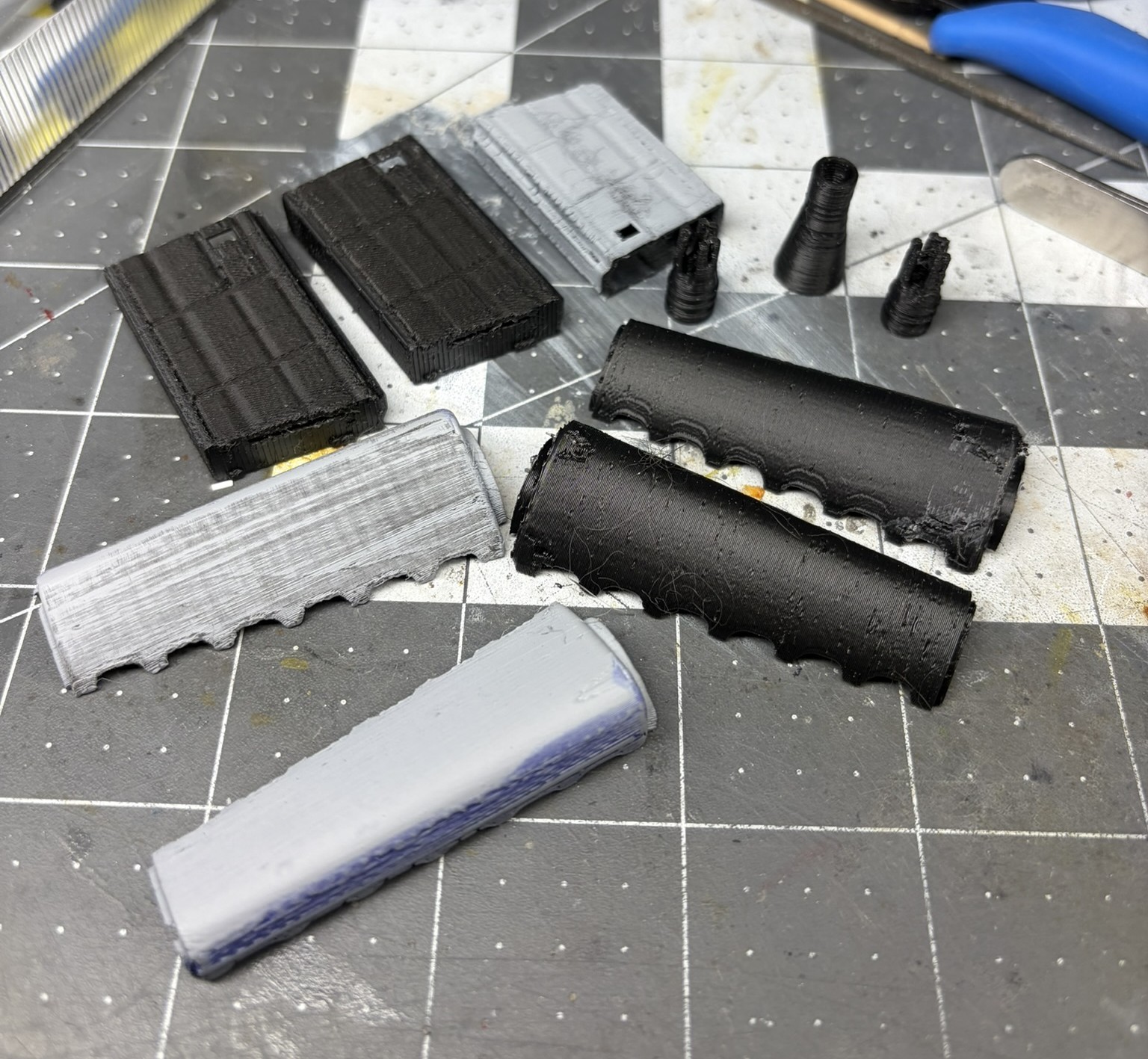

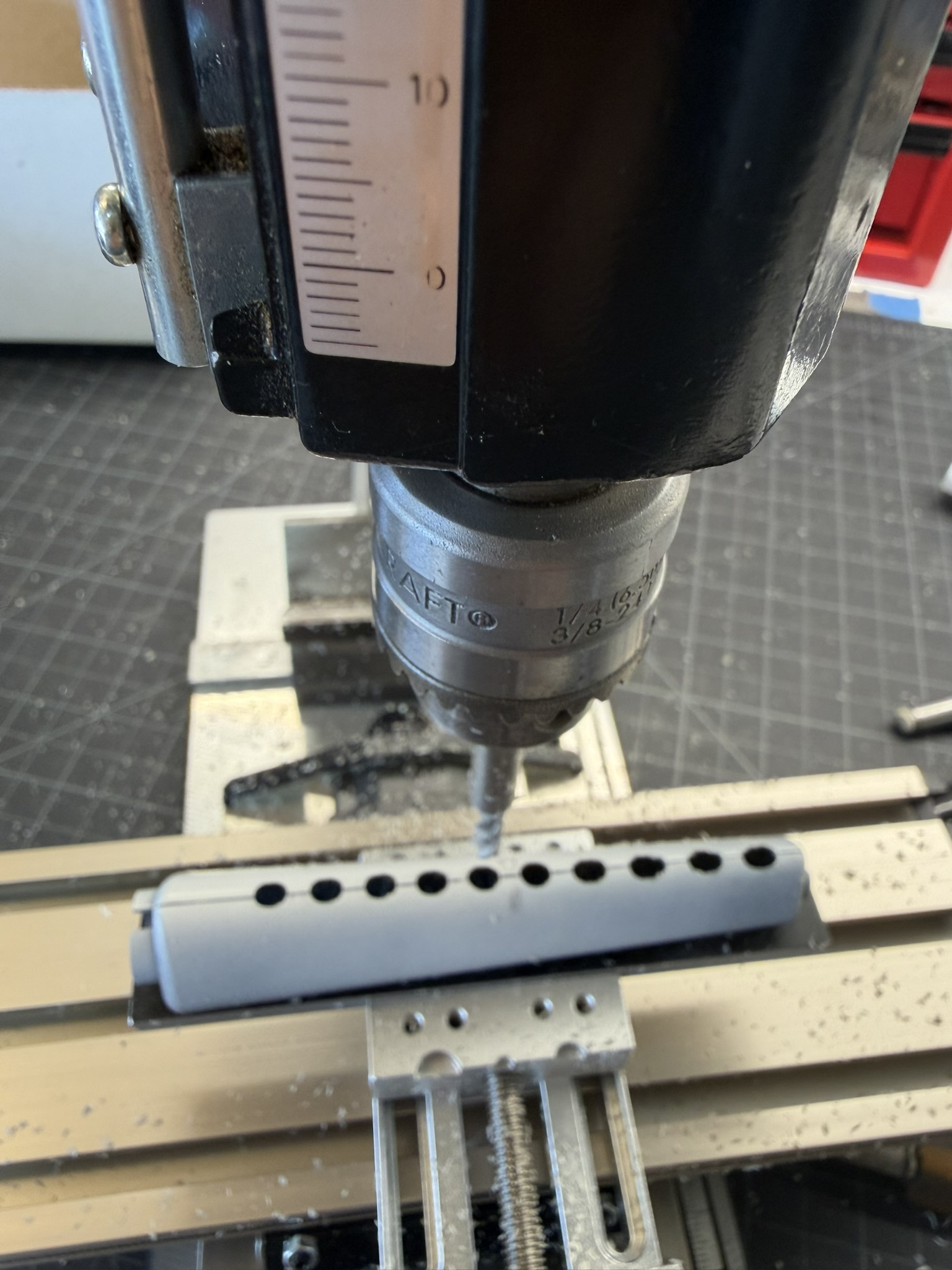

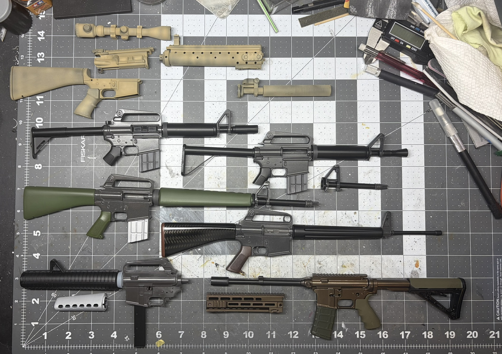

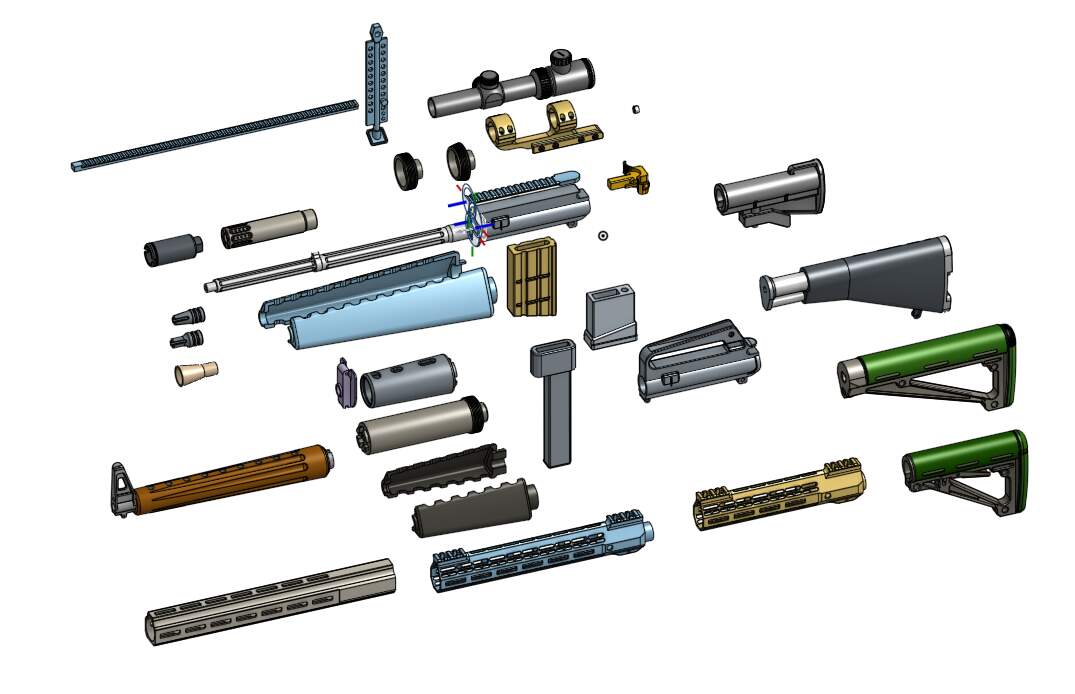

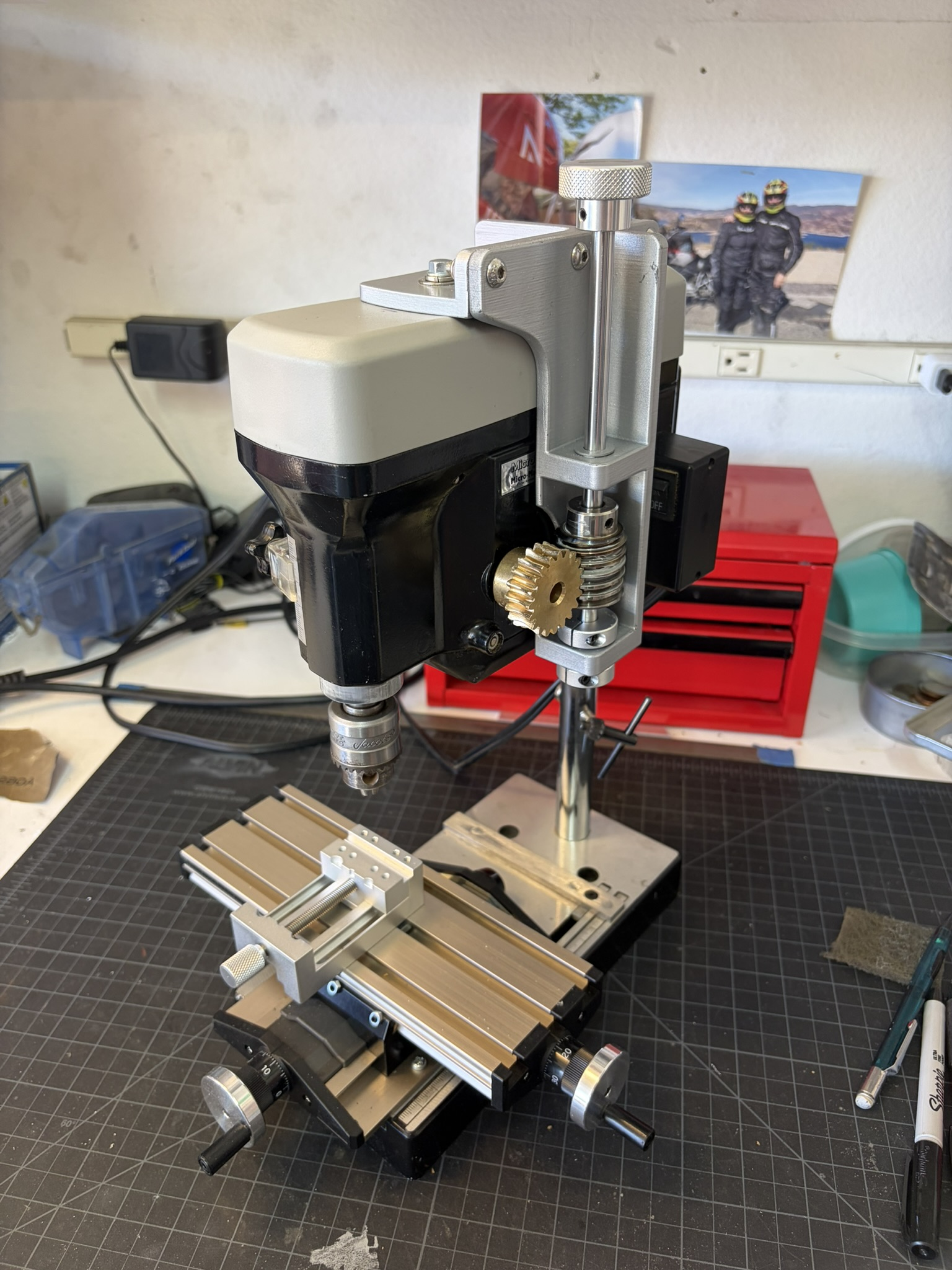

Some progress. I modified my MicroMark drill press to a sort of mill and slotted out the cooling holes in the Trumpeter parts. Looks decent enough. I found lots of f3D print files online, and had a few printed at 1/3 scale, but they did not come out right. So, I spent some time drawing up my own scale parts in OnShape and had some friends resin cast a few parts (not all shown in the image have been printed). Working on so many simultaneously is a bit distracting and progress feels slow. The further I get along, the more I find I need to change, correct, or do better. There are three more that aren’t in the photo. The bronze one is a modified Goat guns model, intended to represent one of my own ARs. I need to get this done as I will soon receive my ejection seat and that is a WHOLE new deal.

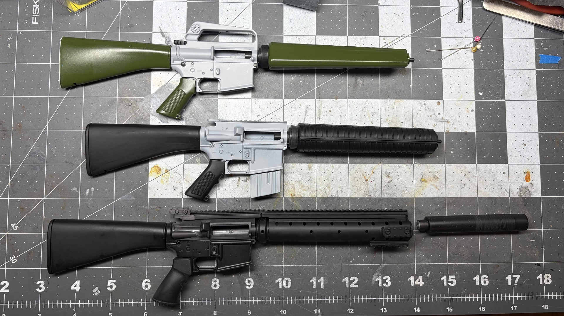

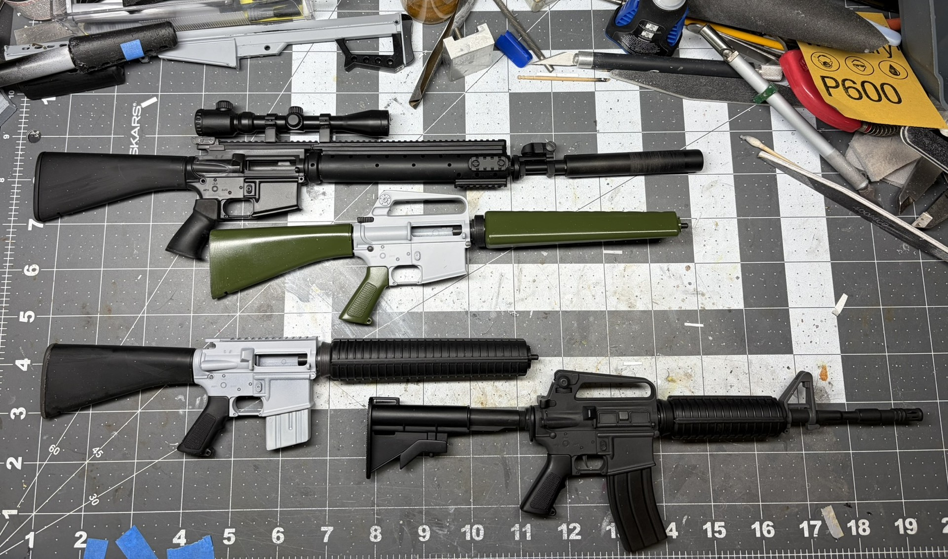

It’s been a bit of a slog, but seeing the finish line! Completed several, still have a few more on the list. These modifications use modified/corrected kit parts, scratch built parts, and 3D components I designed and had printed for me. I did use a Goat Guns bi-pod because it is really accurate and would have been a real chore to scratch/print. Speaking of which, the Mk 12 rifle camo is made up though based on schemes I saw in photos of the rifle in use by special forces…typically a rattle can paint job done in the field.
