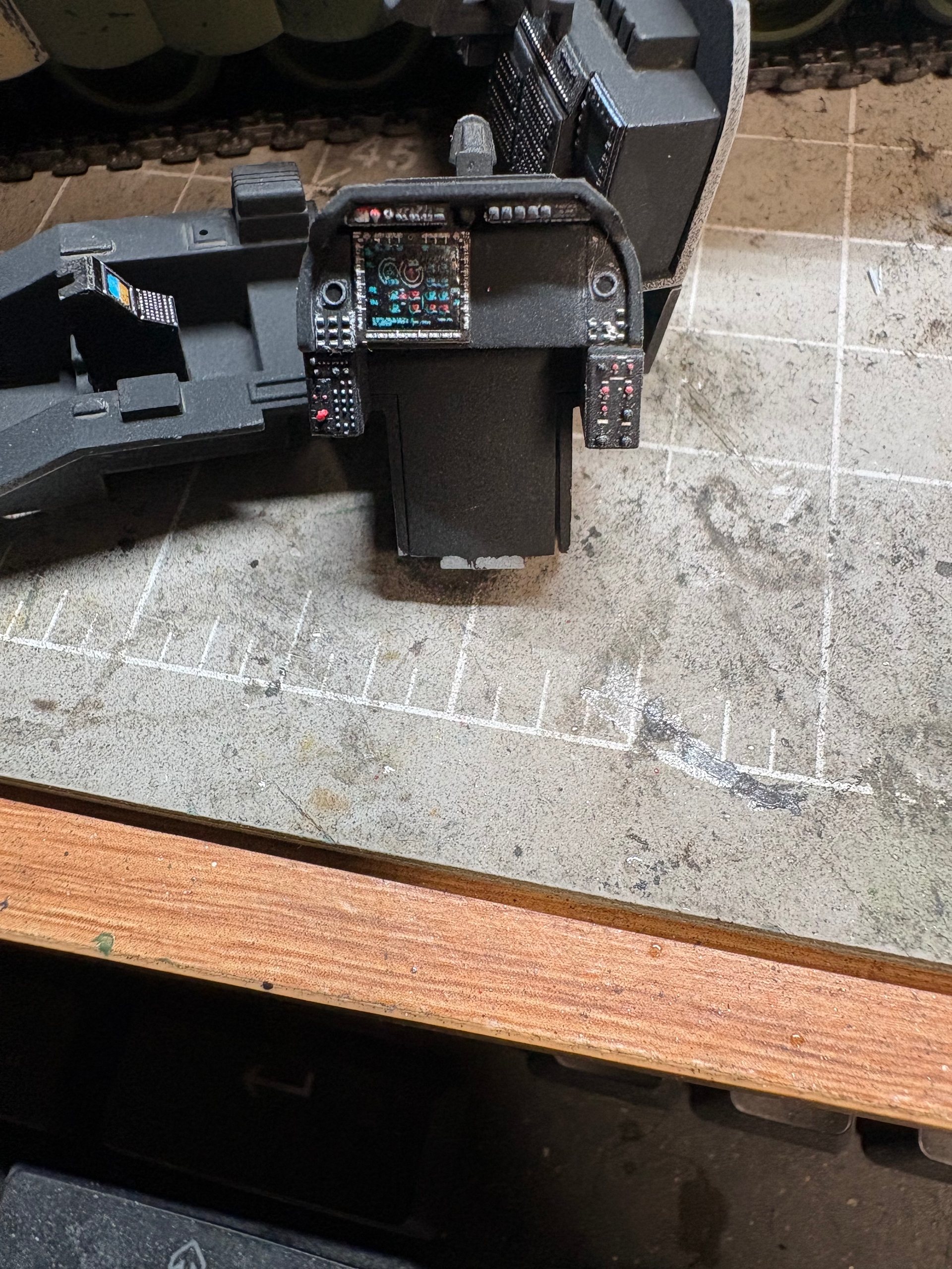

Got some updates! This is all i managed to get done in 3 days! I completely forgot that when i got this kit i bought the eduard set and tss

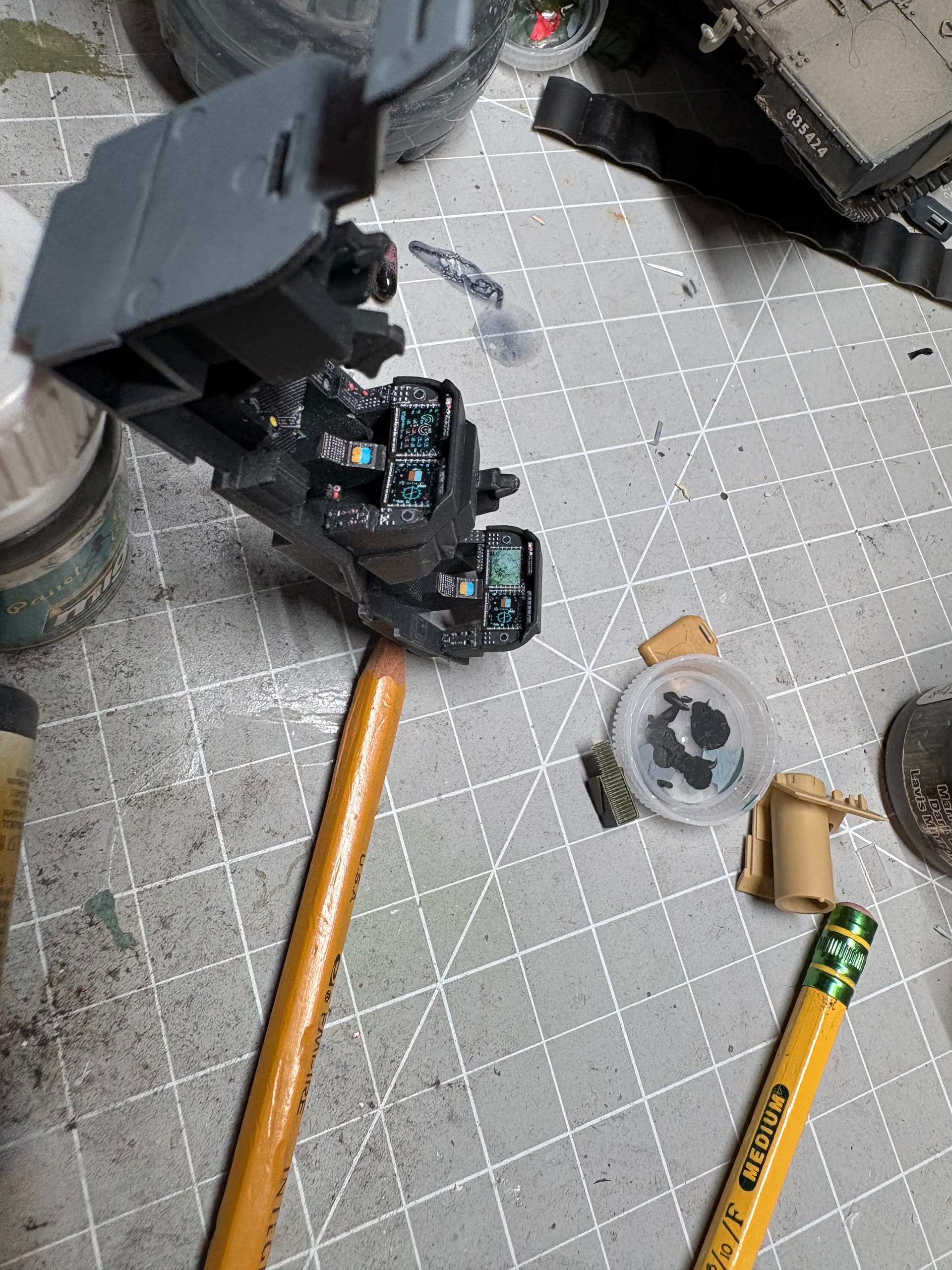

Got a quick update!

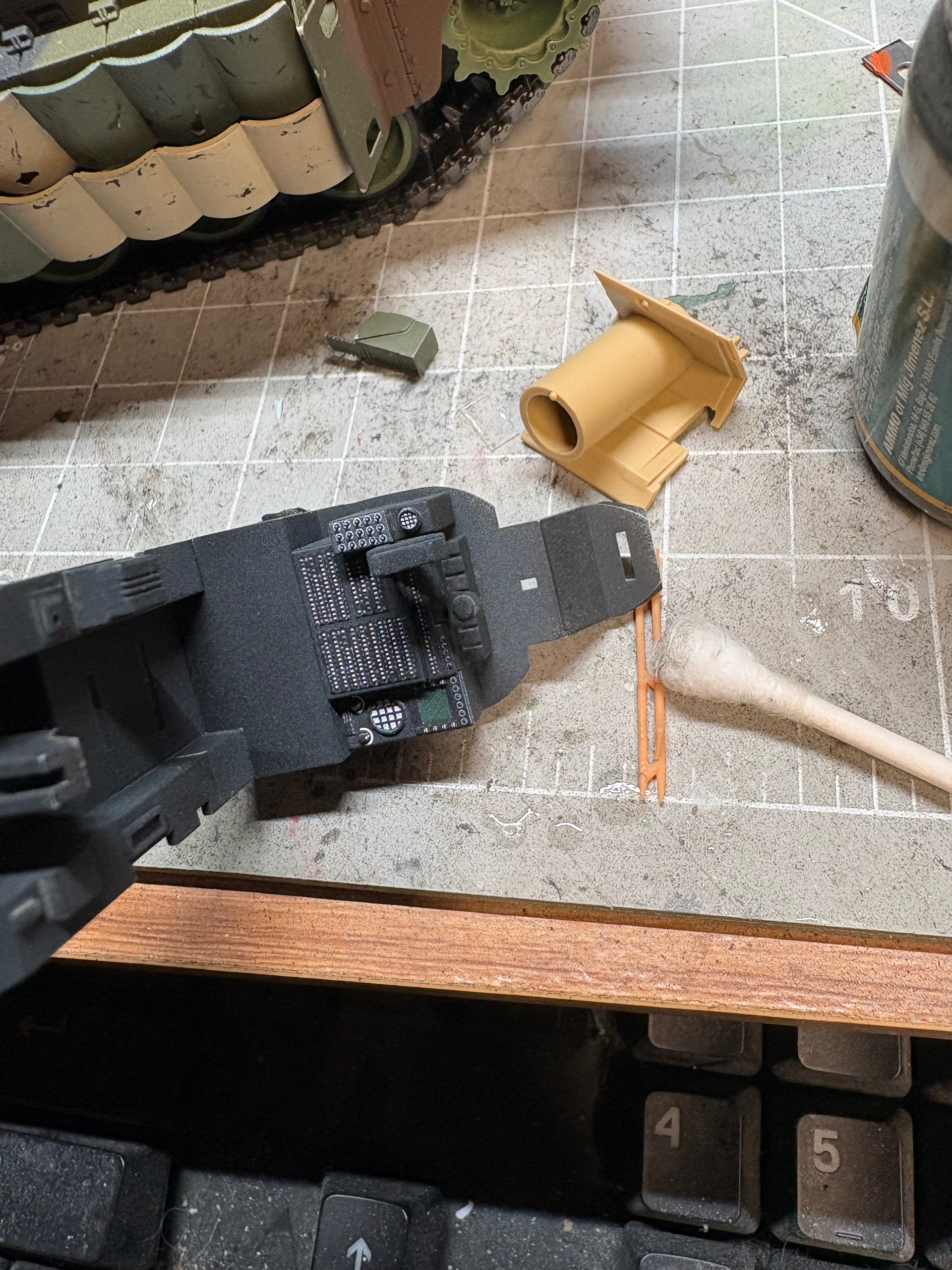

I know it needs cleaned up a bit but I’ll do that after the cockpit is done. Question… what color are the rudder pedals? I can’t seem to find and pictures, and i have a feeling they might be visible.
The pedals are a Light Ghost Grey colour, like the entire floor of the cockpit. It shouldn’t be black FYI!
I did not realize that! Good catch and thanks!

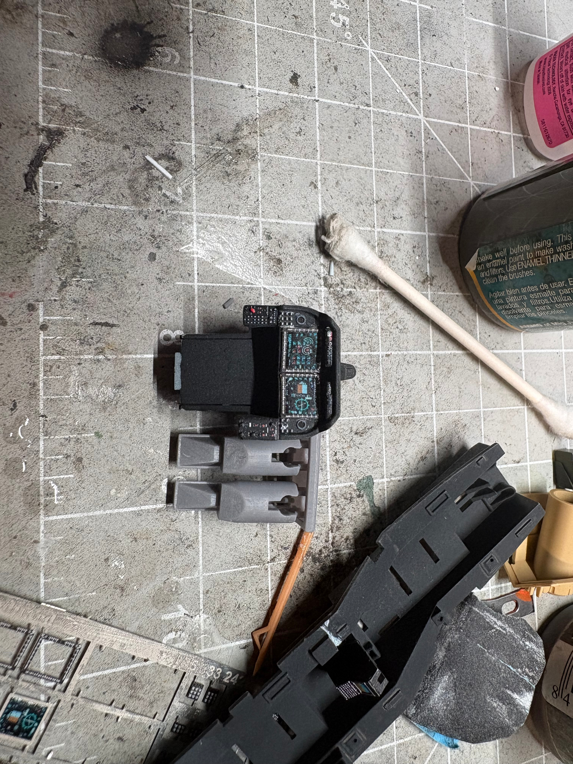

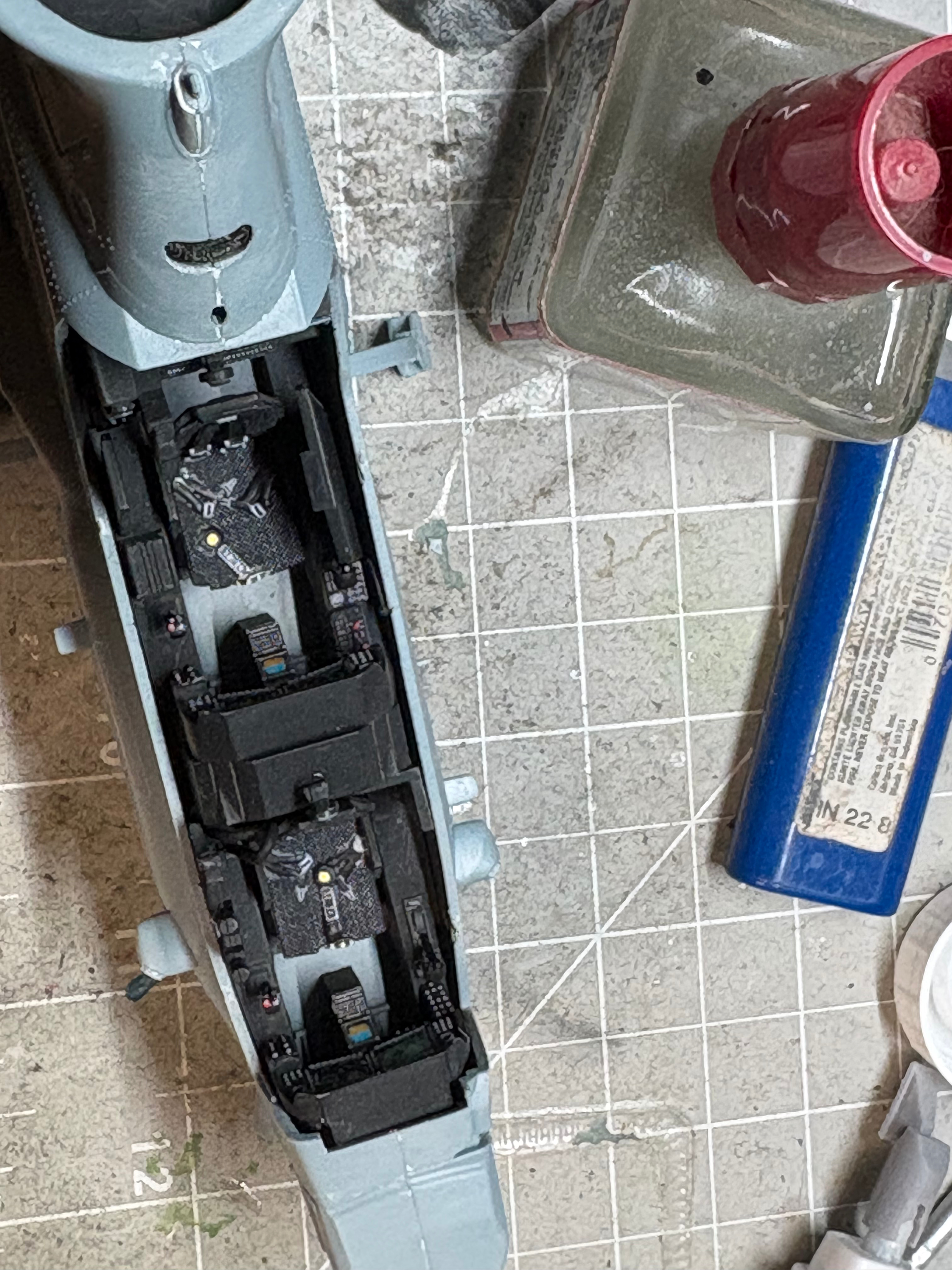

Cockpit is almost done… first time i used kelik 3d decals, i think i like them, no way could i have painted all those dials and buttons. Before i start the next part of the cockpit, does anybody have any pictures showing the ps controllers? I kinda want to put one on the pilots seat cause i messed up the seat belts

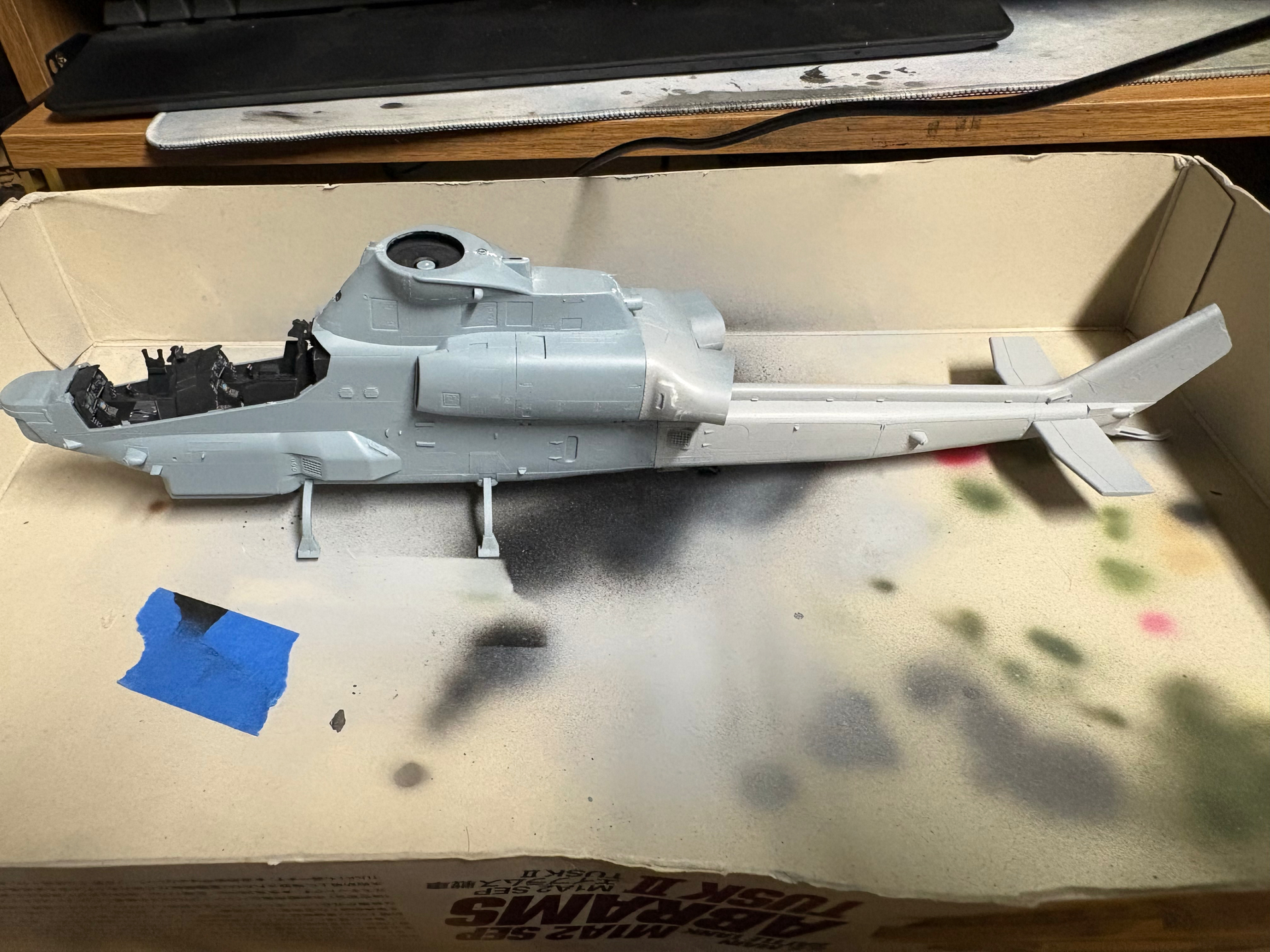

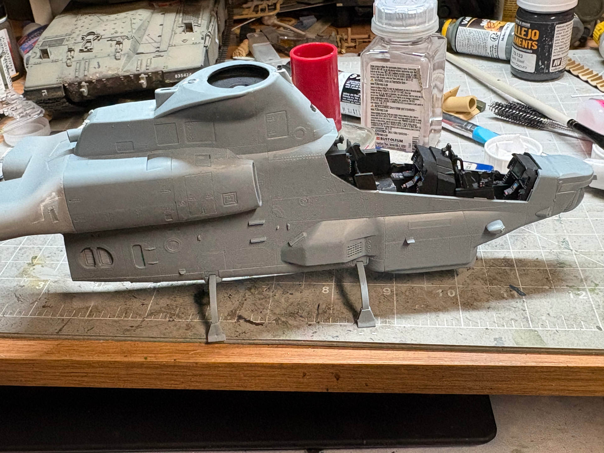

Got some more updates… i made some pretty decent progress with this kit
Ran into a little problem though… as i was sanding down the seam line, i also took out all the rivets, how can i replace them?
Archer rivets, like these:
Archer 1/48 & 1/32 Aircraft Rivets in Spiral & Circular Patterns (.23mm) AR88139
Or these:
Microscale 1/48 Aircraft Rivets Multiple Sizes AC48-0042 USA Waterslide Decals
They come in single and double rows
Thanks! I never need these even existed
I used the Quinta rivets QRV-021. perfect for this kit.

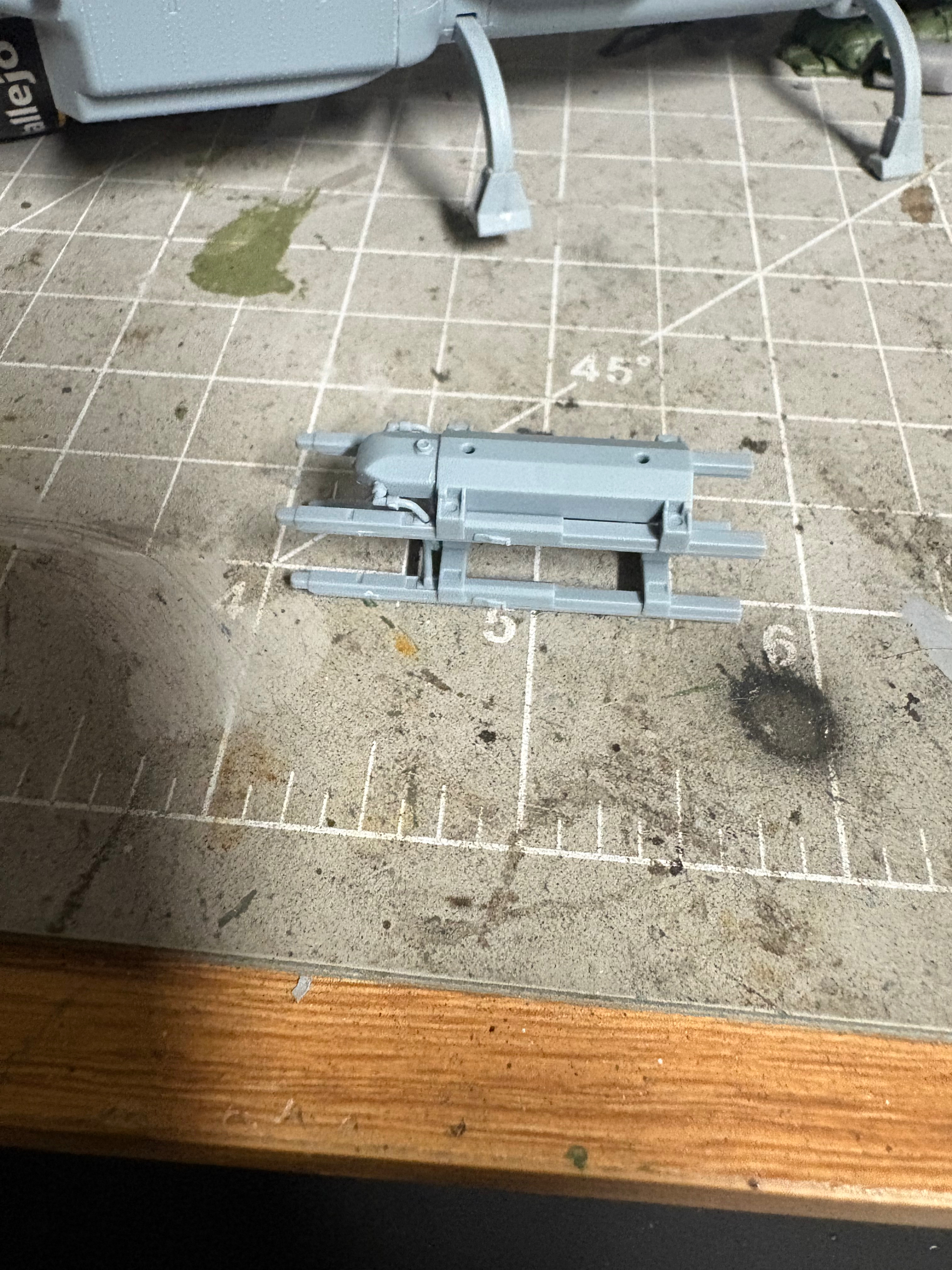

Got more updates

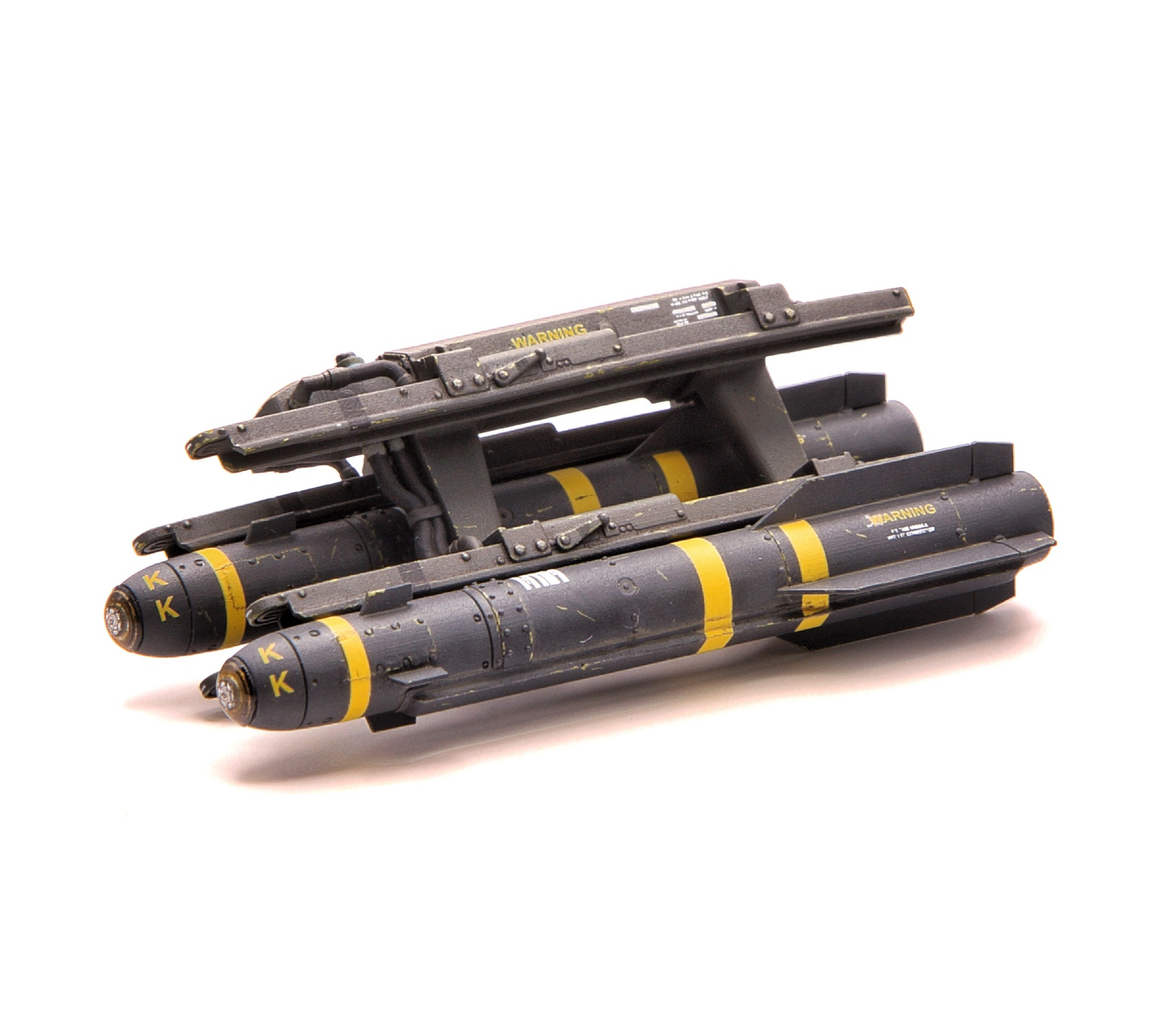

Question, what color is the pylon? I’ve seen multiple pictures and i can’t tell if it’s a really dark green or really dark grey

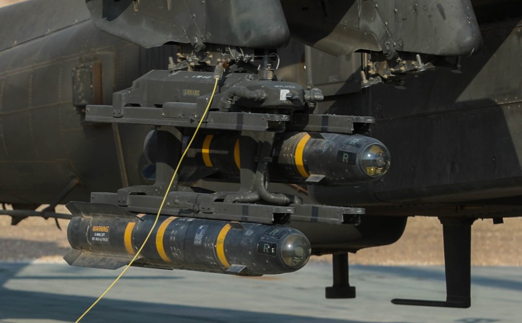

Also… what’s a good color for hellfire missiles
The hellfire rack is helo drab. Hellfires are arguably NATO black, they can fade quite a bit in operational environments.
the kit missiles leave a lot to be desired and the fins are way too thick. I am using the reskit K’s in my build.
interesting to hear they’re nato black in colour, I assumed it was a dark olive green, thanks for the information.
oh yes, best way to be convinced on this is to look at the hellfires next to a helo drab Apache. Helo drab is itself a dark grayish green, and the hellfire looks like faded black with some blueish hues next to it. A fresh one won’t have the fading.
I find NATO black nails it on the head
Ditto ^. I can confirm that Hellfires are black.

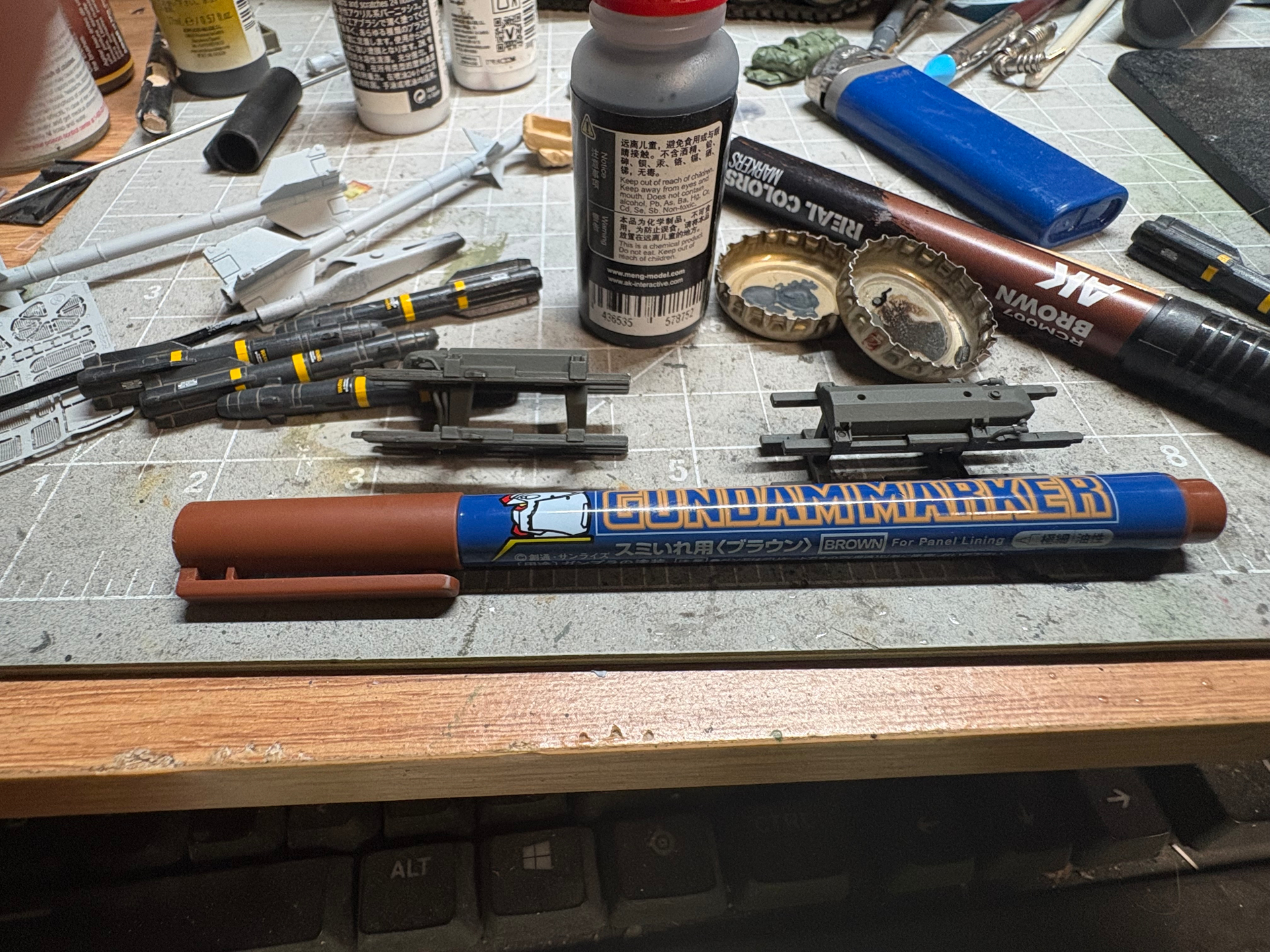

Thanks everybody for the info! I got some progress done…
Ran into a little problem, does anybody have experience with fine point gundam marks? I’m trying to give the missile racks some paneling, i got like half way done through one and the marker completely stopped working… anybody know why this happened and how can i fix this?
