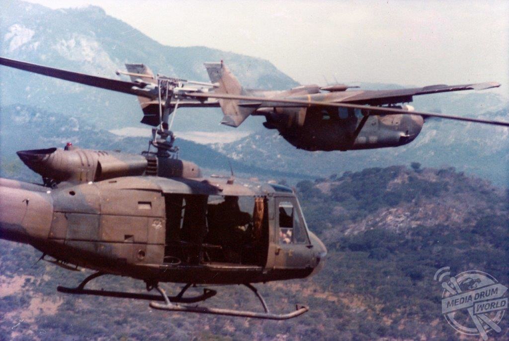

Hi, this is my first post here after scouring the forums for a couple of years; I recently acquired a Dragon UH-1D kit for a somewhat reasonable price but would like to turn it into a late-war ~1973-75 ARVN UH-1H that has the Anti-Strella exhaust and covers but can’t seem to find any options for such add ons.
Here’s a picture of the Anti-Strella field modifications:

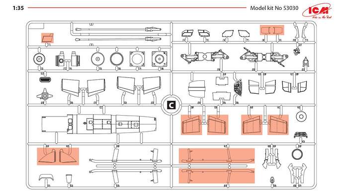

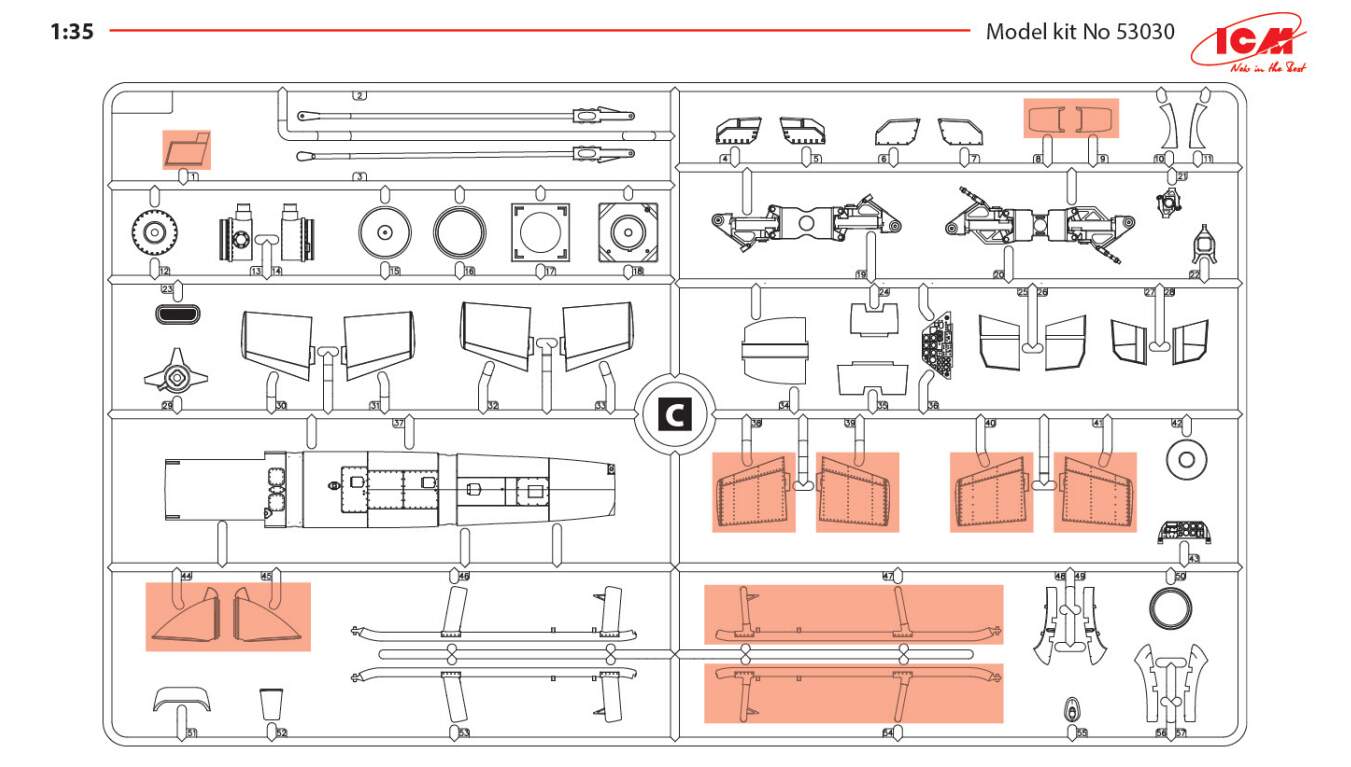

I have discovered that there does exist an Anti-Strella bowl exhaust in polystyrene form! The ICM AH-1G Cobra 1/35 does include this option in both their “late-war” and “early-war” offerings as seen in the bottom left of the sprue. There’s probably some fit issues but super negligible to custom fit it to the Dragon kit. Guess the only thing left would be to scratch build the rest of Anti-Strella kit, such as the engine and oil heat shield; probably using the WW resin set as a guide.
