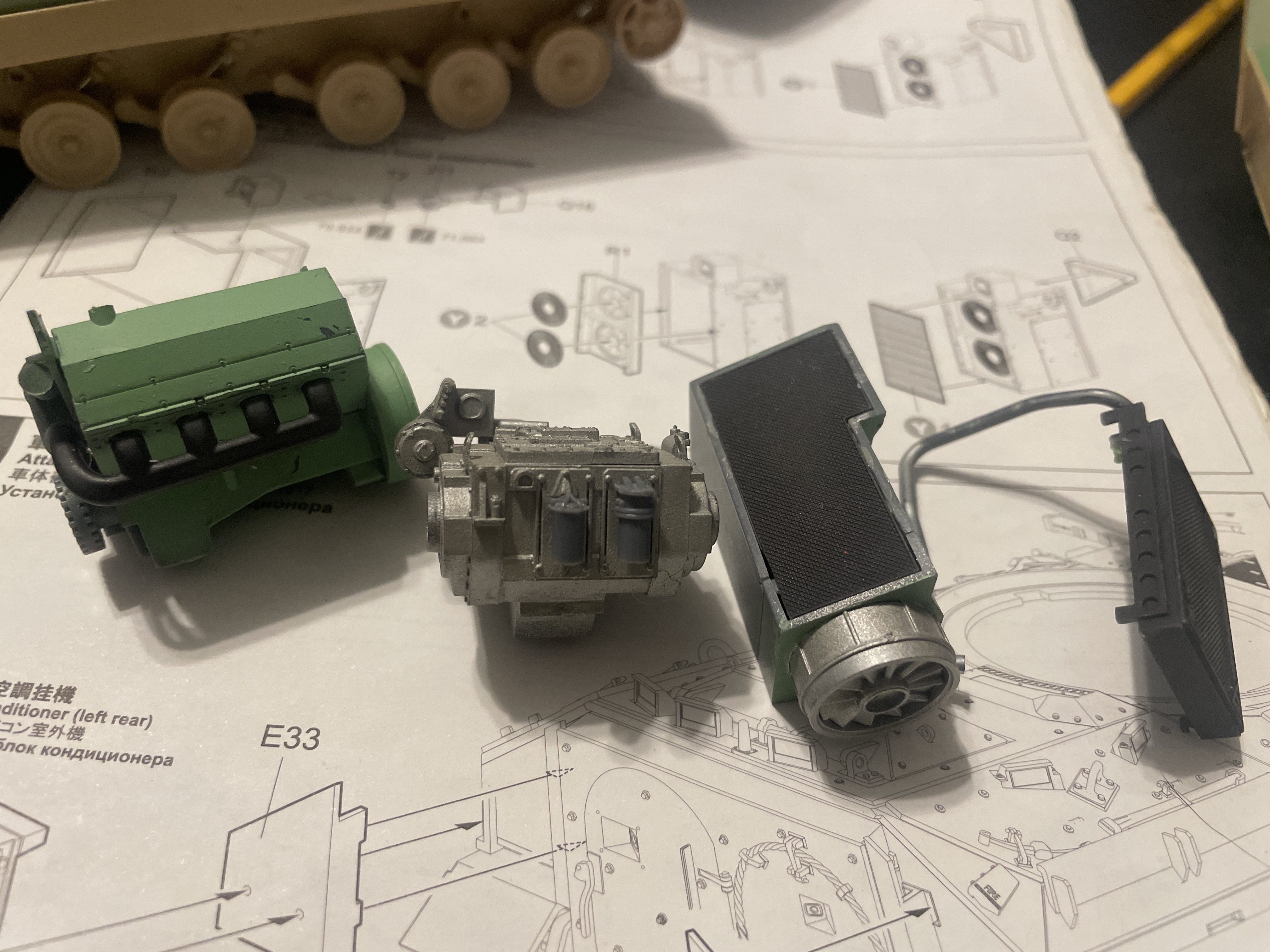

I’m trying to finish up a build of mengs m2a3. I can’t find any decent pictures of the engine parts and I’m hoping you guys can help…. This is what i have so far
Thanks!

The only thing i could do is that most will not be seen. And in the real vehicle, especially in the field, the area is extremely dusty, dirty, and grimy. Not due to misuse, just wear and tear. So exactness is up to you. Again if you plan on having access, as in a " breakdown or inspection dioama, it’ll never be seen. Good luck.

Thanks for the references and info! Im trying to figure out how to make the upper half of the hull removable… if i can figure out how to do this then i will get into a lot of details with the engine and crew compartment
Even then you won’t see much of the engine. The radiator mounted on top pretty much blocks your view. If you really want to show it off, you would need to display it on the ground or suspended from the crane of an M88 or other recovery vehicle.

You can see below how the engine compartment top comes off, compliments of Pete “Epi” Becerra. You also will have to add the aluminum radiator reservoir seen on the left side with the two blue hoses going to it. You should add a flat rear firewall as well, not the rounded part that is in the kit.

If that’s not radical enough you can do that and open this panel. You’ll see quite a bit. Thin the panel from the back for scale thickness:
That’s what I did and I’m quite pleased.
Of course you can always remove the radiator. That’s why workshop dios tend to be the best for displaying engine bays.
