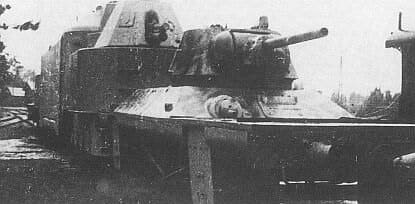

It is captioned “Soviet T70 tank turret mounted on a Panzerzug – Eastern Front”
The turret is clearly from factory 112 circa late 42 to mid 43 and the lower hull upper half is from an 1941 production vehicle based on the drivers hatch. You can find both vehicles from dragon bot you need to hack on plastic.

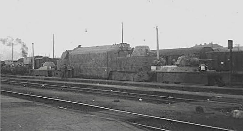

Photos i’ve found, shows that PT 16 had 2 T-34 wagons, one with older turret, possibly welded ‘42 or cast ‘43 (more likely), and a second with model ‘43 hexagonal turret. I have photos of both types coupled with PT 16:

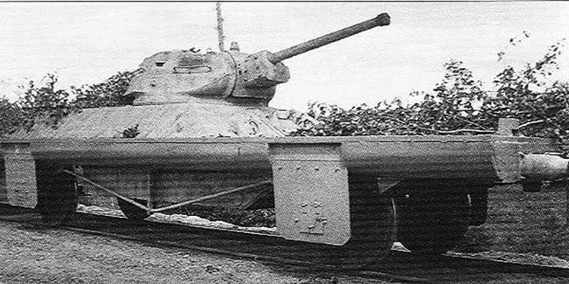

The one below is just a reference, probably not from PT 16 team:
After researching scarce photos, it appears, that this cars were made by modifying and armoring russian 2 axle 20t, “11”? meters long flatcars, also mentioned in model kit UM MT 674 Armored Platform “Tank Destroyer” and this one www.mojehobby.pl/products/Armored-Train-Platform.html , tho this kit has it own flaws, it can be used as general reference on construction and dimensions. On this site, almost at end of article, is a drawing with dimensions of the real thing: Грузовые вагоны постройки 1918—1928 г
UM kit is a bad reference in regard of Pztw 16, coz the kit is basically modified short 16,5 - 18t wagon, which in turn is portrayed well by MiniArt in 1/35, and can be used as some ref. Also MiniArt has nice set of russian rail wheels, that will be handy in this project.
Those armored cars differ so much from original platforms, that its better to scratch build it, than changing some kit.

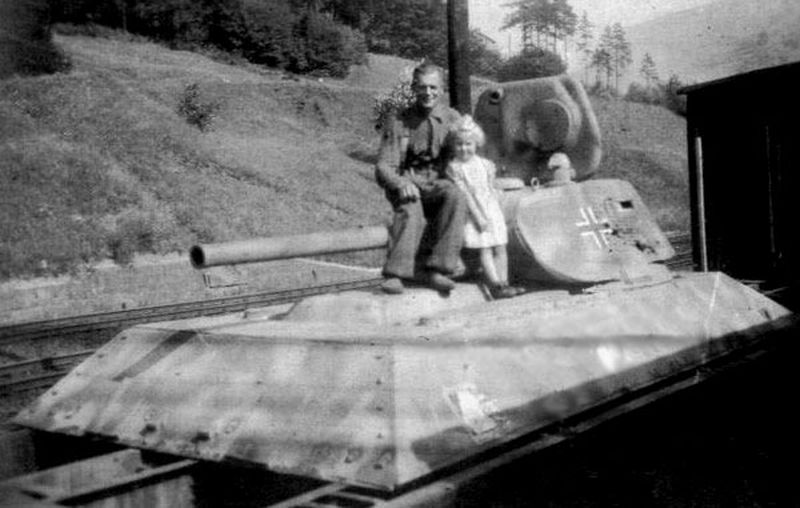

That photo is great! TYVM for it, it gives me much information.

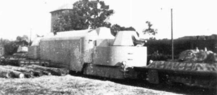

This one gives some hint on the camouflage of the PT16, and surprisingly, they attached some point the armour skirts to T-34 carts.
