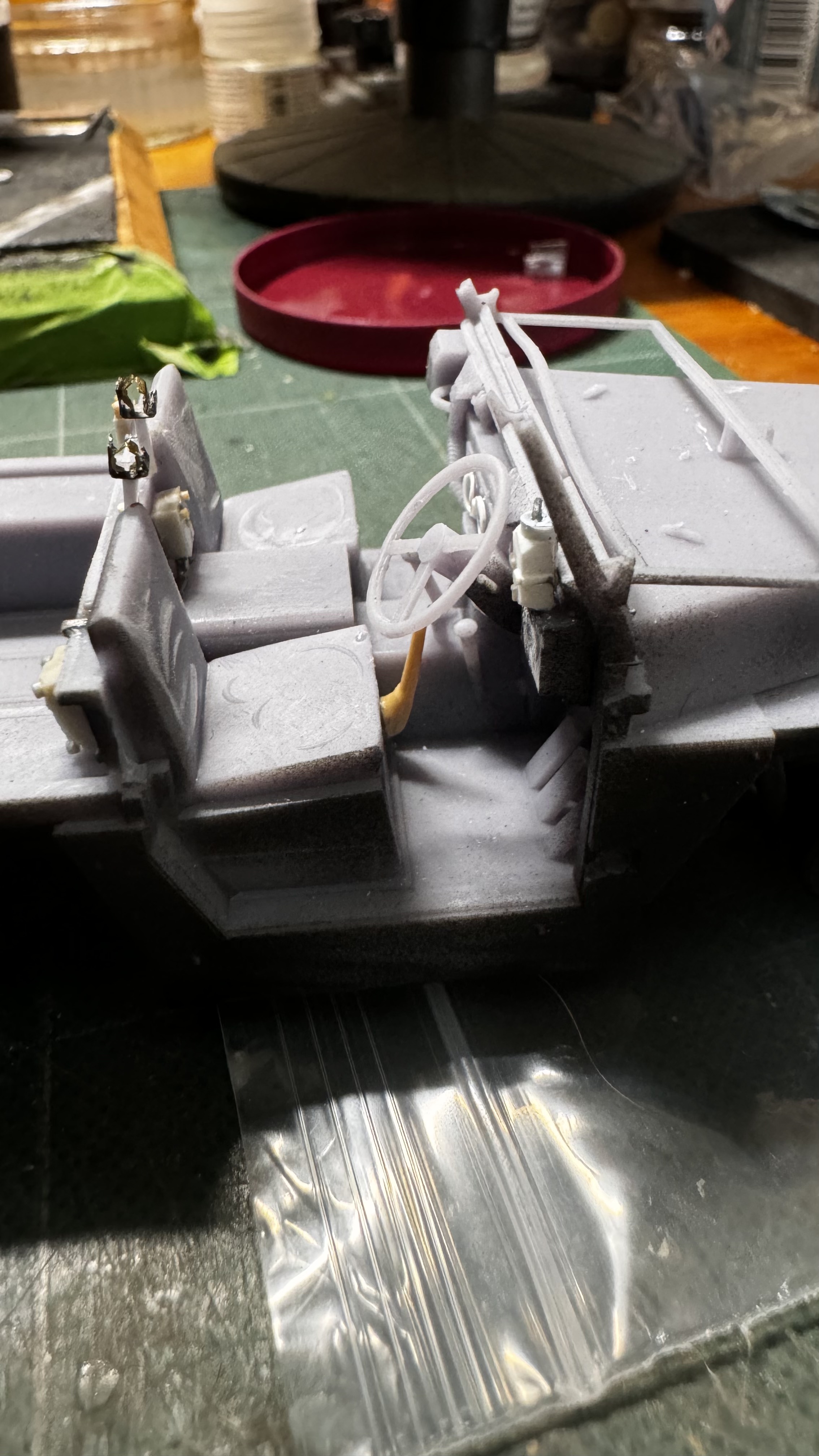

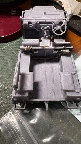

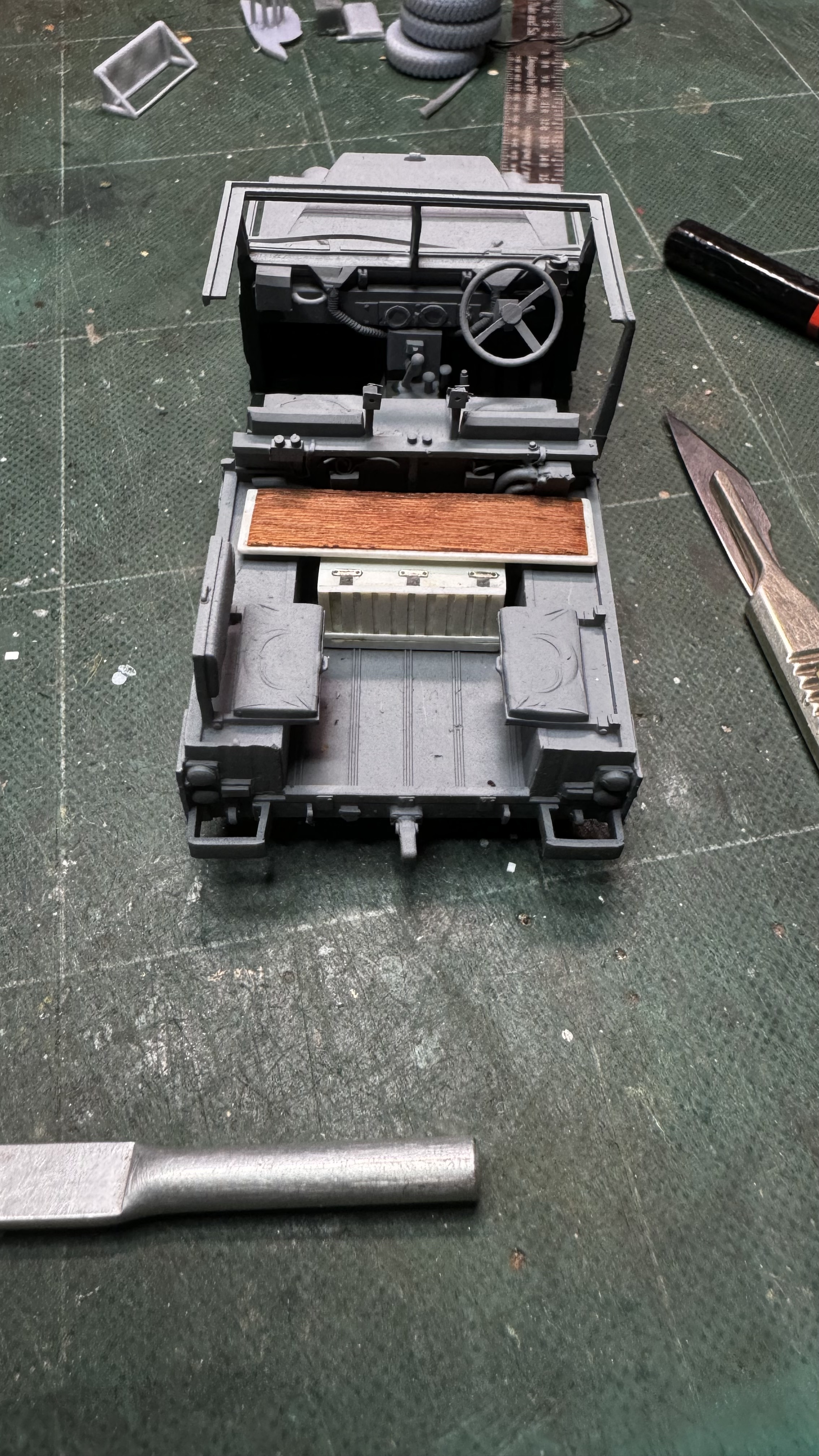

This has been out a little while now a 3D print of the lightweight Land Rover…nicely detailed and the only version of the VPK [vehicle protection kit] available in this scale …
It’s a simple model to put together but has plenty of scope for extra detail…so on we go
Mate, some nice detailing in that rear … cool radio tray and batt box
Cheers nate

Thank you mate …as you will see I’ve gone a bit over the top on this one
Cheers mate …was on of my favourite drives when I was in …brought one when I came out and rebuilt it.

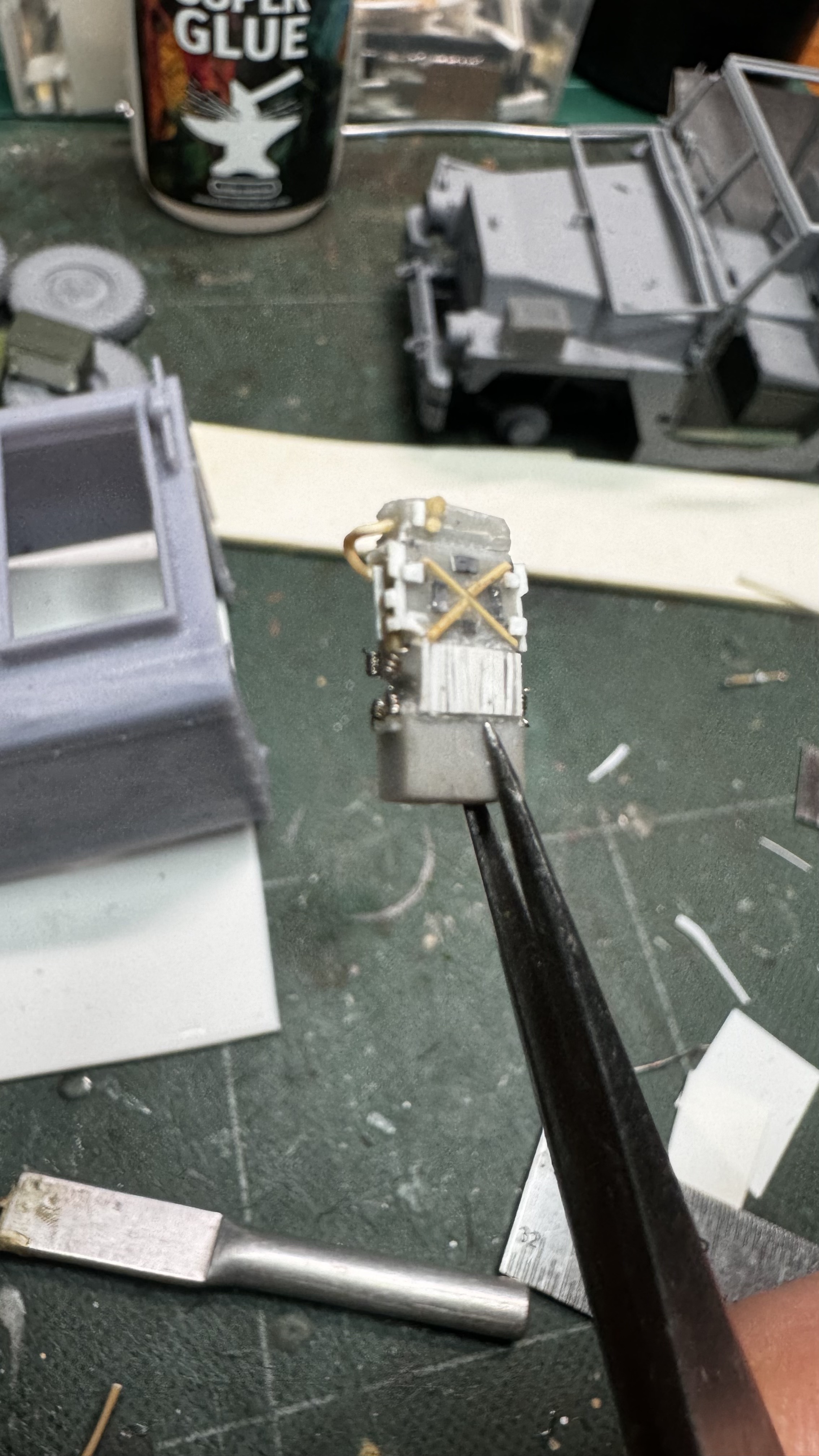

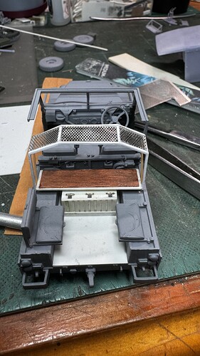

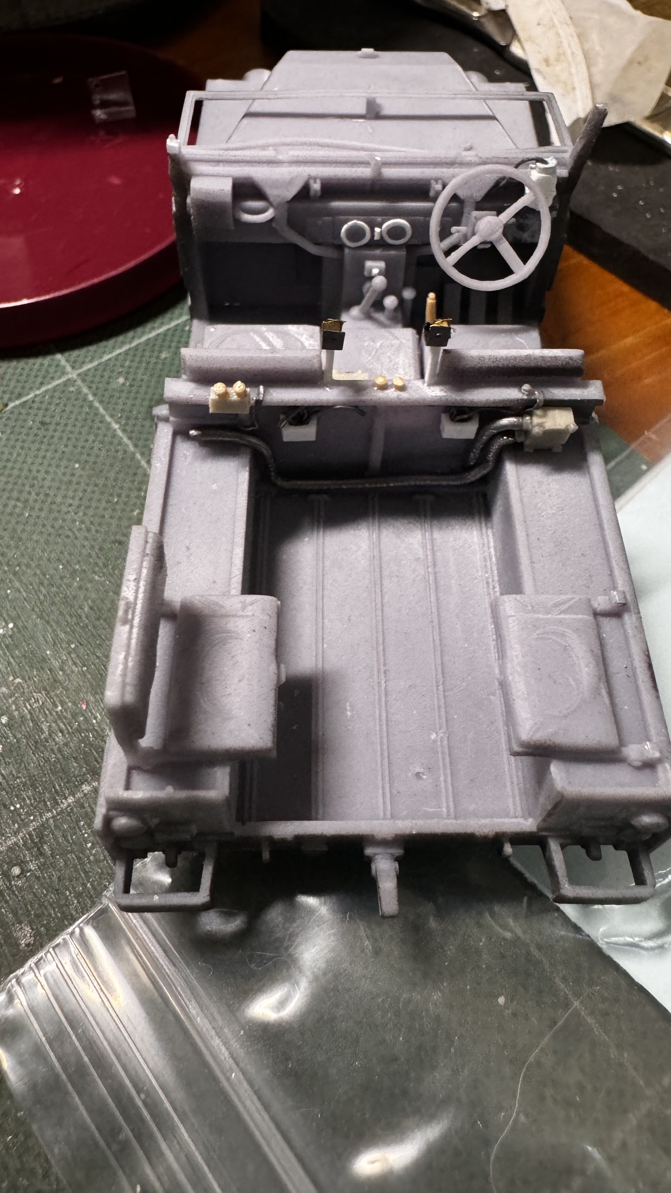

Moving on …having decided to go down the black hole of radio fitting and making the table. The cage was next
Funny you did that; I was thinking of getting one - they were such fun to drive - but I note they’re going (if you can find one) for between 12-15 grand these days. I might just have to stick to 1:35,
Looks phenomenal already. Outstanding detailing.

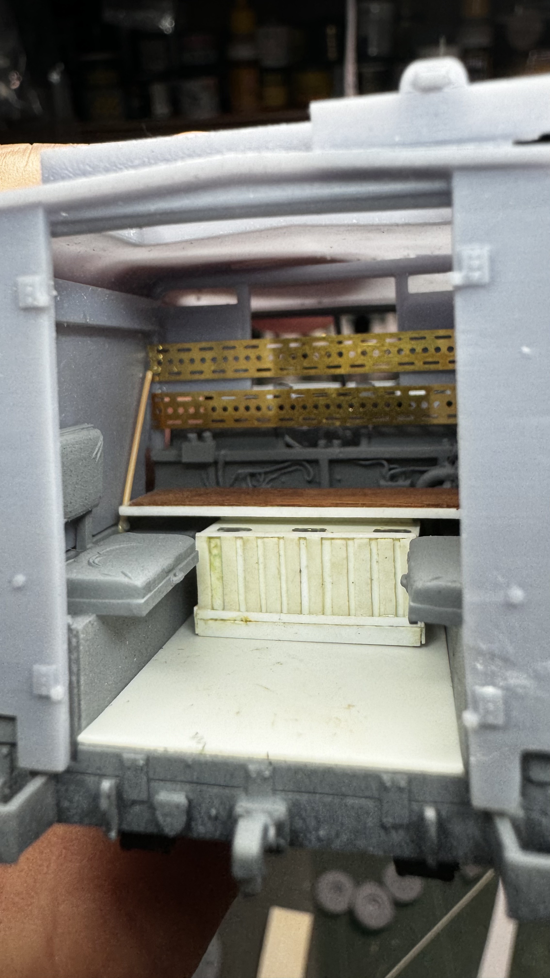

Mate thats superb. Are the crew box mounting plates from a kit or scratch as they look the dogs ?
What’s your opinion on accuracy & ease of obtaining this kit?
Thank you they are additions to the basic kit mate

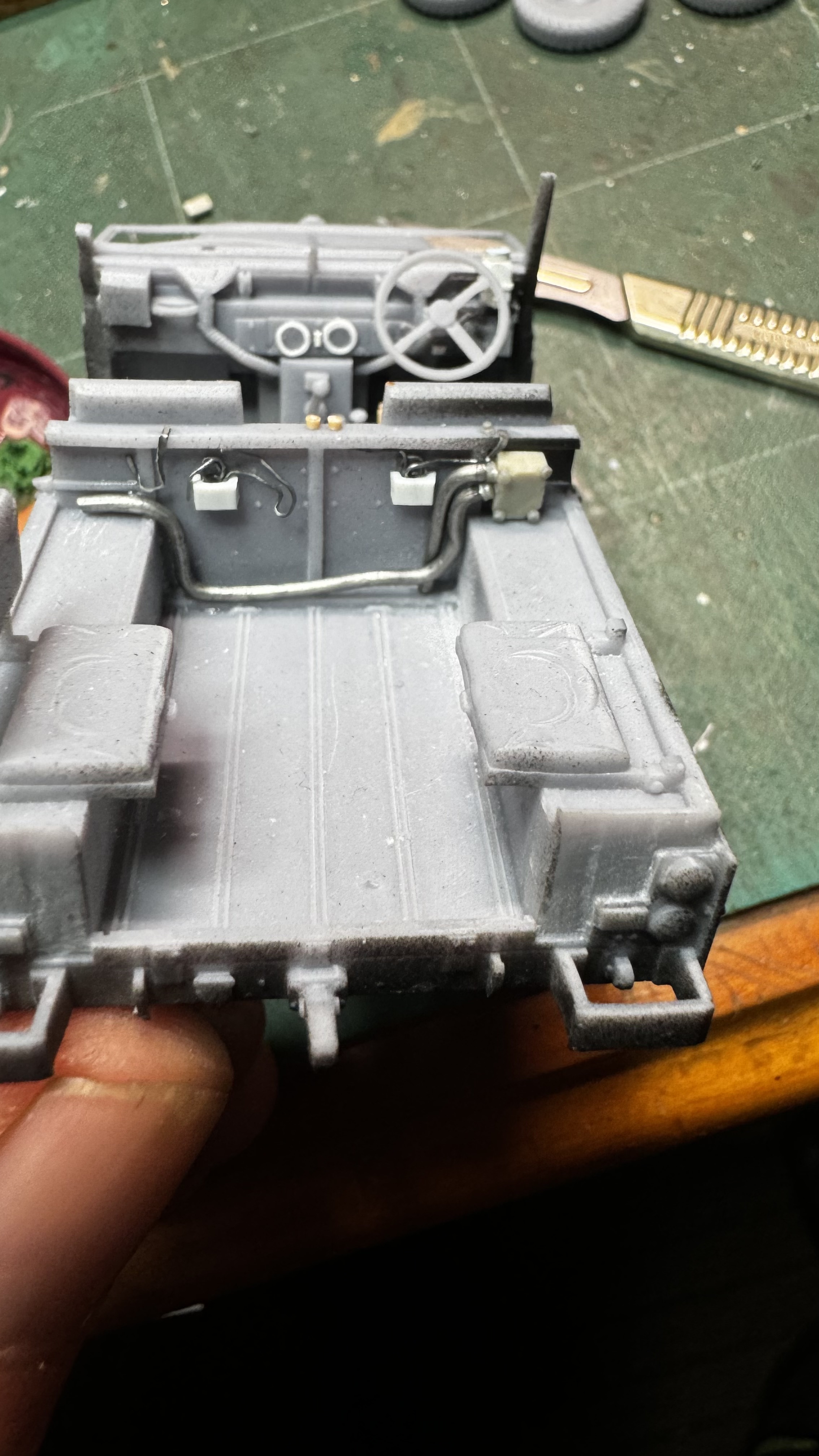

The lightweight is printed by a chap in Holland …so the usual postal issues depending where in the world you live .Hes a one man band and prints to order so it can take a couple of weeks as he has a day job as well.
Personally as a base kit it comes out ok …little niggles like the hand brake needs adding and I didn’t like the original wheels tyres but he has re done them on newer ones .it scales out well to the original vehicle…but as with everything always room for extra detail

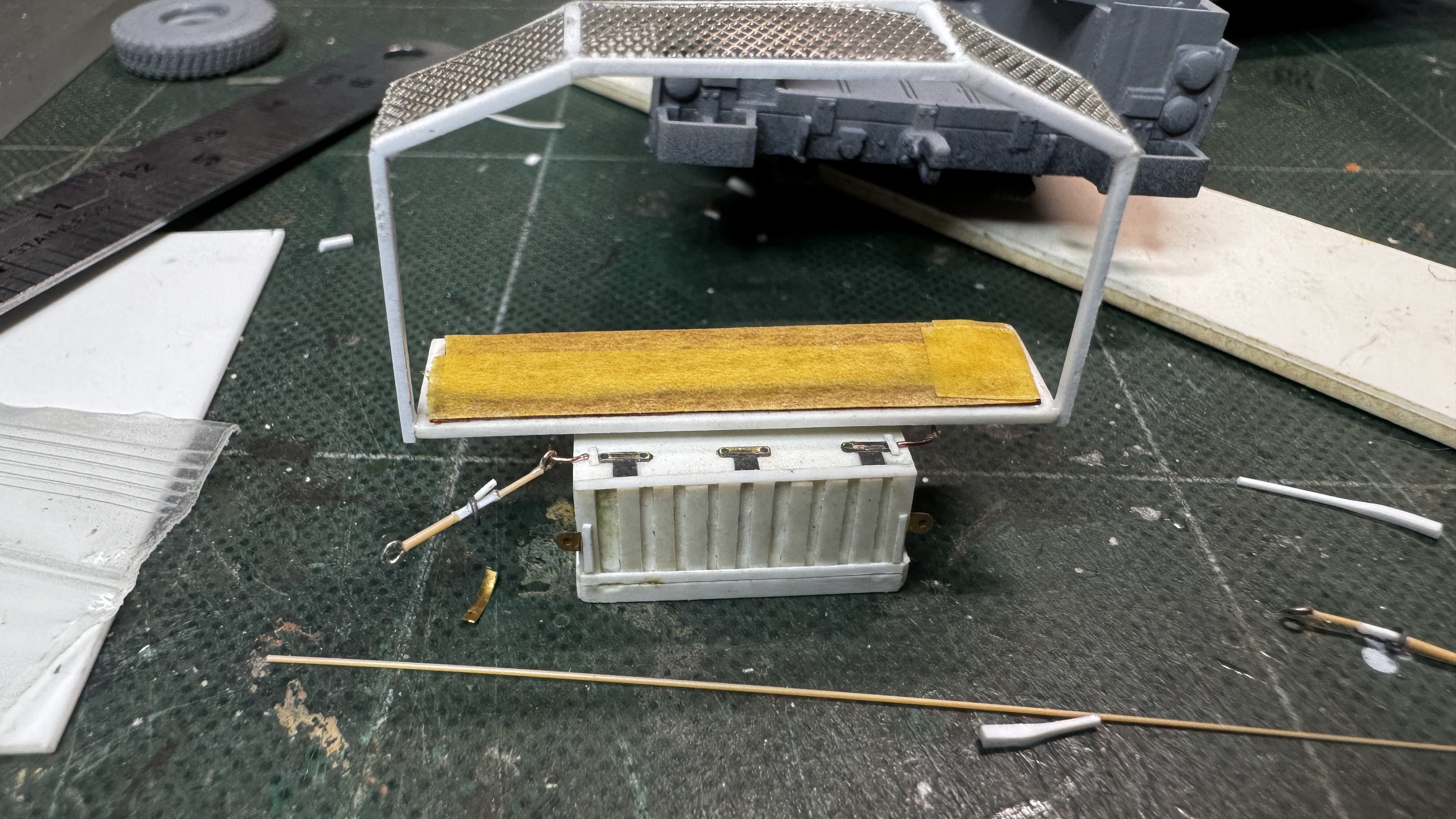

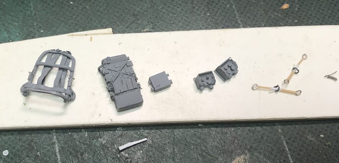

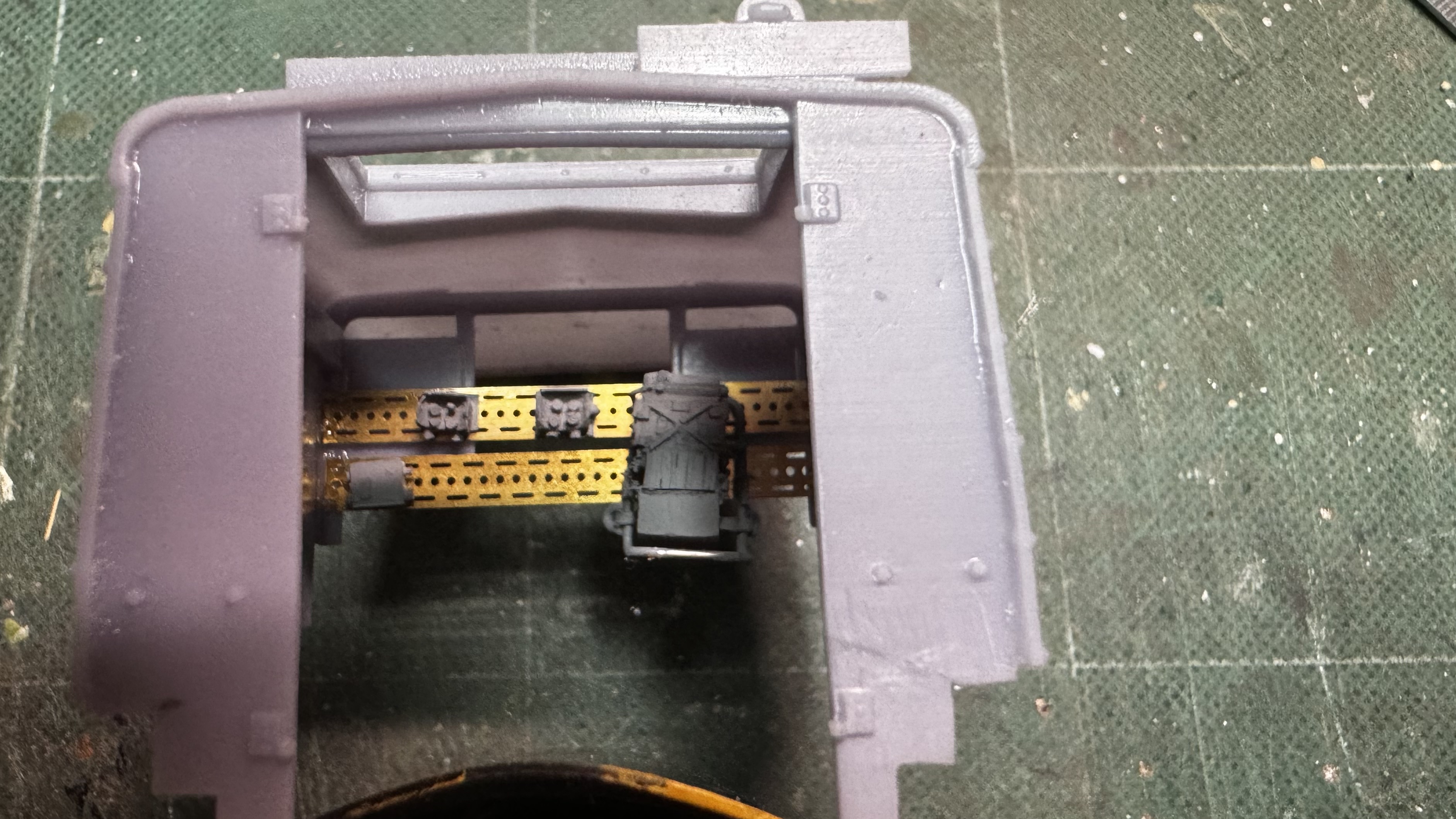

Having made the decision to go along the Clansman route…I needed to make a 352 with some extras
Most of it won’t be seen unless you look

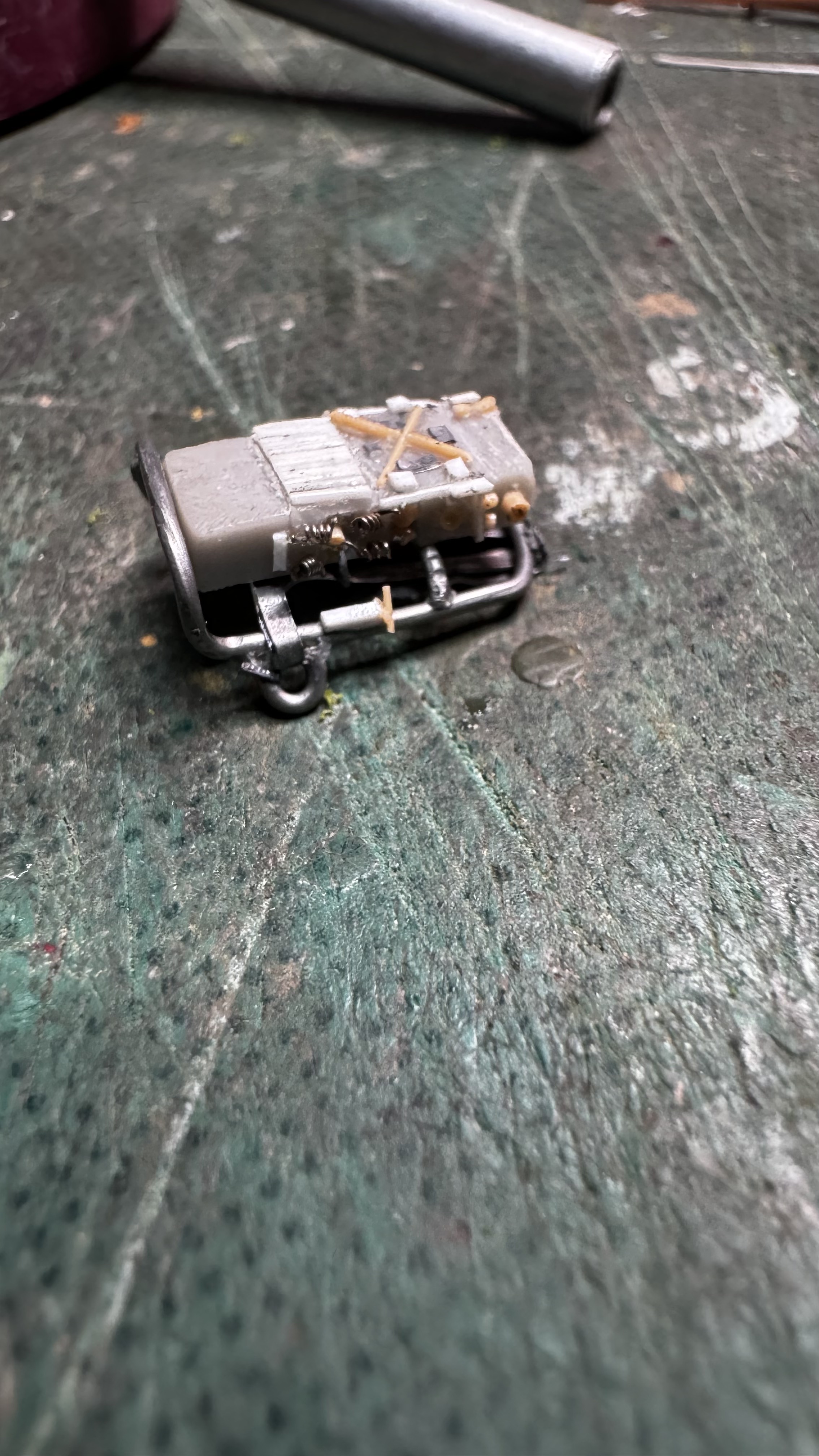

That radio and backpack frame are phenomenal. That item alone will put this model over the top. It’s things like this that make a finished piece truly outstanding.
