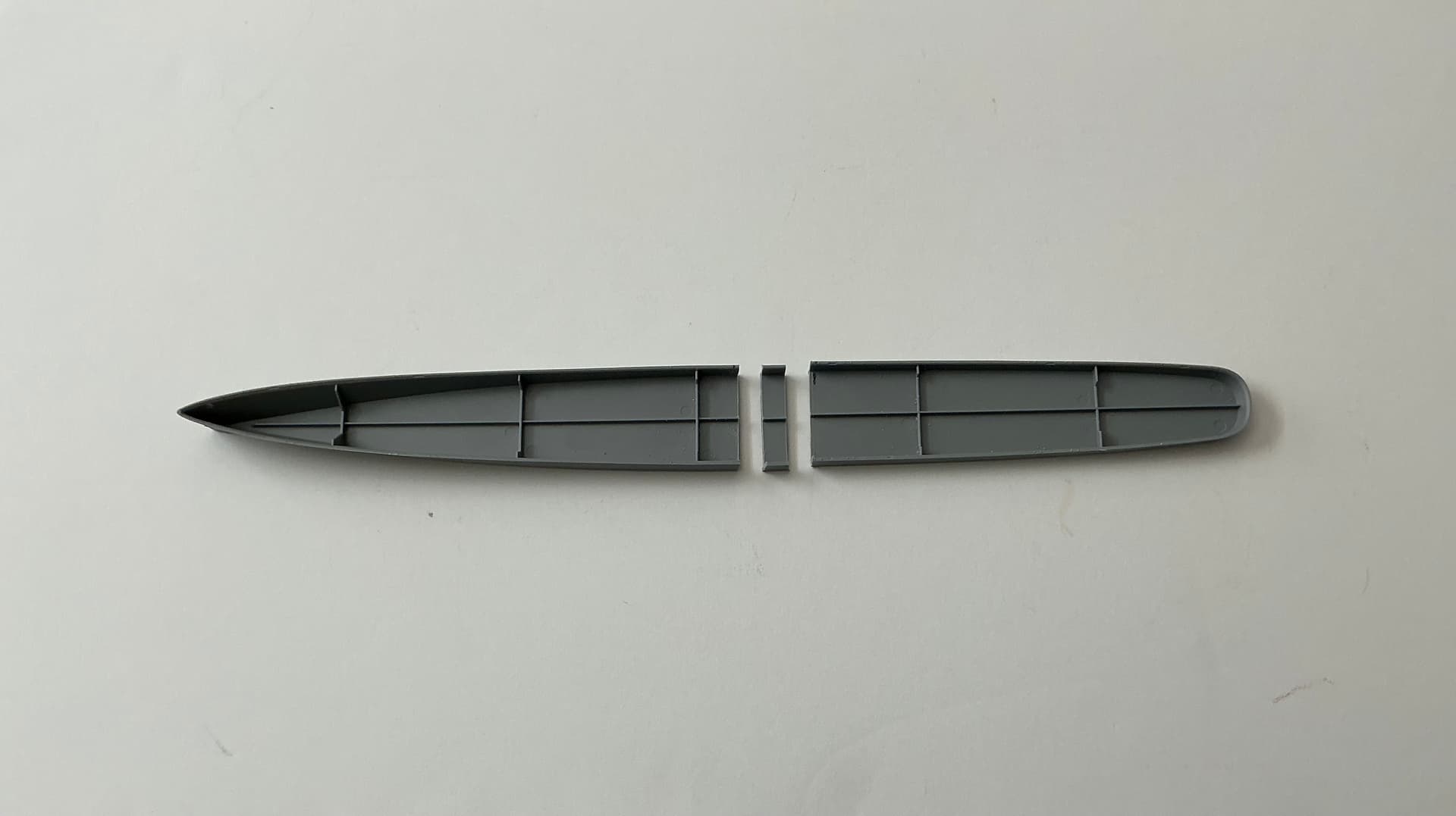

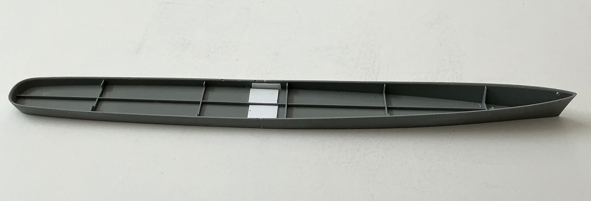

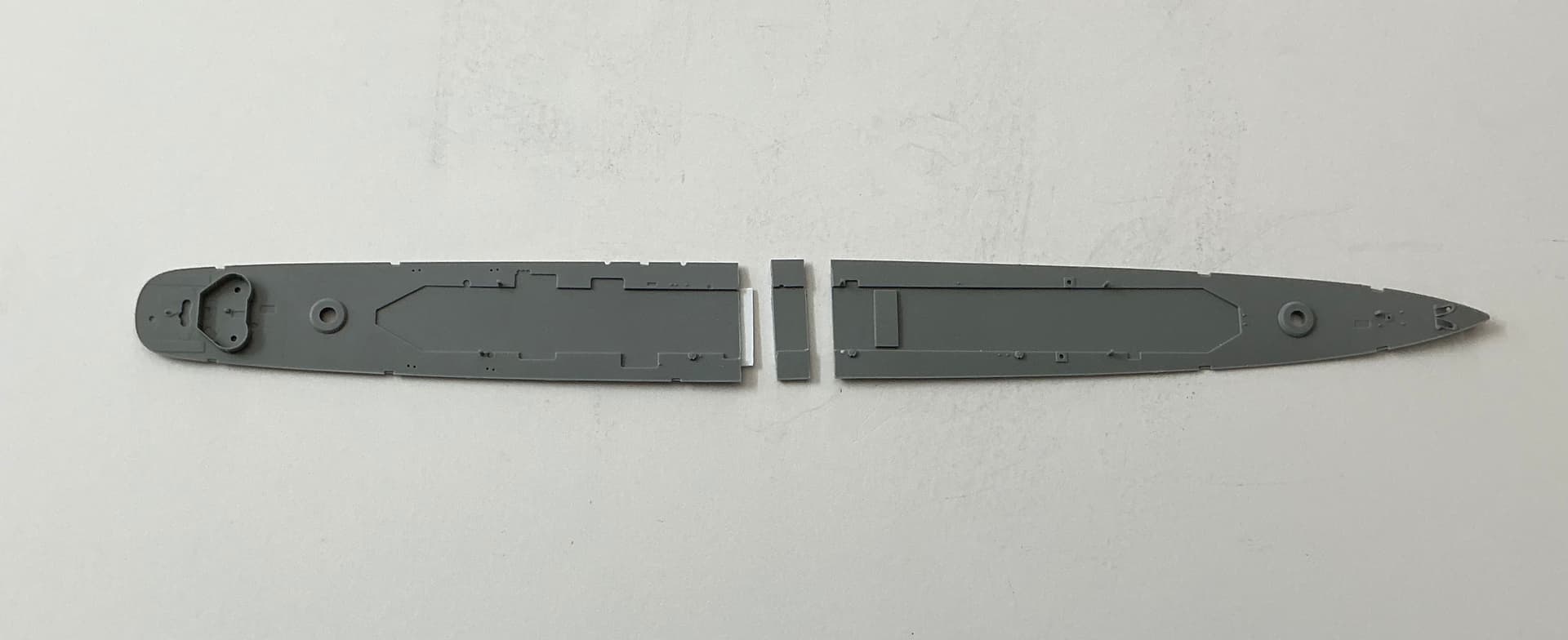

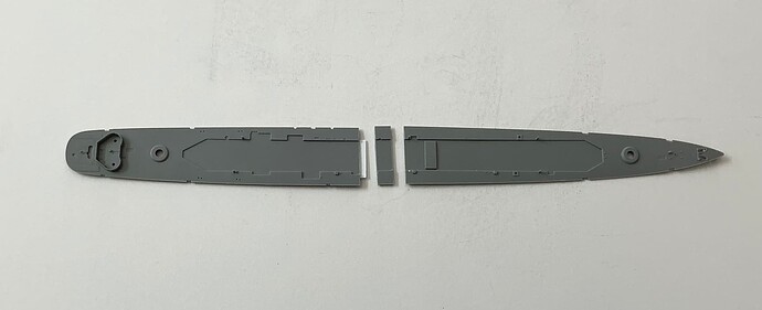

Hi all - starting a new build here . My late Father in law served aboard the Maddox at the end of WW II . I am converting one of Dragon’s Gearing class kits to a Sumner class by sectioning the hull / deckhouse. The Gearings were essentially Sumner class ships with a 14 foot section added amidship for additional fuel tankage.
I removed a scale 14’ section from the hull and deck . Firstly, the section had to be taken from an area where the breadth ( beam ) would match on both sections. Fortunately there is a long section of the hull with minimal change in beam . Secondly , the sheer height above the waterline had match as close as possible. This dictated that section to be removed was as far aft as possible as the sheer is very straight in this area .

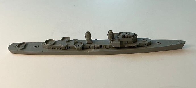

A little progress - hull ,deck and deck house sectioned and basic structures built up ..

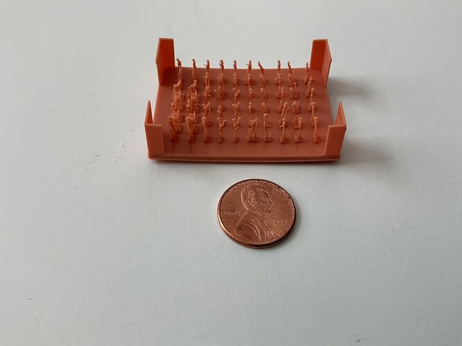

Just got these 3D printed figures - will share them with the Buchanan build.

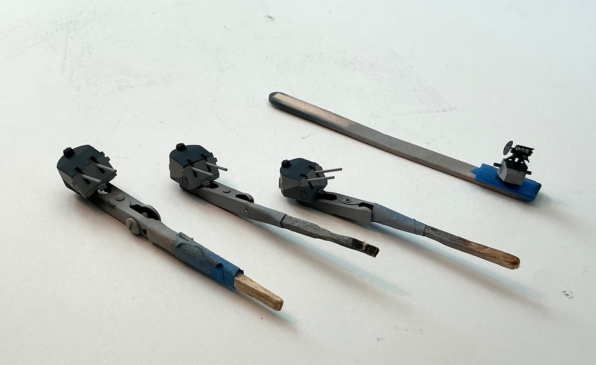

The build is progressing with the tedious work of AA weapons. I thought some may find these items interesting meanwhile.

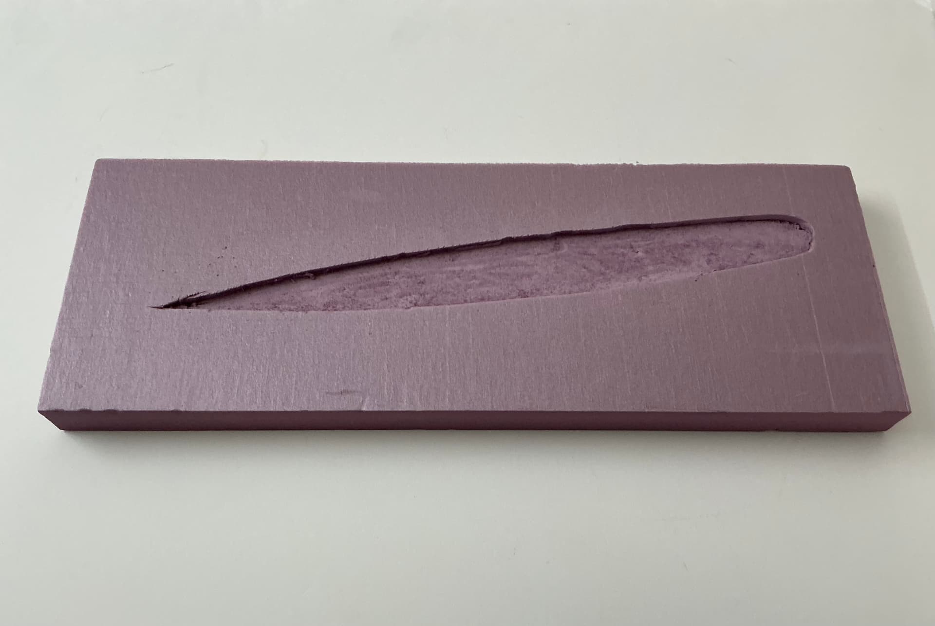

Foam base begun - hull traced on surface and mortised with router base on Dremel …

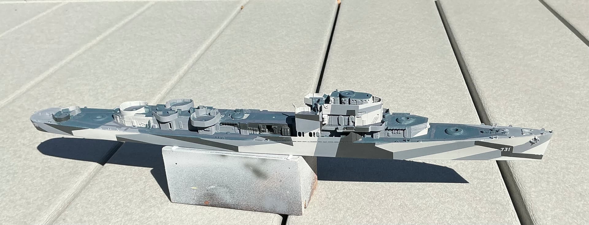

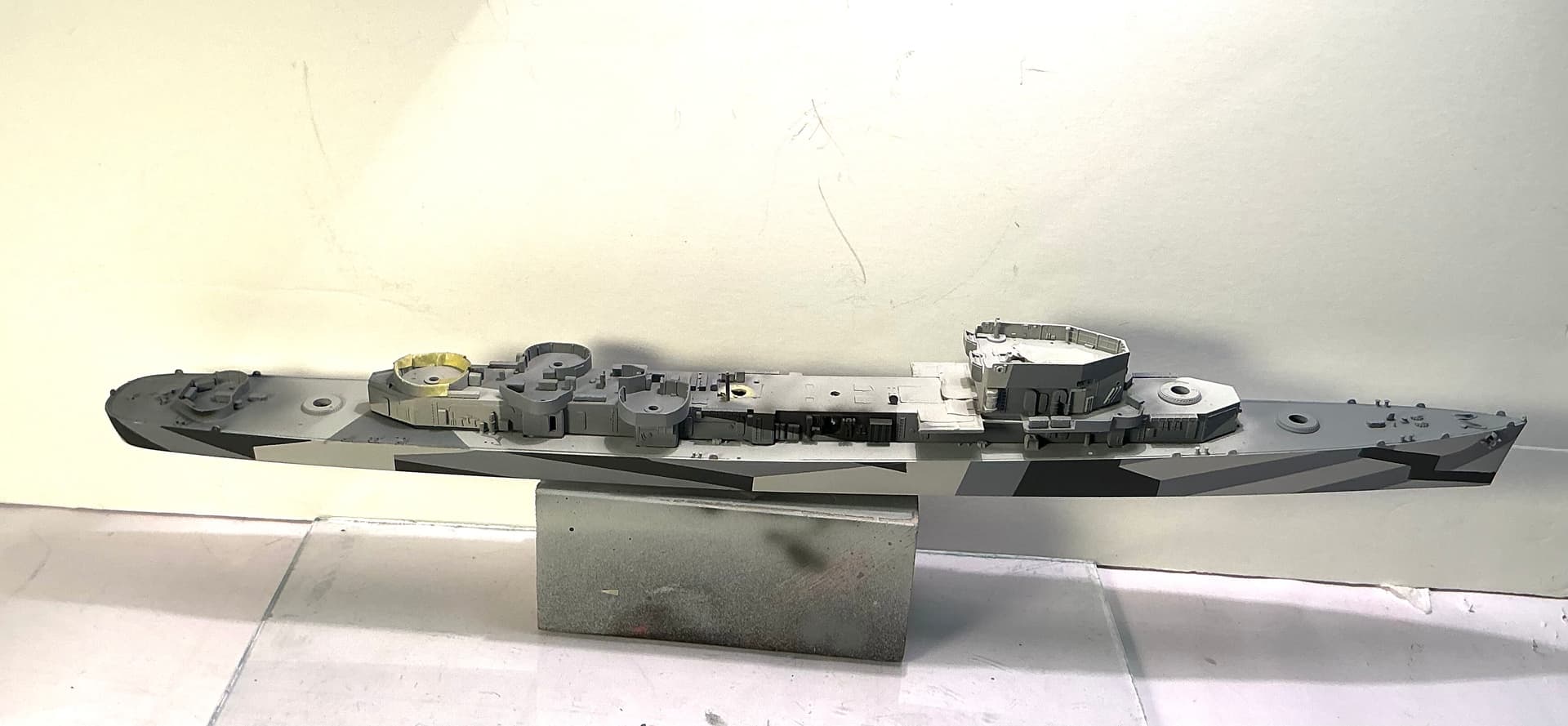

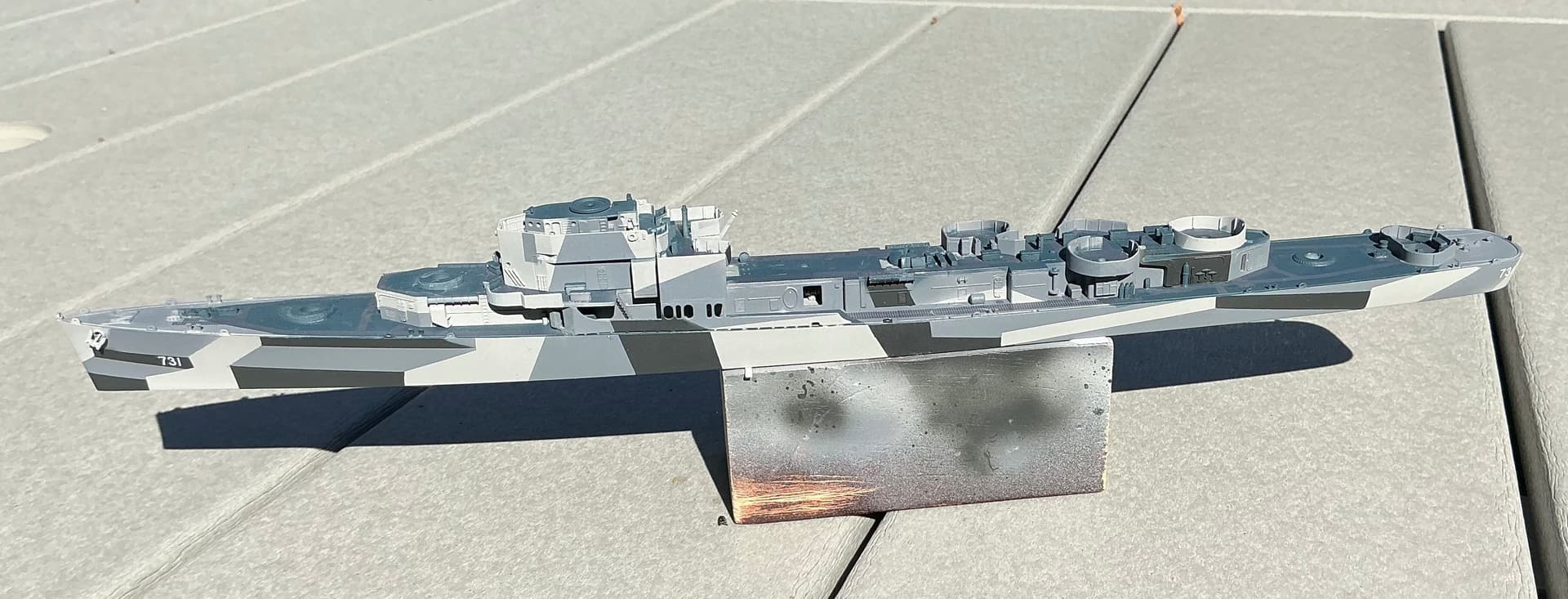

Dazzle paintwork underway…
Dazzle done on hull and superstructure - gun houses and a few other bits left to do .
Superb.
impressive dazzle,
Cheers, :clinking_beer_mugs: Si
Super job on the dazzle;
It really give a sense of the disorienting effectiveness of this type of camouflage!

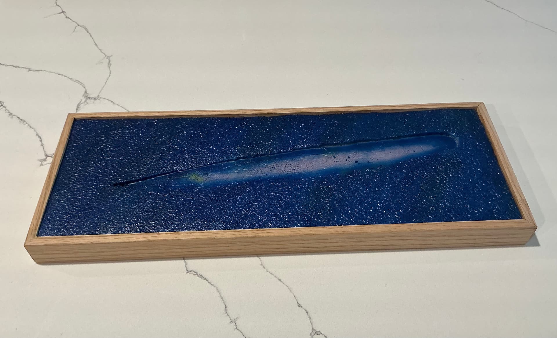

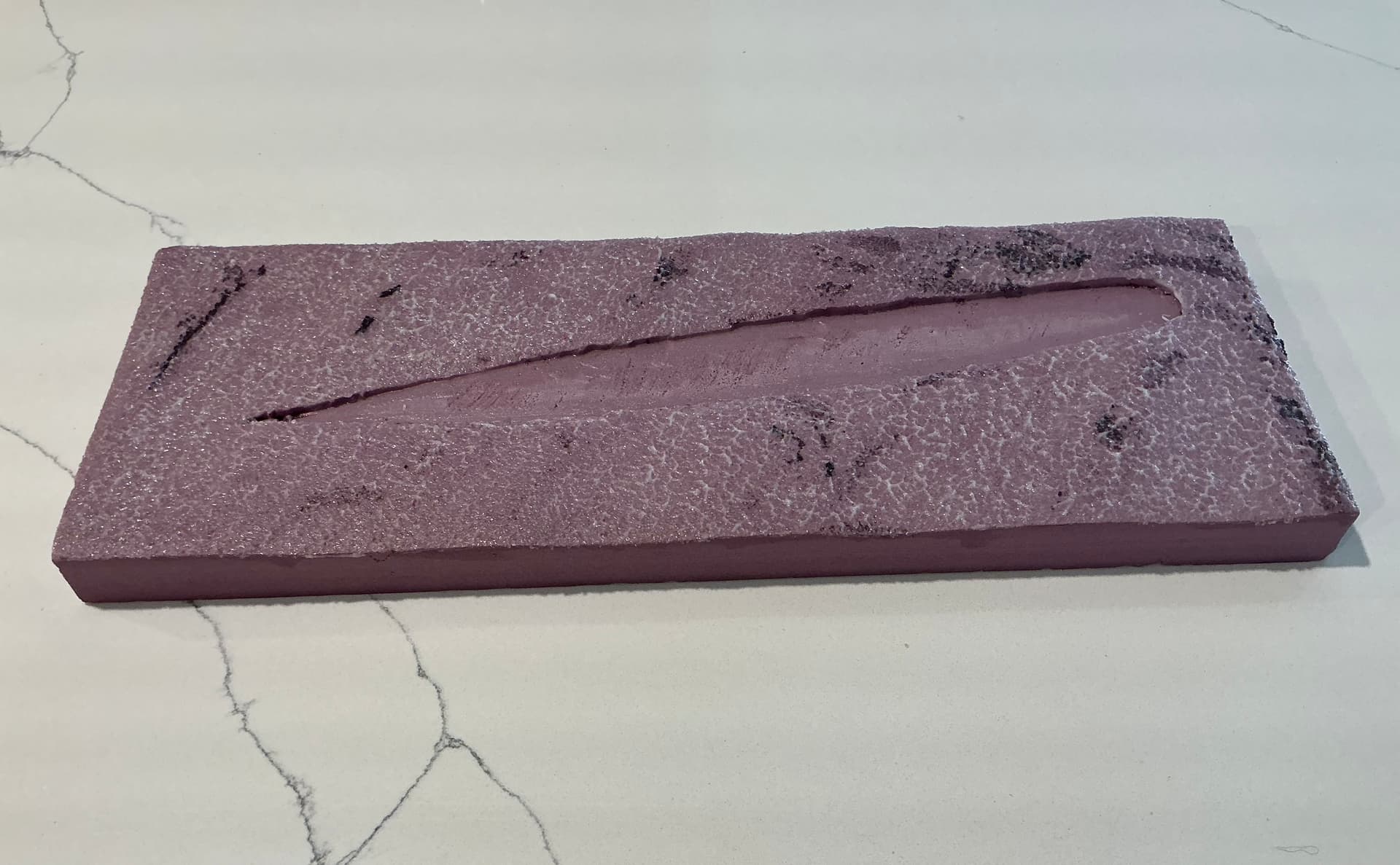

Here is the base with slight swell ground in with 4” disc grinder and two coats acrylic polyurethane and acrylic gel medium stippling .
And base with base color blue airbrushed on and oak molding around edges.

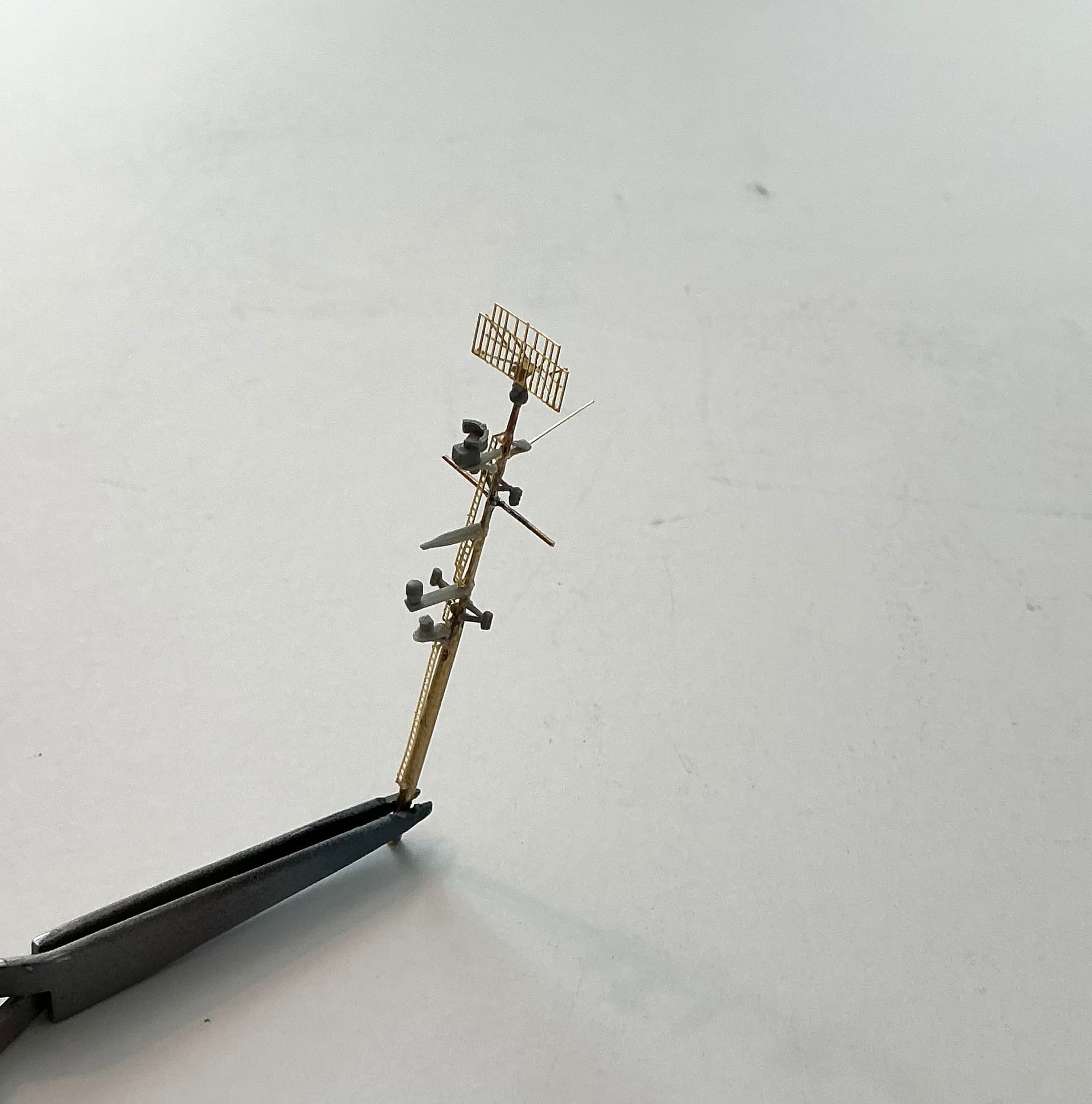

Mast made up of soldered brass with kit plastic bits and photo etch added..

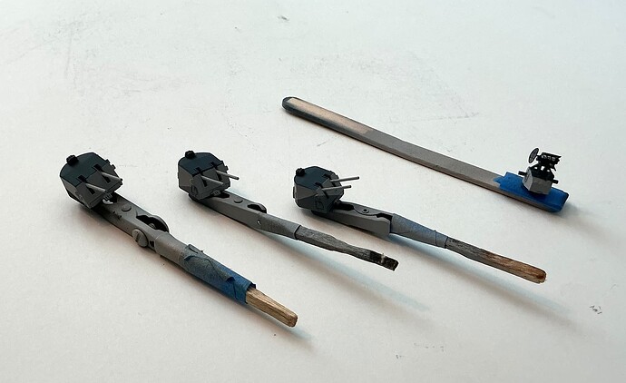

… and twin 5” mounts and gun director in dazzle..

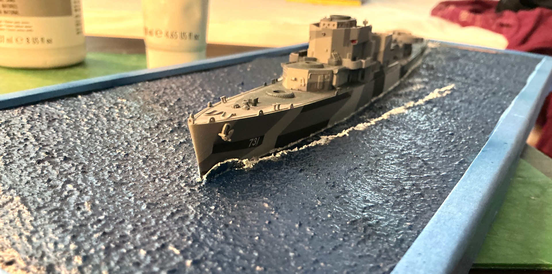

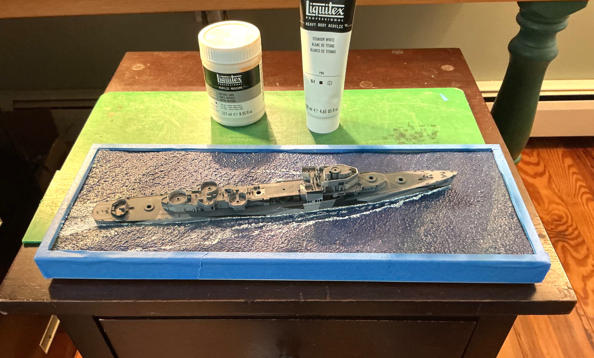

Working in the wake …

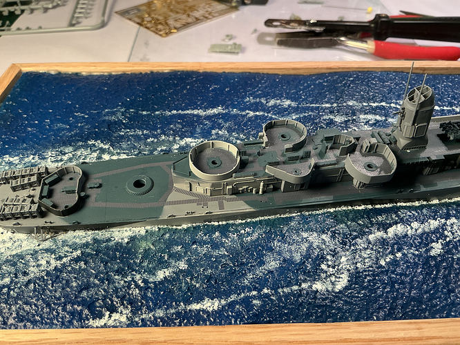

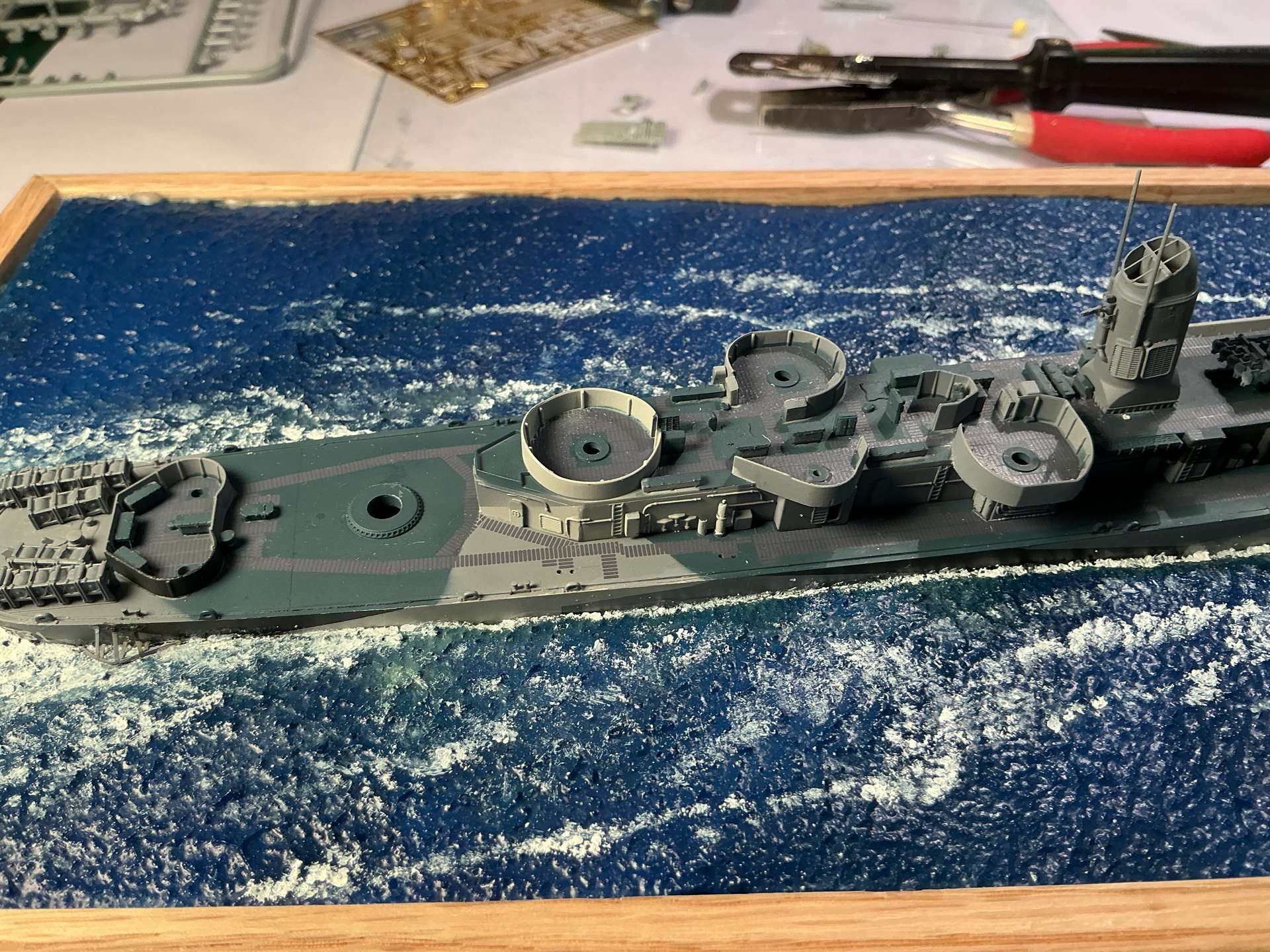

Natural Sand medium / acrylic white mix . Bow wave at stem done by wrapping a 3/4 “ dowel with wax paper and painting on 5 minute epoxy. Shape cut out after curing and set in place with PVA .

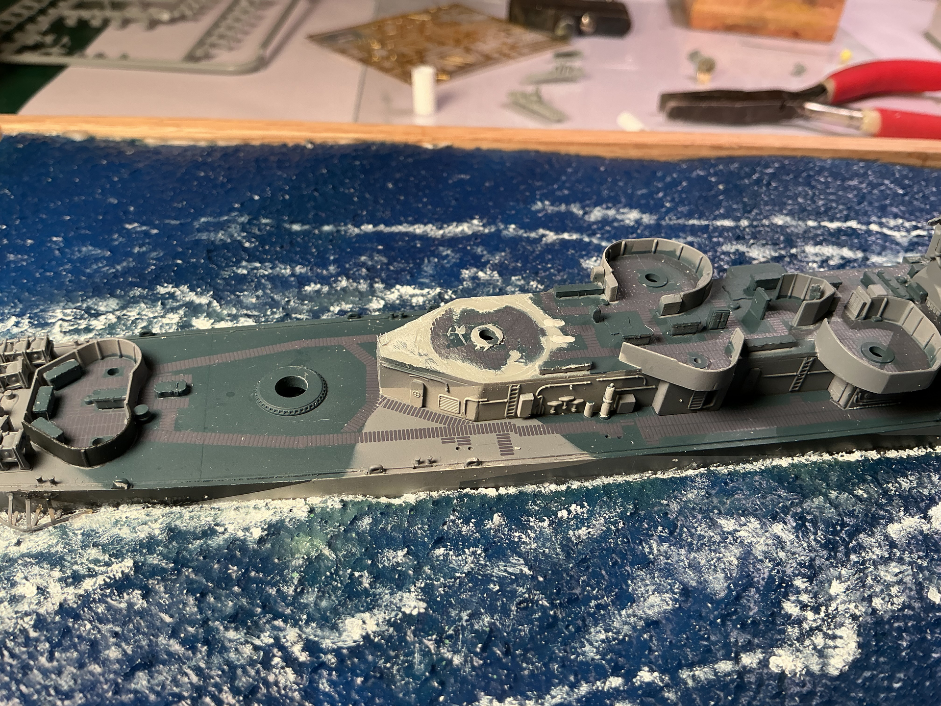

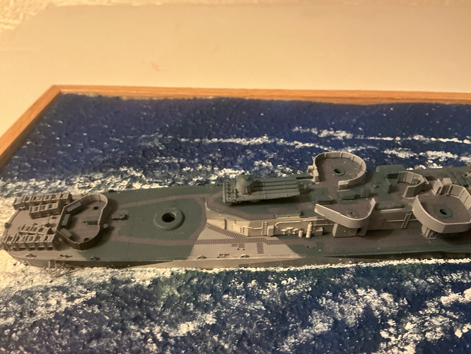

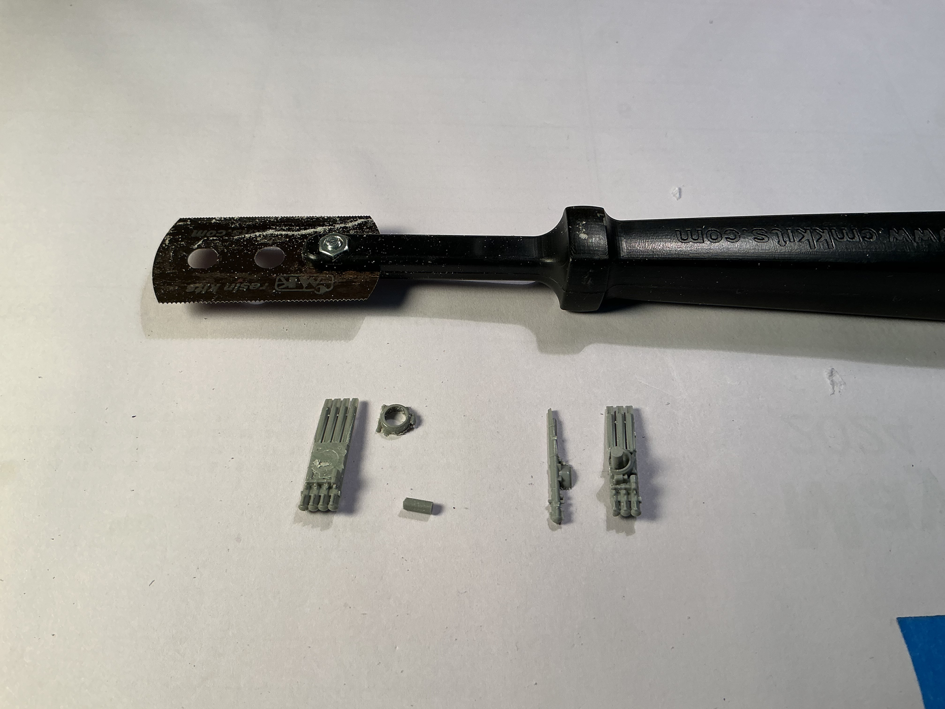

Much to my disappointment I have discovered a glaring error on my part . While studying photos for the search light location I realized the Maddox carried an additional quintuple torpedo launcher in the place of the after quad AA mount . I must have looked at this photograph dozens of times while studying the wake and it never sunk in…
so now I am in the process of making another quintuple torpedo launcher out of two spare quad launchers.
Easy enough but the difficulty will lie in removing the aft quad AA gun tub ( which is finished )
I debated on just leaving all alone and living with it but … well … you know how it is .
Ugh !

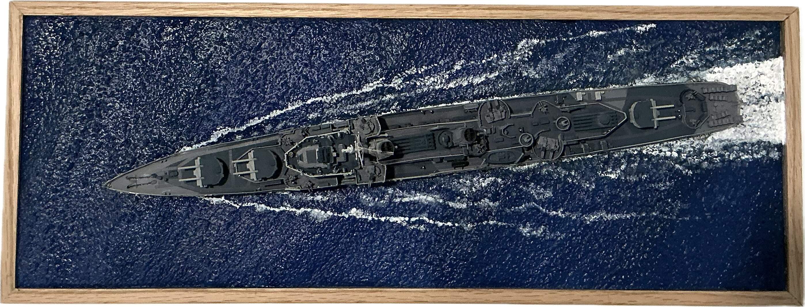

Oversight corrected.

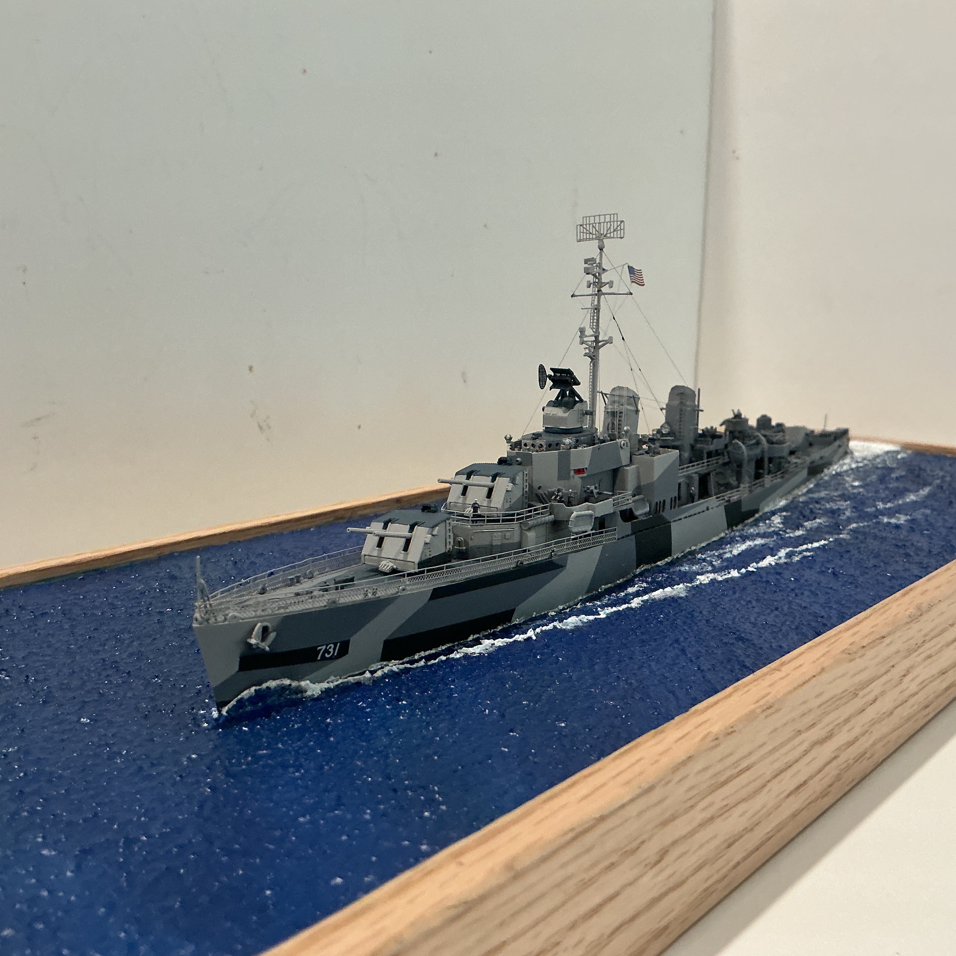

Quintuple torpedo tubes built . Blast protection structure made of styrene tube . Conical roof turned on lathe and detailed with styrene bits and photo etched ladders. Gun tub sawn away with razor saw and chisel. Deck sanded , repainted and walkway decals replaced.

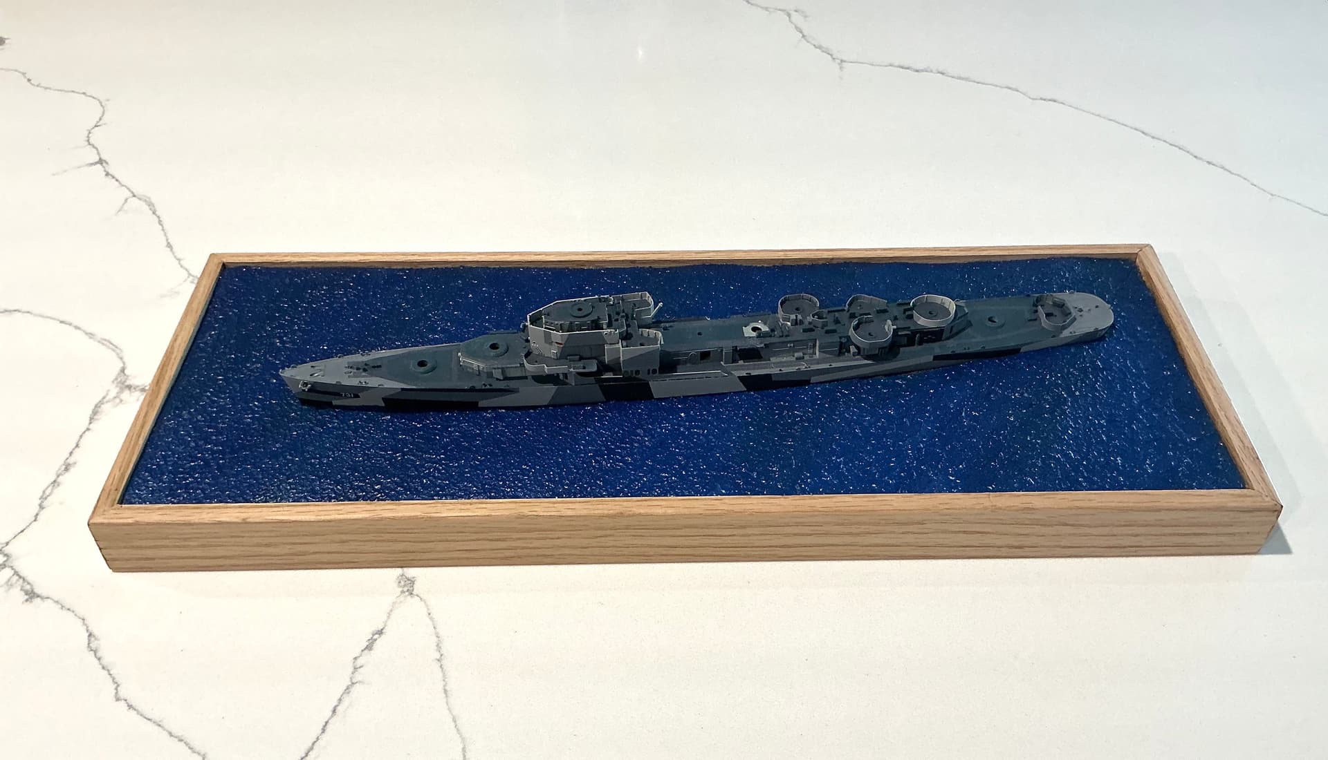

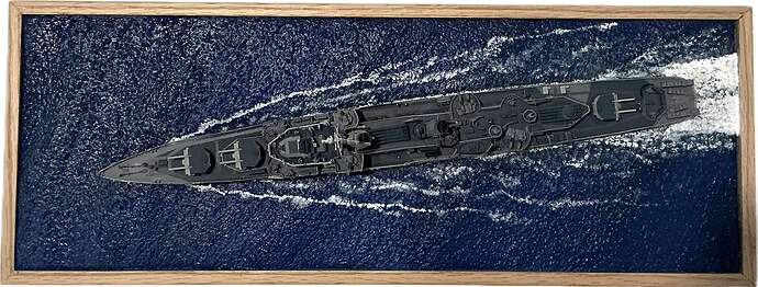

Calling this one done . Here are some shots of her “ making knots and carrying a bone in her teeth “
A totally enjoyable project - assembly of the small anti aircraft guns was a bit tedious. If I do another I’ll opt for 3D printed ones .
