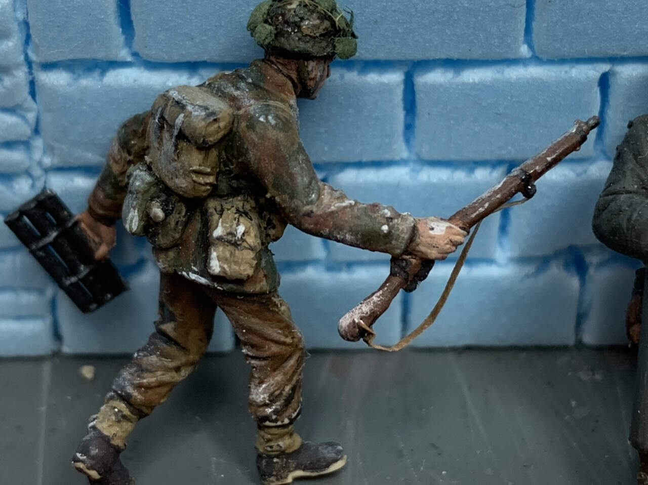

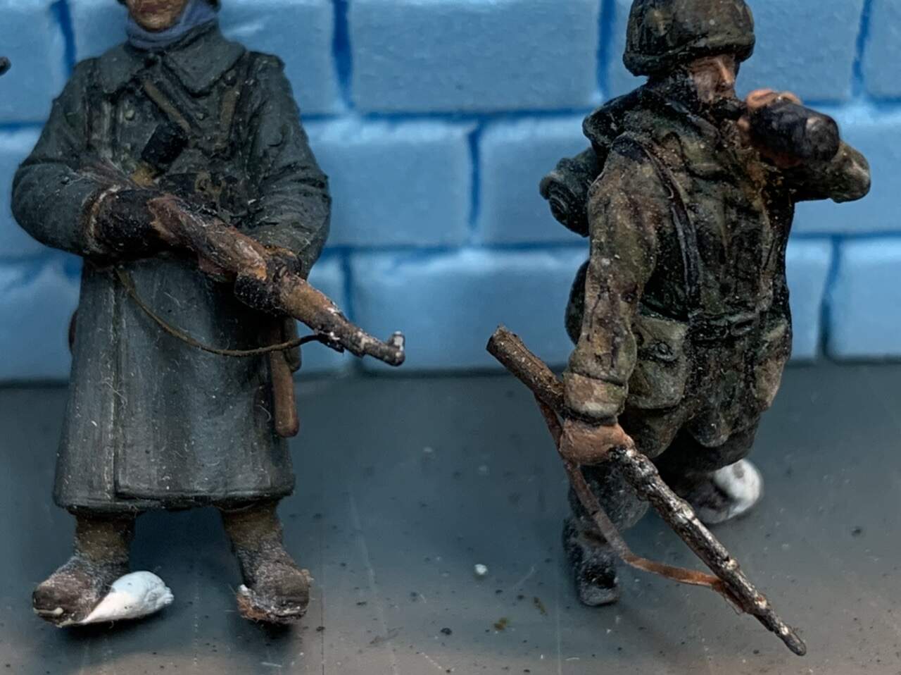

Hi all,
Today I learnt a lesson, nothing sticks to vinyl plastic figures, :angry:…unless anyone knows otherwise, :thinking: :roll_eyes:. In my naïve way I thought it would be a good idea to try and loosely represent weapon slings…now wish I hadn’t, :unamused:.
Trying to get the thin plasticard to stick with CA glue was difficult at best, and the handling of the figures removed paint, so some patching up needed, :pensive:.
Have decided that I’ll get all slings fitted and then repair all the figures afterwards.
Some images below to give an idea of what the slings should look like when completed. Silly how such a small detail should take so long, gggrrrrr!

G! Make the straps out of paper and glue them with super glue! Quite easy really:) /Erik
So something like thin strips of what I’d call printer-labels with the gummed backing that sticks to friggin’ everything wouldn’t stick to vinyl for the slings? :thinking: :tumbler_glass:
Hi Erik,
Thanks for the tip, great idea,:+1: :slightly_smiling_face:, not sure why I didn’t think of that, :thinking:, it’s basically what I did for the ‘hessian’ strips on the vehicle camouflage nets, :roll_eyes: :roll_eyes:.

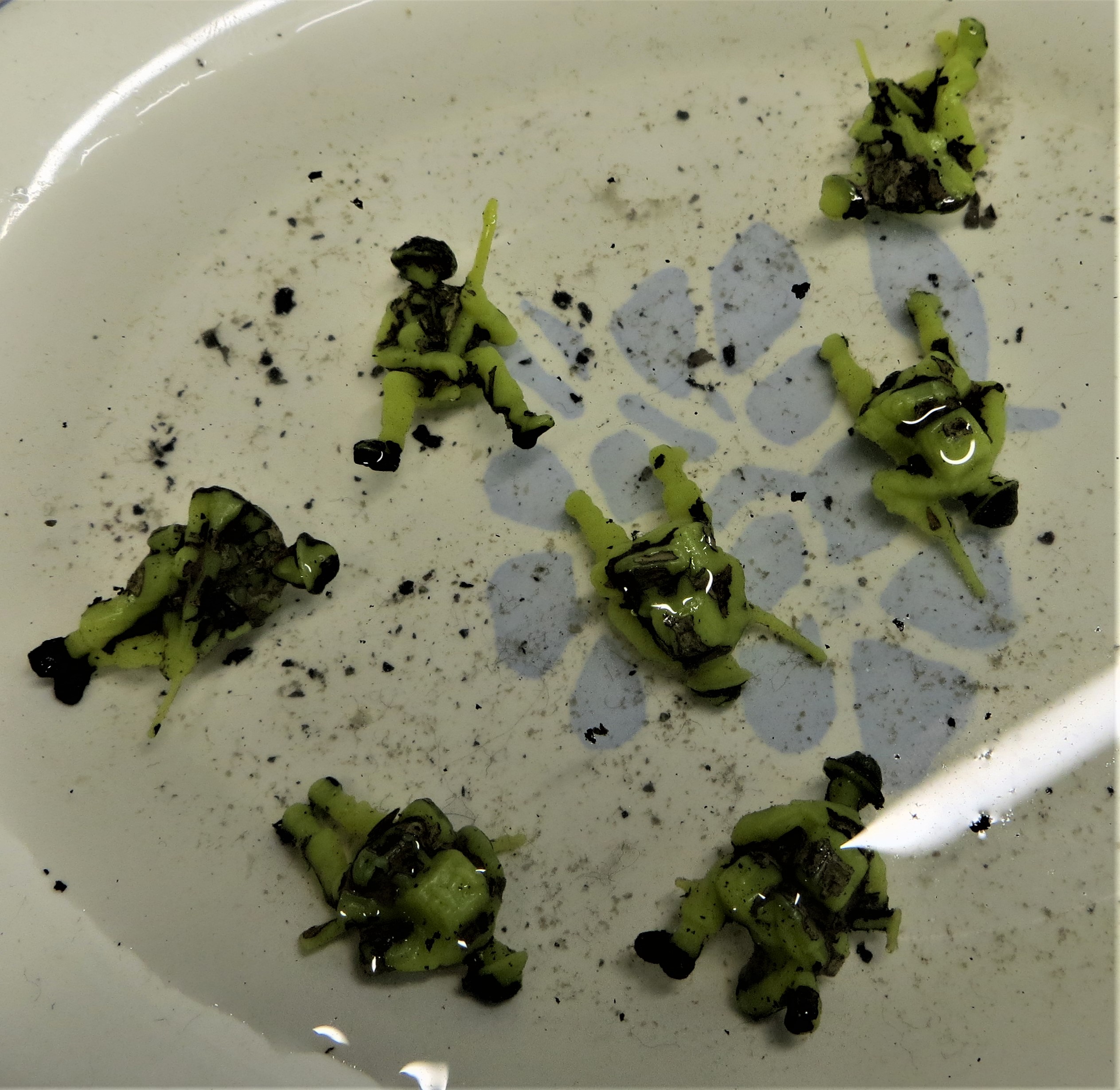

Decided to strip off the plasticard slings and replace them with paper ones as I’m hoping they will hang more naturally, :slightly_smiling_face: :slightly_smiling_face:. The downside was that it also pulled off chunks of paint, so in the end I decided to strip them right back and start again, :roll_eyes: :smile:.
MEN OVERRRBOARRRD, :laughing:!..
Thanks again, and cheers, :beer:,
G

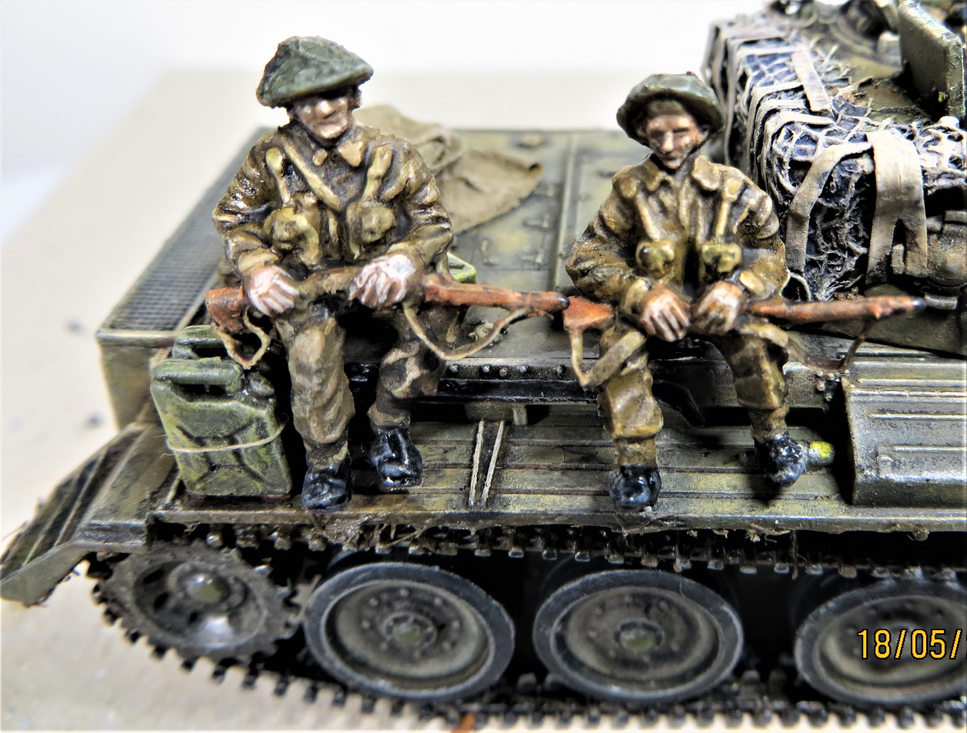

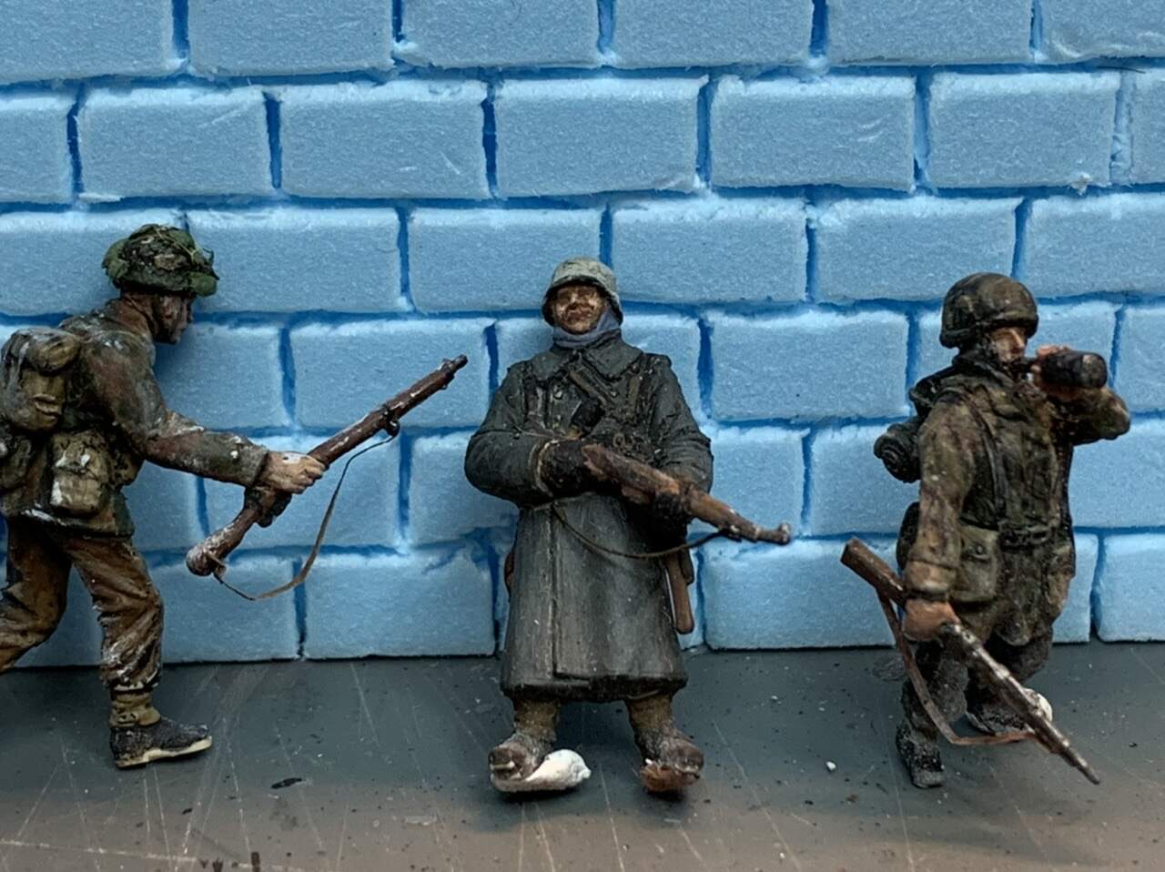

Hi all,
Although it probably doesn’t look like it, :thinking:, these two are the first to be stripped down, fitted with paper rifle slings, and repainted, :roll_eyes:.

Nice job with the strip down and repaint and new slings, they look alot better …more to scale …
Looking good! I have only tried paper and I like it.
After you have glued the paper and the glue have dried, try to carefully wet the paper with a wet brush, that makes the paper workable to form the straps as you want them.
You can try this on the ones you already painted as well. I hope you understand what I mean…?
/Erik
Thanks John, I was struggling to cut them much narrower, but they hang better than the plastic ones, imho, :roll_eyes:.
G
Paper is definitely better than the plastic Erik, :slightly_smiling_face:,
I adopted a similar approach to your suggestion of wetting the paper, but I soaked it in diluted white glue. It’s the method I used for the strips on the camo nets, I find that it makes the thin paper hold its position better when dry and, more importantly imho, it makes the paper more robust, :roll_eyes:.
G

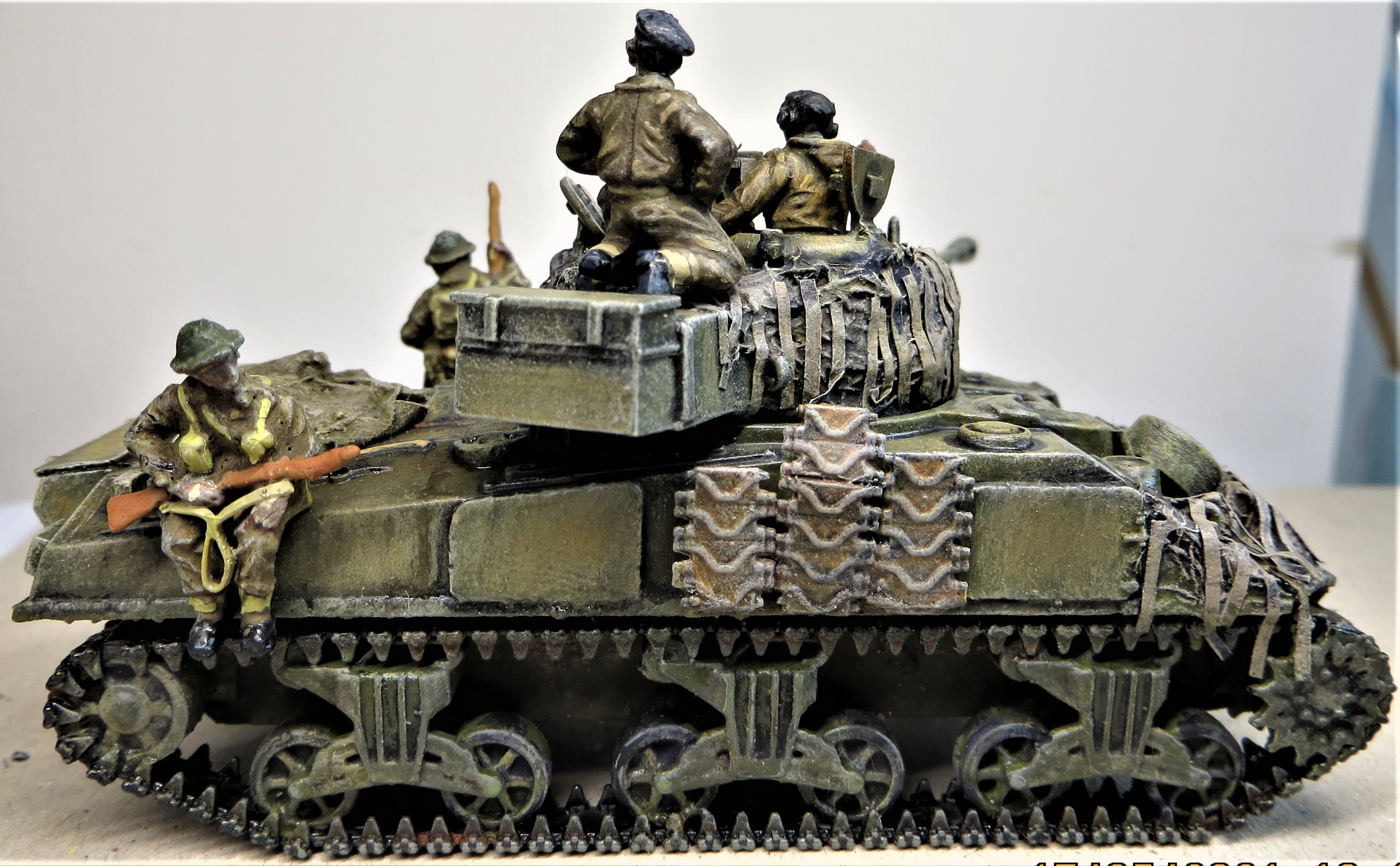

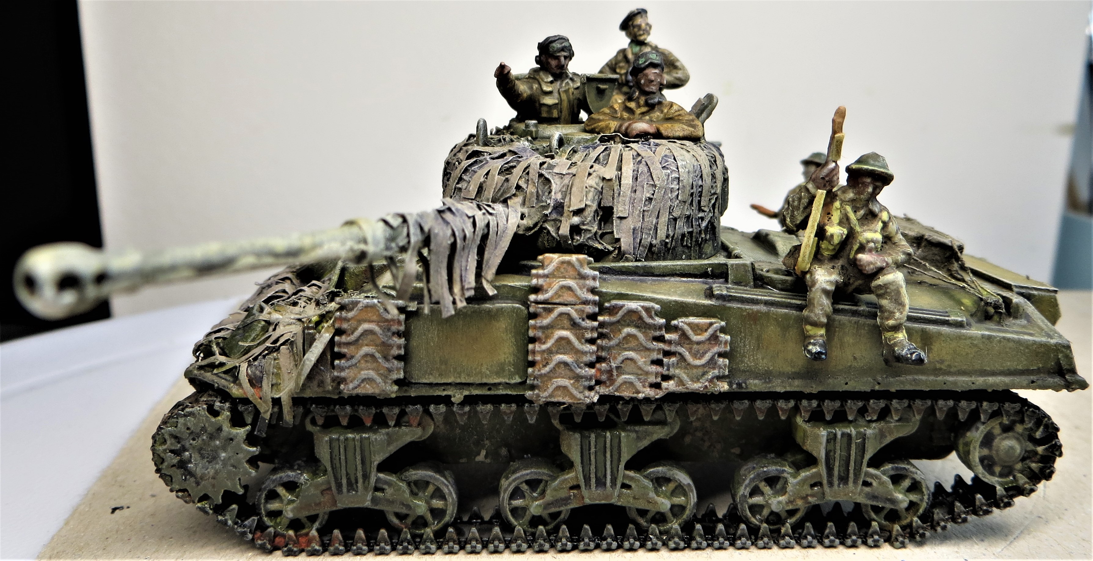

Hi all,
A bit of a play day today, :roll_eyes: :slightly_smiling_face:, added a wooden ladder and a couple of buckets to the rear deck stowage of the Firefly. It needs some washes and highlights, but it gives a more informal touch methinks.
And now the Firefly complete with all riders aboard.
Cheers, :beer:,
G

Great looking Sherman G, looks great with the figures on it now. Have you thought more about the overall scene and the farmhouse; what will be going on in that area ?

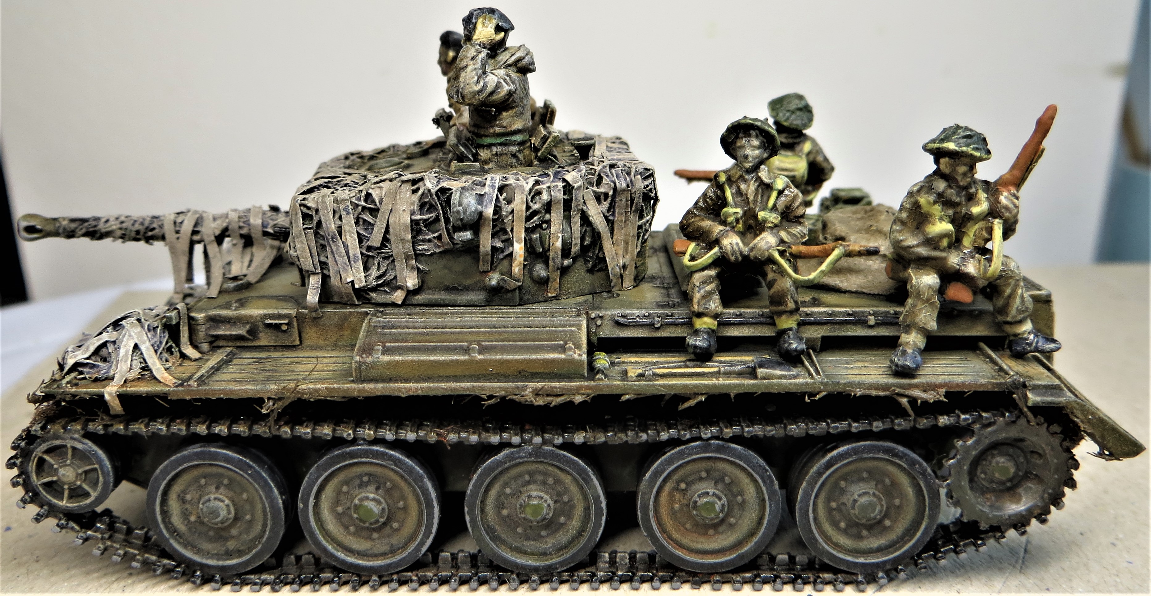

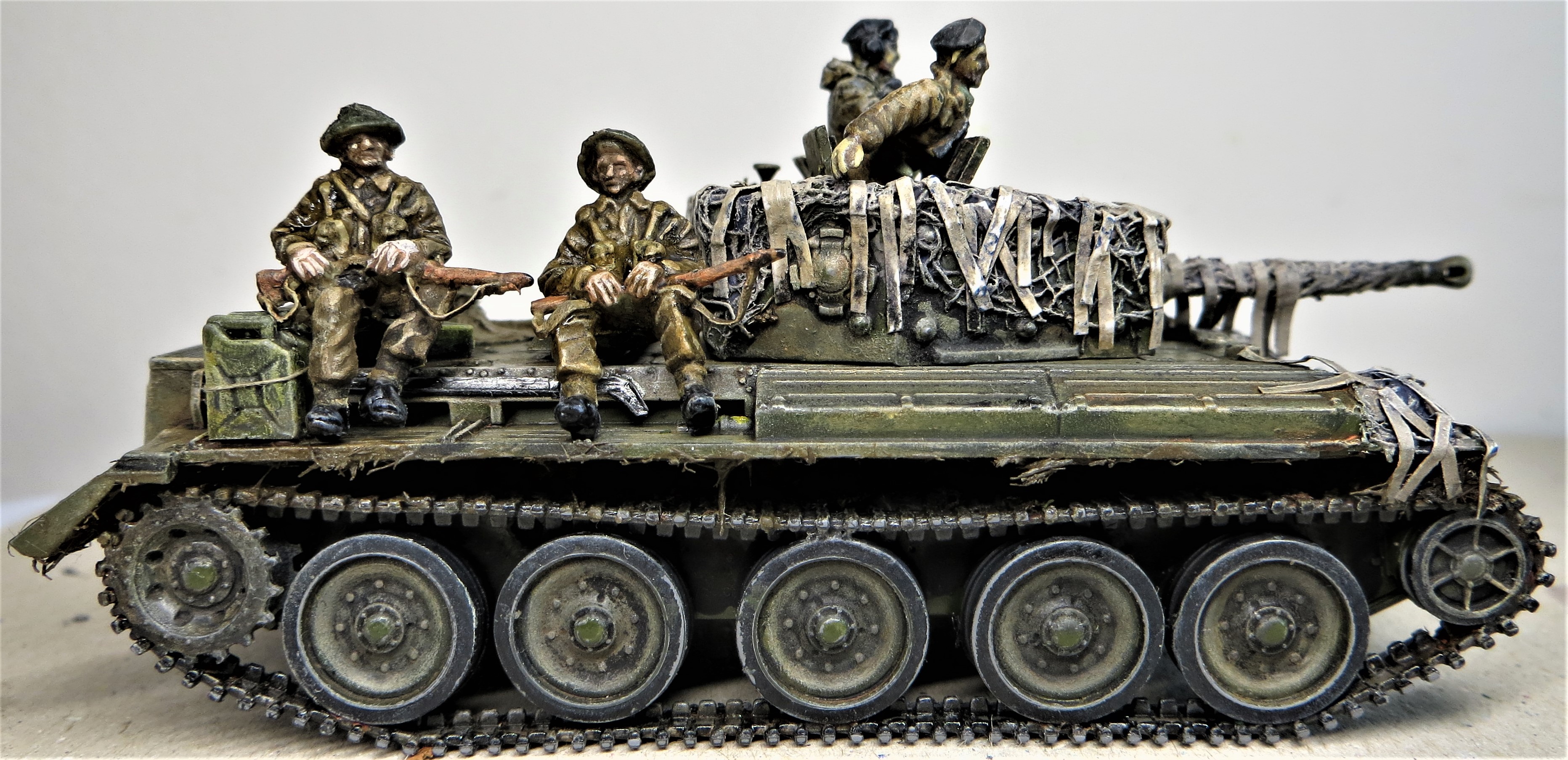

Hi all,

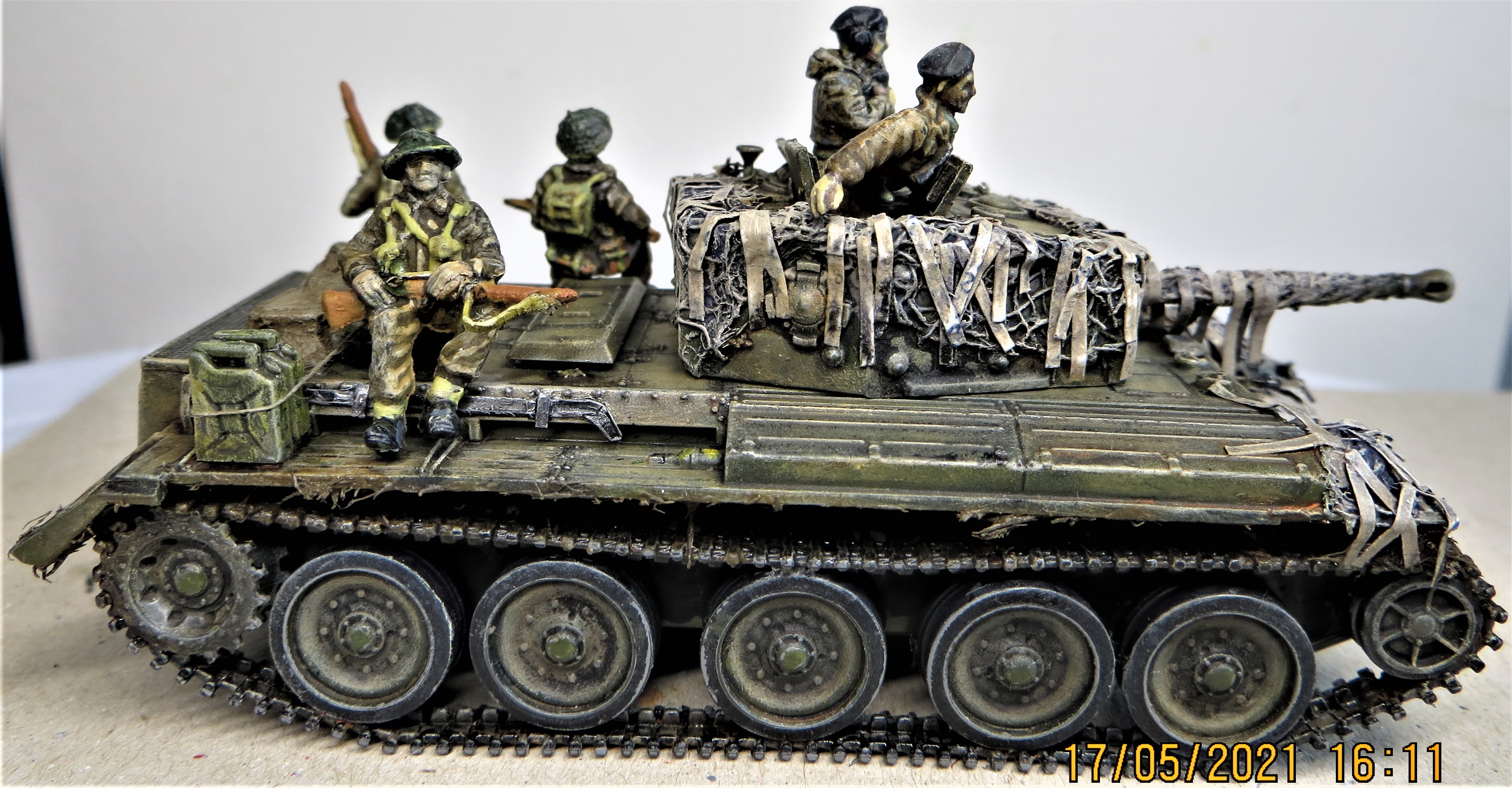

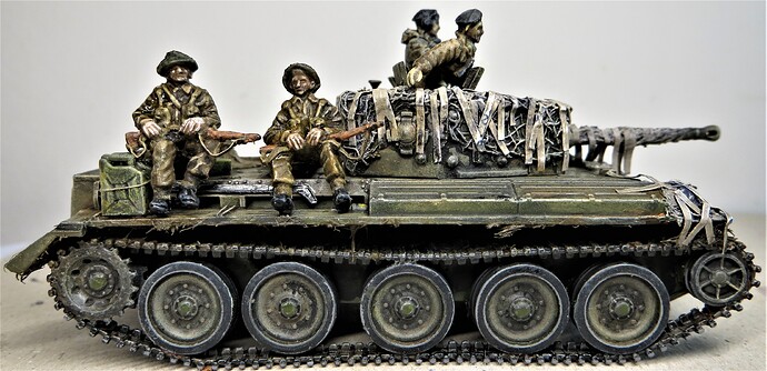

I have now finished both the 1/72nd Airfix Firefly and Revell Cromwell and dressed them up with the figures, below is a walkaround of the two.
And below are the two insitu…
Cheers, :beer:,
G

@G-man69 I applaude your effort here. Although you said that you’re new to this scale, you have reached a level of work I can only aspire to, and that means the scratch built farm as well as the figure painting.
That is looking outstanding G… Fantastic effort and it all ties in together just right and you find yourself in the Bocage watching them trundle past…
Now sure about the lead wagon … I think in a non combat situation there are to many variables to worry about as to who would out in front. I would leave as is mate.
