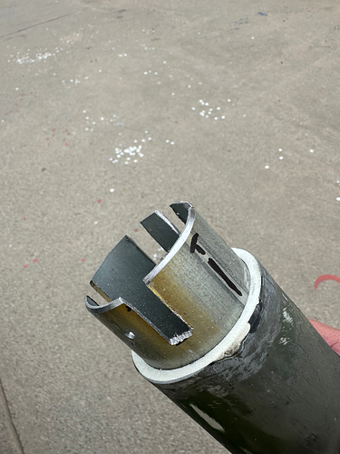

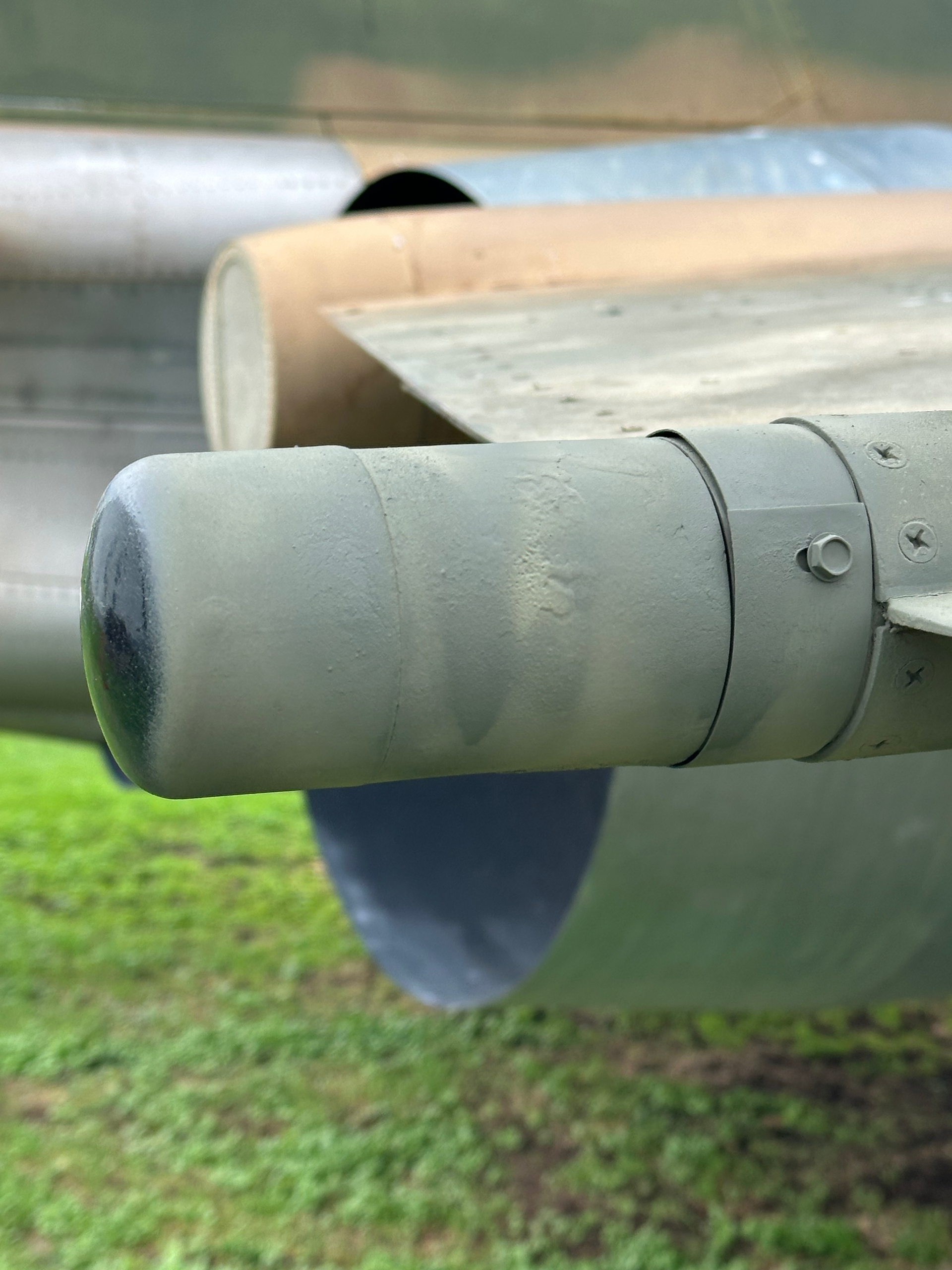

I did manage to recreate the ECM pod on the horizontal stabilizer using PVC and piece of steel tubing someone had thrown in the scrap bin that was just the right size. I had to cut the slots to allow for the internal hardware that was in the way. Why grown adults keep pulling on things like this, I don’t know.
It still need black paint in this photo:

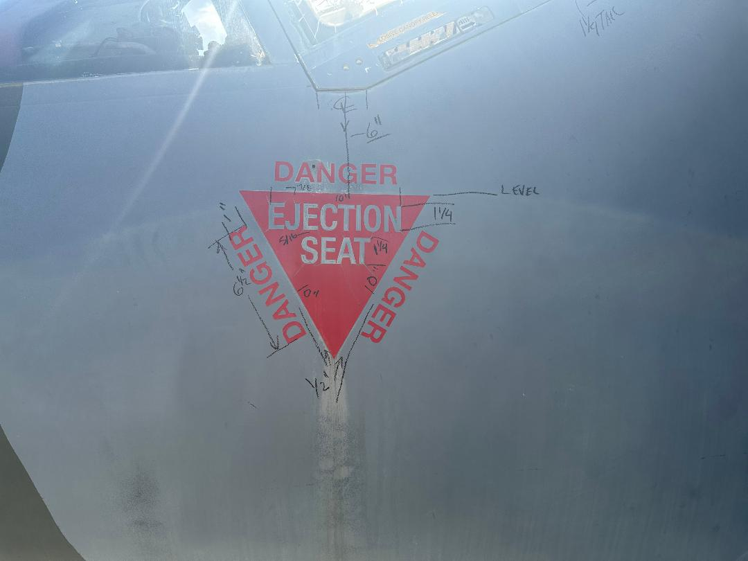

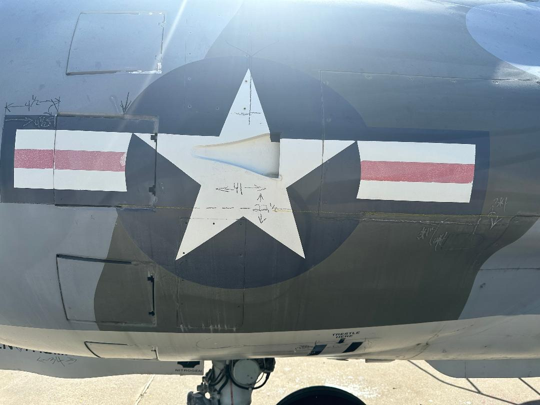

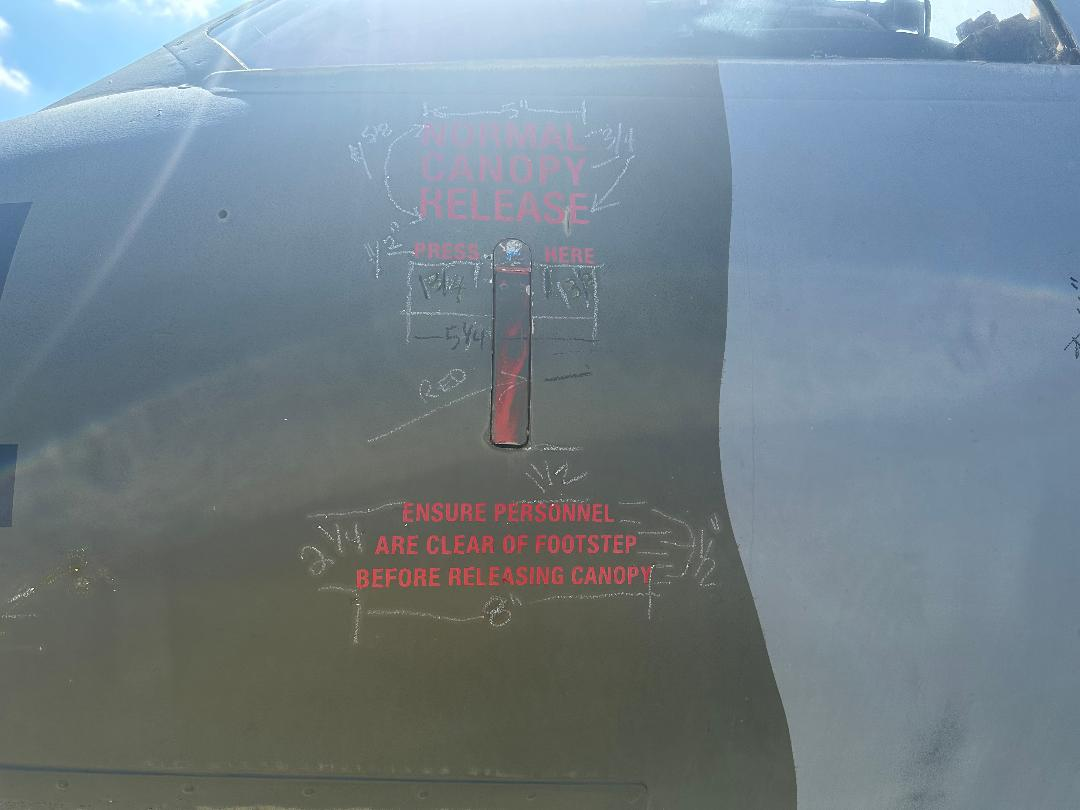

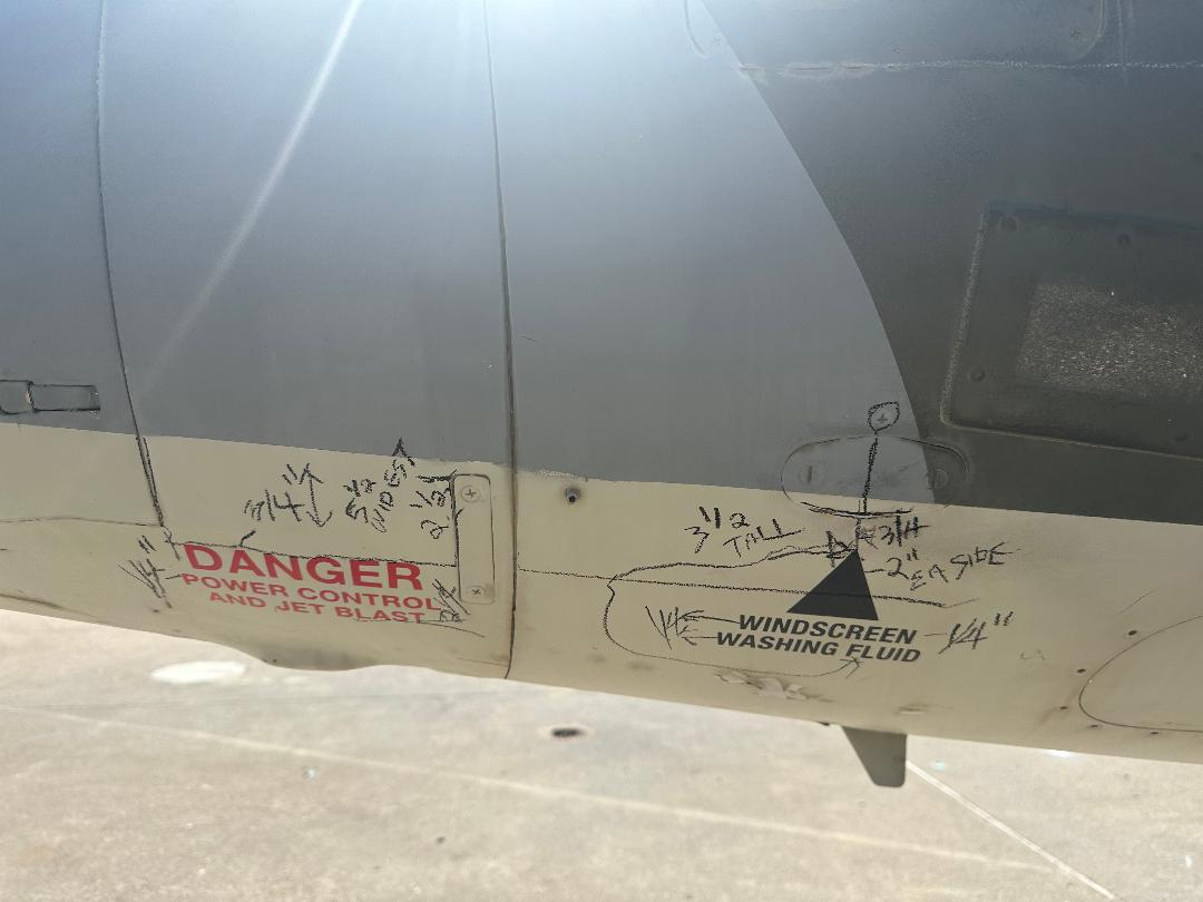

Now, I did say we’re very precise with stenciling. We’re working on a Harrier today. Here’s a glimpse as to how it’s done, as per Air Force specifications:

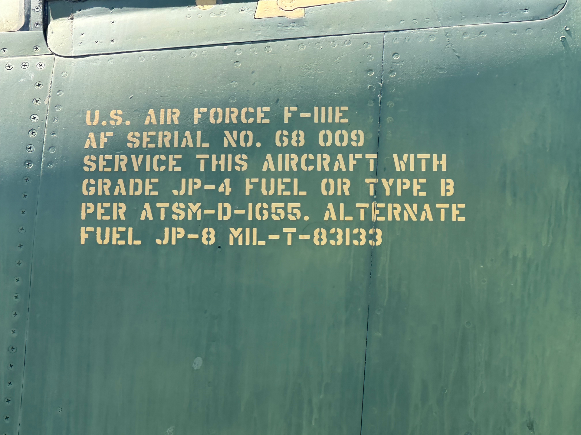

So if we’re this meticulous, what happened on the F-111E?
There good new, and there’s better news.
When a plane arrives as this one did back in 2013, all stenciling is notated so it can be replicated exactly later on. I actually have photos from then. This plane had none of the usual informational stenciling, but it bore its original paint job.
We happen to have a pilot who flew them. He said most squadrons were very meticulous about the stenciling. Some not so much. This was one of them. His own plane was devoid of almost all stenciling, and our plane was done with his approval.
As you saw above, we have the drawings that show in great detail where the makings go. Picasso says we may have those drawings squirreled away someplace. Our archives are in a bit of disarray at the moment. He said if he can’t find them he can try to make some calls and get digital copies.

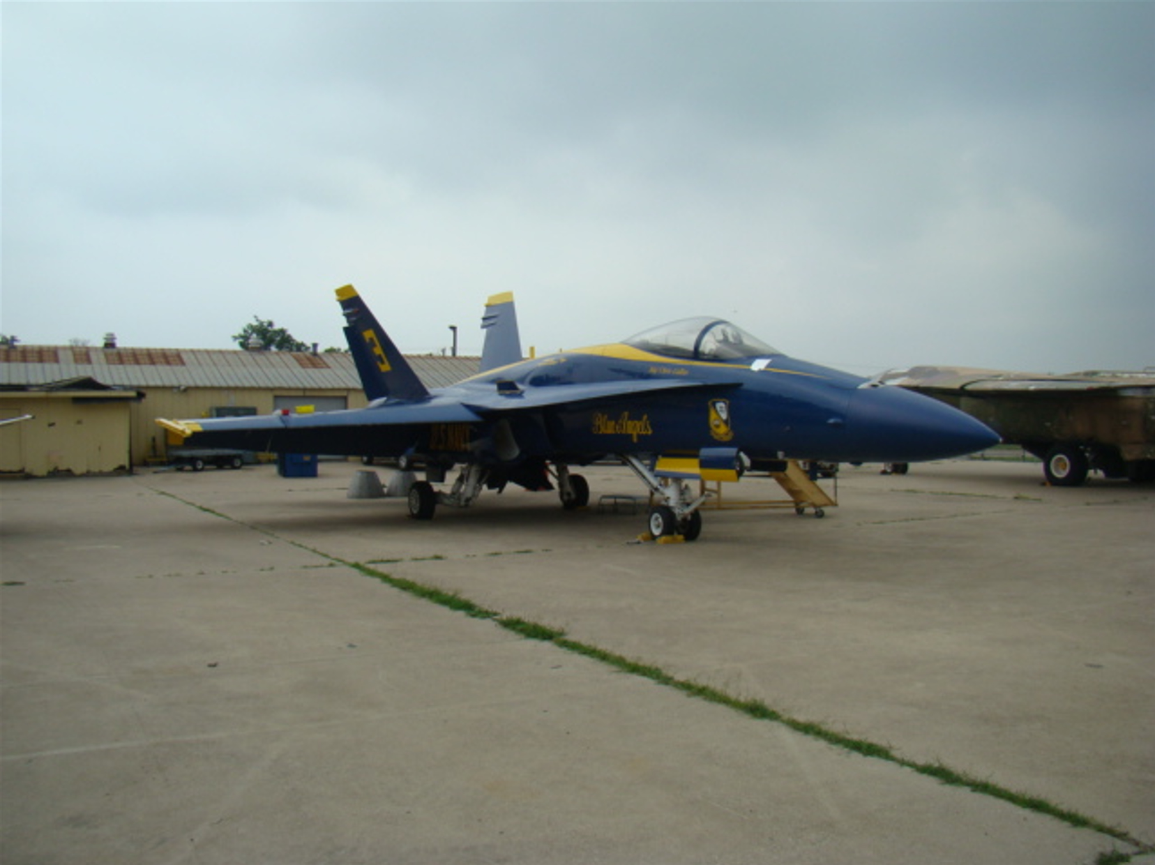

I know I have more photos somewhere, but here’s our Blue Angels F-18 as it looked in 2013. We just recently repainted it. (I’ve posted photos) You can barely see our F-111 in the background as it looked before restoration.
A few of our planes were flown in on what was to be their very last flight. The F-18 was one such plane.
