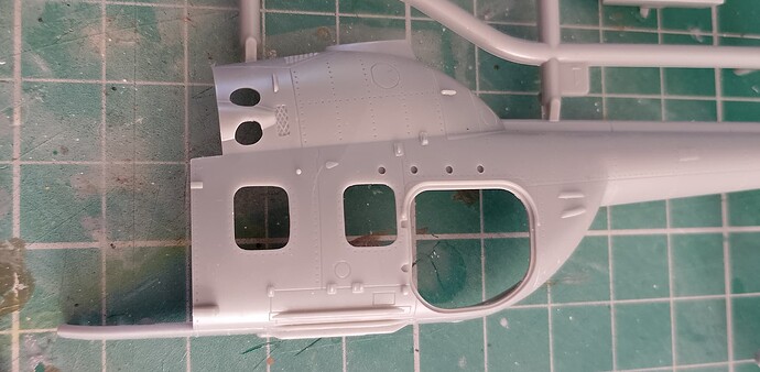

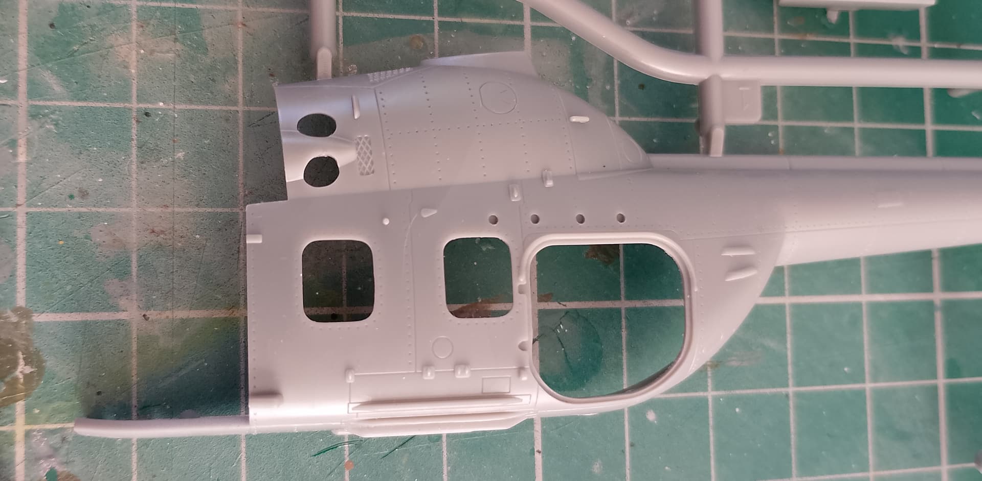

Detailing is nice on the fuselage and fit perfectly when I did a test fit.

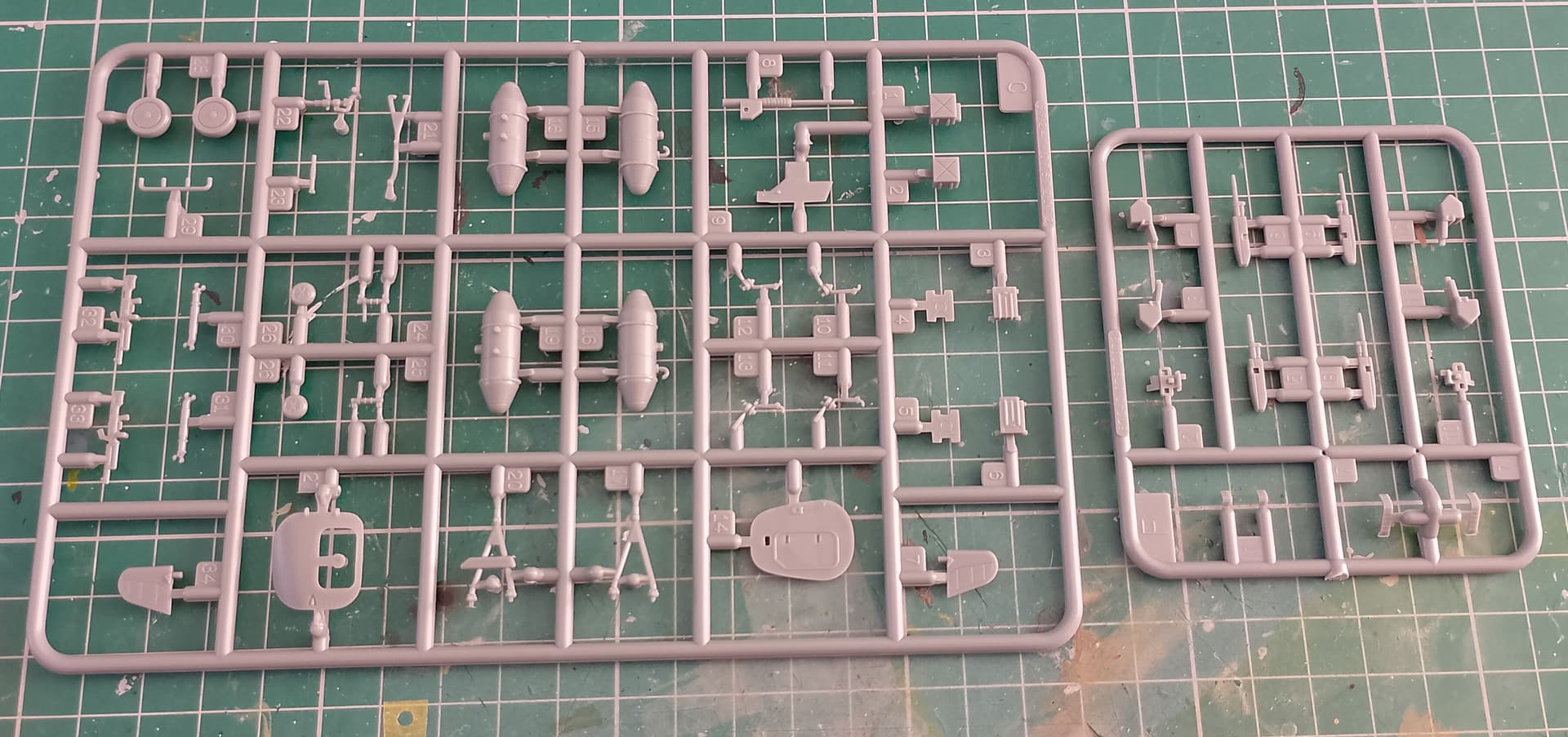

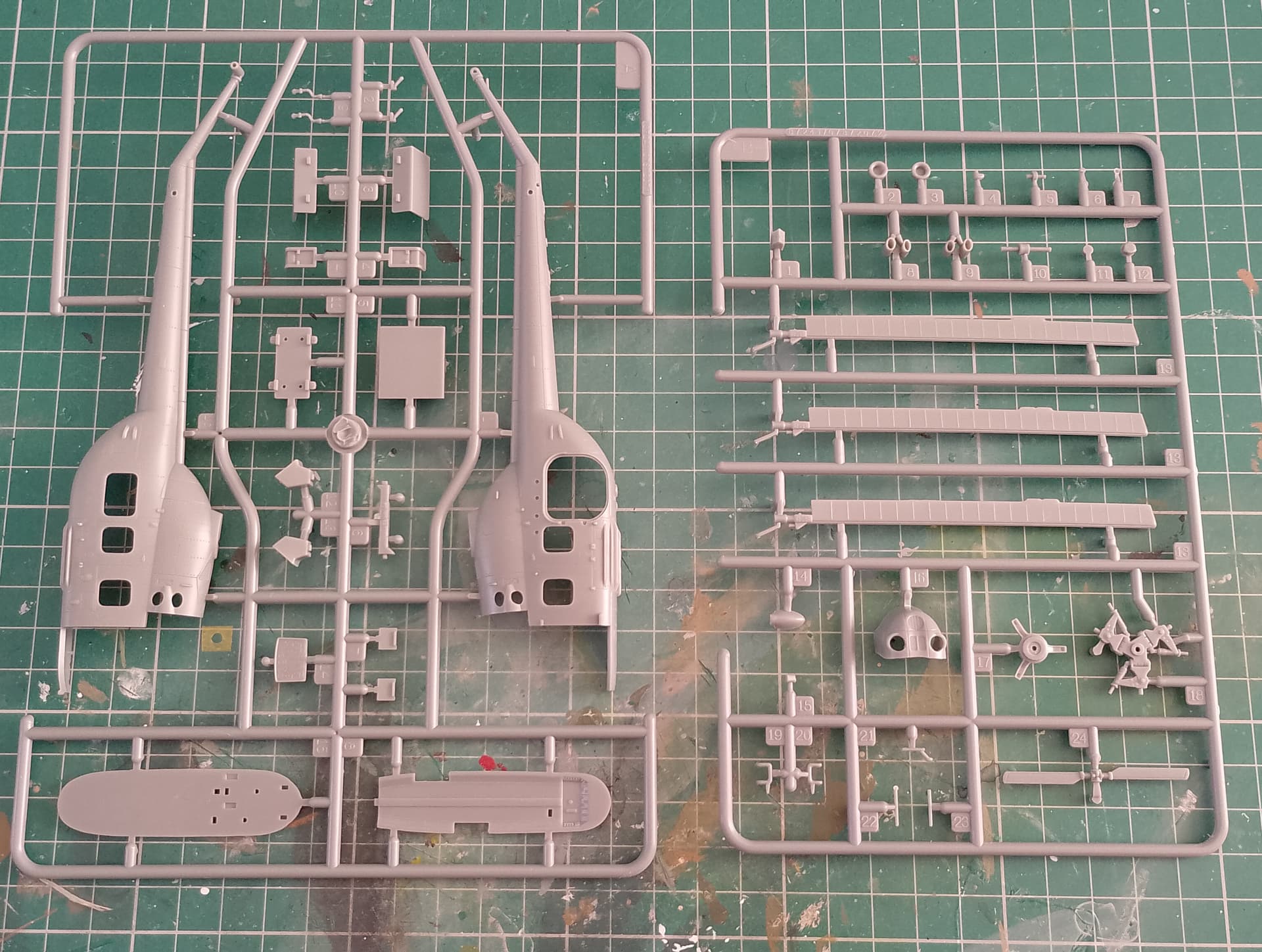

Armament sprue. This is the only thing that changes between the various boxings. I have got my eyes on the Anti-Tank version next with AT-2 Swatter missiles.

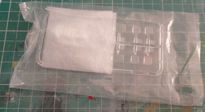

As usual with Hobbyboss, all the sprues are separately bagged and delicate parts have an extra layer of foam wrapped around them. Wish more manufacturers would put this effort into packaging to protect the transparencies (Revell, I’m looking at you!).

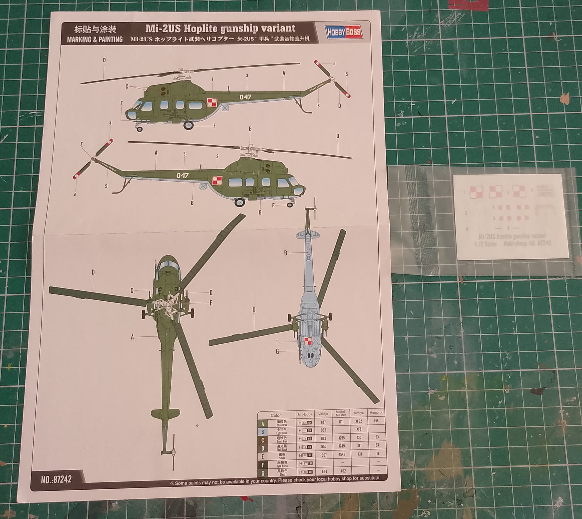

Markings are provided for a single Polish aircraft, as are all in the range.

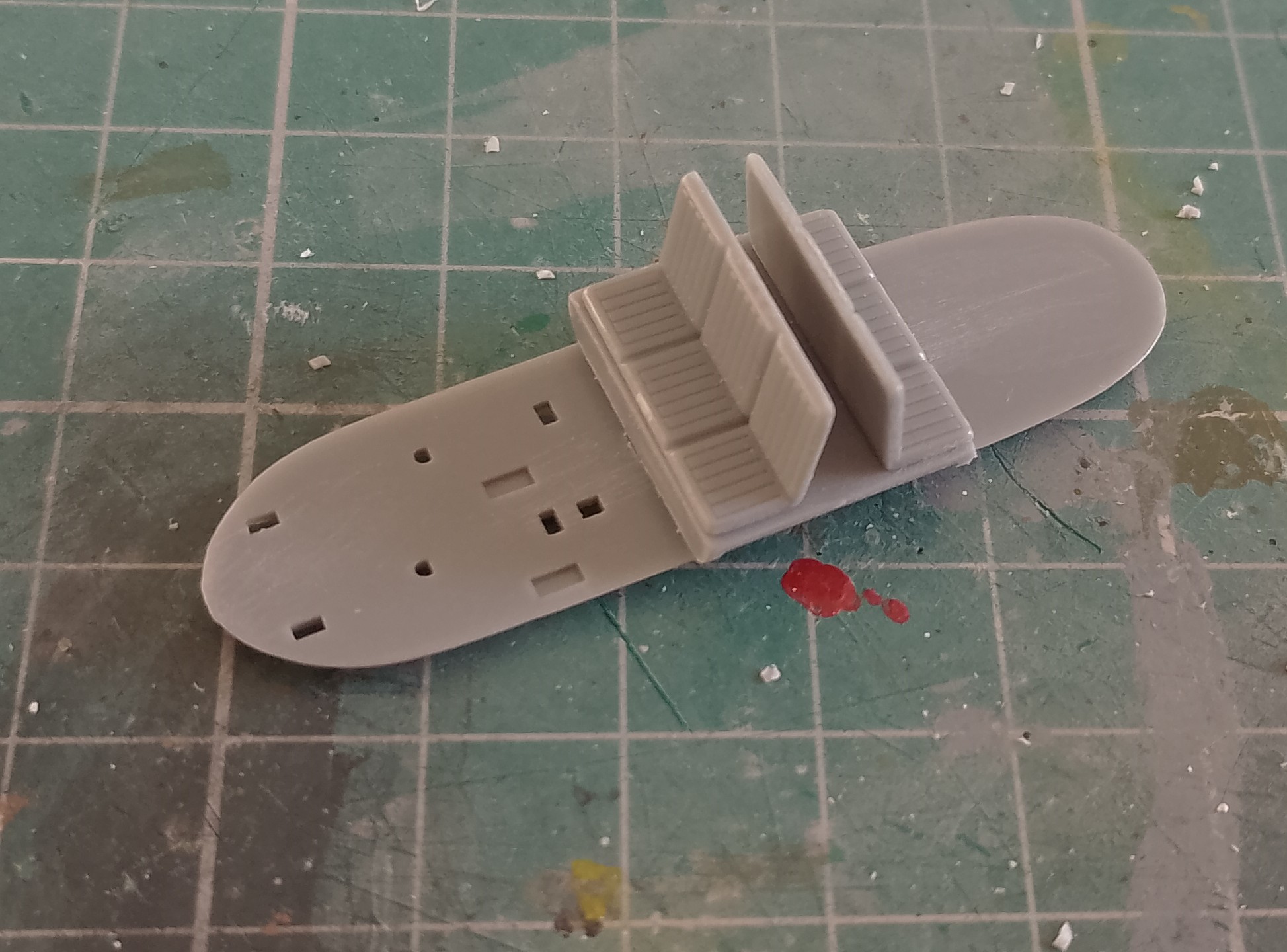

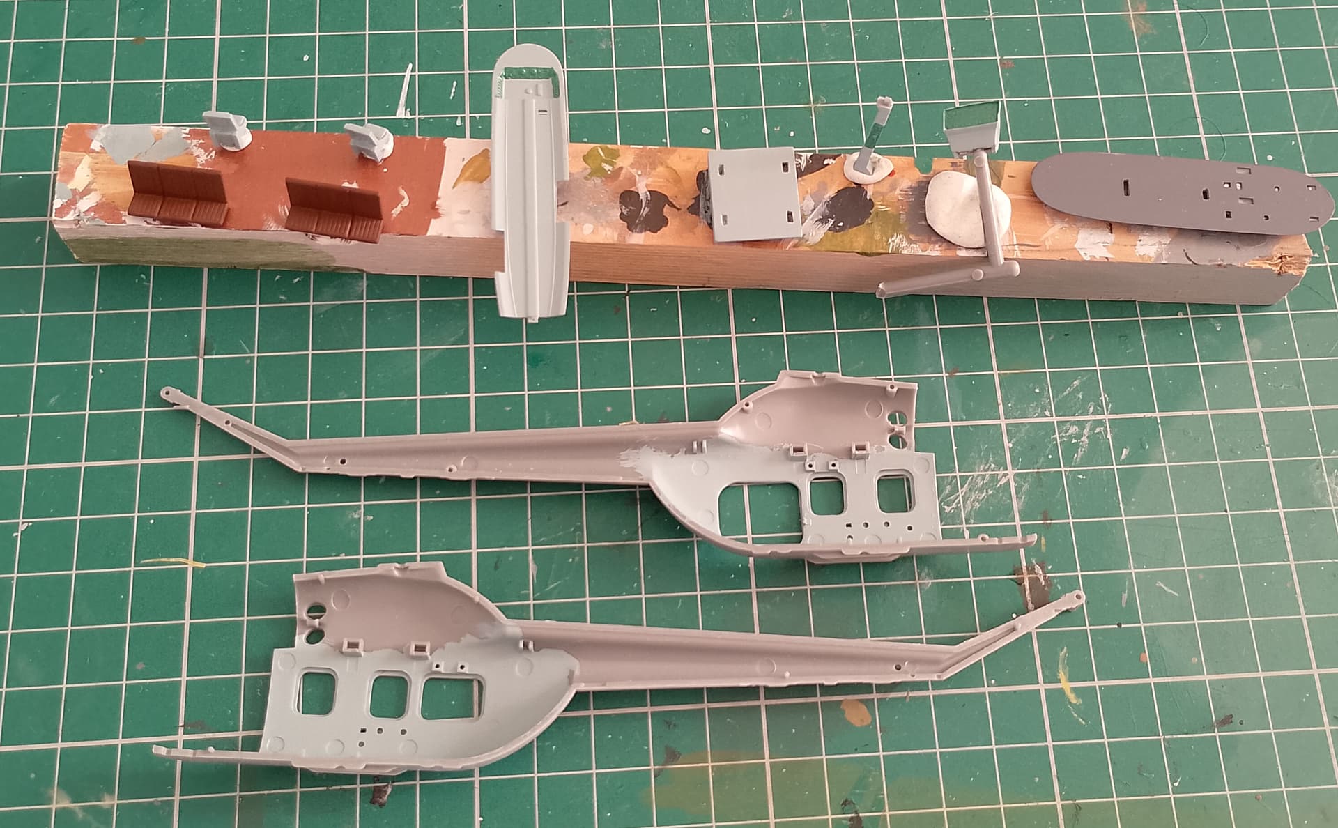

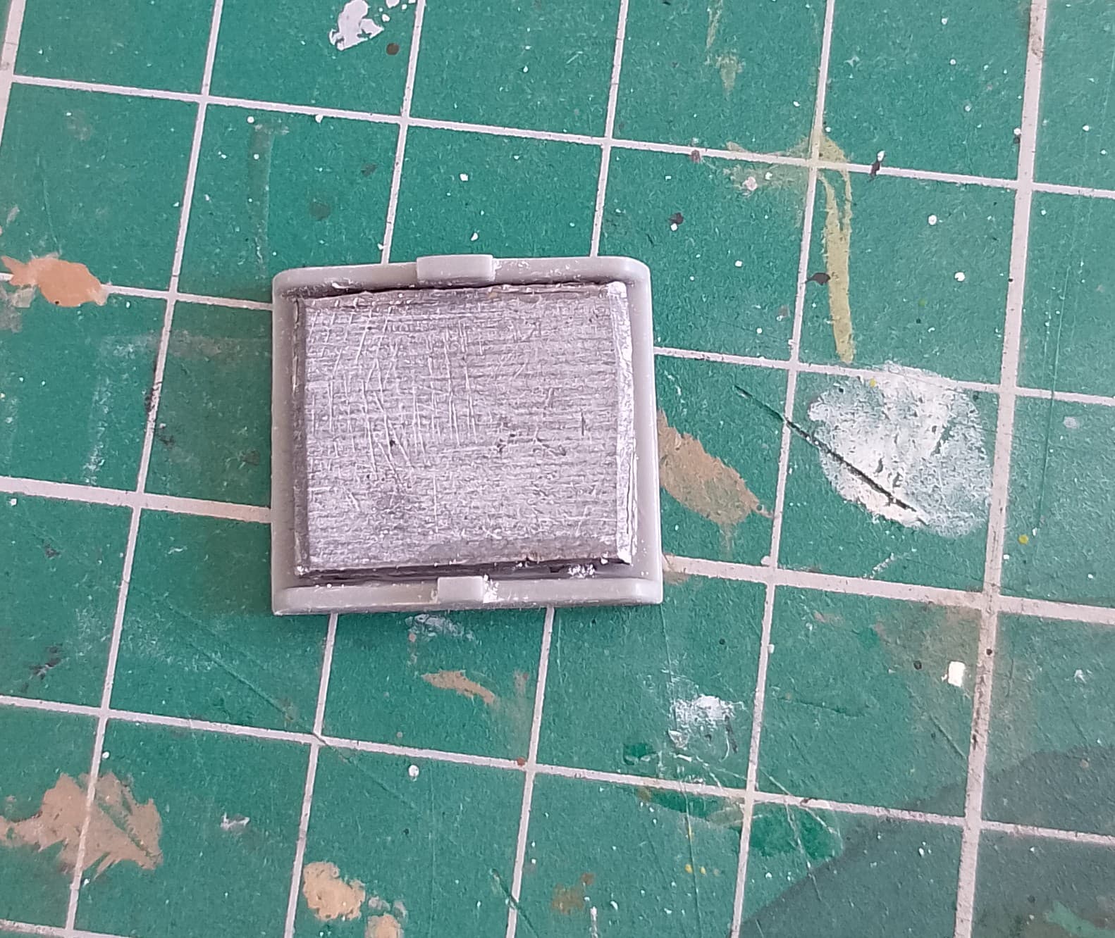

Everything starts with the cockpit and cabin. You do need to cut some slots for the cabin seats. Not difficult, but the plastic was a bit thick. I chain drilled through the slots on the underside and trimmed. Holes are a bit ugly, but they’re hidden under the seats.
This also a good place to hide some lead weight to keep her sitting level.

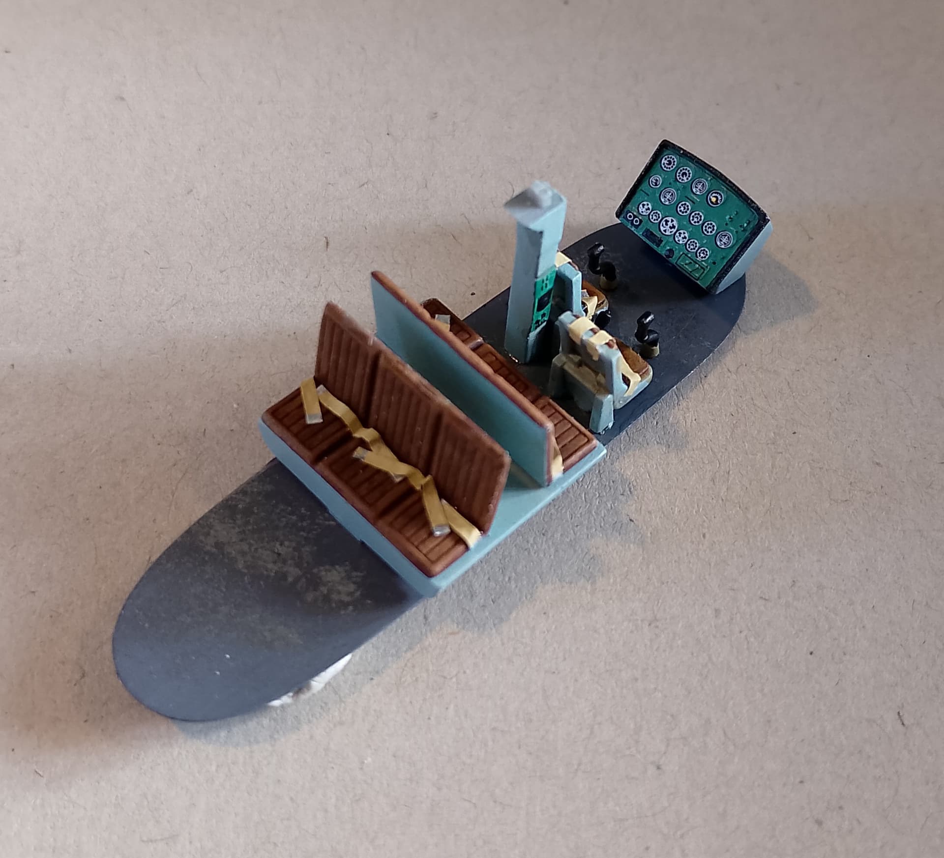

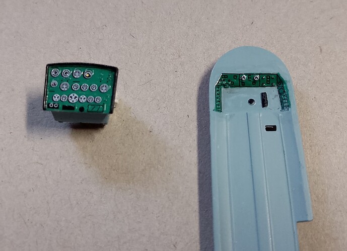

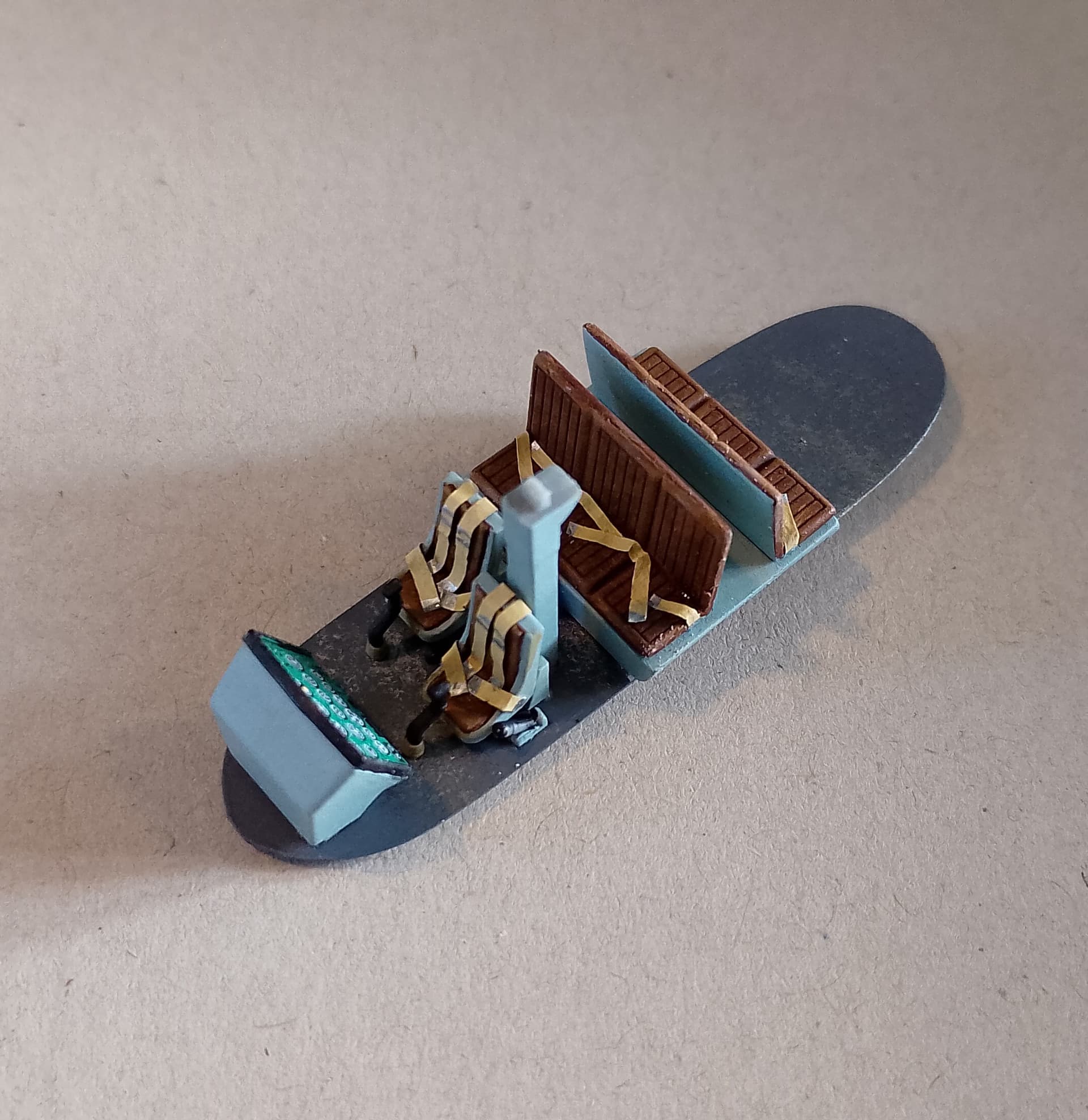

Managed a little bit more tonight when I got in from work. Finished up the flight controls and gave the seats a dry brush and wash to make them look used and lived in. Gave the instrument a coat of gloss ready for decals. Should be able to get them down tomorrow.
Decals applied to the instrument panels. The upper console decal was a bit tricky to apply, had a little distortion on one side. Not much of it will be visible, but it’s a nice little detail that could have been overlooked.
And the interior is now mostly done. Just guns to do (instructions are vague on how they assemble). Seatbelts were made from painted tissue paper. The sort they cover decal sheets with.

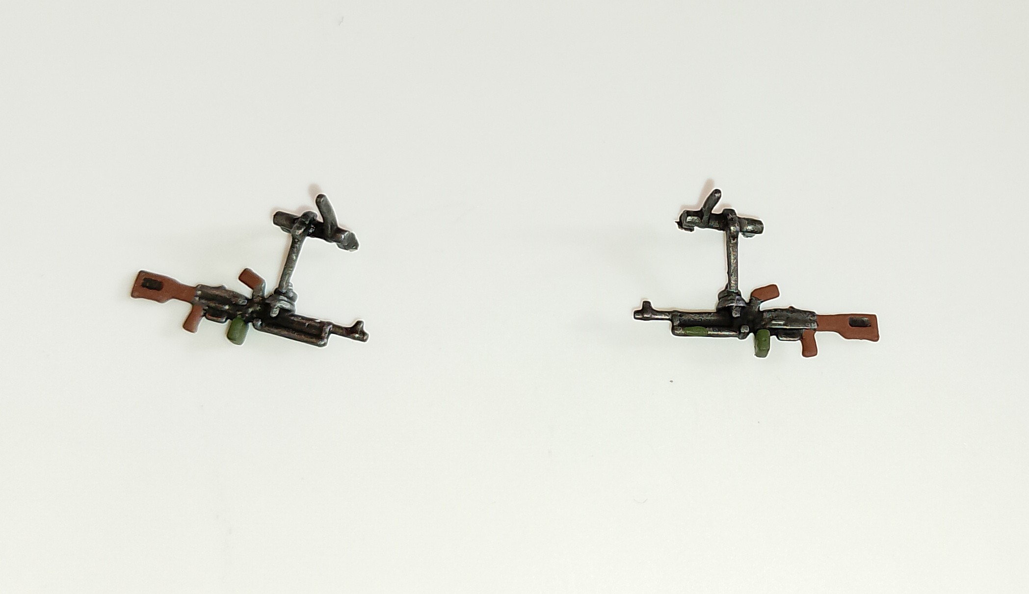

Door guns painted up.

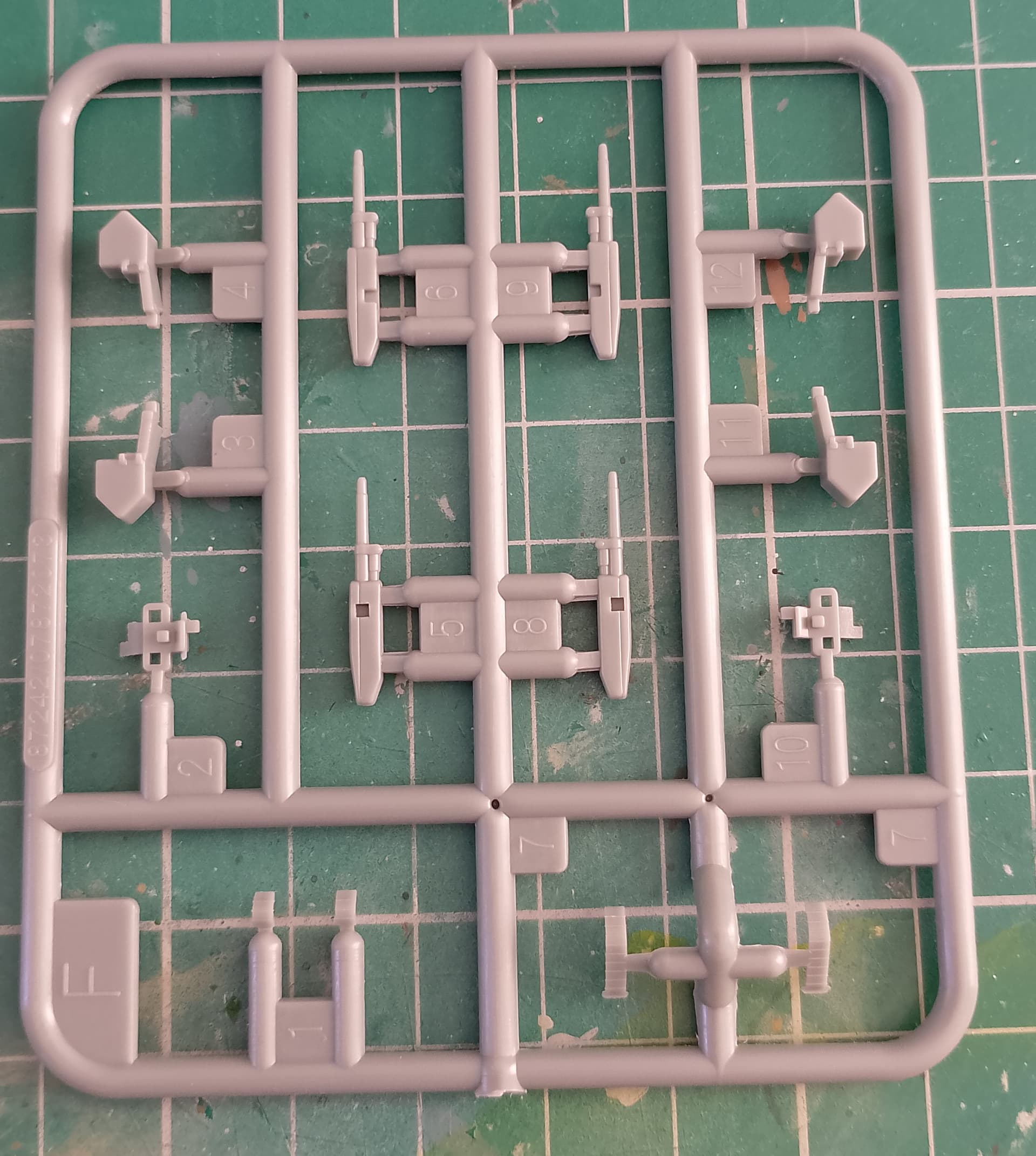

The mounting arms are very fiddly to assemble and fragile. Not much surface area for the parts to attach to each other, especially on the upper rail.
I deviated slightly from the instructions here. Hobbyboss would have you fix the arm to the mg carry handle. But, it hangs far too low if you do. Below the window and interfering with the fit between the cabin seats and fuselage. I decided to fit it to the top of gun in front of the handle. Looks like a logical place that would not cause a problem with the guns breech and operating parts. But it is a best guess on my part. Try as I might, I haven’t found photos showing how the guns were fixed on the real thing.
