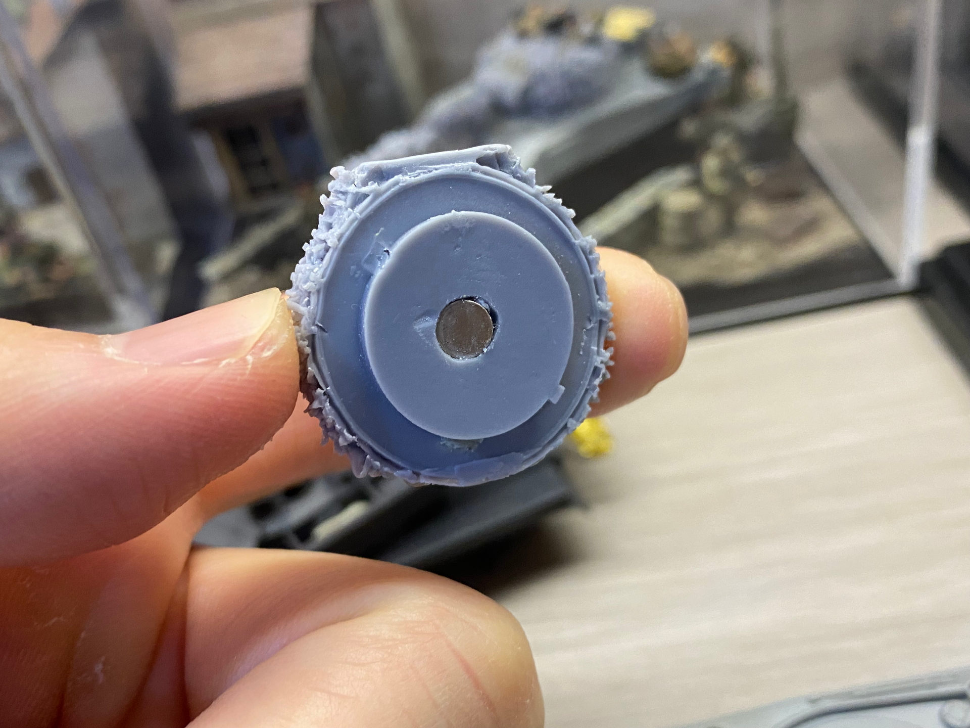

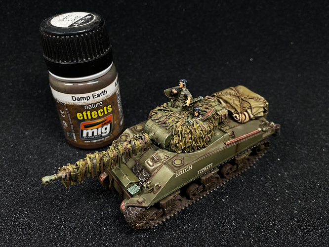

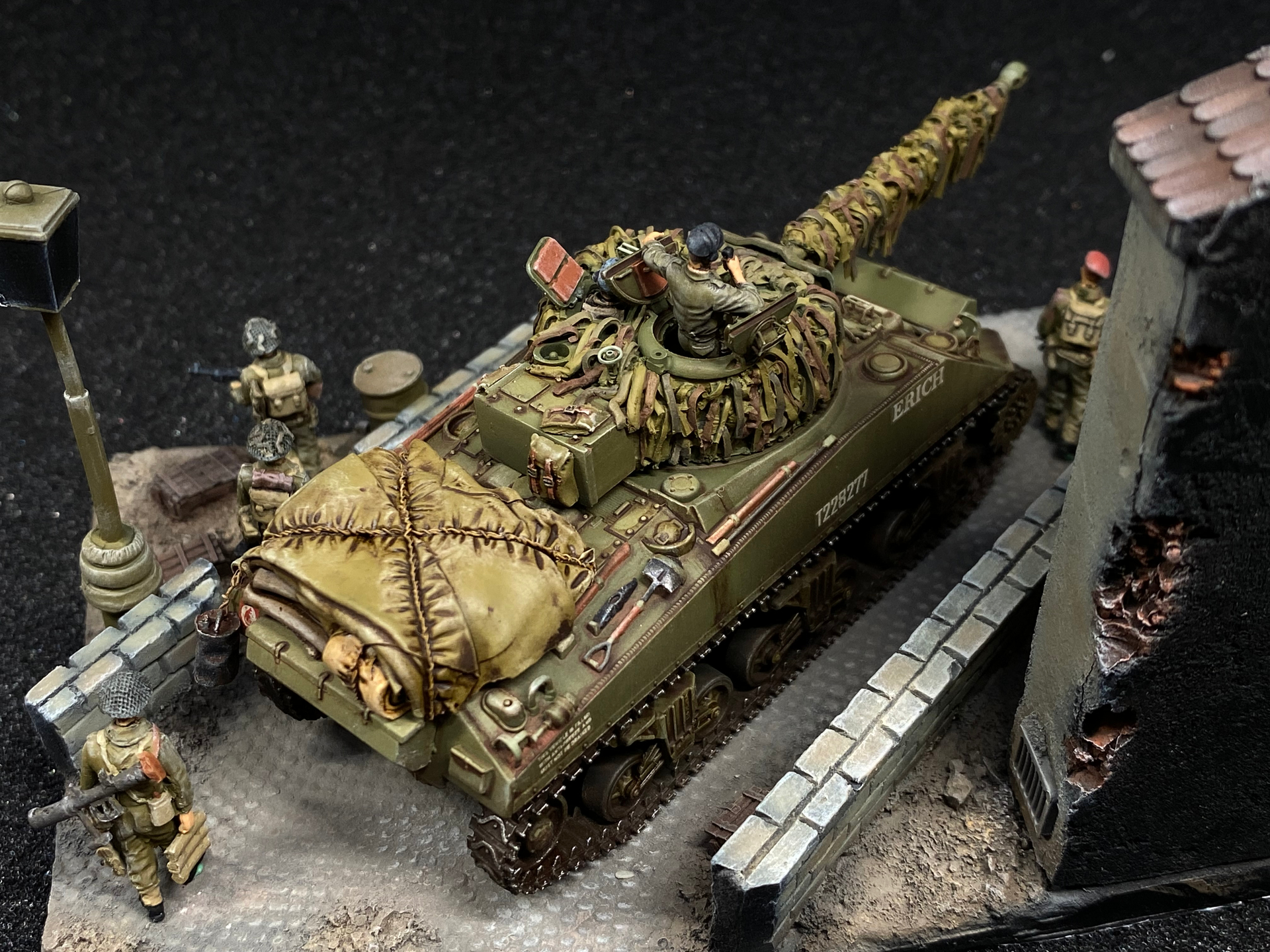

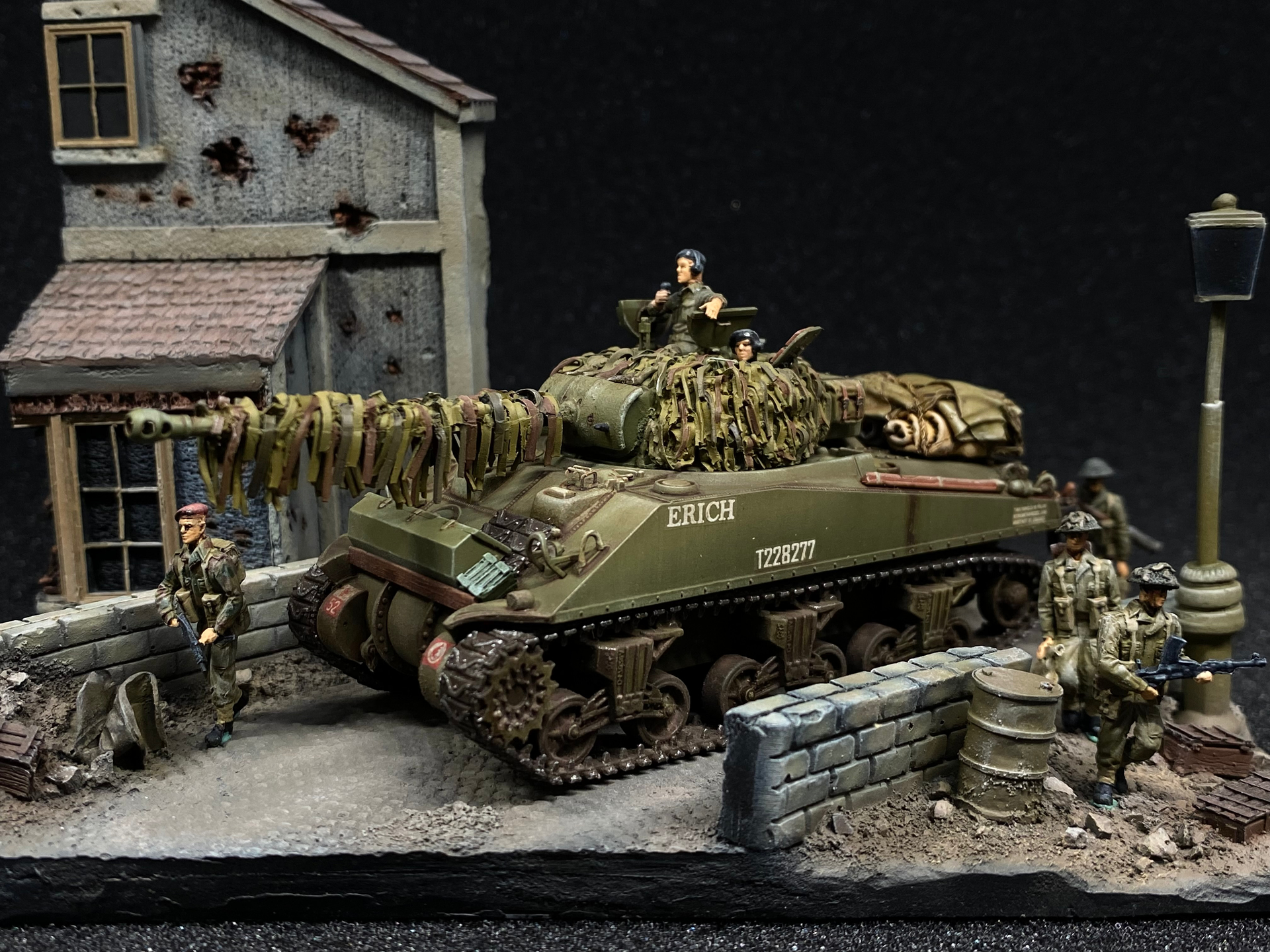

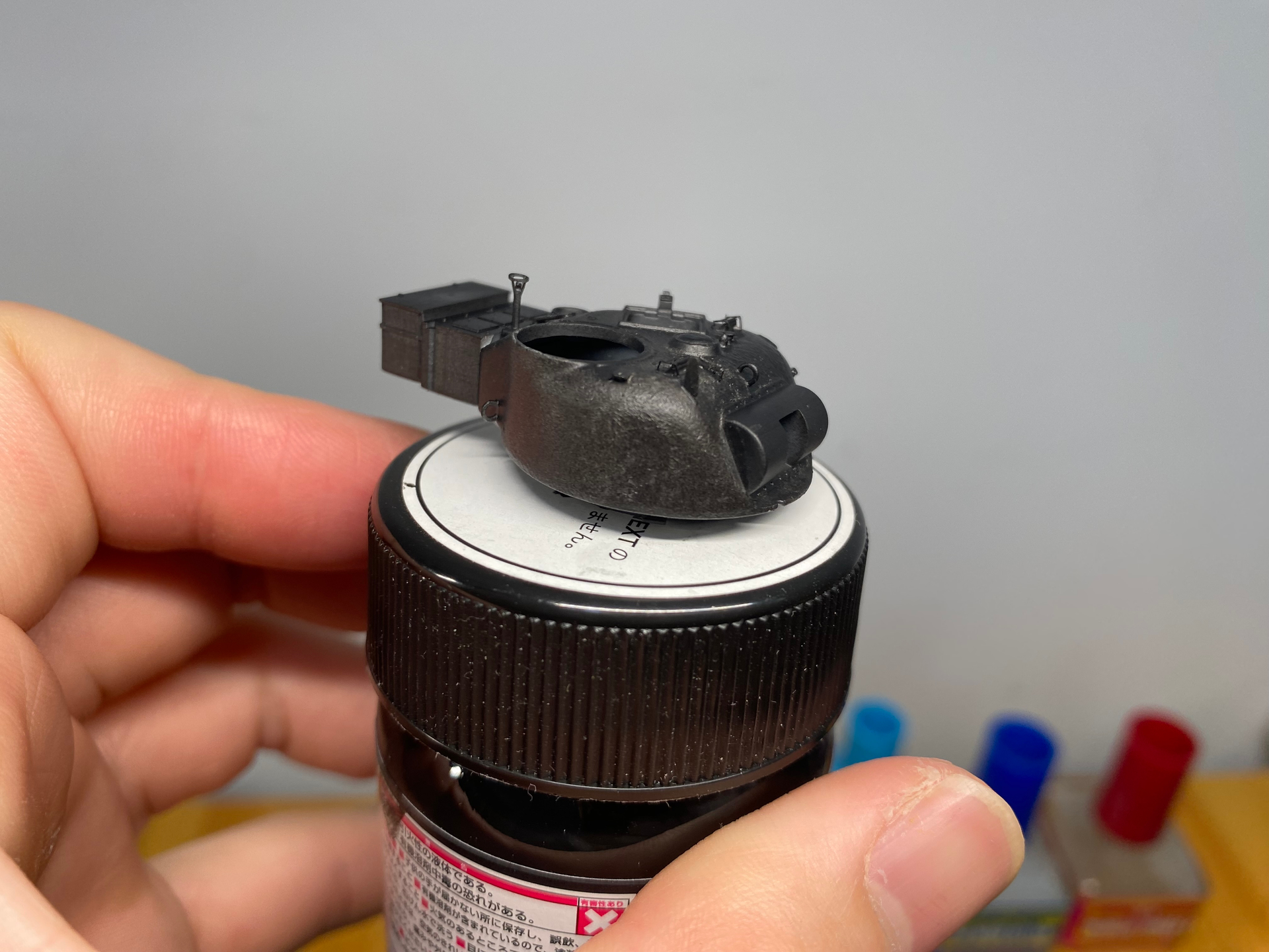

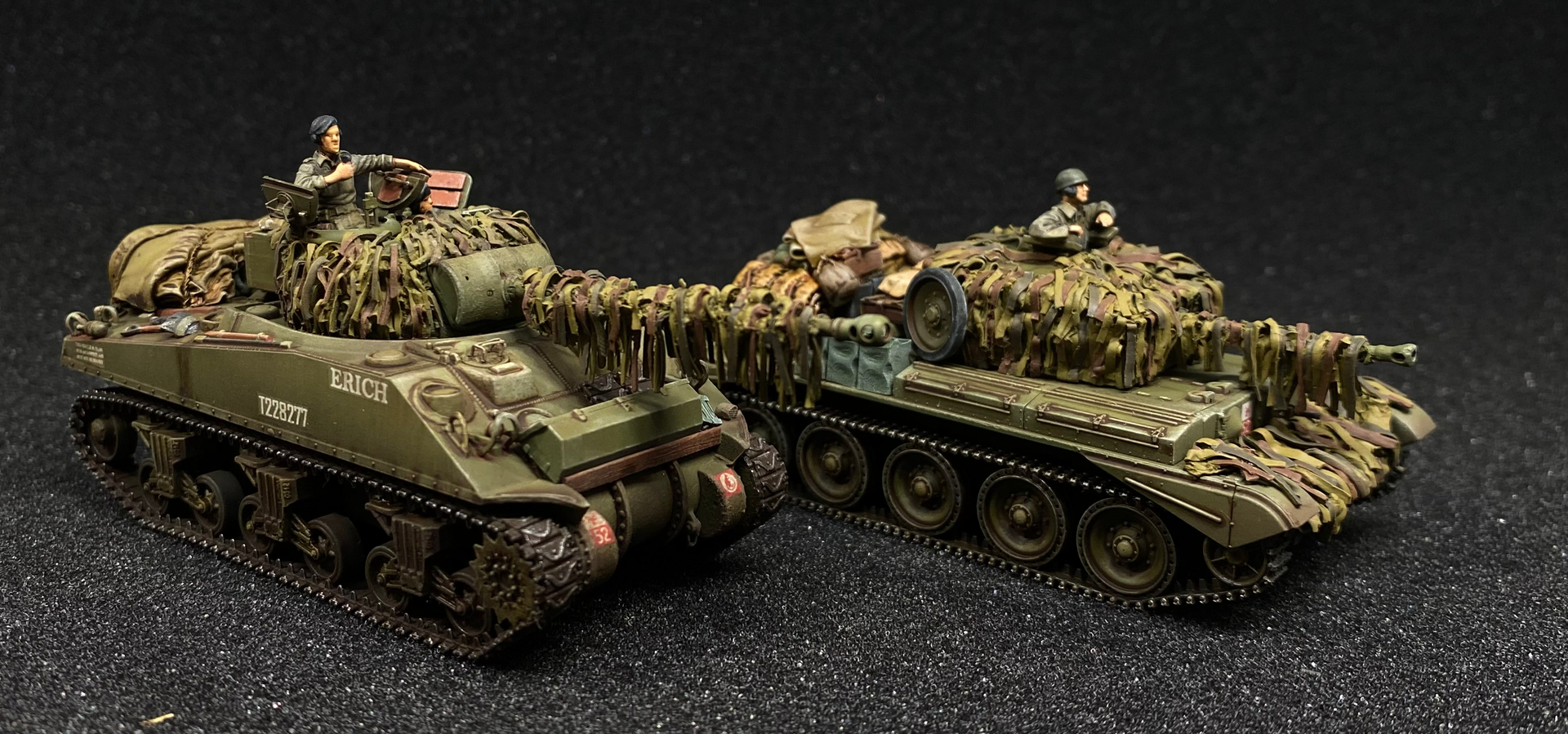

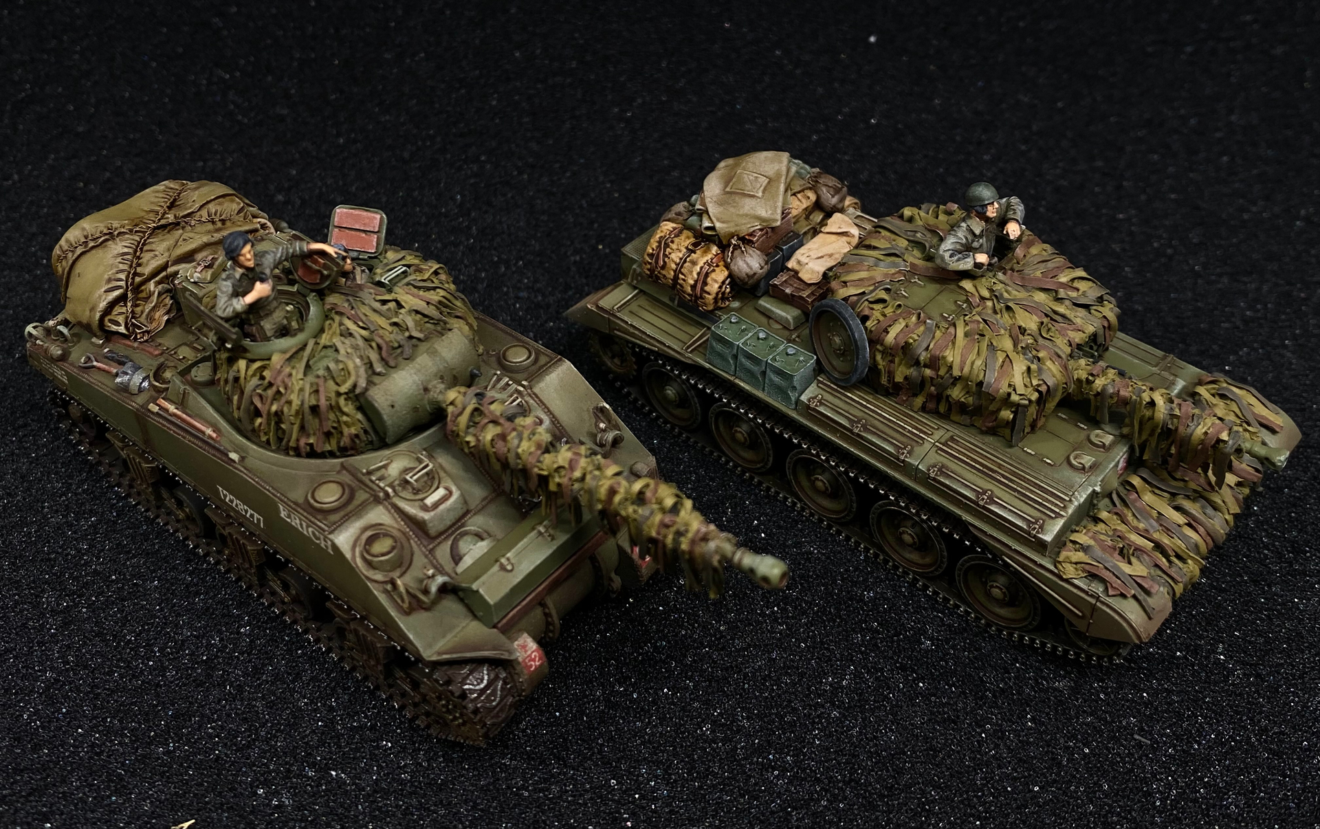

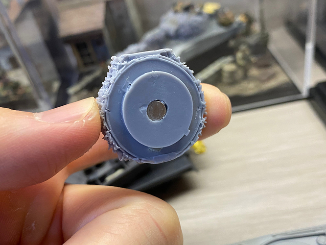

This Firefly tank was built primarily using the Dragon kit, combined with a Black Dog resin turret, with some turret parts and the tracks being 3D-printed. Additionally, I used toothpaste putty to handcraft the gun mantlet and transmission cover armor to replicate the cast texture. I also added hull weight and a magnetic turret attachment.

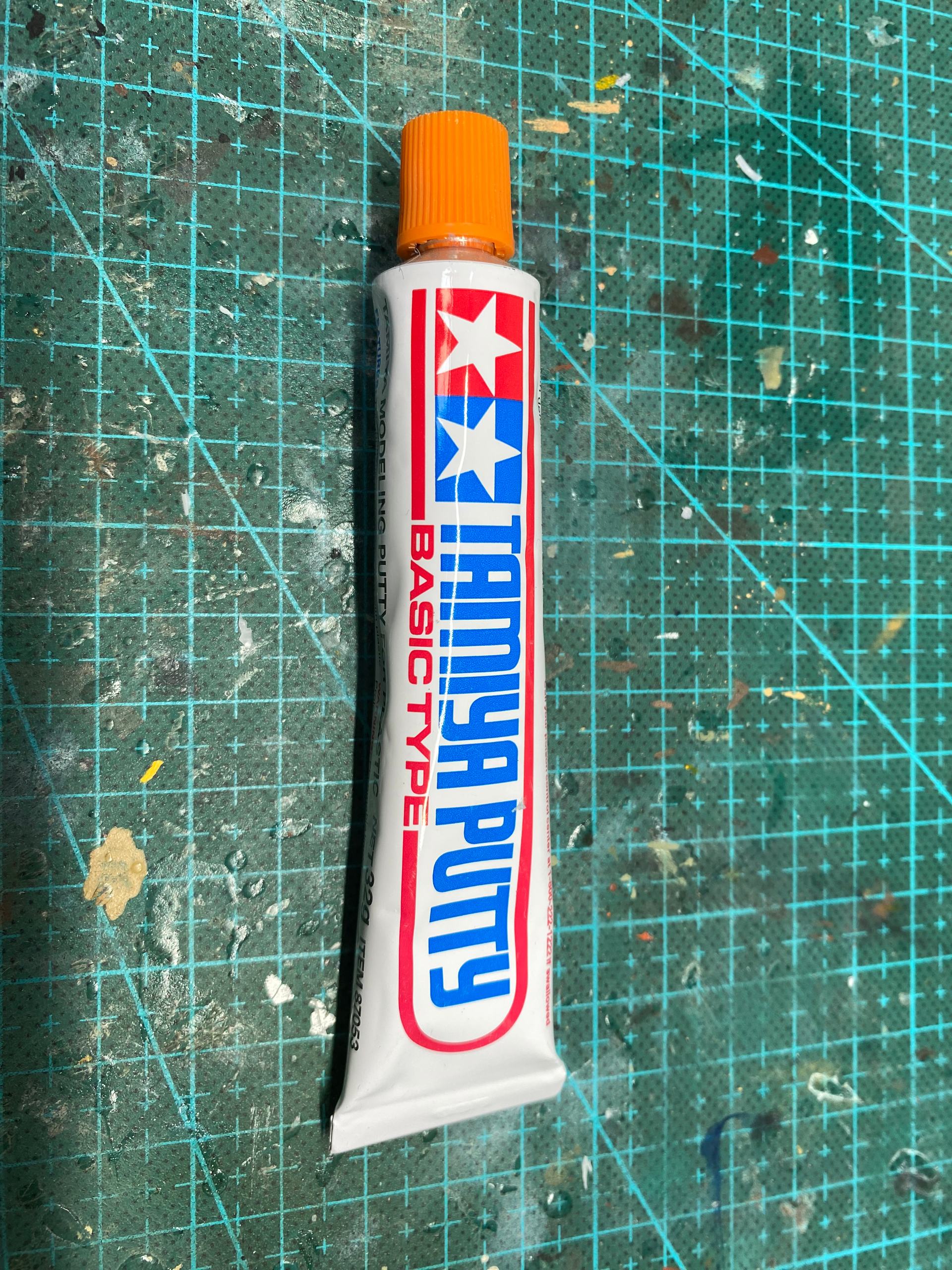

What is toothpaste putty? Just plan tooth paste? Nice work.
This one
Something probably went wrong in translation there :slight_smile: Toothpaste = 牙膏 (says Google Translate, I’m afraid I can’t read hànzì myself :frowning_face:) and I’m not sure that would work well on a model except for things like polishing clear parts.
This likely stems from a small cultural difference. We usually refer to this type of Tamiya putty as ‘toothpaste putty’ because its squeeze tube packaging and paste-like consistency closely resemble actual toothpaste.
I was thinking you had a new way to add texture to a model! :+1:
Aha — that makes sense once you know the background :slight_smile: For comparison: Dutch modellers sometimes refer to “liquorice laces” (American English: “licorice”), which would likely also cause confusion until you know what those are and what they sort of resemble.

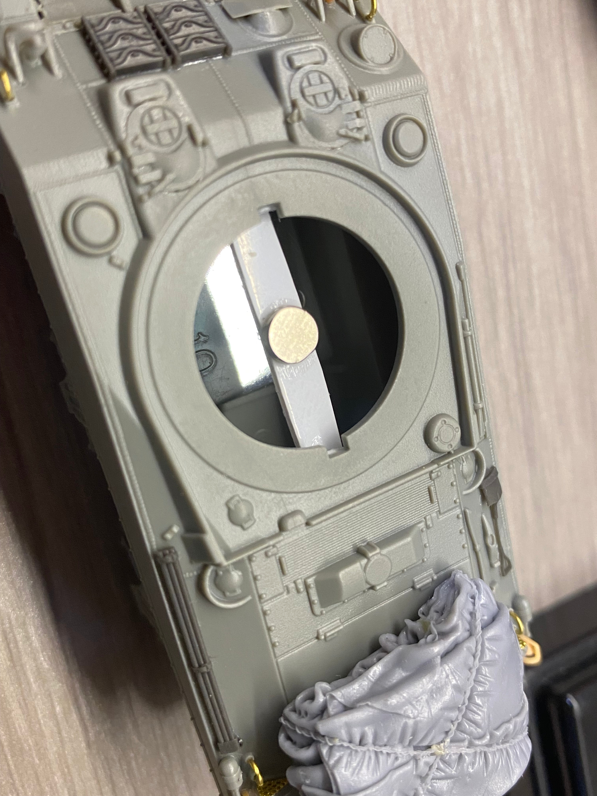

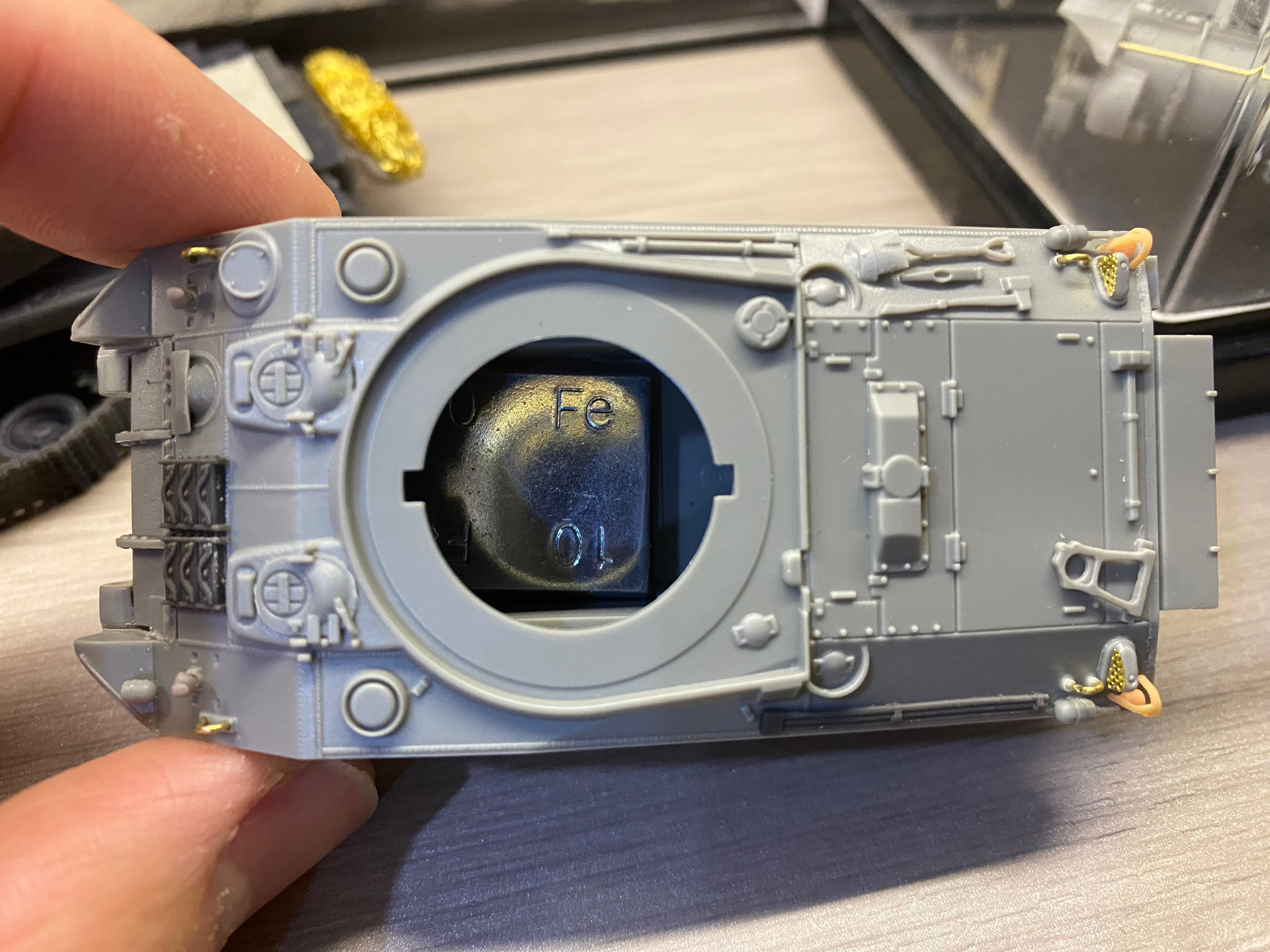

Hi Jim, very nice tanks: what else should I expect? “Hull weight “ and “magnetic turret attachment” means some nuts or something like it glued inside the hull to increase weight of the model and some magnets, to keep turret on the hull, please?
And what about miniatures, from where they came from, please :D? Thank you very much!
Thanks, Miloss. Yes, I added 10g of self-adhesive metal weights inside the model’s hull—they’re very convenient to use. The resin turret from Black Dog didn’t fit well with the Dragon hull, so I built a connection mechanism myself using plastic plates and magnetic pieces. I also incorporated some 3D-printed parts, including the gun mantlet, muzzle brake, turret hatches, radio antenna mounts, and more. These were sourced from a local 3D printing shop called “Wakusei Turbo.”

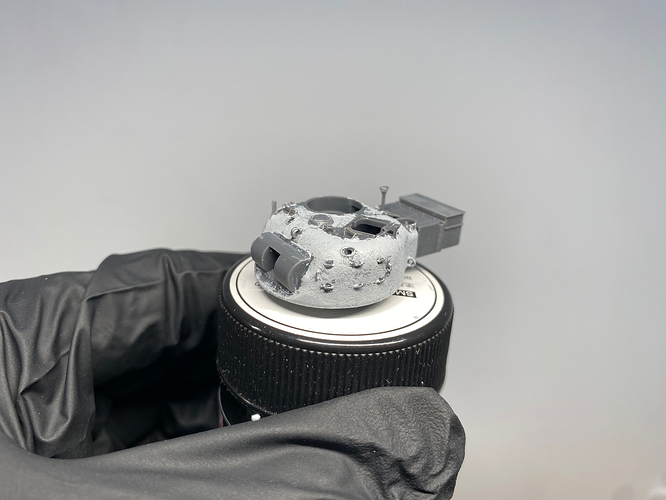

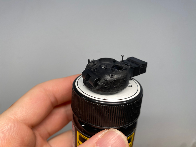

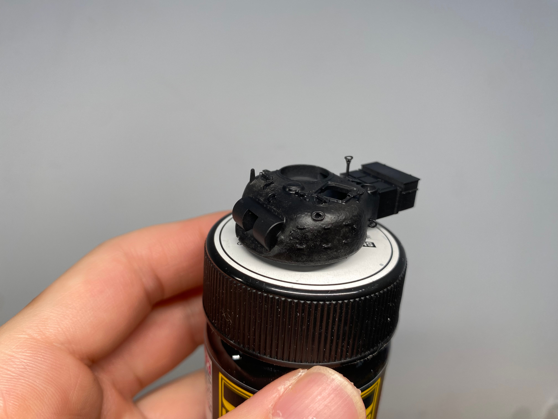

Here are some photos showing the cast texture on the tank armor, made using Tamiya putty.
