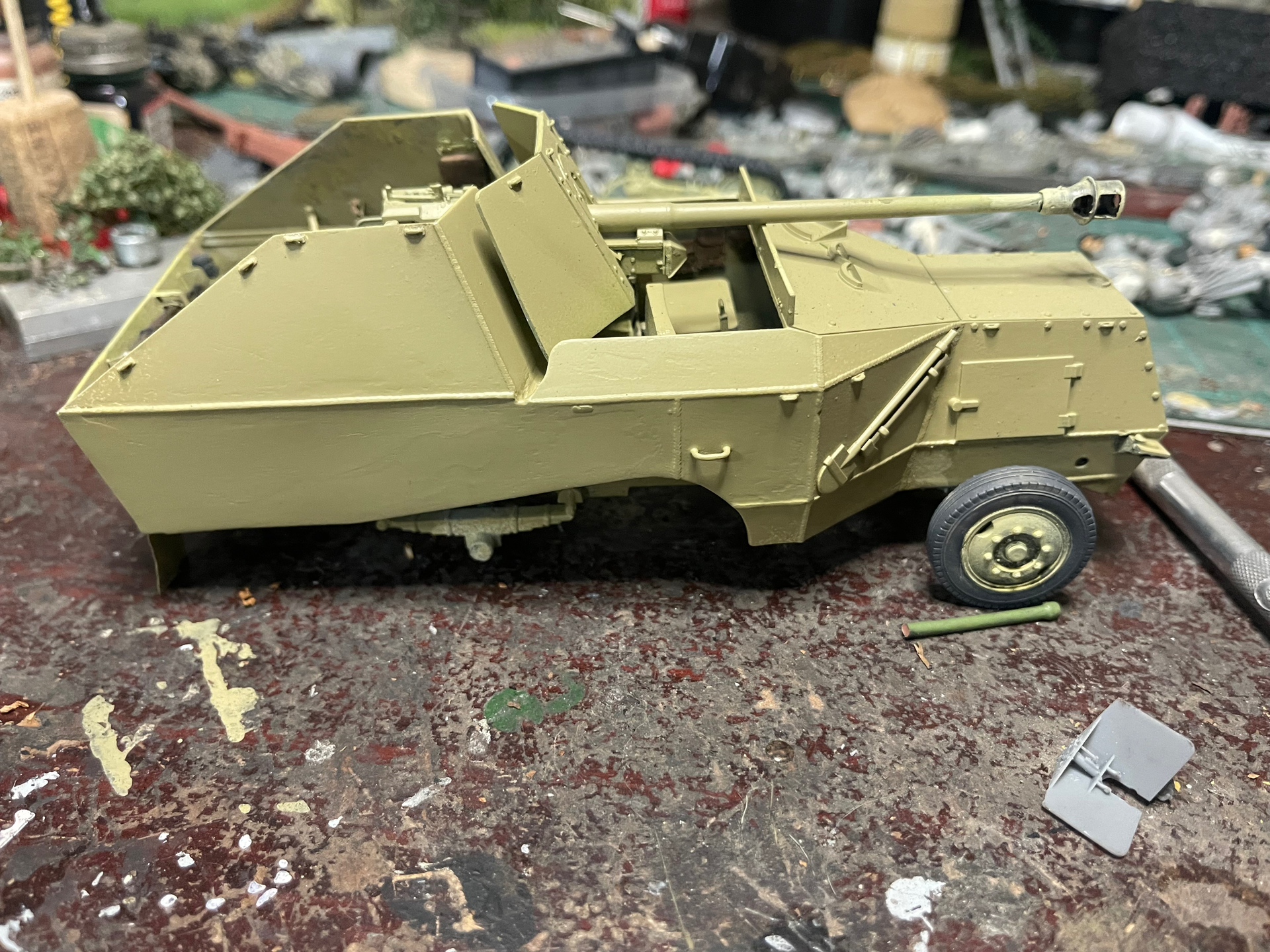

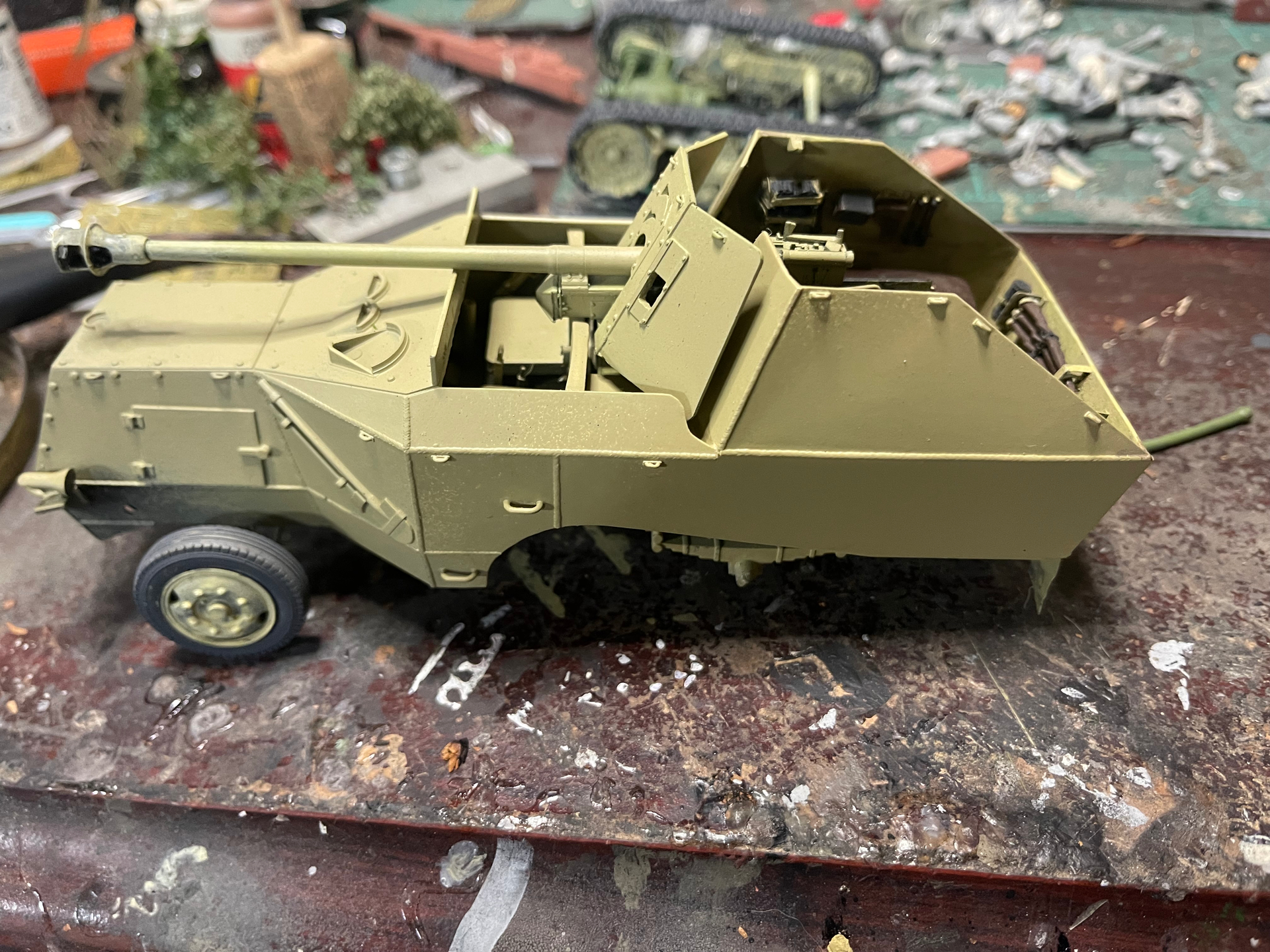

Finally got a primer coat on! I used MiG’s One Shot, which I really like.
My Badger Sotar 2020 is acting up (almost always a dirty or deformed tip) and I have 2 fine tips on order, so I’ll have to wait to apply the camouflage.
I did however, have a rattle can of Tamiya dark yellow which allowed me to lay down a base over the primer and see the problem areas.
This kit has been endless repairs on the fragile 3D printed plastic, pitting and uneven areas needing to be fixed with putty and sanding.
After the base coat was on, there was quite a bit of unevenness that had to be repaired.
It’s in a place that I’m happy with until my Sotar parts arrive.

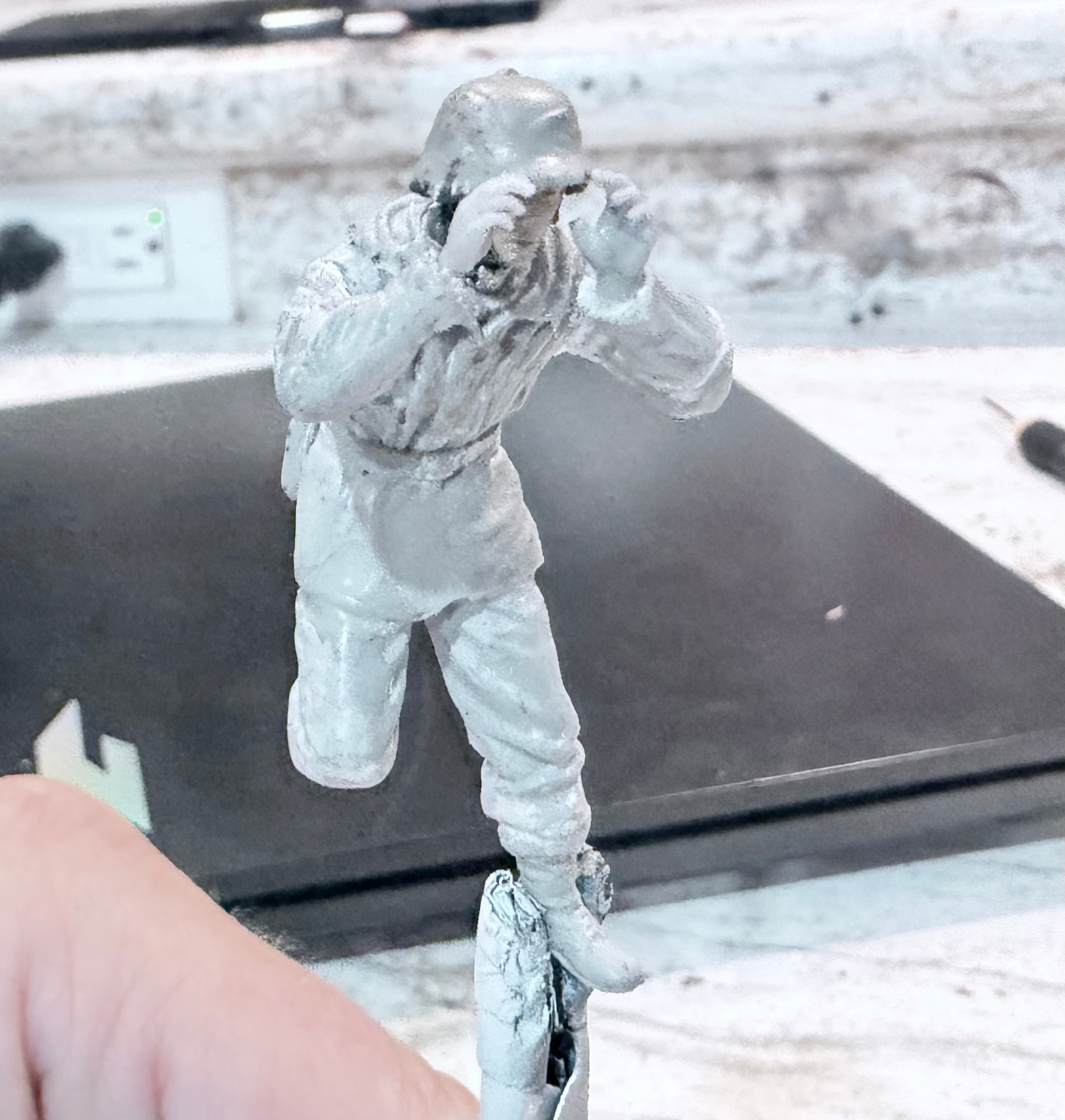

I did get into building the crew. Like all my figures, they look absolutely terrible at first, because it’s just about getting the poses correct for the fighting compartment and driver seat. Lots of test fitting, cutting, filling, molding and positioning.
Because of the KM chassis and hull being very much on the larger side of 1:35 scale, I’ve had to modify my already bash modded figures to match the size. It’s been a challenge, but doable.
They’ll look much better once I’ve decided on final poses, can fill and clean them up properly and apply a primer coat.
I think it’s important for us to document the whole process no matter how rough it looks initially.

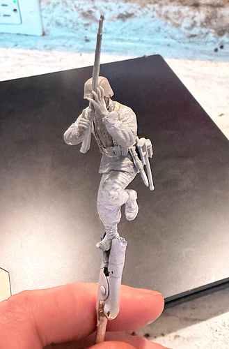

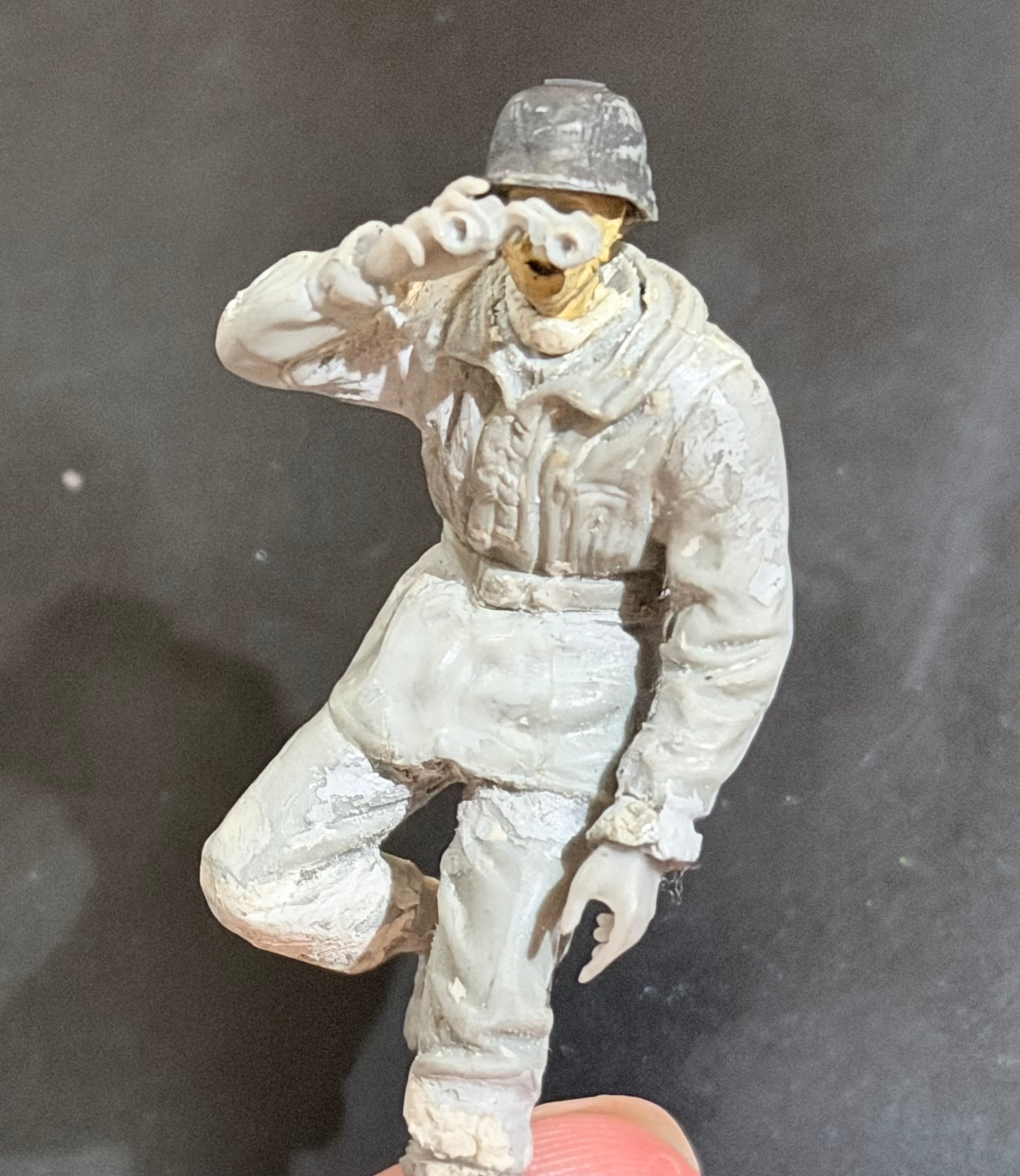

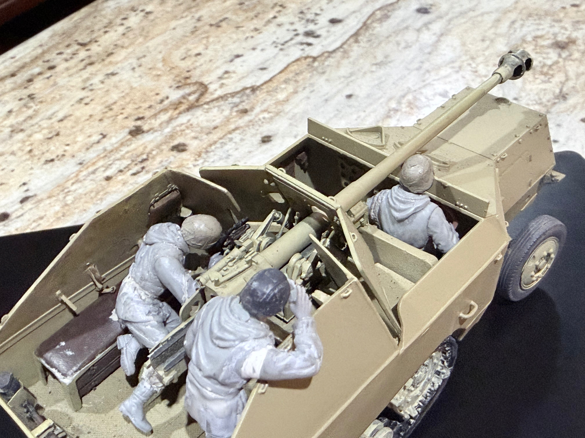

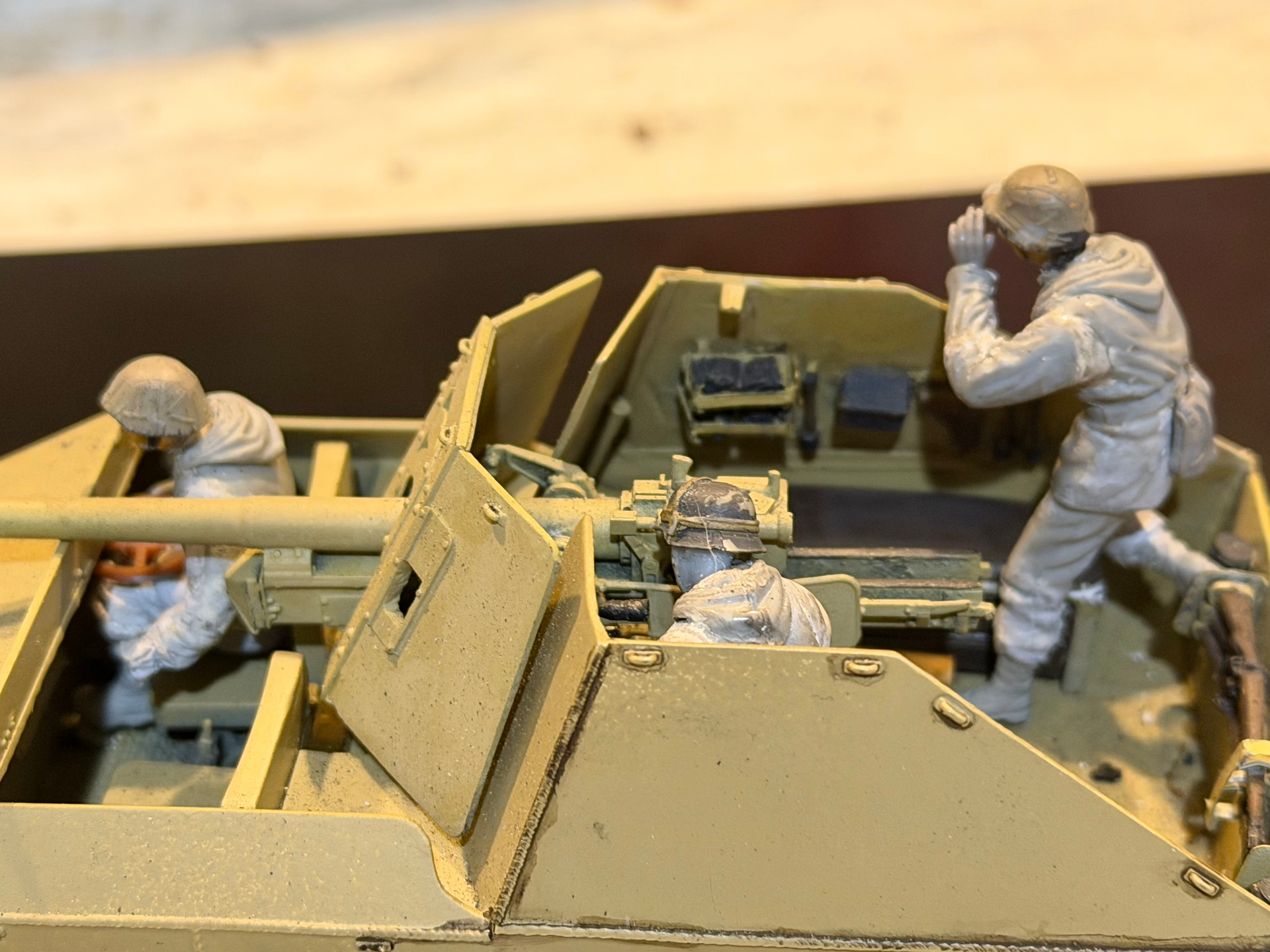

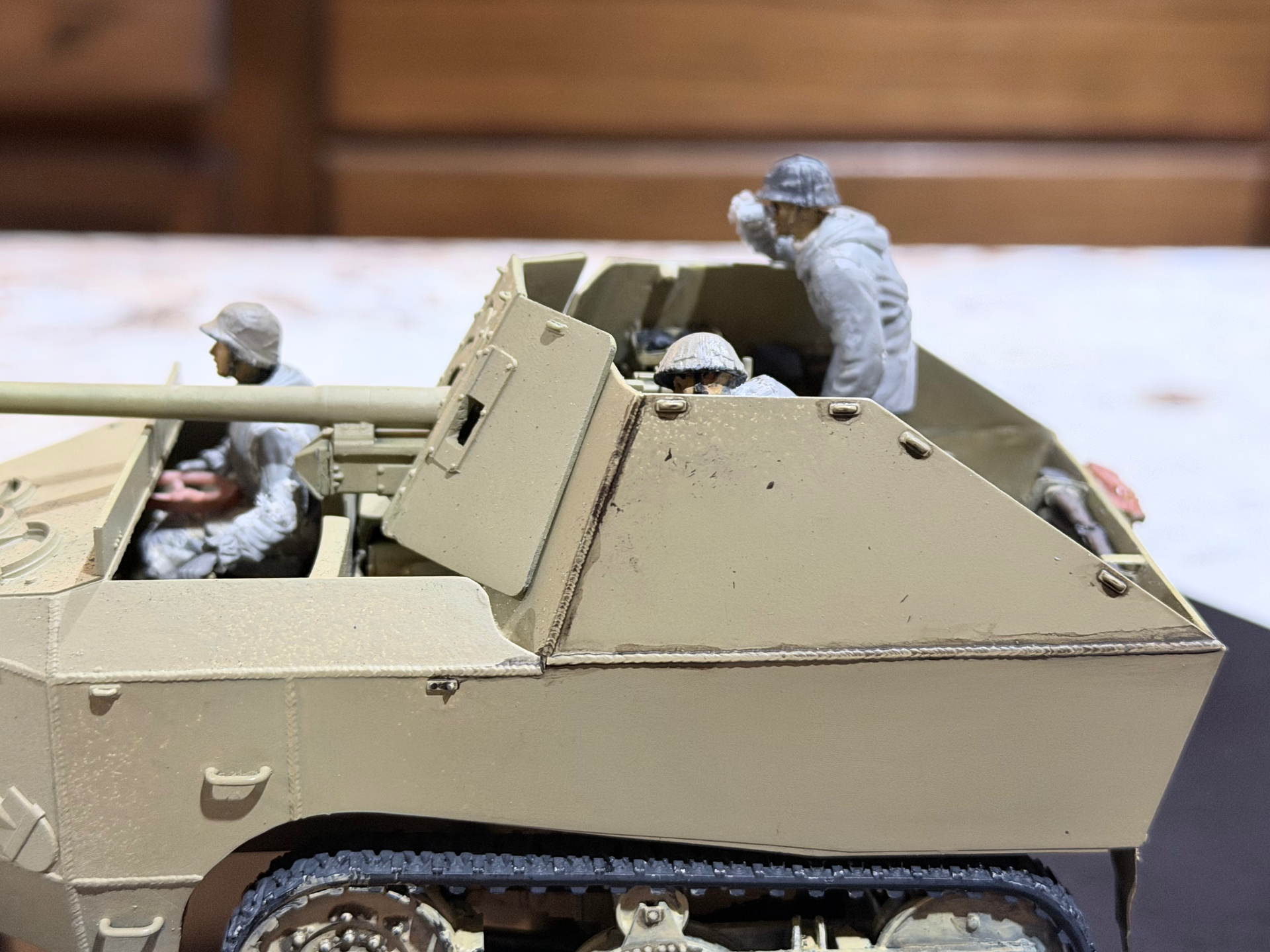

Hey all! Still slow going. I wasn’t happy with my commander and gunner figures, so I modified them.
The commander now looks more to my liking. His left arm is now holding the binoculars instead of awkwardly hanging to the side. I also added putty and used a dremel to sand out and form the shoulders a bit different. This gives him a more hunched appearance with a different head, and I really like it. As if he’s scanning for targets while aware of the occasional cracking long range British Mk IV shots. Thats what I was going for.

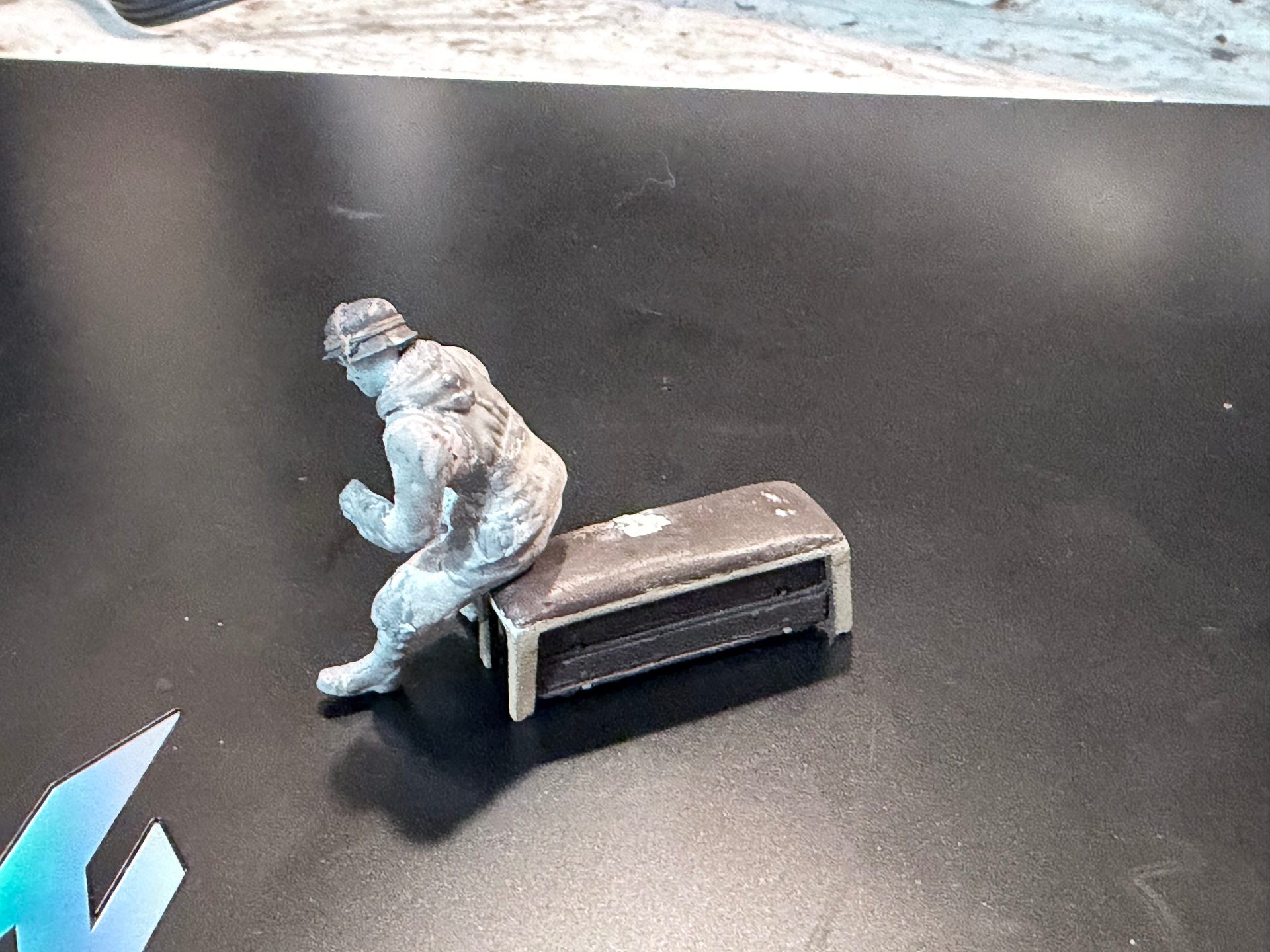

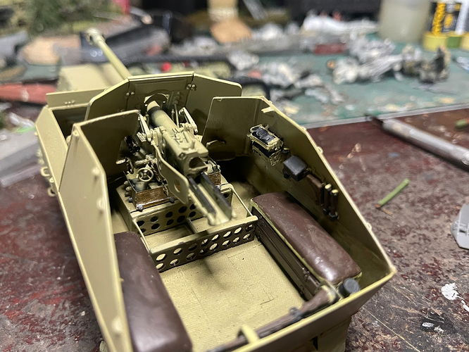

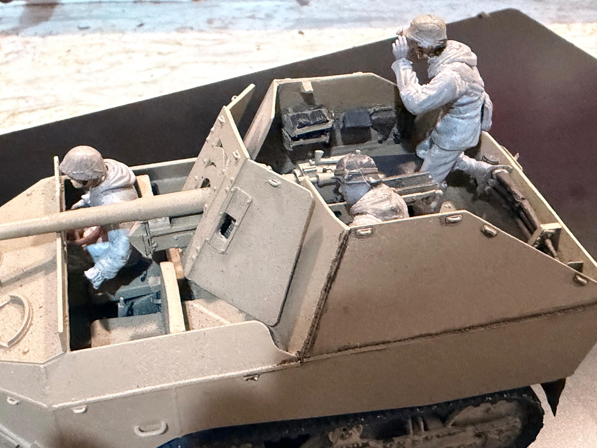

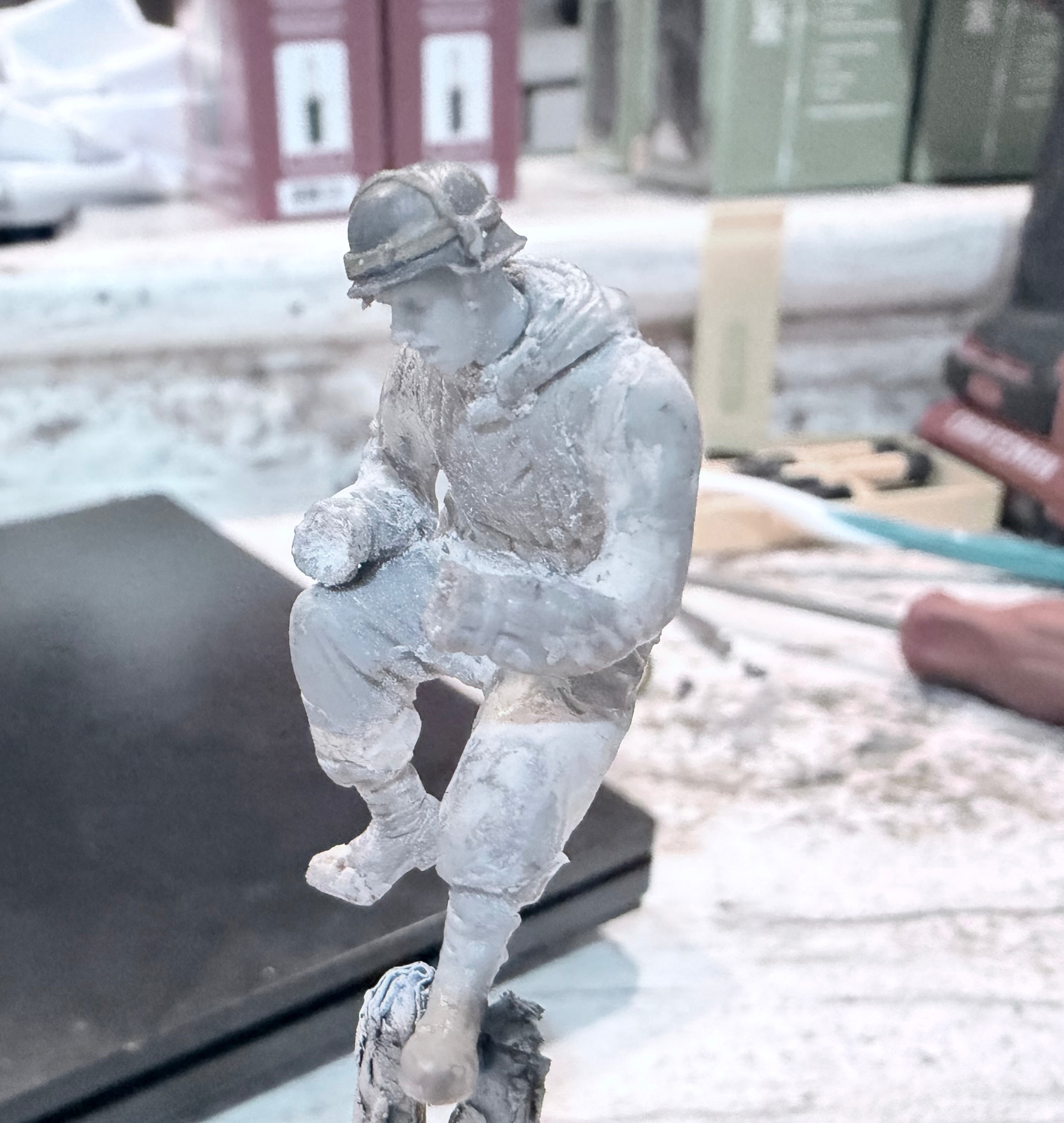

The Pak 40 gunner has been really hard. The Pak 40 is a notoriously awkward gun for a gunner to fire. You have to shape and squeeze into the gap between the carriage mount and gun shield. This is hard to depict realistically with a traditional split trail Pak 40 carriage hut more so with this custom mount, odd seat/bench and the entire ammunition stowage on the floor and in the way of the gunner’s legs.
I did have a gunner sort of sitting/laying across the bench at a major angle (see previous posts), but this just, never felt right to me. It’s taken me a month to figure out a better alternative and work the putty and leg parts to both fit, and look somewhat realistic.
I’ve provided some new photos of how the crew will be positioned in the completed model down the road.

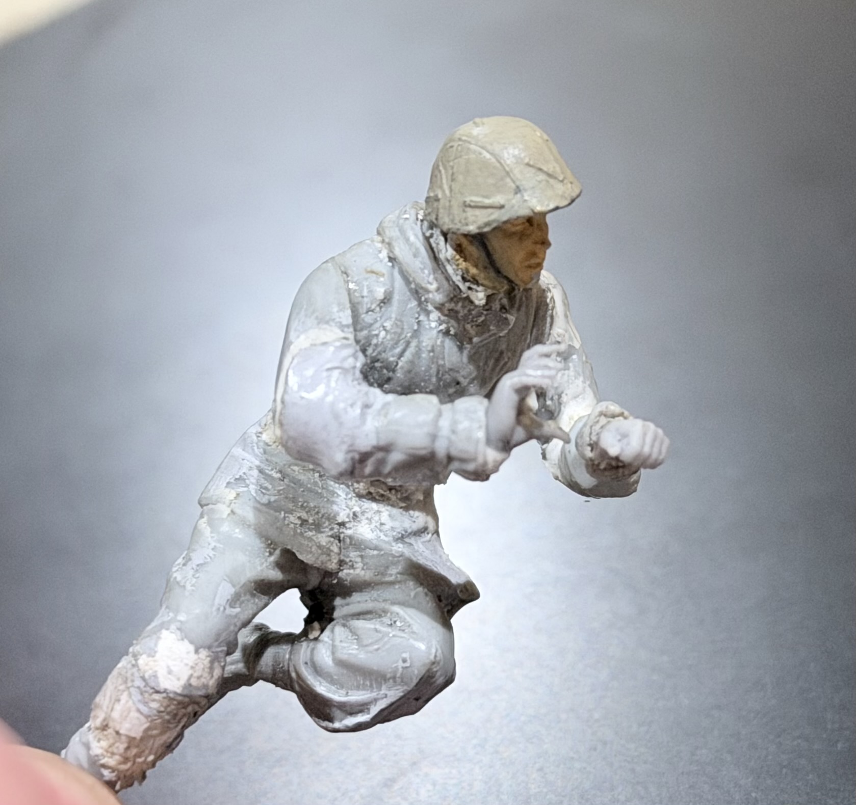

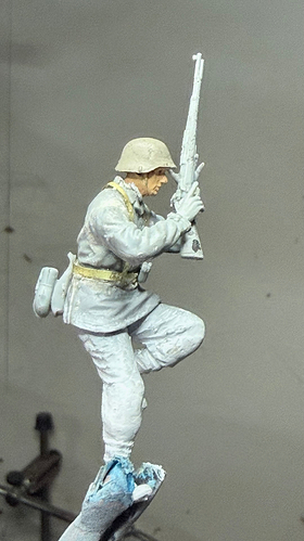

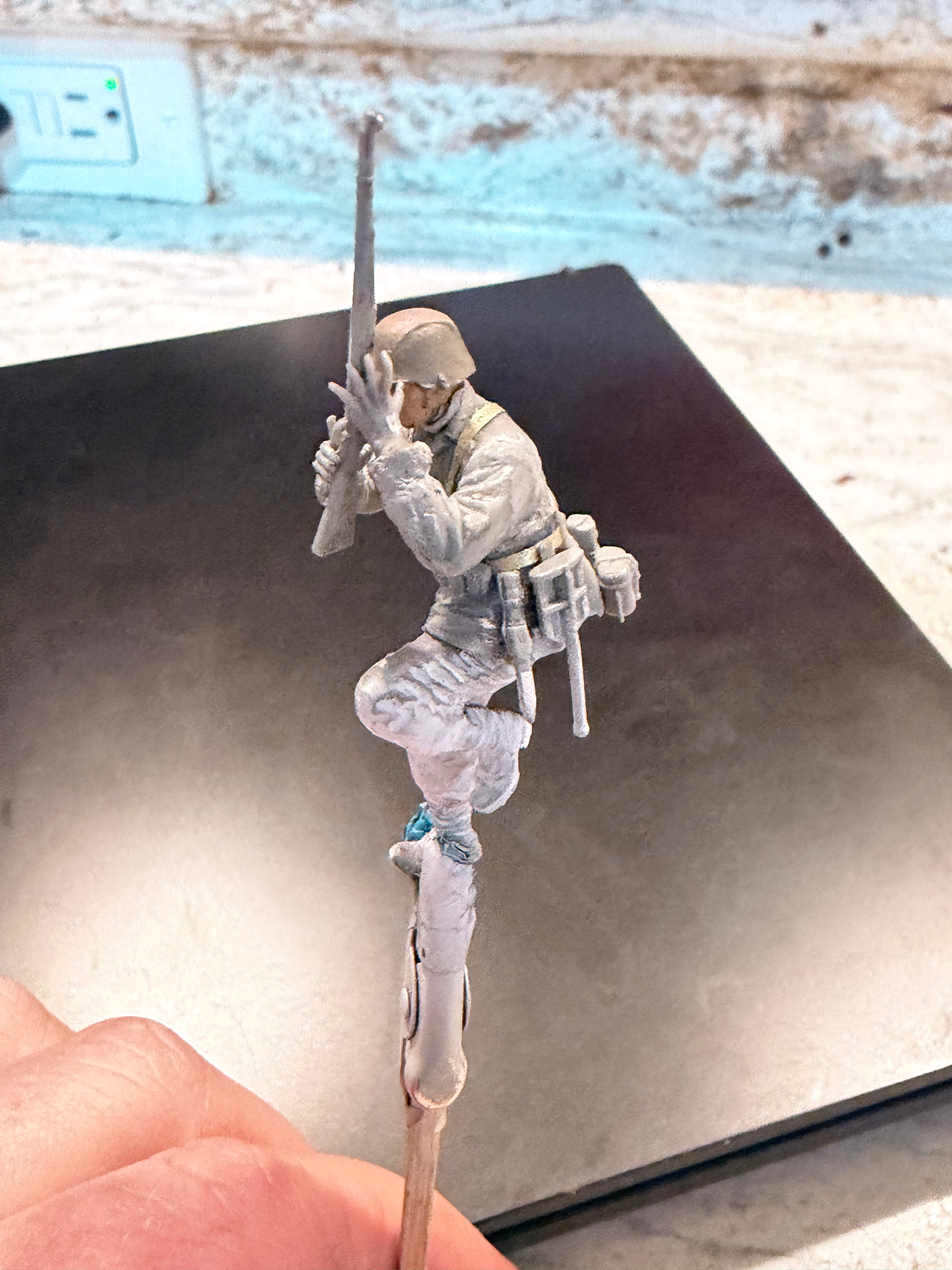

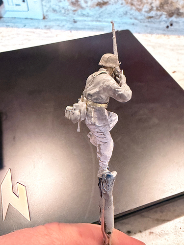

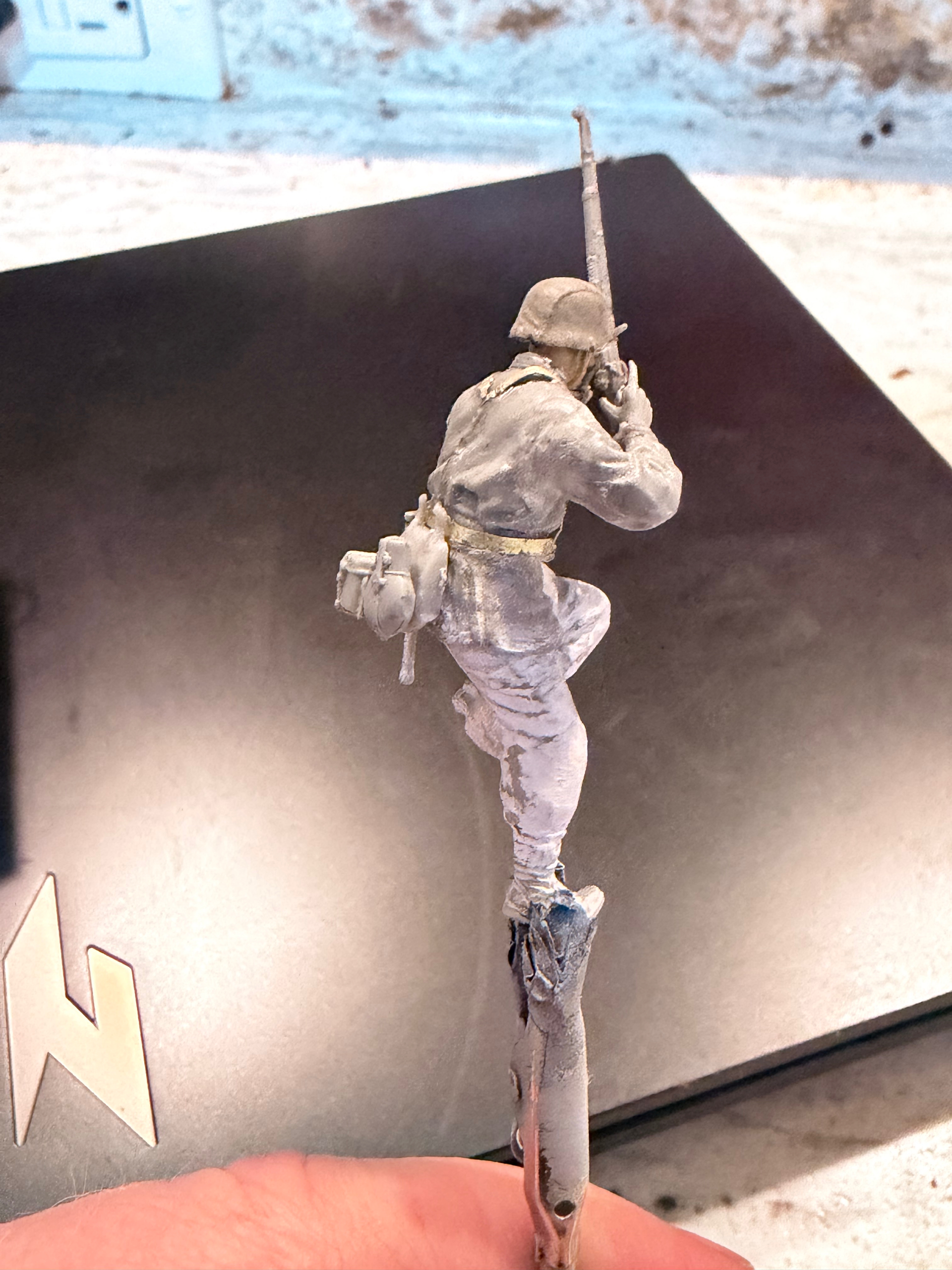

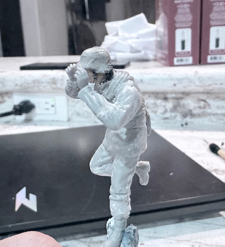

Lastly, I was able to work in some time on one of the panzergrenadiers. This WH grenadier is a part of PzGrRegt 192, like the others but instead of a Sumpfmuster/Marsh pattern hooded smock, or a Splinter Zeltbahn, this one will be wearing a WH hoodless splinter smock.
I got the inspiration for the pose from this screenshot from Saving Private Ryan. While the uniform/equipment details are different, I used it as a base for figuring out a pose for a similar scenario.
