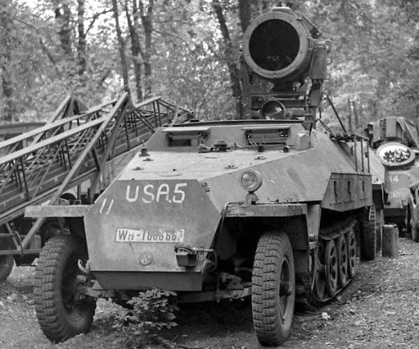

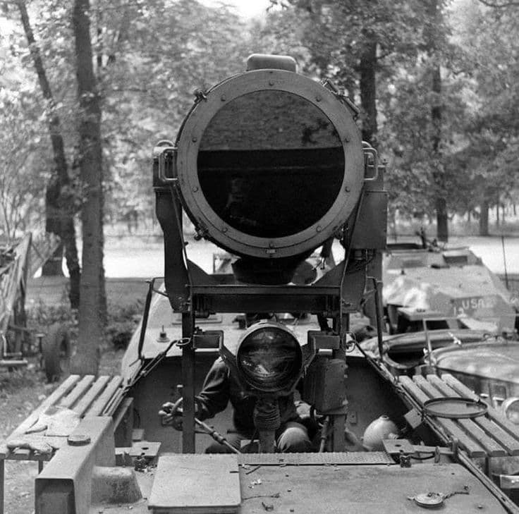

I searched images on Google with this
uhu SDKFZ 251 generator
and got many images that could be used to scratchbuild the generator box
Thanks guys, any data are welcome!

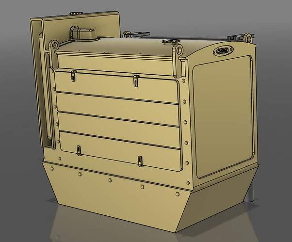

See the similarities?
My interpretation. Tx Dan.
Looks good!
Will you sell/share your STL somewhere?I have also an AFV UHU i my stash. Thanks in advance.
