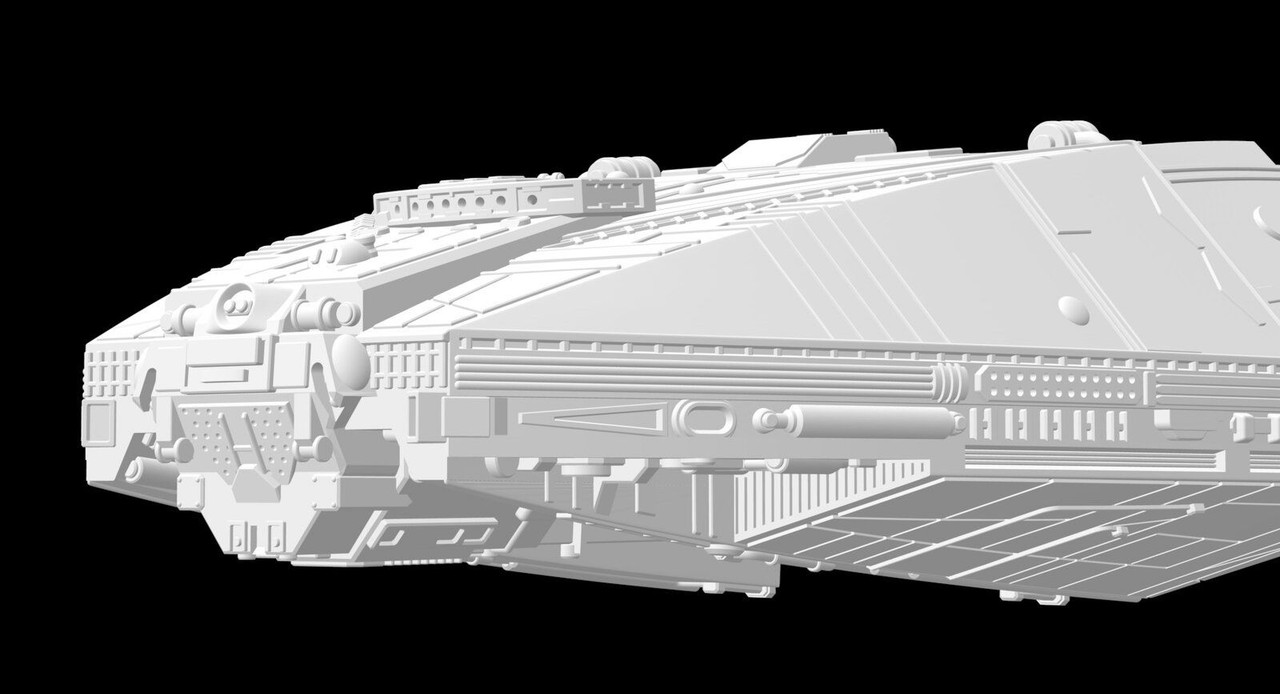

STL file screen render
In late 2023 I discovered the Gambody Galactica 3D printed set. They offer STL files for a 14” SLA resin and 24” FDM plastic version. The files are very high quality (some parts are difficult to print well)
and I was able to print out the PLA version pretty well. Some of the details are wrong of course, or not sized exactly right, but the digital files are well thought out and designed, and it looks pretty good - worlds better that the old kit from the 1970s. I know I’ve showed this version on the webcast and in the forums but here is the 2 foot version printed.

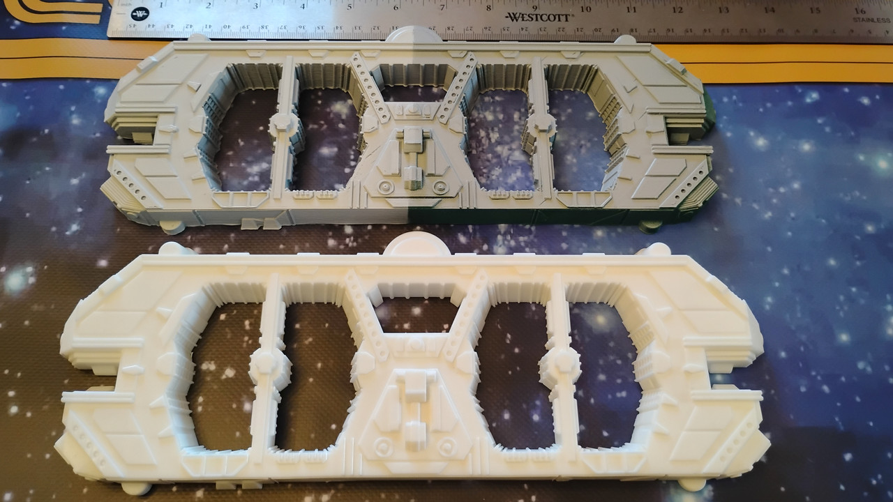

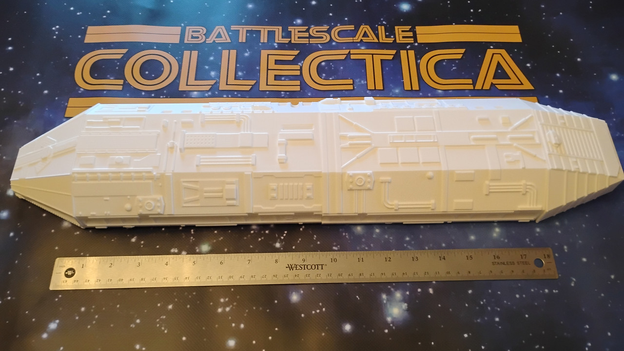

So I decided to scale it up 200% and contracted a shop to print some of the larger pieces. Here are the test mules – I say test because I wasn’t really happy with the shop’s print resolution
and layer height settings. That’s a printing issue, not a file issue though.
Having the HUGE parts in hand, it was obvious some of the design and gator head panels needed correcting. When you’re dealing with a 50” monster, the details or lack of are NOW pretty glaring.

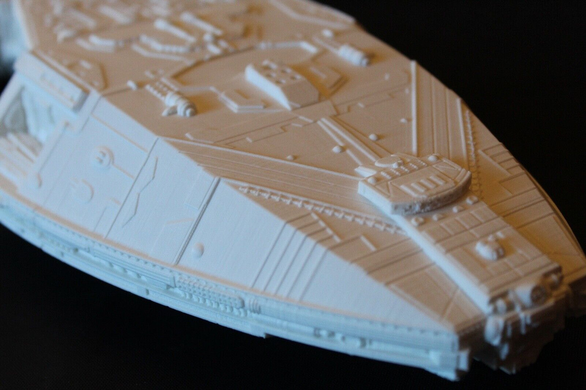

Since I knew I wouldn’t use these first parts for the final model, I decided to start marking, grinding, scribing & testing new elements needed to help this become a little more screen accurate with the original studio model.
marking some changes
Testing some color shades

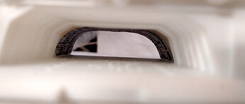

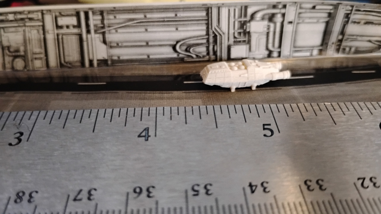

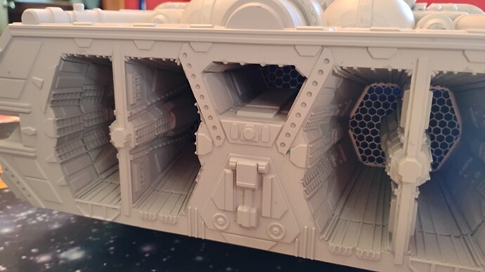

I can’t print/obtain figures that scale, so I’m using 1/700 scale figures for the landing bay. I figure the forced perspective will really hide any size discrepency.
My hanger bays are roughly 24" long.

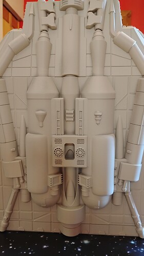

Stock kit engine grills on the left. Custom BSC on the right.
One big change I needed was to redesign the engine grills. The stock versions are fine in smaller scale, but since I’d be lighting all three engine ports, they just wouldn’t work for my needs. They would need to have a metallic look to them, not a translucent plastic one.

Latest update is all the final primary pieces have been printed.
The final engineering cap: test PLA version on top, final resin version on bottom.
I couldn’t get the finer details in PLA so I ended up needing to print this in resin for the small details I needed.

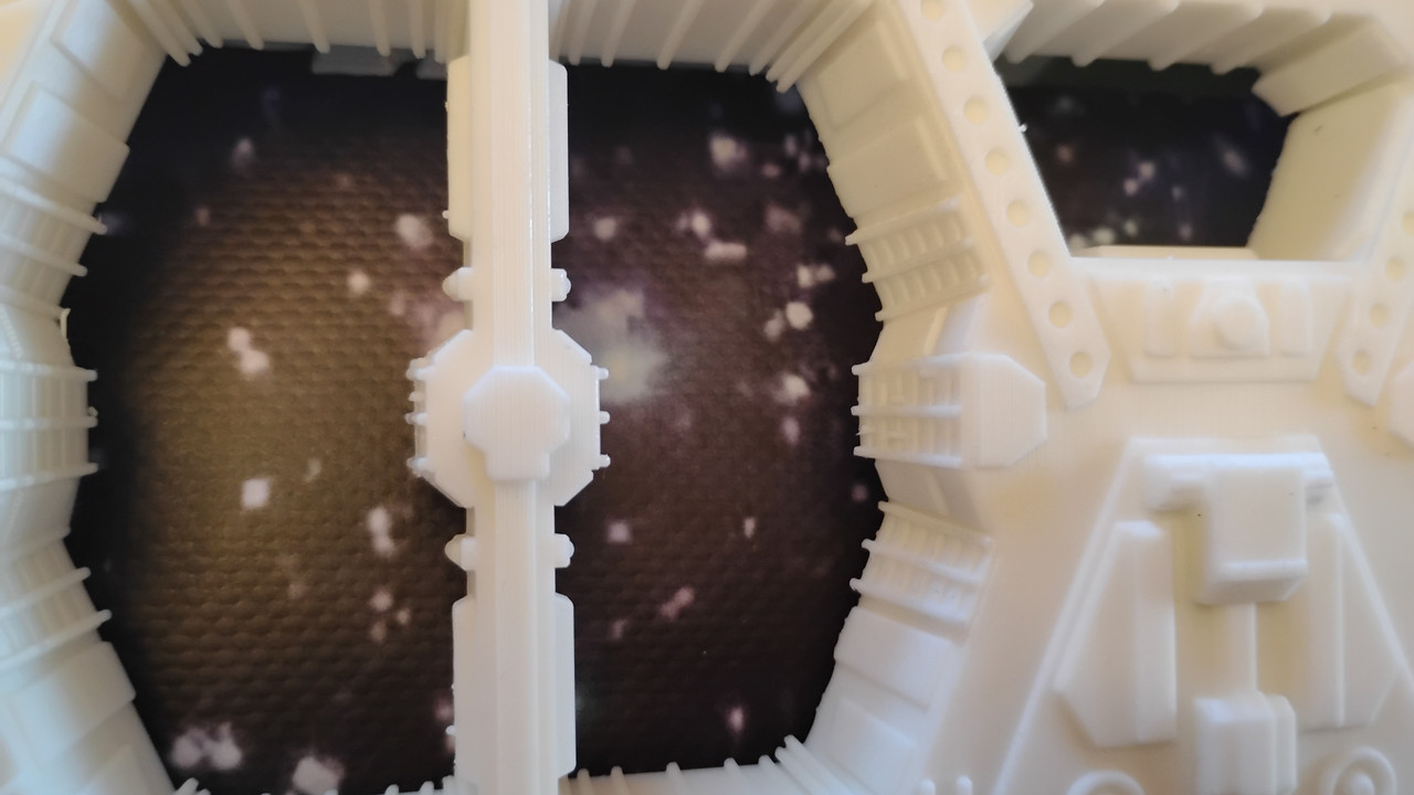

Now that both exterior hangers bays are done, I’ll be focusing on finalizing the designs for building the interiors.

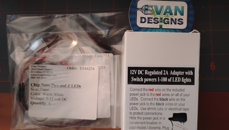

I’ve received most of the LED lighting and 12V power transformer from Evan Designs.
They did also some custom circuit work for the hanger bay sequential lighting. I can’t recommend these guys enough!

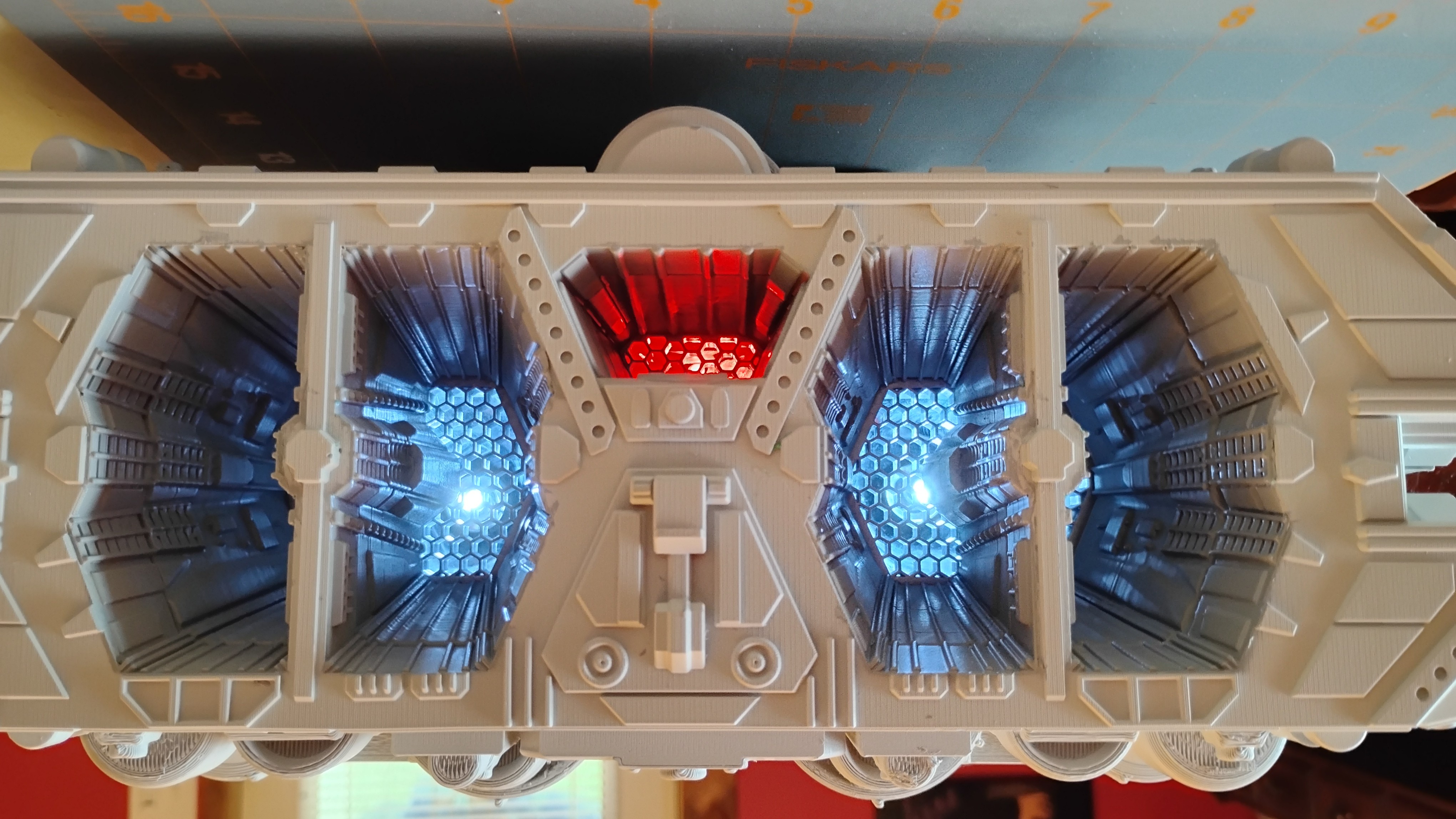

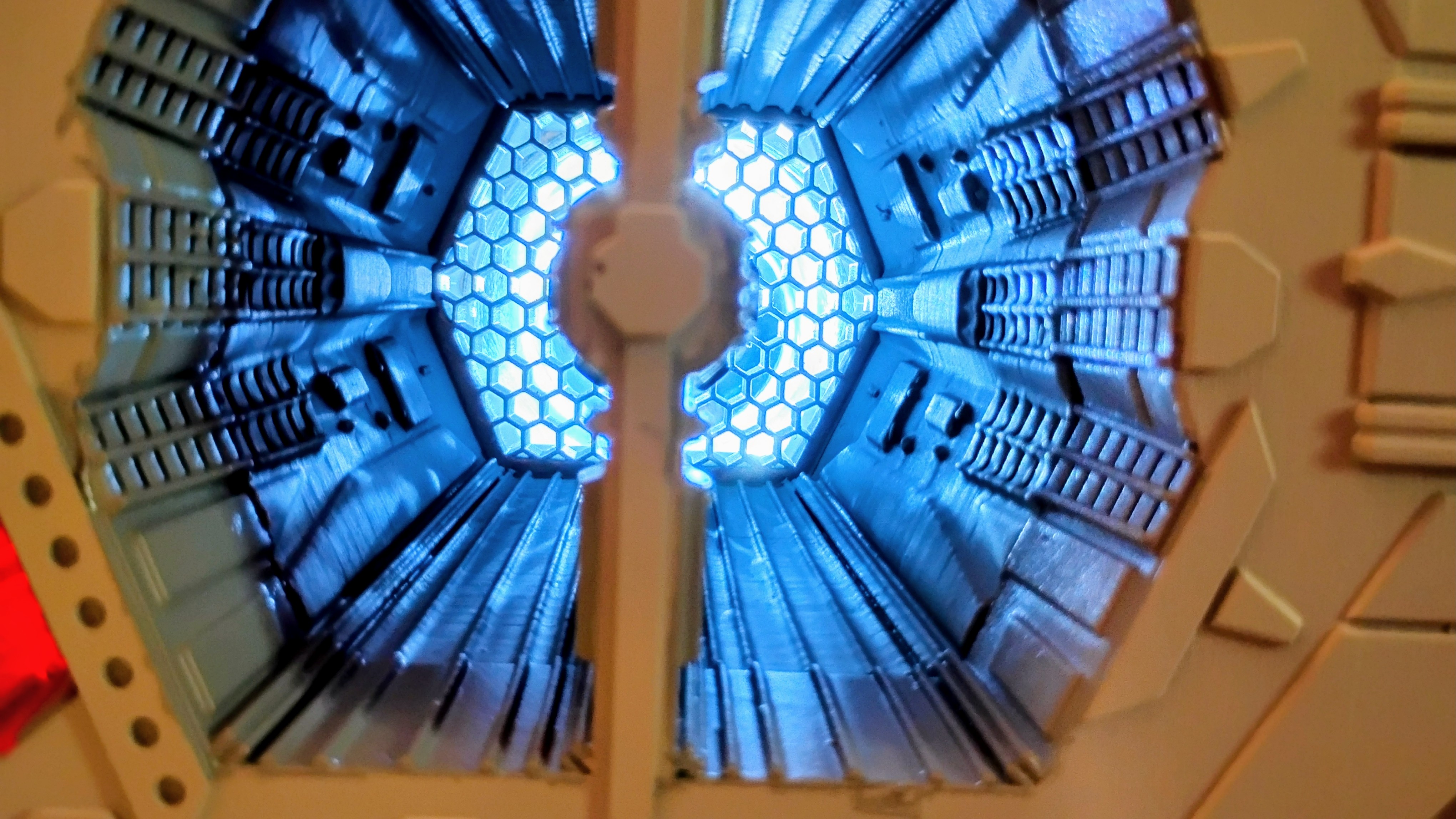

Painted the rear engineering section recently. It took awhile testing different shades of gray before settling on Tamiya Insignia White for the primary color.

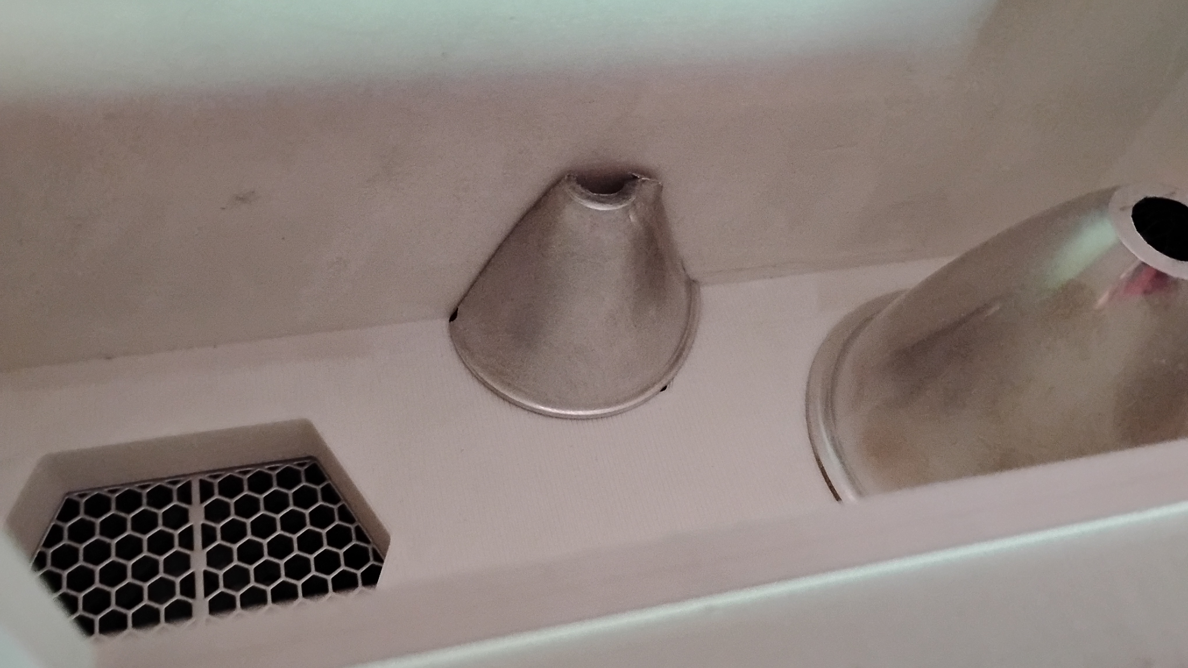

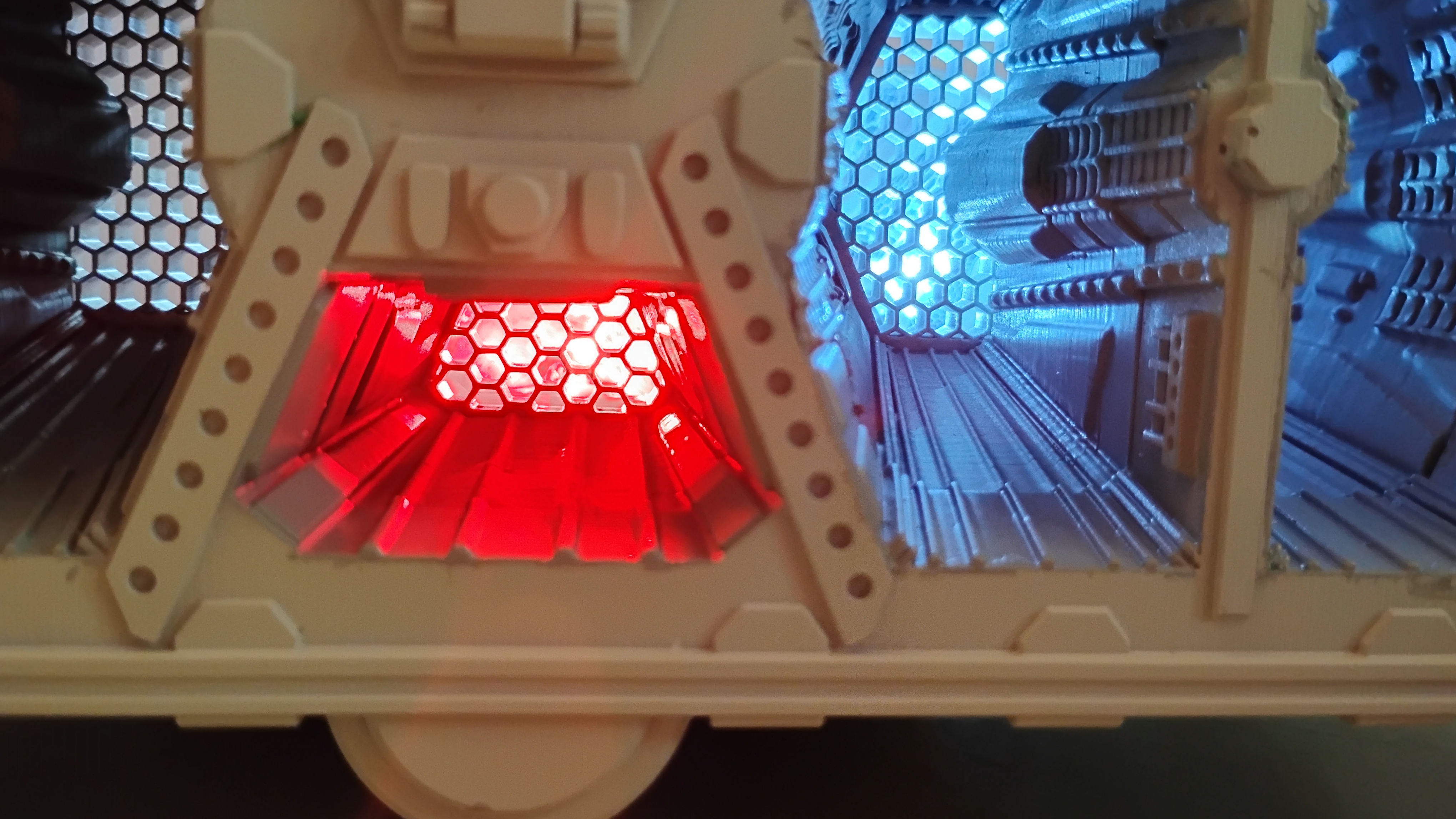

I’m using 3 separate flashlight reflectors for the engine illumination. I want a sense of depth behind the grills, so no diffusion will be used.
She’s not quite ready for light speed, but I’m liking the effect. Using the chrome reflectors there is very little light leaking internally.

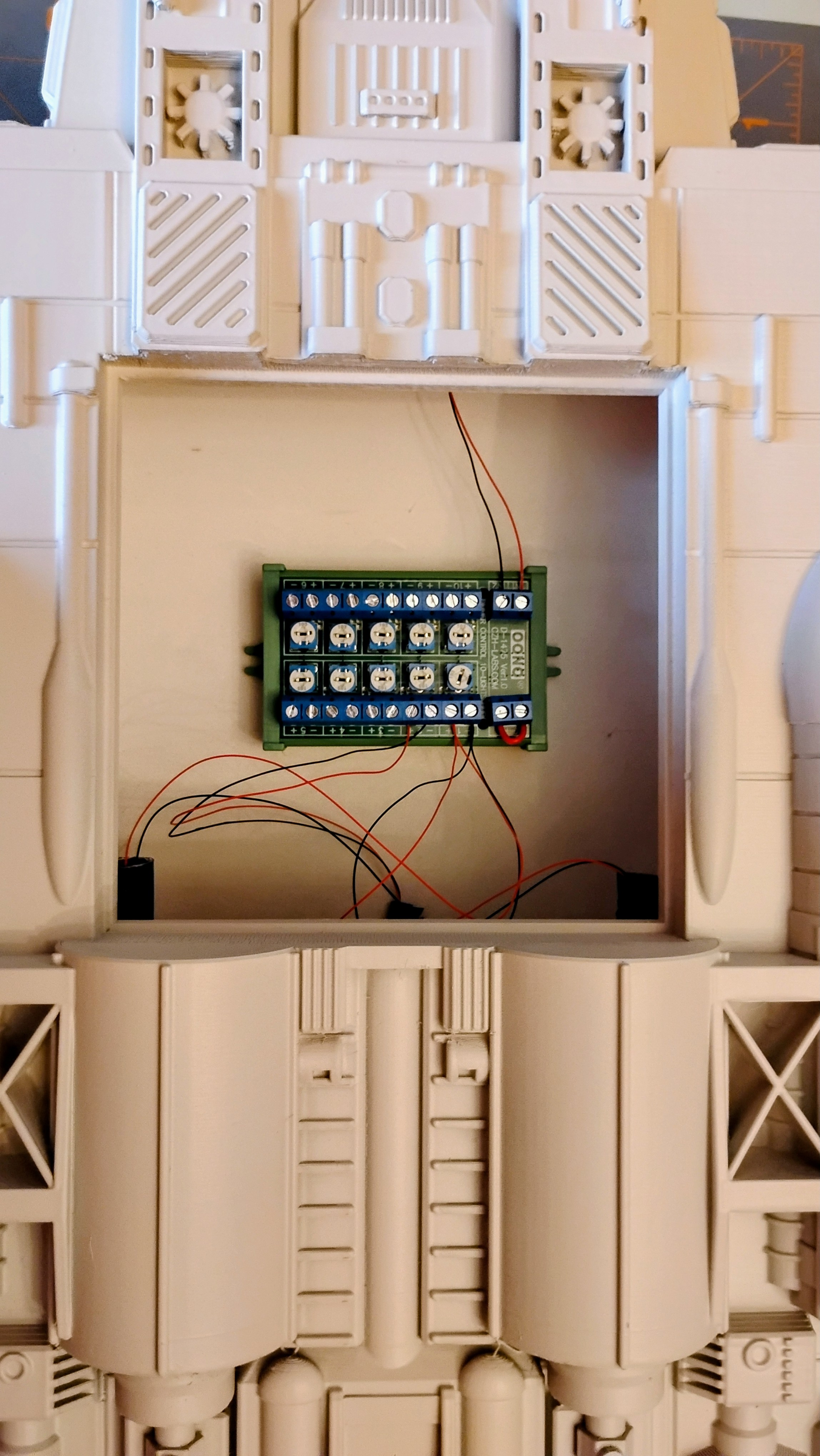

I decided to install a power distribution block that allows me to regulate power to each connection.
This way I can dial in each light (or set) separately. The red engine was dimmed back about 30% from the larger sides.
