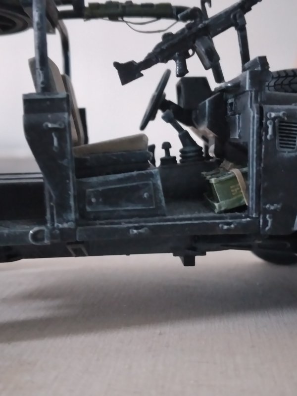

Bolted plate on each seat base instead of articulated access panel molded on the kit.
Remove the big triangular detail on Blackdog seats and built the brackets on both sides on each seat.
