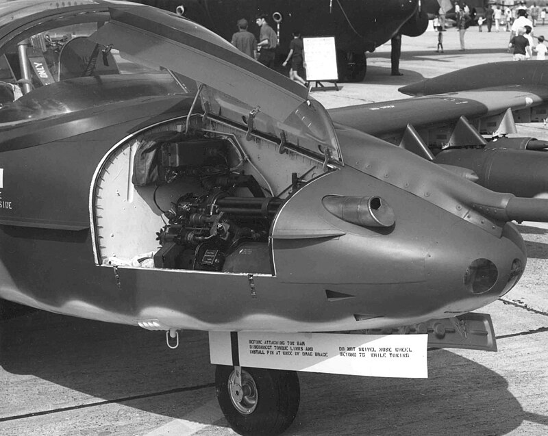

they had a wing of them in DaNang, but never came out our way. They were neat little air frames, and seemed to be very loud for what they were. One thing they lacked was a gun! (I know they had gun pods)
Also heard they only flew with a pilot, and the other seat was empty
gary
Gary, they had a fixed gun, a 1 × 7,62-mm Minigun.
There is a minigun in the nose :wink:

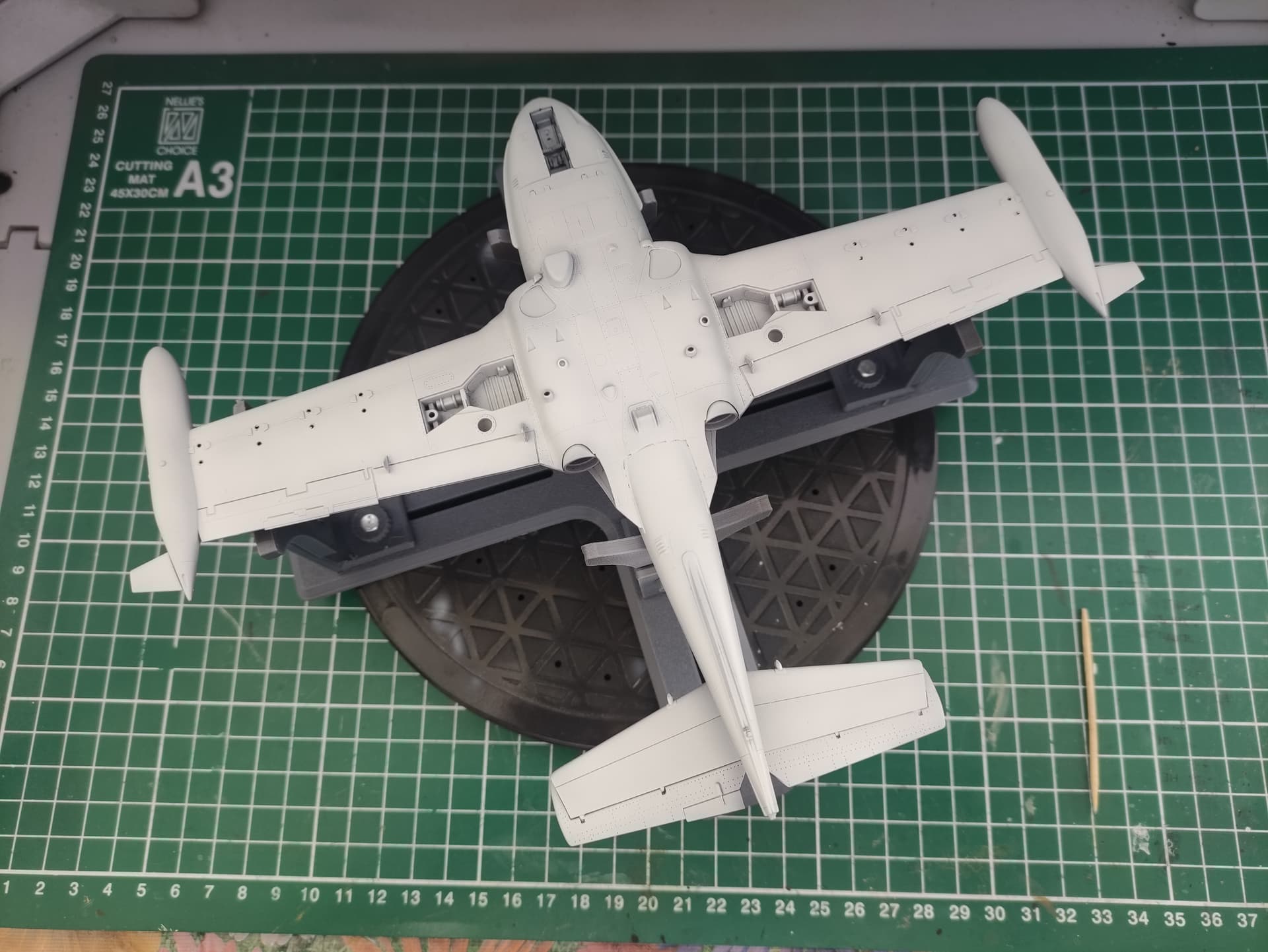

Gluing the fuselage, the air intakes are multipart assembly, so they need some filler and sanding:

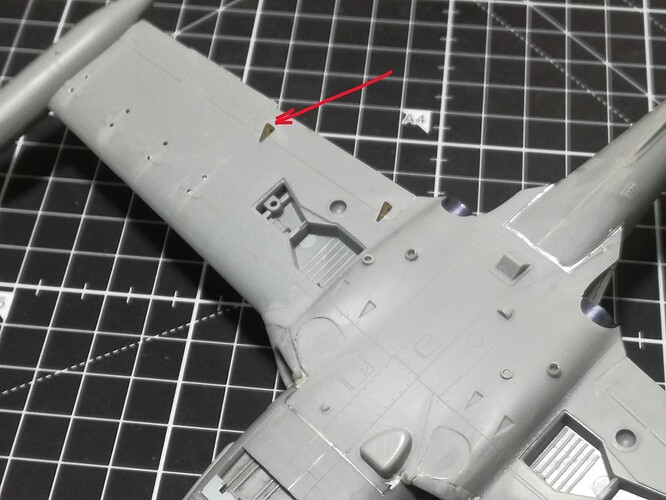

Some new paints and LAU 3/A rocket launchers I designed and printed. Also those small brackets (or whatever the name is) included in the Eduard PE set, I lost two of them, but again easy fix with 3D :grin:

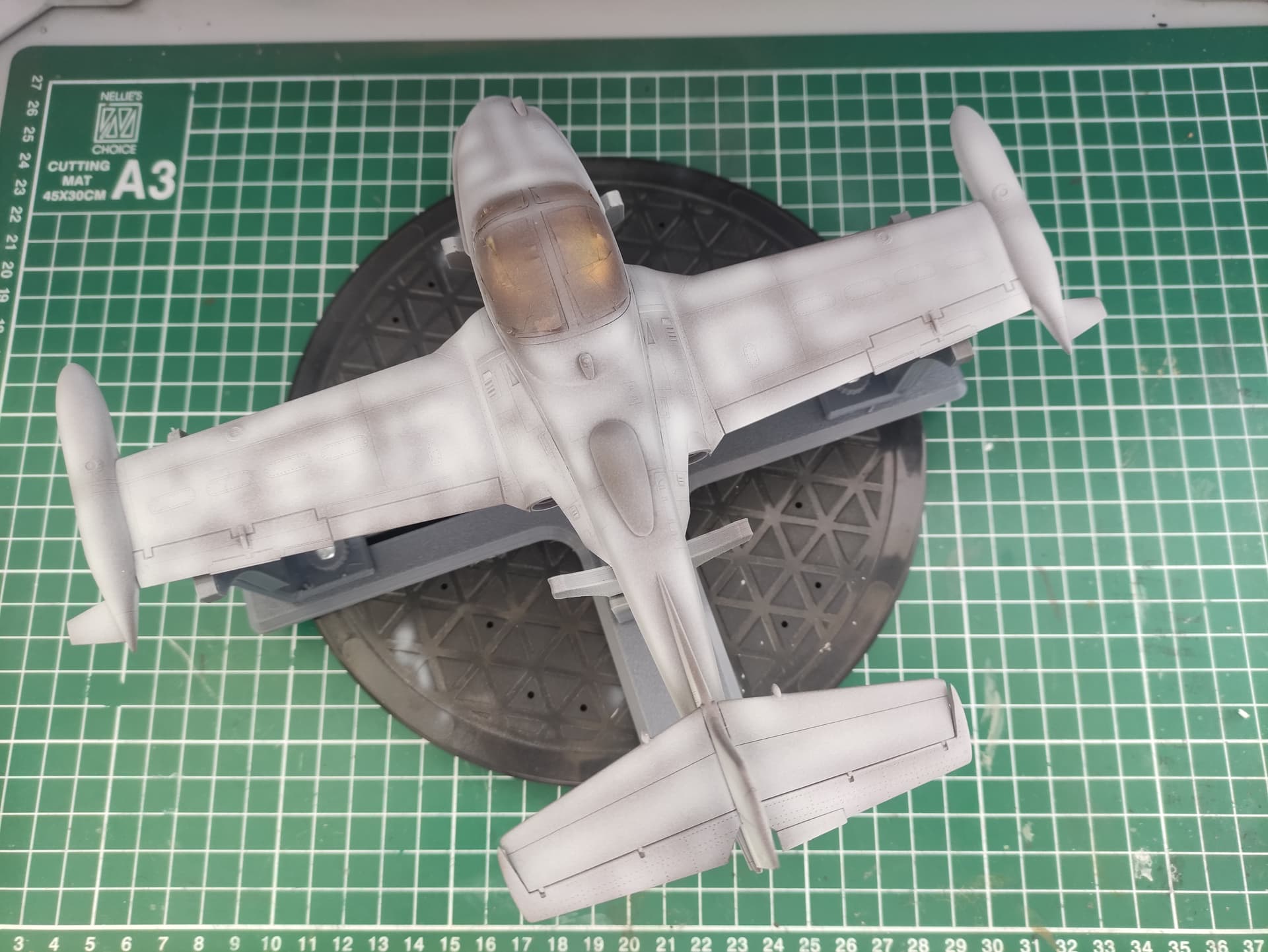

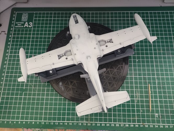

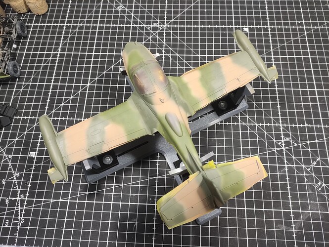

Base coat of Gunze mahogany surfacer and Mr.Hobby FS 36622 for the underside and preshading.

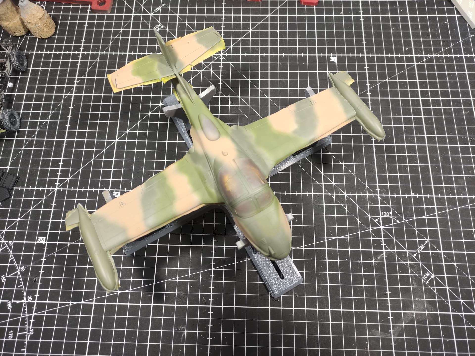

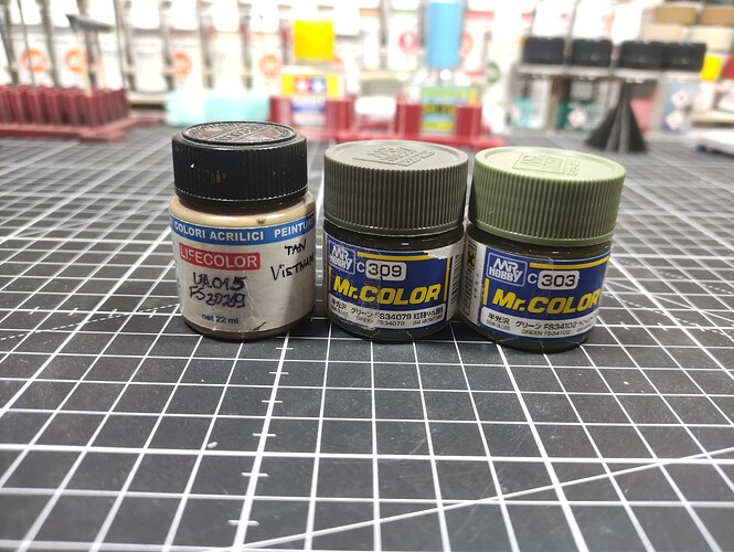

Upper camo with Lifecolor FS30219 Tan and Gunze FS34079 and FS34102. I decided for freehand, only masked the bottom FS36622 :slightly_smiling_face:

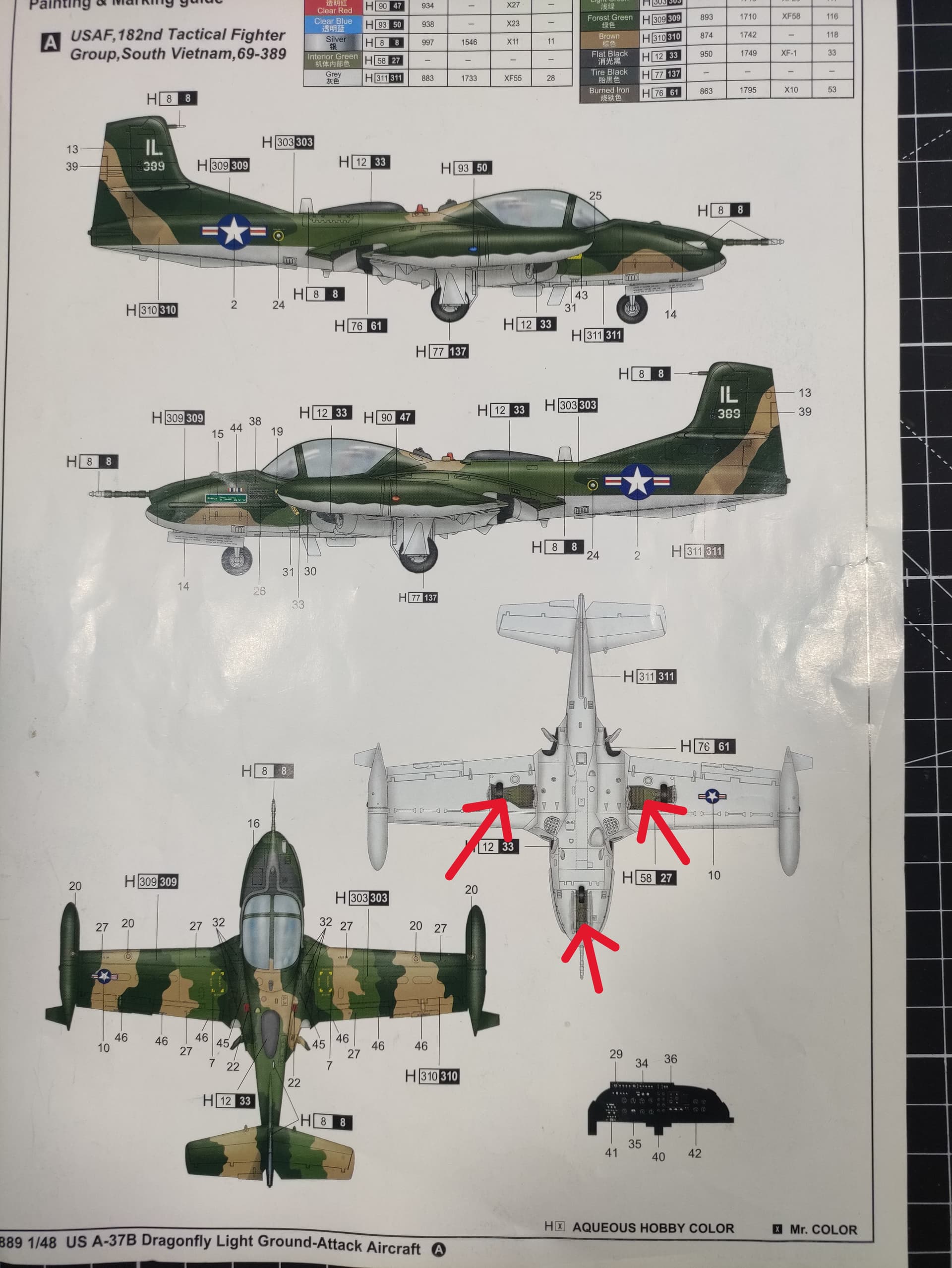

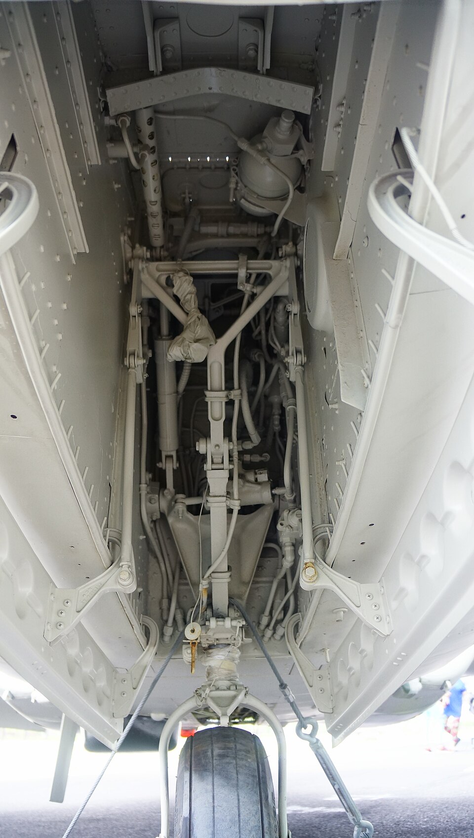

Guys, I’m little confused about the landing bays color. I’m pretty sure it is the same as underside FS36622 light grey, but in the instruction is shown as interior green. Which is correct for the Vietnam era?

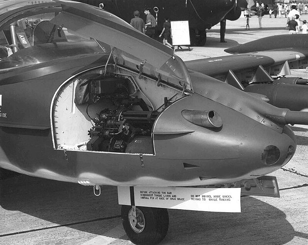

I only found this, but is from a museum:
Were referred to as “Converters” ( along with T-37) … They converted kerosene into noise. And they did have a gun. GAU-2/A, 7.62 mm “mini gun” with 1500 rounds.
