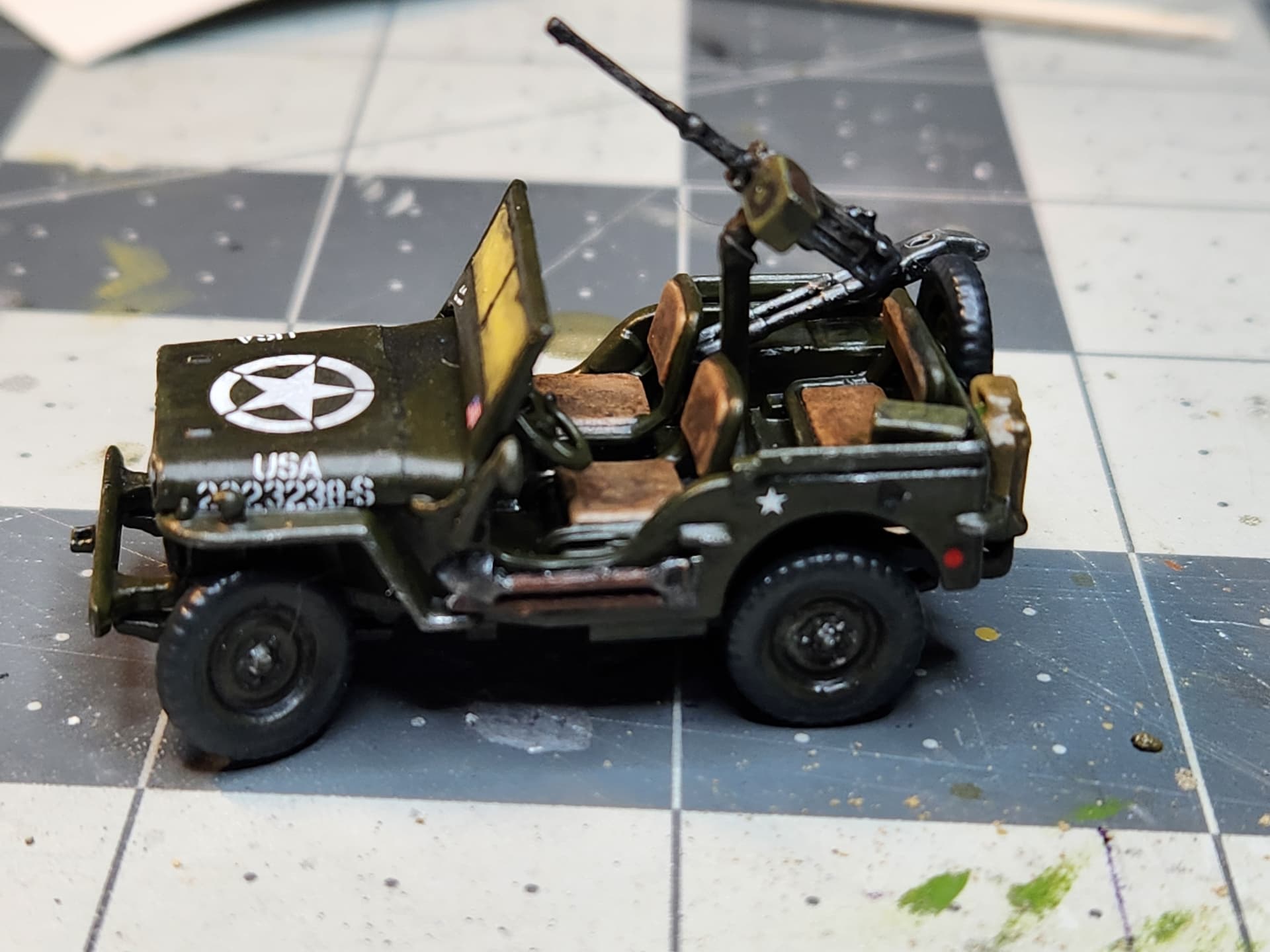

Hopefully the phot uploaded. lol.
Anyways. Tried Tamyai Panel Liner on a tarp and it ate my paint. But I did do a wash on my jeep with Testors Thinner and Flat Black. This picture is after a gloss coat and drybrushing. Tomorrow it will get a flat coat. Thanks for the comments. I am going to try out your suggestions.
