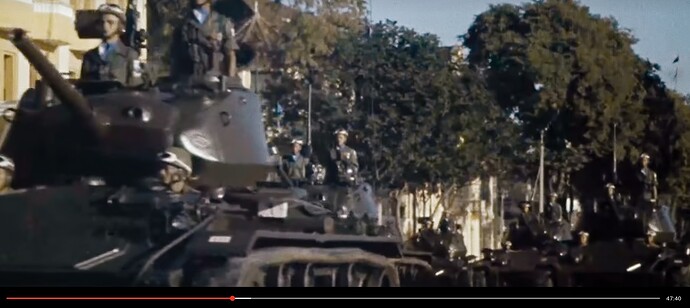

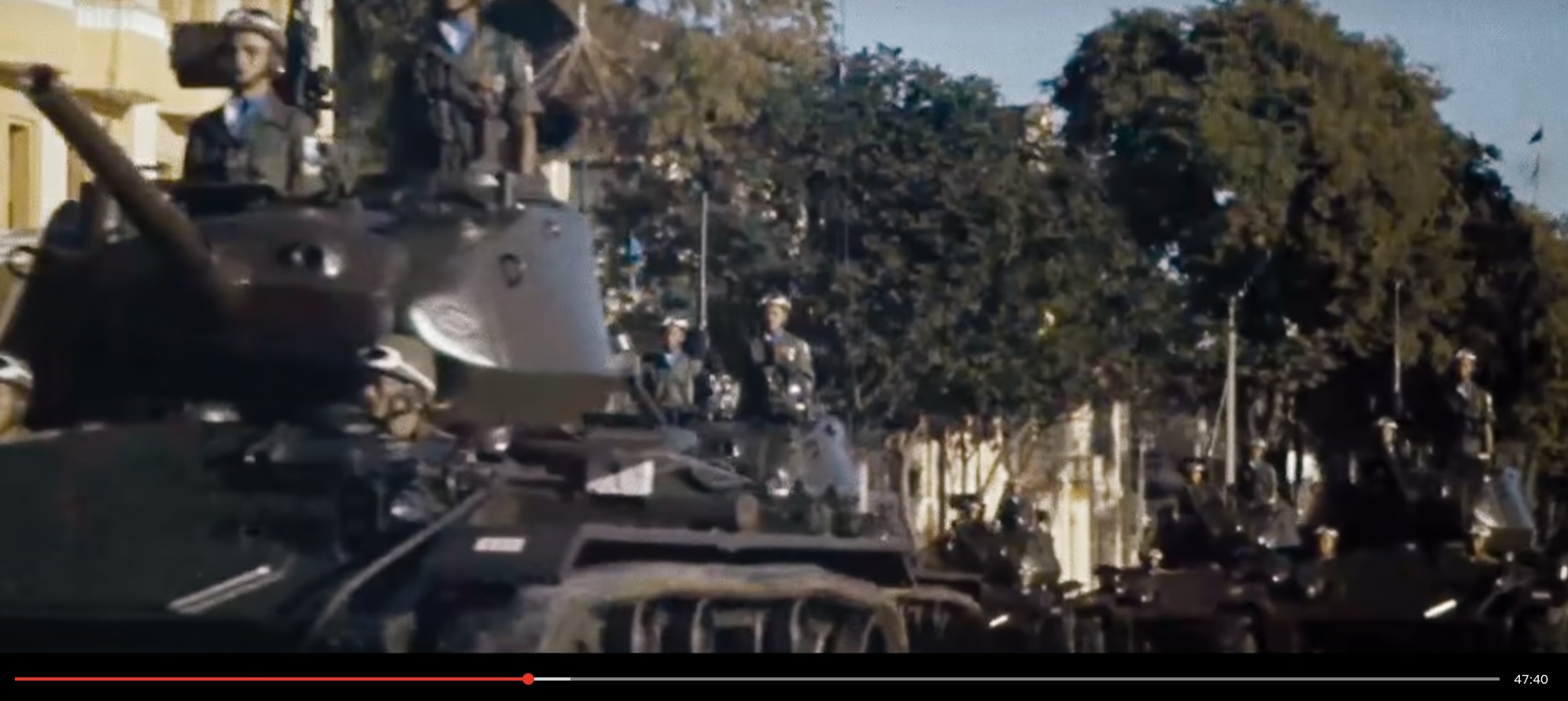

I watched a doc on Vietnam on Netflix not to long ago. There was a brief clip of a column of ARVN Walker Bulldogs going through Saigon. OD2430 stood out clearly on them. No doubt about it. For US, the X24087 was standard but got overpainted in Vietnam with camo colors. The National Guard for sure would have been in X24087
Correction—Chaffees
