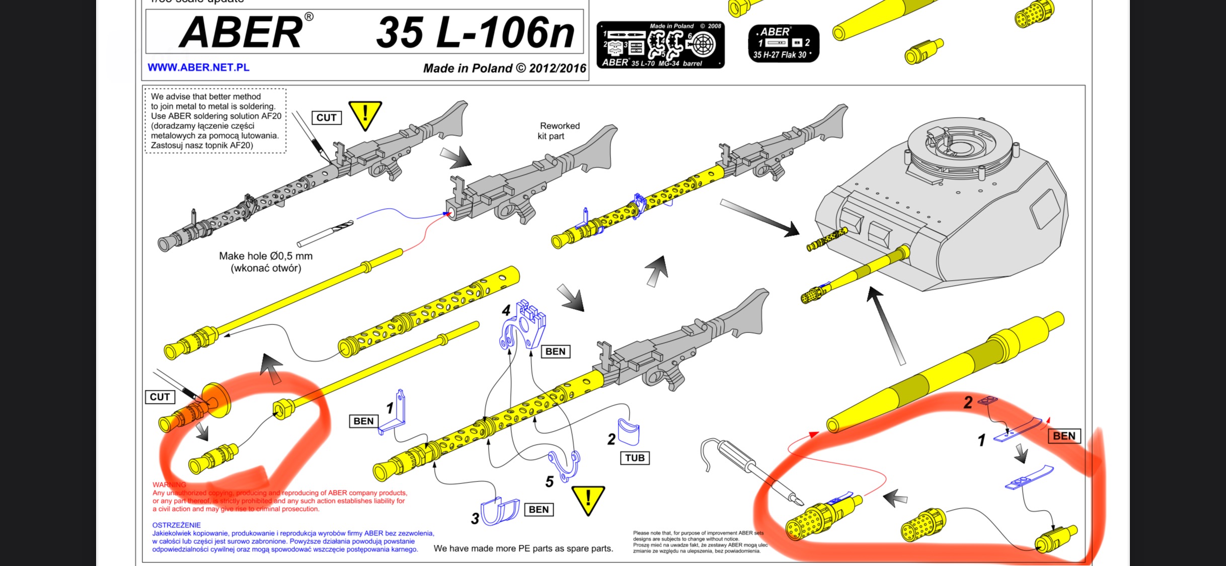

I am building a panzer ii and I am swapping the barrels out for brass. The muzzle brake for the MG-34 has a separate one piece flash hider, the KwK 30 has a two piece muzzle brak/flash hider. The instructions call for soldering these. That makes me nervous with how small they are, though I am worried that glue might not be strong enough if they get bumped. Any thoughts?

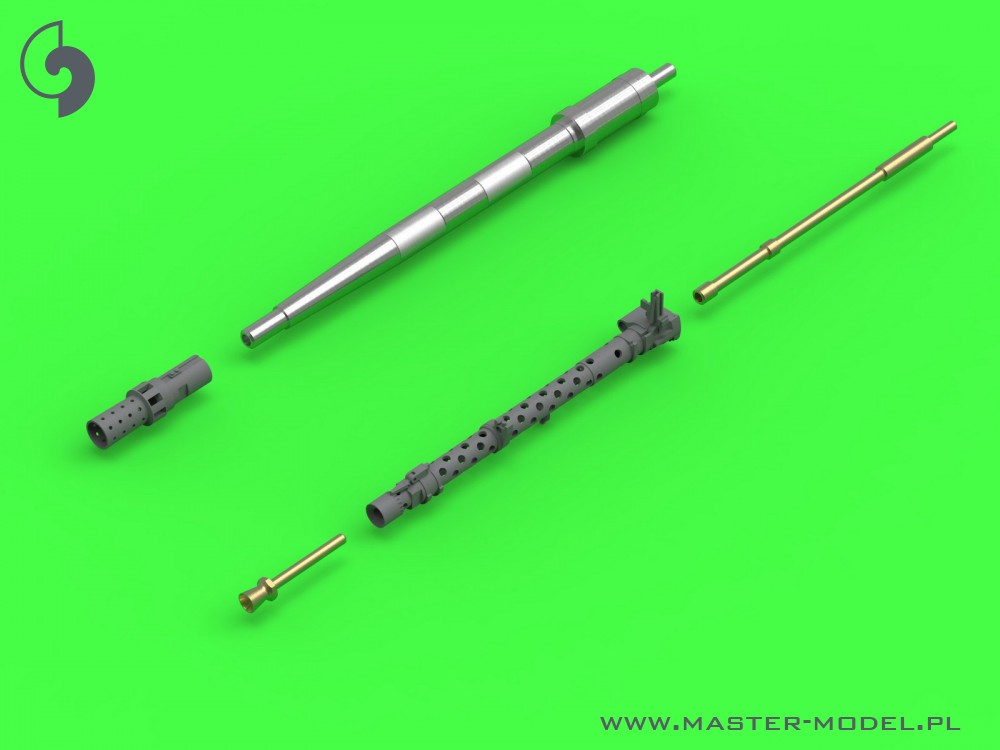

By the way, Master has an easier approach:

There is some pretty fine detail around the parts too and with my soldering skills I know I’ll make a mess of it and get solder in the tiny holes
