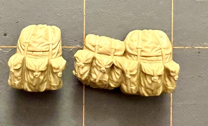

I have just that kit, or a variant with two rucks and a solo ruck (for the 3-man crew). But I will go check, and shop anyway!
Sounds good. I’m sure it will look great either way.
I’m wrong. I have these and additional tarps, et al.
These rucks look like that lake large ruck that was in three-color camo. 90s?
So, I’ll get shopping!
Yes, these are older ALICE rucks that were used up through the early 2000s. In '03 during OIF 1 in 3ID, we still had ALICE rucks. When I went back to Iraq in '08, we had transitioned to MOLLE rucks and other gear.
