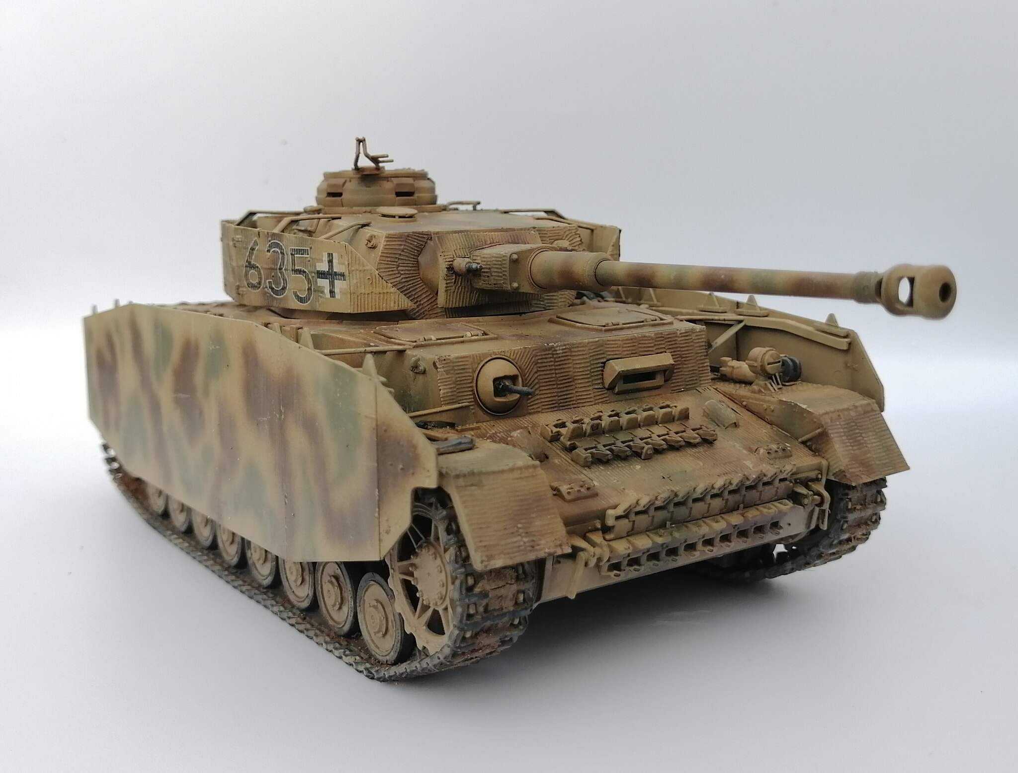

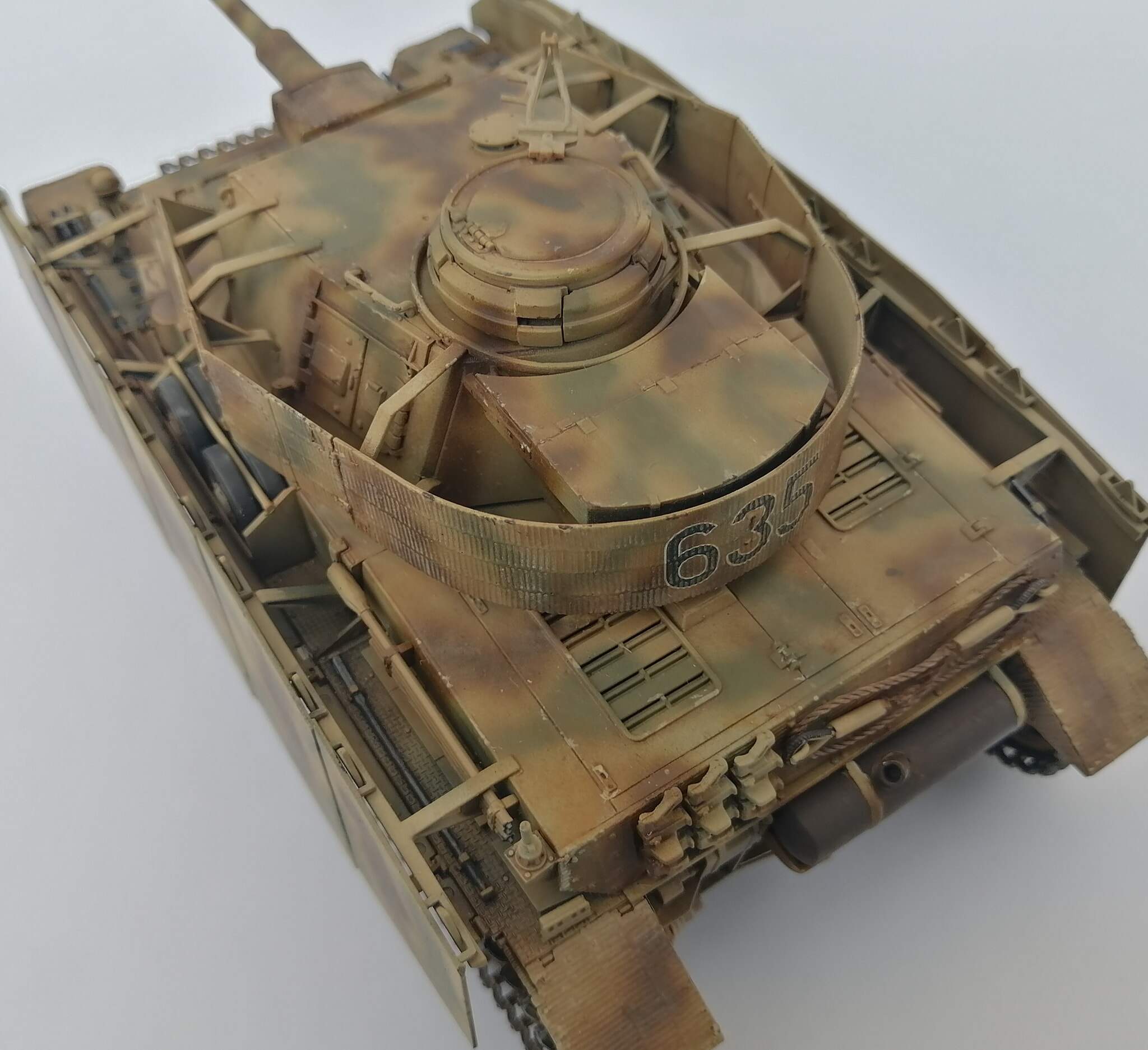

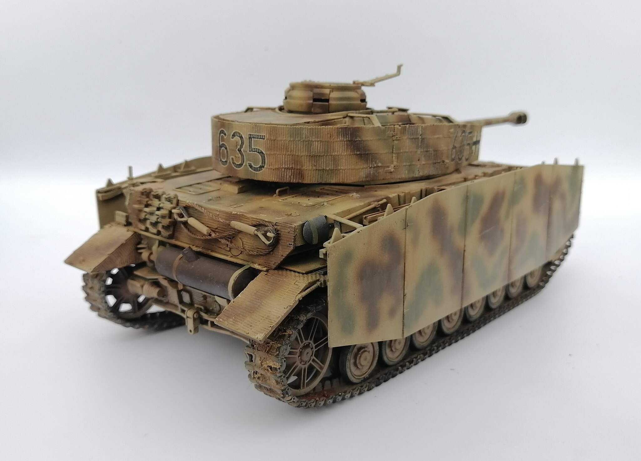

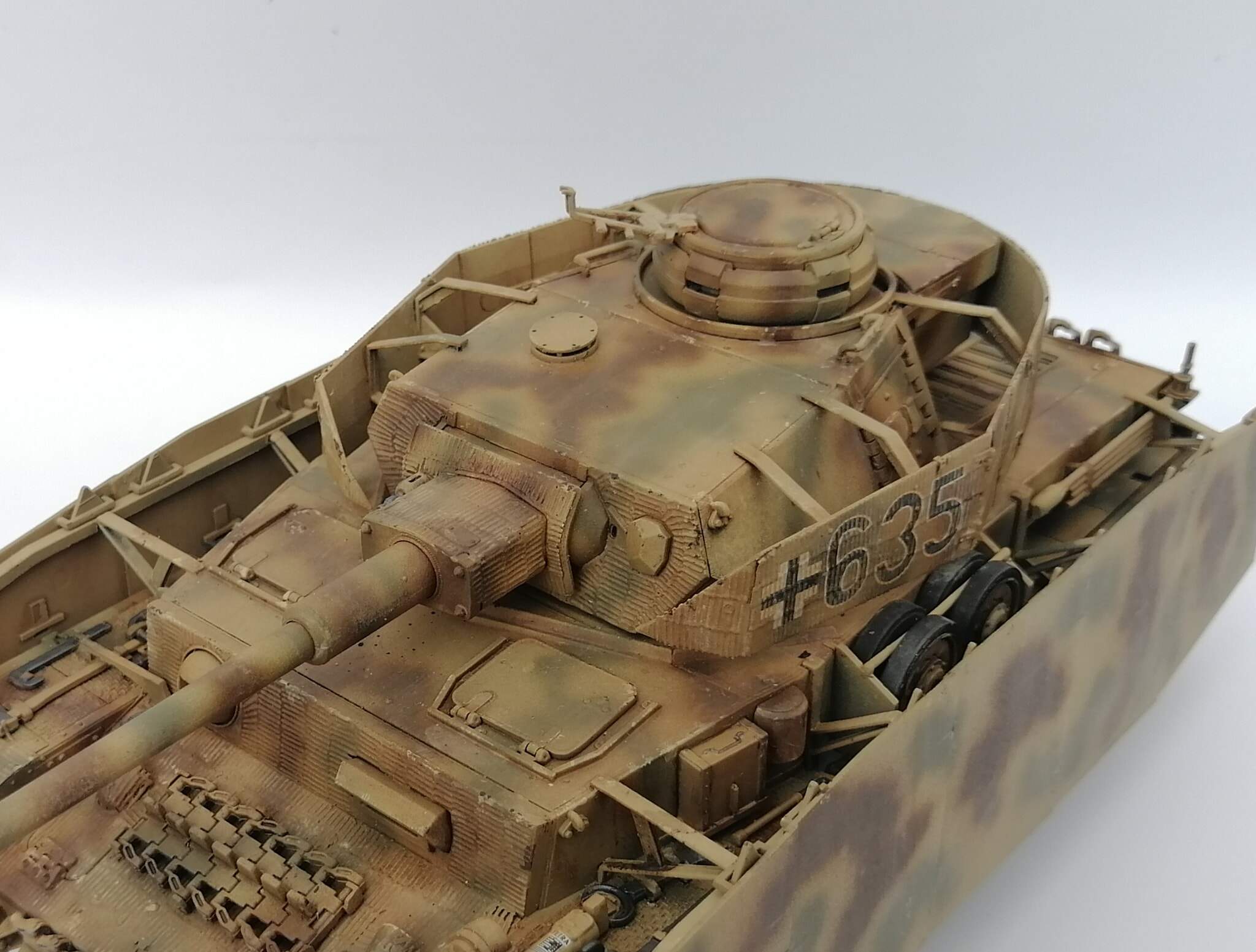

Hi folks,
I’d like to share another quick build - Academy Panzer IV ausf. H. Markings are for a vehicle serving in the 12th SS Panzer Division in Normandy, 1944.
Really nice resin zimmerit decals. Unfortunately, some of the smaller parts don’t conform well to curves. I lost some of the zimm after they unfurled and dropped from the model. Thankfully they give you a few spare parts which you can use to repair the damaged parts. Liberally used Mr. Mark Softer and Setter to make the decals fit nice and snug.
The kit itself was pretty good - loads of spare parts! I just don’t like three things:
  1. There are some missing weld lines on the model.
  2. The schurzen is one part - reminiscent of 1990s Tamiya. Pretty disappointing.
  3. The tracks are vinyl and a bit hard to glue together. Fortunately they don’t really need glue to attach to each other - but the joint isn’t neat. One nice side effect of the one piece schurzen is they really get hidden
Thanks for looking!
Excellent results! Very nicely done :heavy_check_mark:
I like the paint work and the markings, right on the money for HJ #635
Thanks Wade! I tried to look for as many photos of 635 as possible - unfortunately all of the ones I found were from the front. I just copied the camo suggestion of a decal company for the schurzen. This was quite an enjoyable build :slight_smile:
