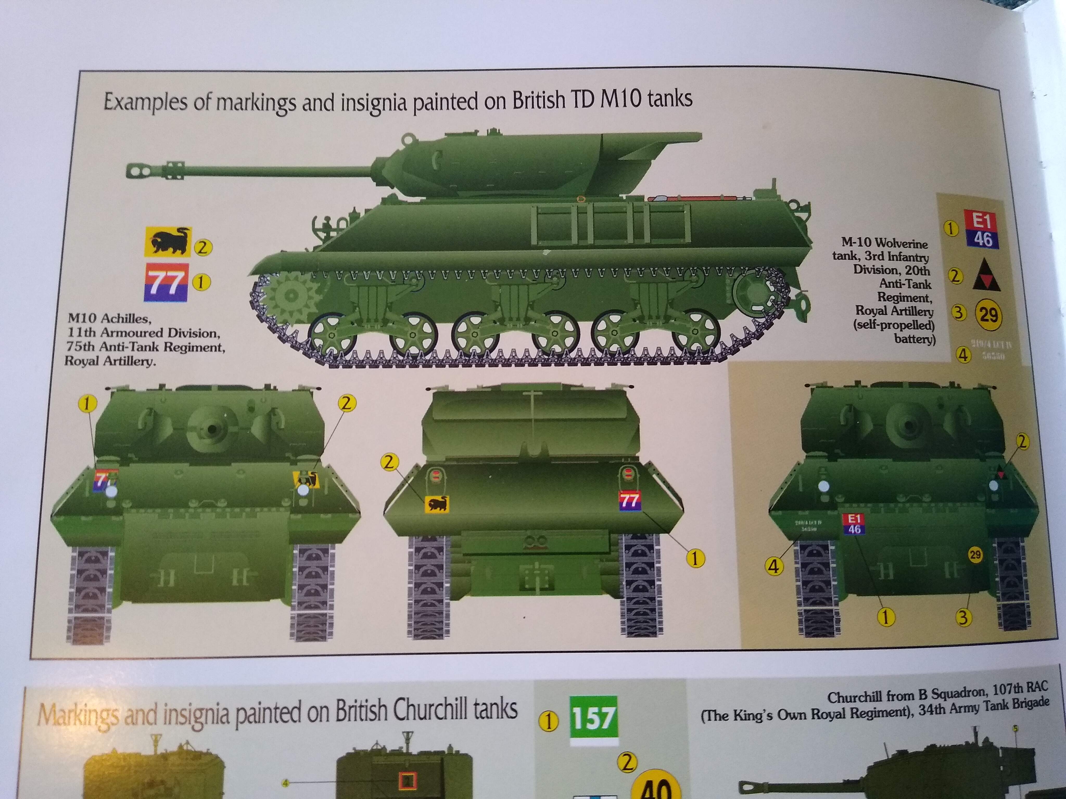

Joel, hope these are of help.
The example scheme for 11th Armoured would be pretty much identical on a Guards vehicle. Just swap the division marking.
