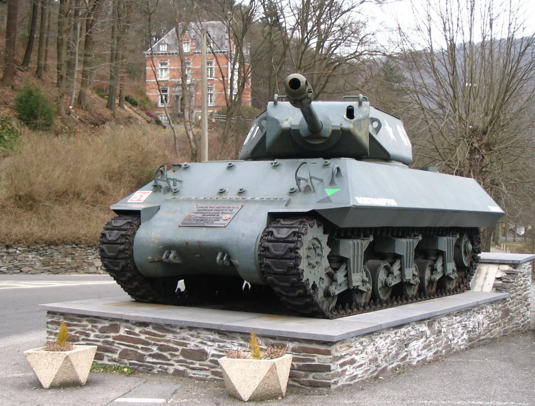

I did find a monument to the 1st Northamptonshire Yeomanry (the senior regiment in the 33rd) at La-Roche which honors their liberation efforts with the 51st Highland Division. The monument has an Achilles in the markings of the Northamptonshire Yeomanry though I’m fairly certain this configuration never existed.

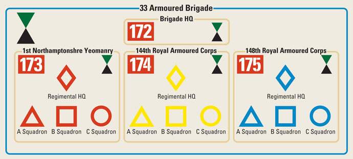

Just to add to Brian’s information above, I did a little bit of digging around and this is what I dug up on the 33rd Armoured Brigade.
Their first battle in Normandy was around Caen between 4 and 18 July. On 8th August 1944 it was involved in Operation Totalize, a planned breakout from the Caen Salient. Heavy German counter-attacks prevented exploitation of the early successes and tank losses were heavy.
The Brigade consisted of:
1st Northamptonshire Yeomanry (Sherman I & Firefly VC)
144th Battalion Royal Armoured Corps (Sherman I & Firefly VC)
148th Battalion Royal Armoured Corps (Sherman I & Firefly VC)

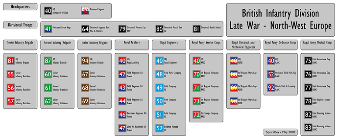

Now this below gives a typical organisation of a late war British Infantry division, you’ll notice under Royal artillery, 46 Red over Blue is the divisional towed anti tank gun Regiment. That’s not to say that they didn’t have SP A/T guns, may be assigned from higher up but you’d need to look into the history of that battle and the war diaries if you can find them. The fact the 33rd Armoured had Fireflys in each troop sort of begs the question why assign more A/T.

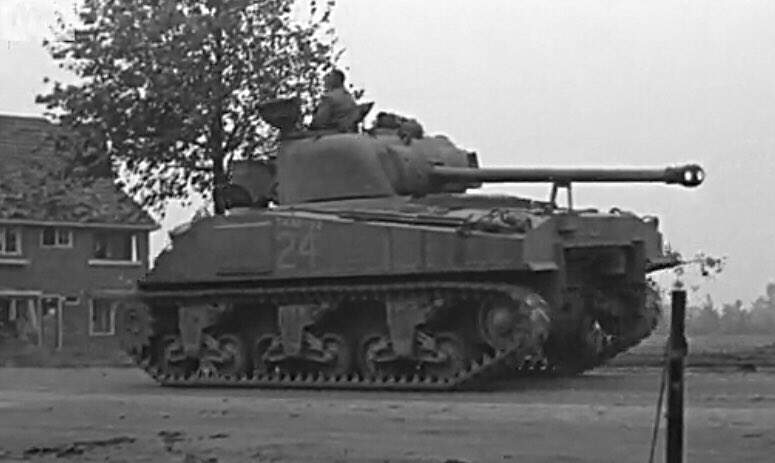

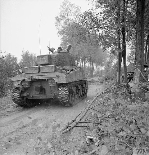

Sherman Ic from East Riding Yeomanry, 33rd Armoured Brigade outside s’Hertogenbosch, around the 25th October, 1944

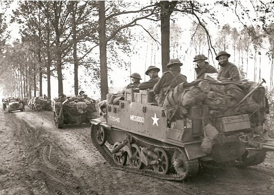

51st advance on Hertogenbosch, you can just make out the trail of an A/T gun being towed by the nearest universal carrier, as the universal couldn’t tow the heavier 17lb this must be a 6lb A/T gun which it could tow.
Sorry just a little off topic: Just an observation for those who model universal carriers fully laden note how the carrier sits right down on its suspension, seen so many otherwise very nice models of fully laden carriers sitting up high.

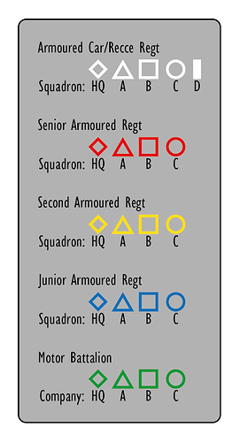

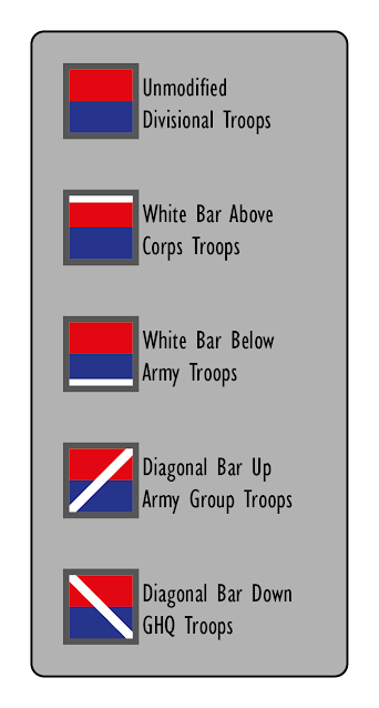

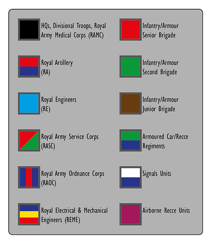

If this helps here are some examples of British markings.
Arm of Service flash
Modified if from a higher formation
Tactical signs

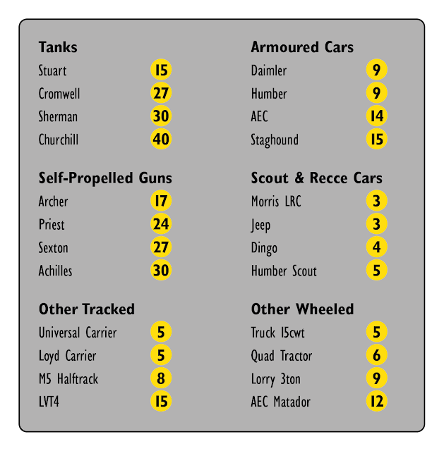

Bridge classification
Vehicle WD number prefix

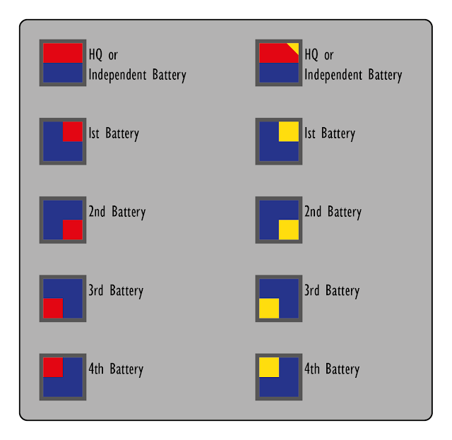

And RA markings. The pattern of the marking denoted the battery to which a vehicle belonged, with one quarter being coloured, starting with the upper-right for the first battery and rotating clockwise for subsequent batteries. Field, Medium, Heavy, AT and AA regiments all used a red corner, while Survey regiments used yellow, and added a yellow flash to the HQ marking.

You mean to say a 17-pounder M10 or some variation on that :slight_smile: “Achilles” was not a nickname in common use in the war, but seems to have gained traction only after it.
