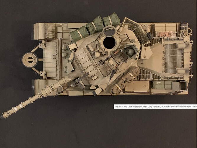

I search from a long time picture of the top to realize a model.
real shape of hatches remain for me a mistery.
probably i need a trip in holy land to see the correct shape !
