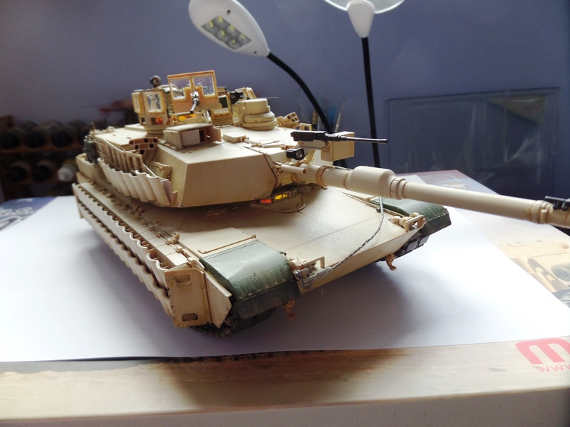

These stickers are great for simulating the anti-laser coating on modern US AFV optics. The periscopes are painted the base color of the vehicle, then you apply the sticker to the face of the periscope. The effect is very realistic.
I used these on my M1 Abrams and they look spectacular to me, they really finish the kit off. I placed them over the clear lens without paint on them.
Is there a color paint that you recommend behind the stickers?
Yes. The AFV base color. These stickers are printed solid, nothing shows through them, so no silver behind them is required. Paint the periscopes the AFV’s base color.
Oh ok…thank you.
As previously mentioned they are opaque. Base color or primer or blue or black work fine.
