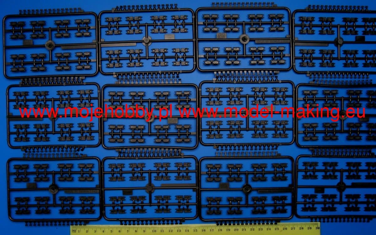

AFV club tracks workable
I have some on order for my m48’s and m113’s,anyone have experience with these,pro’s and con’s

You will be looking at medium to severe sink marks (Front and Back) and knock out marks on those tracks.

I have built 3 sets and vowed never to use them again. As said above, the first two sets are not workable, the end connectors fall off as you assemble the lengths, Treat them as you would magic tracks, just glue them to shape. My sets repelled Tamiya extra thin.
