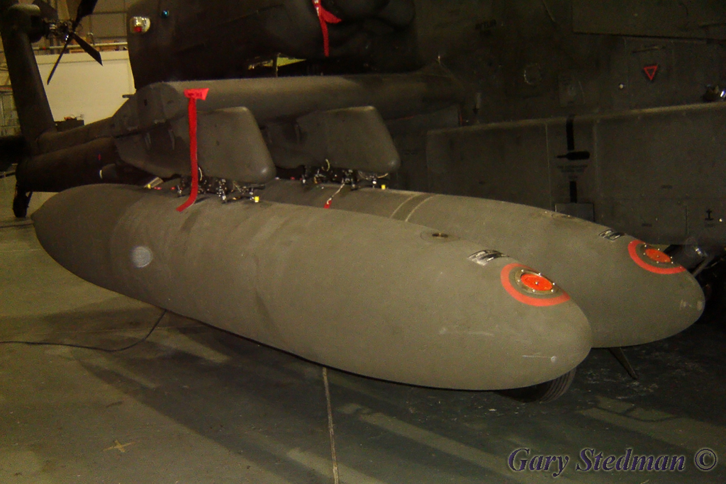

External aux tanks are used on them for ferrying, but not in combat conditions. The aux tanks hold 230 gallons each and are the same ones used on a Black Hawk. Each tank gives an additional 2 1/2 to 3 hours of flight time. They can carry a max of 4.
Like I said above, external aux tanks are not used in combat on US Apaches. US machines now have an internal Robinson Aviation Combo-Pak fuel /ammo container, or “Robbie” tank in the ammo bay that extends range and still gives a significant ammunition carrying capacity. The capacity of the Robbie tank is 97 gallons, roughly an extra 125 miles of range or an added flight time of about 1 hour.

External fuel tanks are a fairly permanent feature of IAF AH-64s, combat missions included.
