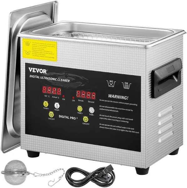

an ultra sonic cleaner? Another must have.
The paper tapers are the only way to wipe inside the nozzle without damaging it. They are a great +1 to ultrasonic cleaners and a sure way to make sure your nozzles are clean inside.
