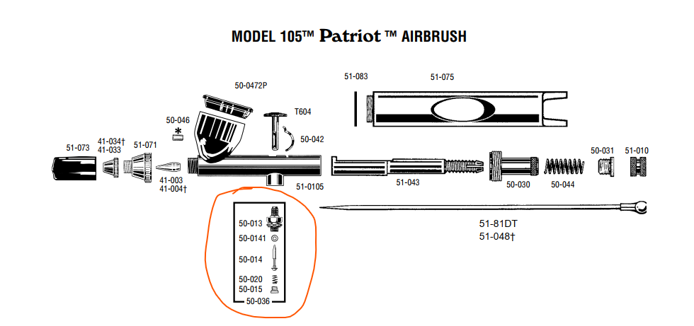

Maybe this, if you get into the air input mechanism (where the gun attaches to the hose), you’ll see that there is a pin, that is spring loaded (live a valve stem on an auto tire) which is activated by the trigger, regulating airflow. I wonder if it is partially stuck? thereby limiting the range of air pressure being applied from zero, and then past halfway or more? You might disassemble and clean this mechanism. Hope that sentence wasn’t so poorly constructed that it doesn’t make sense!
As far as spraying out/emptying out the paint cup quickly, I’ve found that if either I haven’t set the pin correctly in the nozzle (too far back) or if I have a fine pin in place, with a typical nozzle, (“nozzle”, not being the tip of the gun, but the smaller, cone shaped chrome piece the pin inserts into) the gun will use paint too quickly - which is fine for some things, like if painting a large surface area, but obviously not good for more focused work.
So, despite my technically inaccurate parts descriptions, maybe this will help -
Nick
The air valve would be the circled parts
