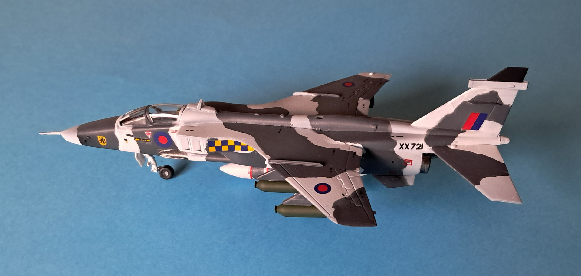

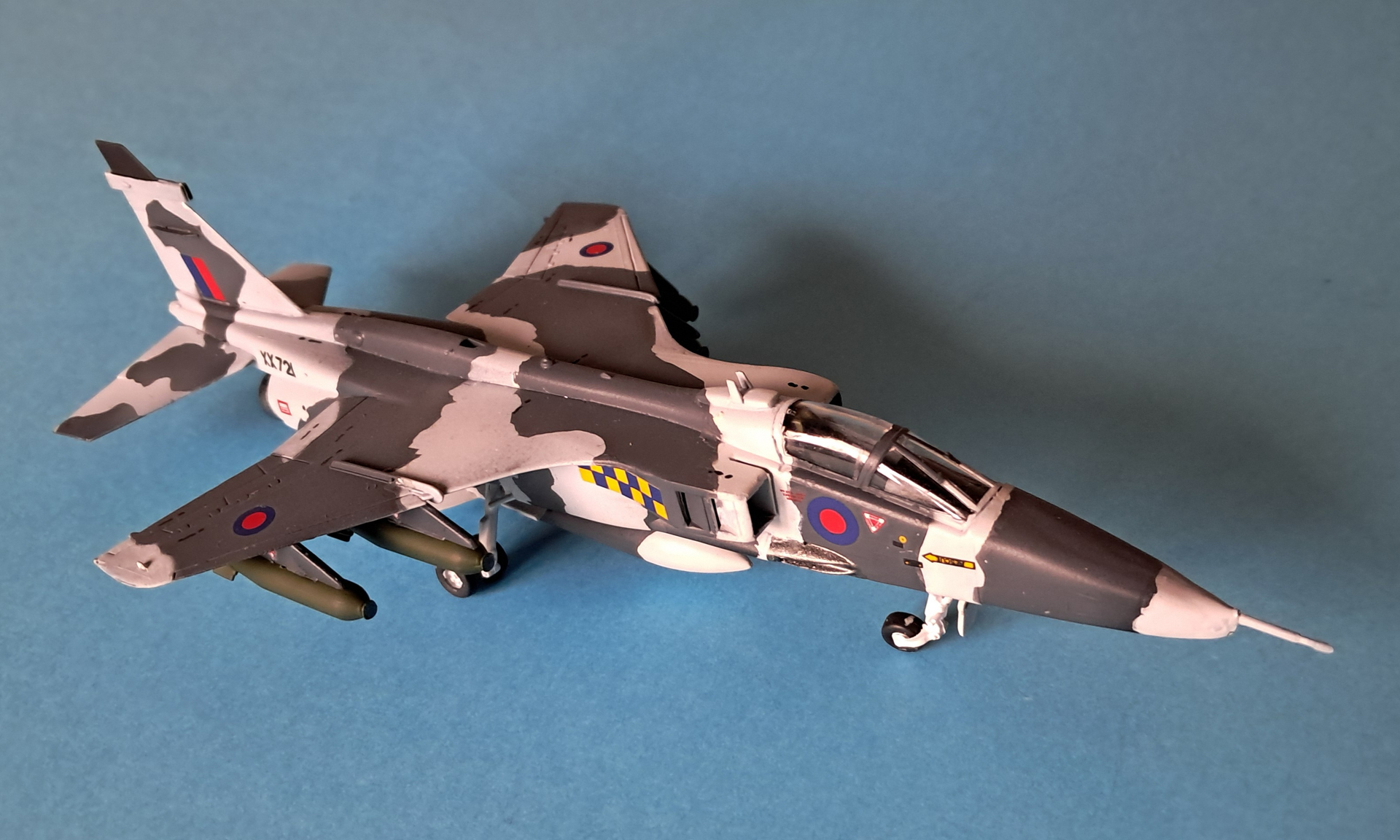

Airfix 1/72 Jaguar (test subject)
I finished this old kit just before Christmas and since I’m not really an aircraft kit builder I was using this as a test subject so please forgive my efforts. It’s one of the old airfix kits from the 80’s when accuracy and fit was an after thought for these old “Wet Weekend” kits
Lessons learned:
  1. liquid latex/maskol shouldn’t be used for masking camouflage patterns on the whole aircraft as removing it removes all paint, including the primer down to the plastic.
  2. Blue/White tac works better but still has paint removal issues and needs to be flat to create sharp paint lines and not fuzzy ones.
  3. Masking tape is better but very time consuming and can be problematic in it’s removal.
  4. Tamiya clear flat varnish from the spray can has increased the darkness of the acrylic darkgrey colour particularly when doing a winter camouflage scheme.
  5. Delicate/fragile/sensitive parts should be added last to avoid having to re-attaching them again and again…and a-bloody-gain.
  1. You learnt the hard way
  2. yes but remember these winter schemes were temporary so were applied for the exercise, use the blue tac but spray straight down from above the line not at an angle and that gets a line that imitates the ERK’s using a spray gun to apply the white wash.
  3. Tamiya low tack tape, but dab it sticking side down to your cloths to remove some more adhesive, just watch for the stary hair.
  4. Yes but normally it’s the gloss that will darken the colour with the matt bringing it back a bit.
  5. You’ll learn :slight_smile:

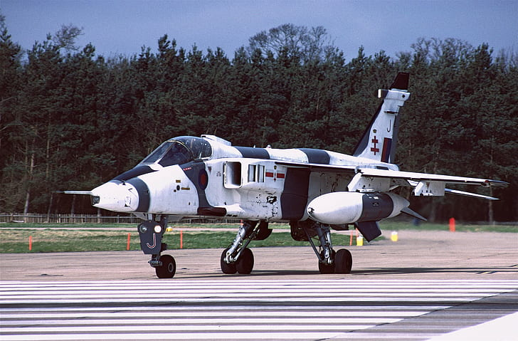

Two things, the white wash tended to wear away at the leading edges within a short time, it was only a temporary paint.

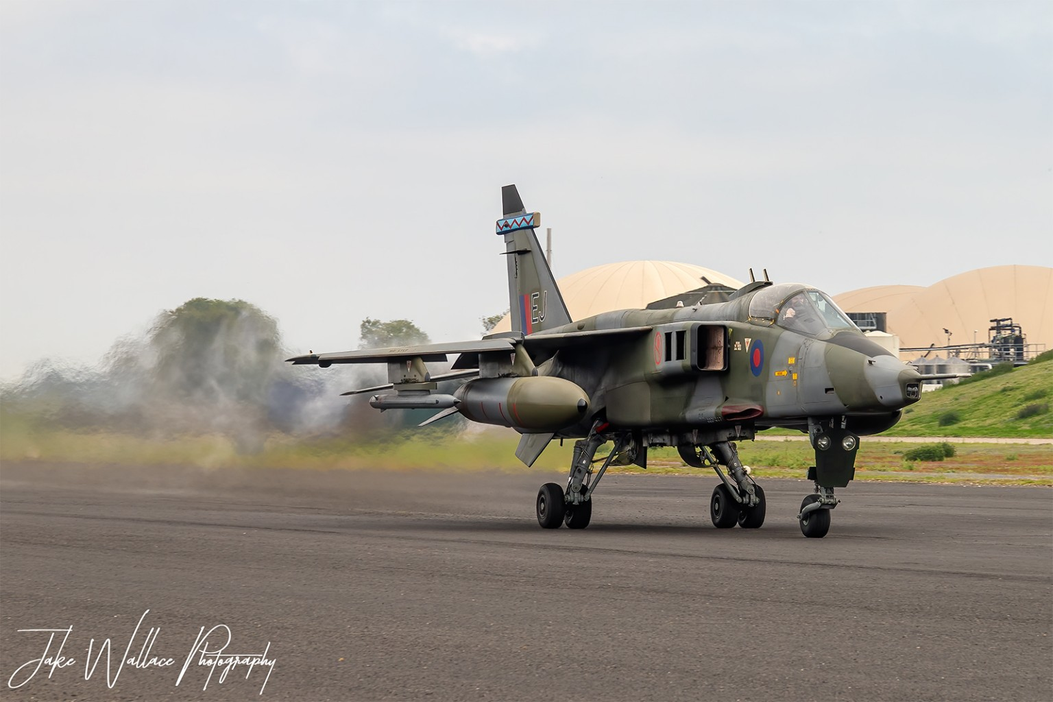

The blow in doors on the intakes should be closed, (they are sprung) when the engines are not running on the ground and are also closed in flight. As there is no one in the cockpit it’s safe to say that the engines are not running. Airfix and a few others got this wrong.
Blow in doors open and engines running
On the ground engines not running

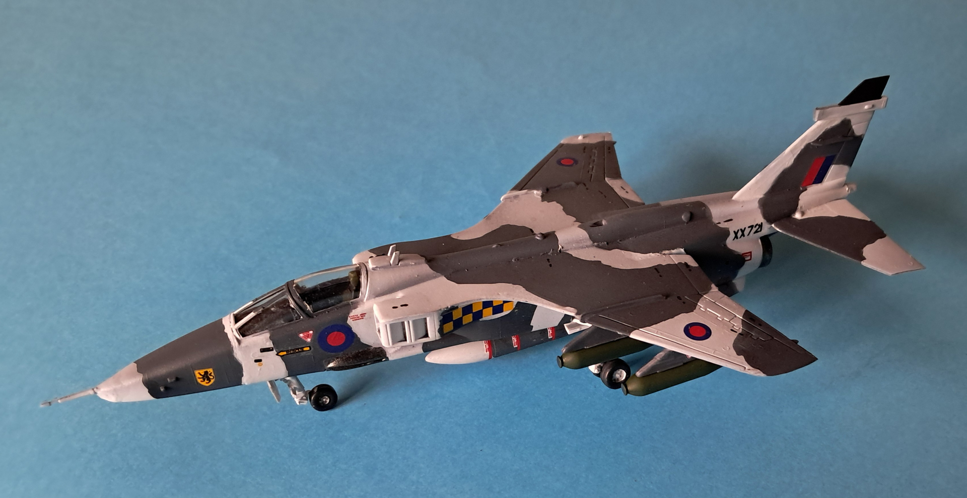

Winter camo
All ready for your next Jag build :grinning_face:
Turned out pretty well.
Really must do one in arctic camo myself one day.
I’m still somewhat hopeful that Airfix will scale down the new 1/48 in the next year or so.
yeah this old dog is really behind times and accuracy is an issue and so is the fit of some parts. so a down scale version is really needed in today’s market place.
Looks good David. :+1:
Naa it’s not that good, I know where the bodies are buried but it was an experimental piece and never designed for competitions.
On every work of art, the artist knows where the bodies are hidden. Still looks good to me.
